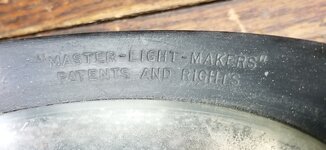

Searching on the 'net, I found a sum total of three pictures of what appears to be this same light--but no information whatsoever. The only thing I learned is that these seem to sell for about 30 times what I paid for it--$5. Not bad.
Working on this light brought back some pretty not happy memories of using drop (trouble) lights over the years--running wiring or soldering plumbing in already hot attics and crawlspaces with a very hot lightbulb near my head, which was prone to breaking the filament every time it was bumped when lit. I'd usually bring two or three spare bulbs with me and got very good at swapping them out in total darkness. We all tried "heavy-duty" light bulbs that were supposed to be made to handle getting bumped around when lit--and maybe they worked just a little bit better.
I'm not in the least nostalgic about old tungsten-filament bulbs.
The "Edison" LED was something a co-worker brought a case of in the other day. He bought them for household lighting and his wife declared they were too bright. Too bright for a 60-something guy working in a shop is an oxymoron.
