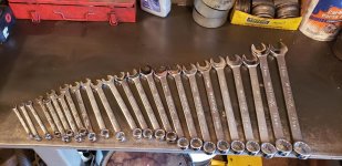

I have the SK in long pattern, the Wright, and Carlyle.
My favorite is the Wright. I like the long pattern of the SK but not how easy they can spread in the open end with the smaller sizes. The Carlyle are great for the price point don't have any complaints with them.
Since Wright doesn't have long pattern my next wrench purchase will be Snap-on for sure to round out my wrench collection! :thumbup:

My Wright 915 SAE set arrived while I was away this week. I didn’t pull each one out of the roll to inspect, but the couple I pulled look and feel good. The only wrench not marked 2.0 in the set I got from Summit is the 5/16”. Not that it’s practical or necessary for my stationary use, but I do like the roll for storage.
My 958 metric set from Zoro shipped today, so I should have it late next week.
That was the wrench not marked from my set either. Wright said it may have been a left over from when they were transitioning to 2.0 . Not a big deal for that size.
I also ordered the metrics from Zoro and no ship notification yet. They did say up to 10 days to ship as they are sent directly from wright, so I am being patient.
