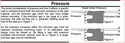

Question on the ucups. What is the purpose of the backing washer (black arrow in the picture below)? Is it really needed?
It sounds like when you convert a jack from oring retainer/oring to ucup, you wouldn't have a backing washer just the ucup. Is that an issue?

For Jeeper
The back up is needed more in the case of nitrile u-cups, but these are not used nowadays in jacks. Earlier models of Shinn Fu jacks used nitrile u-cups but were later changed to urethane.
The purpose of the back up is to prevent what is called extrusion, which is when the bottom end of the seal wants to go into the space between the ram body and the cylinder under pressure. This can also happen with o-rings and that is why you always see o-rings with back ups. The back up is supposed to be slightly bigger in diameter than the bottom of the u-cup so it is made with closer tolerances with respect to the cylinder, without binding or jamming. Extrusion can damage the seals.
With urethane u-cups the possibility of extrusion is less but still the backups are recommended and used. It could be an issue on very high pressures but maybe not on the pressure generated by the weights lifted by floor jacks.
See below with and without back up rings. See also extrusion of o-rings.
