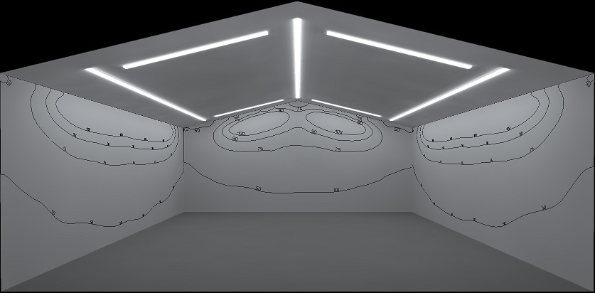

I was looking at 2 tube LED lights that is 4' long, and if I go with that, this is what I come up with. Mind you that the two inner rows will be on one switch, and the two outer rows would be on another switch.......or would it be better to have one side on one switch and the other side on another switch? I was thinking I had 30' of area but I only have 28'. My inner overhang is 8' and not 6' as I was thinking. The LED's would cost me more in the longrun, but the cost to operate would be cheaper. Even at that, a decent fluorescent light fixture is only about $15 cheaper per fixture. The LED's are $44/fixture. Times 16 comes to $720. But a decent fluorescent is $30/fixture and would come to $480 total, so $240 difference. I think I can live with that price difference and step up to the LED lights.
So what say ye all about that? :dunno:
Platonic....I just now read your reply. My garage doors (2) are 10' wide x 8' tall and are on the right side of the garage (layout shown)

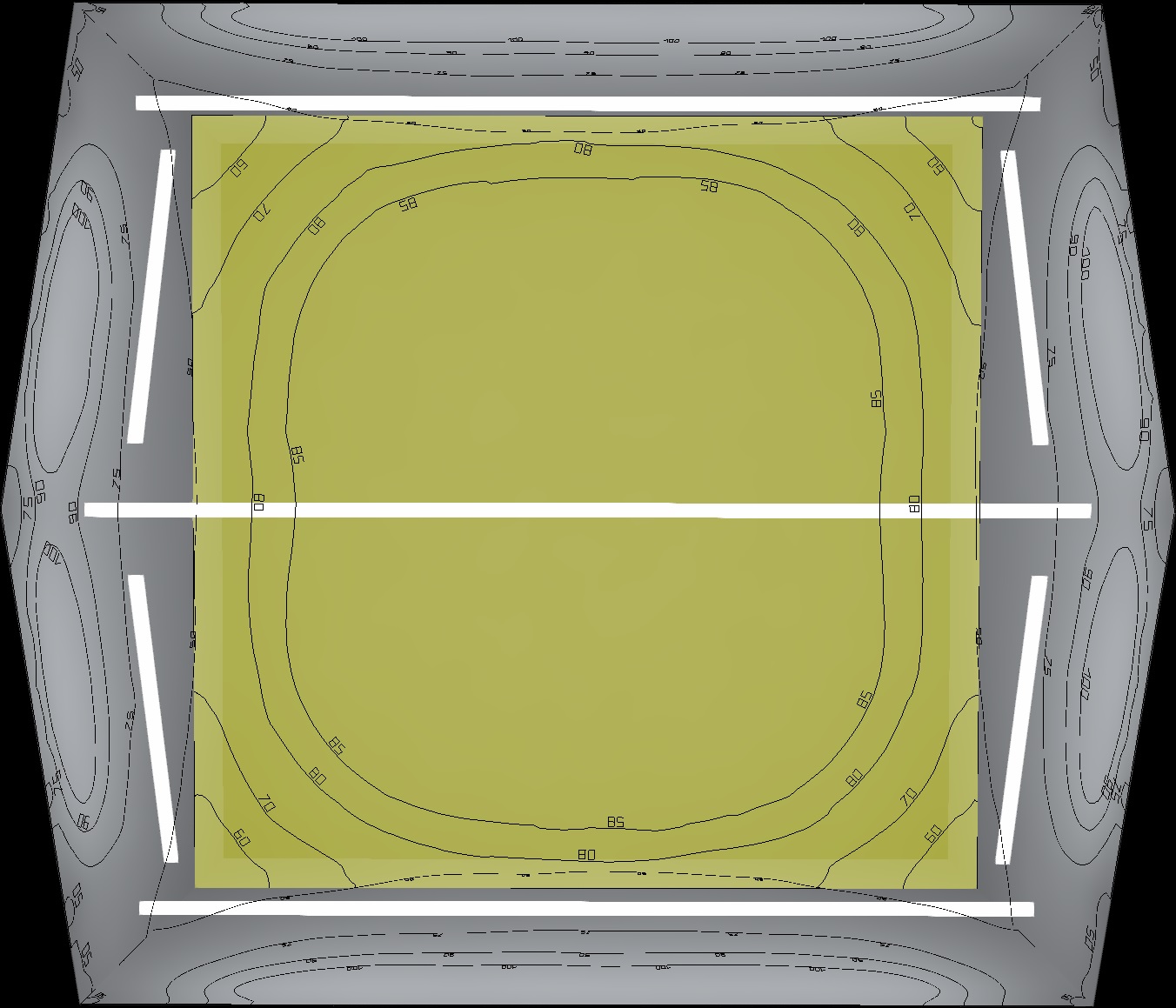

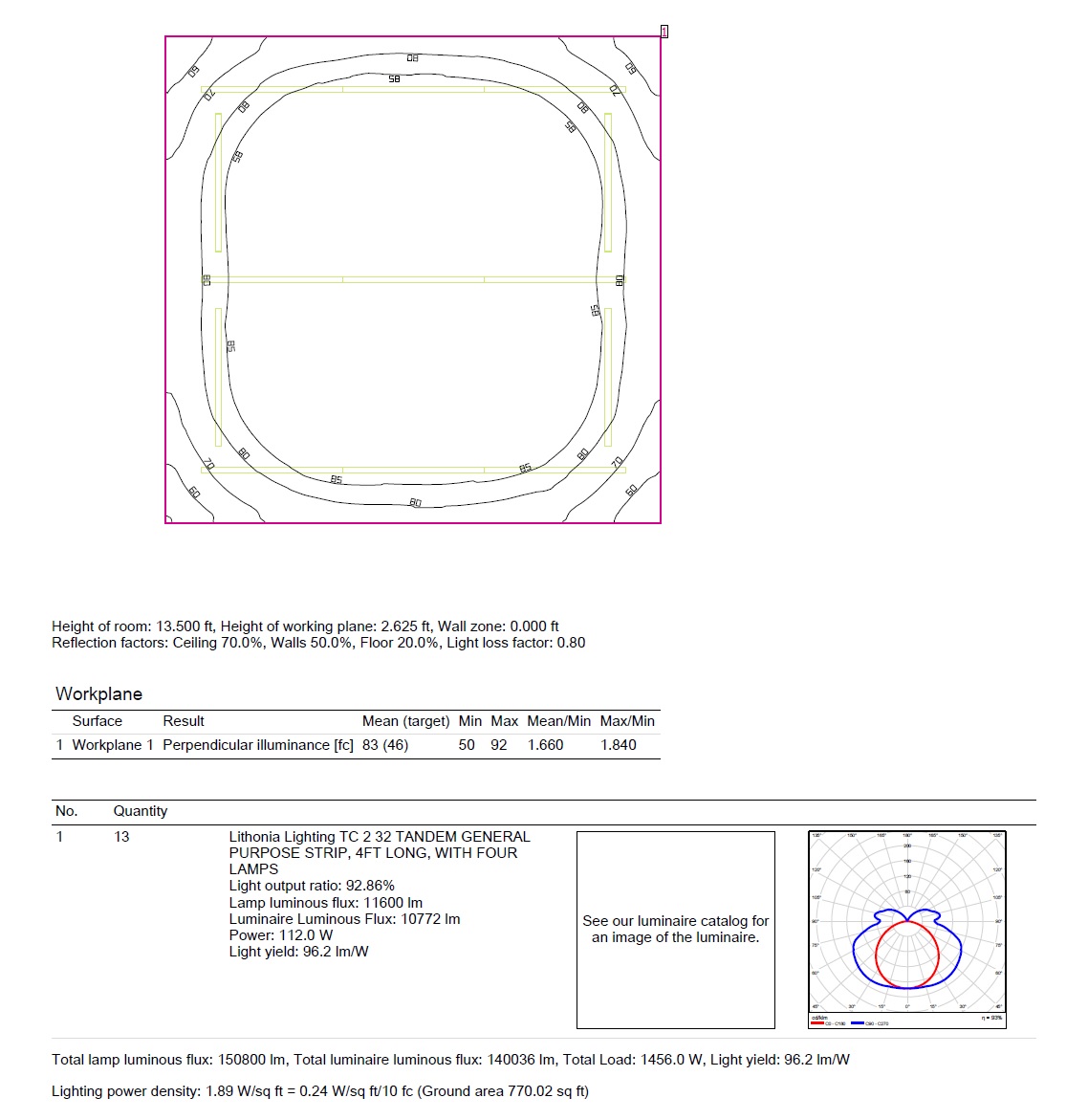

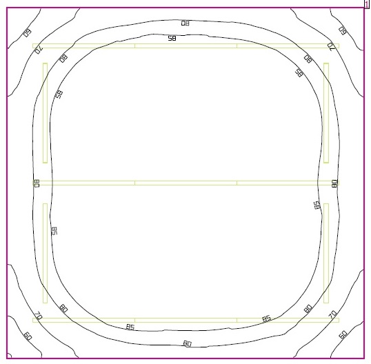

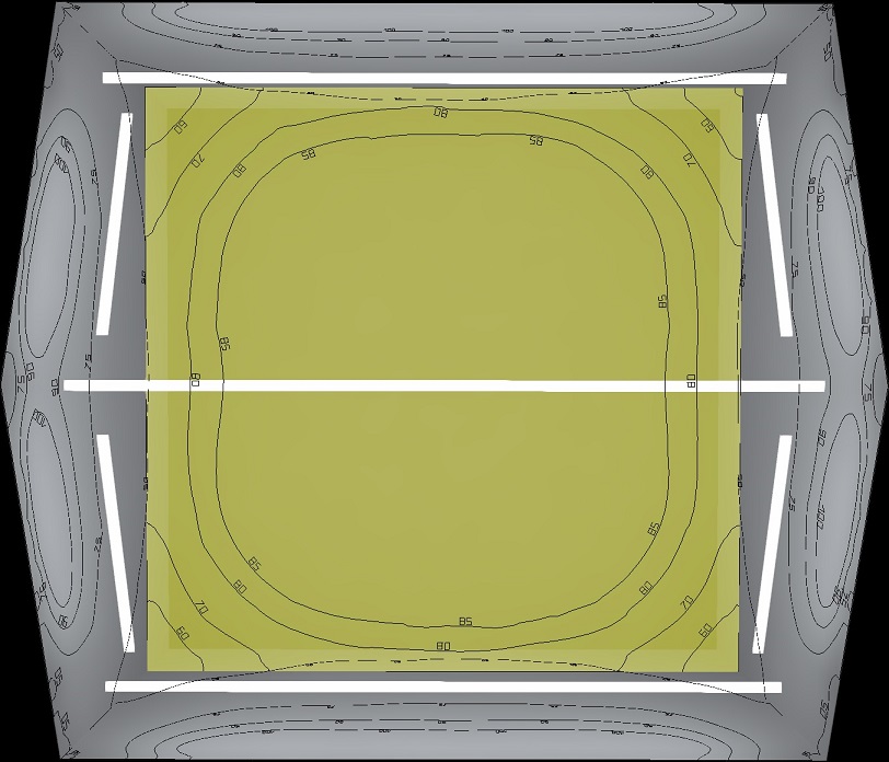

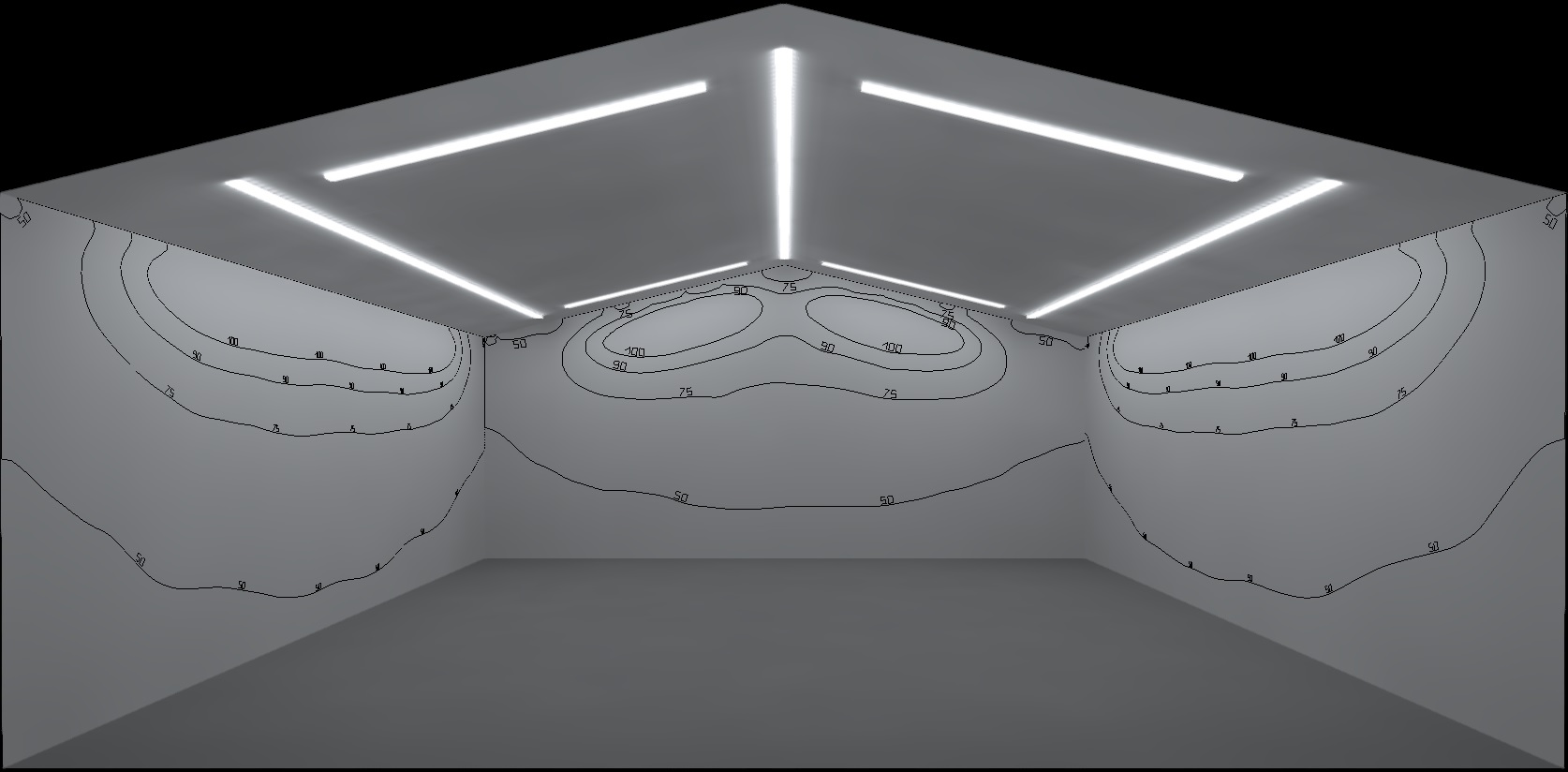

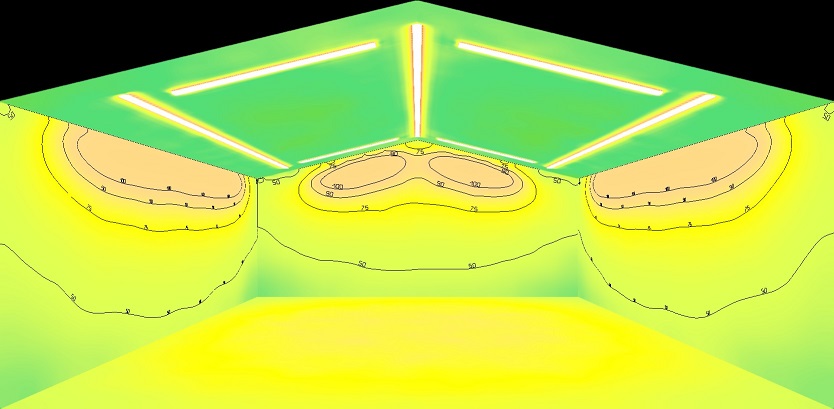

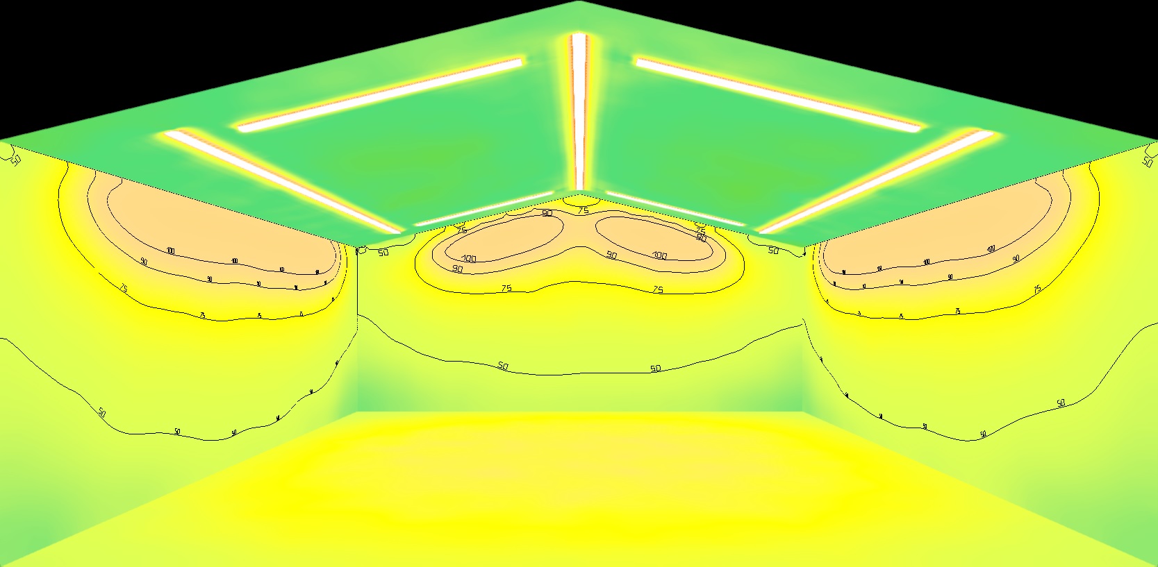

OK, since you've earned some serious street cred with nearly 25,000 posts, I ran your layout. I say this cause my GJ Inbox is getting full and every time I do one of these I get swamped with requests - many from ppl with 0 posts. Anyway here's what Qty. 13 - 8ft 4-lamp F32T8 Fluorescent fixtures looks like (yes, that's 52 4ft F32T8 bulbs).
Fixtures near walls are 3ft from whatever wall they're parallel to. And garage doors, as in your sketch, would be on the right.

If you want LED, the best $1 per lumen output right now is the James plastic housing lamp ($10.50 ea) installed in a PLT housing ($12.52 ea). See the Lighting System Comparison spreadsheet for links.
At 22W per lamp all the fixtures could run on one 15A circuit. You could get creative with switching and run 1 lamp in each fixture on it's own switch, thus each switch turns on 26 lamps (1 in each fixture).
52 James LED Lamps = $546, but you have to buy 60 so = $630
26 Fixture housings = $325.52
Total = $955.52 (leaves you with 8 spare LED lamps)
Total Lumens for 52 LED Lamps = 127,920
You'd have to install 34 Feit fixtures to reach that lumen output.

Doug, how many bulbs do you have and are you satisfied with your current layout, lumen output, lamp life, lamp warm-up time and electricity usage?
Platonic Solid
Nov 29, 2014
3,587
CT-USA
Thank you for the kind words Kevin. Both LED and Fluorescent options have their merits. The fluorescent option you’ve chosen will work particularly well with your sloped ceiling as the 360° light output of the fluorescent bulbs turns your ceiling into a giant reflector providing exceptional shadow free light distribution. This has the added benefit of making the space feel larger. As mentioned earlier, to take full advantage of these features, painting the ceiling with flat white paint is recommended.
