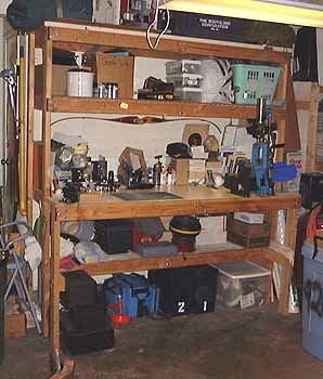

Not sure if your looking for something like this? This is my next project, I will put mine on casters and have a shelf permanently mounted on the wall, so the bench will slide out from under the shelf for cleaning.
This guy went way overkill on the lag bolts but easily built on the cheap. :beer:

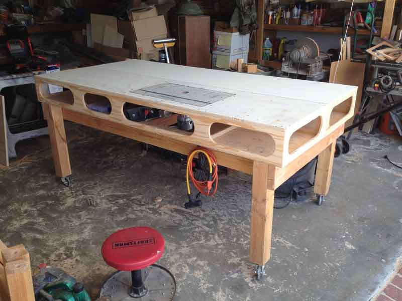

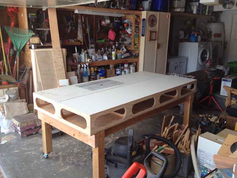

Here's my 'hobby' bench. It's a floor-to-ceiling design, the bench top is 3' deep, the shelves above and below are 24" deep. 2x4 framing, lag bolts are overkill, and it's screwed to the studs in the wall. Very sturdy. Lots of room and storage.
This is my rolling work table, it's a hybrid of a couple ideas, I originally had a large table top a full 4'x8' melamine-coated particle board as a top, on 4x4 legs, casters, and 2x6 support framing. Later I discovered the portable workbench designs of Ron Paulk, on youtube. I built his portable box / top modules and altered the rollign support frame height to maintain the height of the working surface to my table saw. I use it for all manner of large projects, sewing awnings, auto reupholstery, building furniture and cabinetry.
And in this reverse angle pic is the re-work of the original workbench in the garage. Everything surrounding it is new work, cabinets, shelves, yard tool rack.
