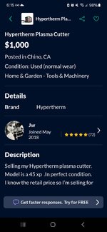

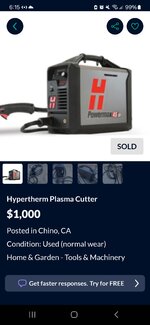

When I got my used HT PowerMax 45 years ago (that I haven't used since testing it out) I only got it because it was a REALLY good deal. The guy selling it was selling it for short money because he thought there was something wrong. I took a chance and realized there was something wrong - he was using the wrong consumables so it would start then blow out in a few seconds.
Being DIY, I was more seriously considering a cheap Chinese one (don't remember which one at this point - I recall it had a "50" in the name) because it just didn't make economical sense. If I was a pro, or fabbed with a lot of metal/steel, it would have been a different calculation, but as is evidenced by NOT having used it real-use EVER, if I got the Chinese version, it would have be justified.
Other people's mistakes can be a goldmine. I have a few other things where someone sold it because they thought something was wrong. I got a Dewalt DW735 with Shelix head for way short money because the guy bought the planer and Shelix, but when he would run it, the pulley would come loose after a minute of running. I took a chance, and he sold me the planer, Shelix, and original head for $200. Come to find out, he had installed the pulley on the head backwards, so it was rubbing the casing, and the friction was causing the pulley to unwind off the thread.
So I ended up buying the used Powermax 45xp. In part because of the electrical concern discussed above. I simply didn't have the headroom on my panel to size up the circuit to run one of the 50/60 amp rated import models, and I didn't want to size down as the cut capacity was reduced considerably. In short, I paid a premium for the efficiency. That said, I didn't pay "10x" for it. I bought a very gently used model with a small collection of hand consumables for $1,000.
I was riding high until I bought a cnc and had to buy a cnc wiring harness for it, then a machine torch because I didn't want to cut into my hypertherm hand torch, then machine torch consumables, etc. I ended up spending more on peripherals for the hypertherm than I did for the machine.
At the end of the day, I'm very happy with it. It has been a great handheld machine and cnc machine. But in this era of inexpensive machines running 100s of hours on home cnc setups, it's hard to argue the value proposition of the import machines.
