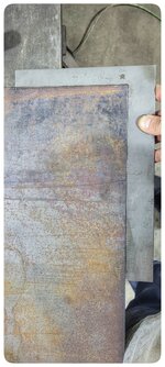

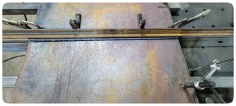

Just thought I would show what a cheap 50a plasma cutter can produce on 1/4" plate. So that people can decide for themselves. This is a 5 year old herocut cutpro50i
Just a straight edge used to cut, didn't grind any mill scale or rust off it as you can see. Even used the same old consumables that were in the torch. Unit set for 50a and air pressure 60psi. Cut took probably 30-45 seconds. Minimal dross which was knocked off with a chipping hammer and then edges got about a 15 second bevel with a regular grinding disc on an angle grinder
Maybe someone with a hypertherm/miller/esab/thermal dynamics 30/45 can chime in and post similar pictures on a 2ft long 1/4" steel non CNC cut so we can see the difference in quality.
