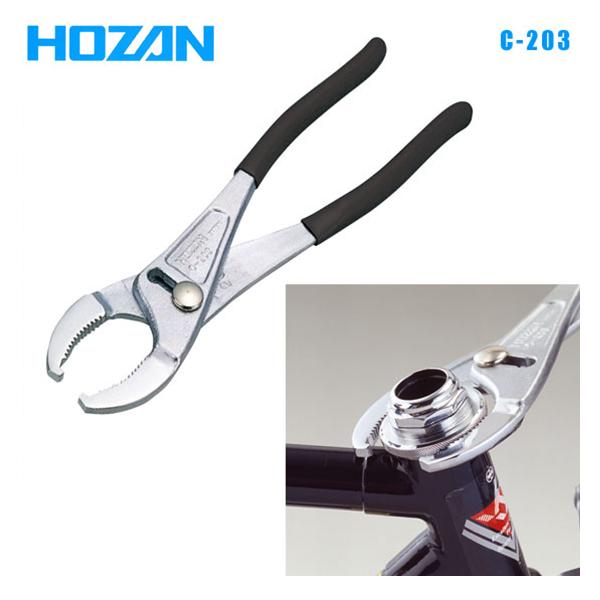

KnurledNut
Jan 28, 2011
8,301
n/a
R
Rstark18
Mar 28, 2013
75
Los Angeles
That is something to consider especially the Hozan BB tool. My concern with that is getting the pins round so that they don't chew up the part.

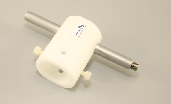

Is this a purpose built tool for the job? I don’t know anything about scuba gear, but it looks similar to your application.
This is exactly what that tool is for and I already have that. The problem with that tool is that the lockdown screws are made from soft nylon. Under normal circumstances it works fine but when the body is over torqued it shreds the nylon ends.
Is the ring also nylon on the specialty tool? Could the lockdown screws be replaced with a threaded “bolt” with the end turned down to the diameter and depth you need? I’d wager if you had a new nylon lockdown screw (or whole tool) to take measurements from, someone here could make one from just about any material you could imagine. Maybe even replicate the “ring” for you in something that won’t mar the stainless/titanium part.
