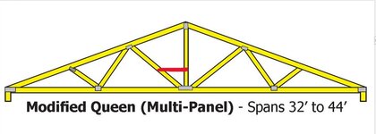

I'm planning to put 20" of cellulose in attic of attached 22 x 24 room, once I get ceiling in. Trusses - half 12" and half 16" on center - 5:12 - so just 5' top to bottom. Access will be a hinged vent in one table, 22" x 30".
Seems like I need a way to get to near to far end for blowing insulation. Should I put walk boards down on bottom chords or should I try to raise them - for crawling - to 20"? (Seems like a lot of work and material to raise them for not much use.) If I do put them - thinking 3 2x6s from form work side by side spaced maybe an inch - on lower chord, should I mark it somehow for future users? String, 1x1s, signage, other?

I screwed a ~24" 2x4 up 22" from the bottom of the truss. It landed on the center queen post of the truss to the adjacent angled web. I had 18 ish wide cut offs of 5/8 OSB from the roof deck so I laid down a double layer down the whole 80' of length. I staggered the joints. It paid major dividends on not only blowing the insulation but also running internet cables and such. The guy that put in the internet loved it and thanked me profusely for it.

Mine is a plain "W" truss so logically between 2 angled webs, but a 7' or so span. I worry I won't be able to fit on it to insulate.
Hard to imagine a reason to get over this single room in the future. Absolutely no storage potential.

I did raised platform. Made it 2’ wide so got 16’ from a sheet of plywood. Added bracing at 16” o/c.
I have R43+ so catwalk is tall. Left plywood loose so could pull it back, blow inside, and put back.
