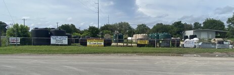

Here is the tank storage yard at our local hardware store. 3000 gallons is the smallest that most people install. This market also includes people with rainwater collection who of course need even more storage.

With our current well issues, I should dig up and revamp our old cistern. Or maybe bury a. New tank next to it and tie it in. The tiles still run to and from the cistern. I just filled it in with clean rock.
