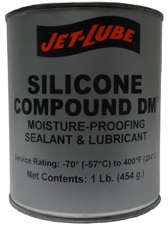

M6erfan
Dec 6, 2014
10,170
'Merica!
It's what i've used, same as your dielectric...
