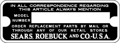

Been over two months since my last post here. There's been a lot of badges reproduce, some mistakes made and new techniques. To catch up, here's some work done back a month or so. By the way, from now on all photos will be as attachments so they stay here "forever" and no more Photobucket links.
I removed the SEARS, ROEBUCK AND CO. machinery tag off of my belt/disk sander and reproduced it without the serial number.
These will be available for sale individually as blanks without any stamps. They will be trimmed to size.

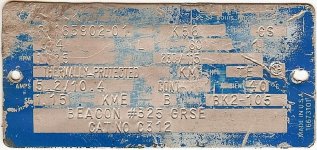

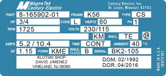

As I mentioned before for those interested in doing there own badges, I'm always trying to reinvent a better mouse trap or at least a more efficient way of doing these, more on that later.
In the mean time, I managed to finally finish a motor rebuild, a 1990s Century Electric 3/4hp motor, by installing a reproduced badge on it. For this one I removed the old one and scanned it. The upper left area was pretty beat up and couldn't make out anything, especially the Century Electric logo. The rest of it was straight forward to trace in Illustrator, however the upper left I had to research online similar badges of the period to get an idea on how it looked. Apparently Century Electric went through a number of acquisitions in the later half of the twentieth century. All said and done, I managed to reproduce in Illustrator a close facsimile of the original badge. The print surface on this badge is shear which makes all white colors clear for the aluminum to show through, finish is matte.
In the blank field at the bottom of the badge, I decided to include my rebuild information for this motor.

Here's a scan of the original badge and the reproduction.

Any thoughts on how to reproduce the punched model number on these tags?
Jay
The original punched numbers, I believe done with reverse number punches punched through the back to produce the raised look on the front. I'm pretty sure given the time and resources that can possibly be reproduced. However the major hurdle is the thickness of the new aluminum at .045". You would need a commercial press in order to achieve this, if possible with the thickness.
The only solution is standard number punches on the face. First I don't currently own a 1/4" number punch set. I believe that's the dimension on the original. Second a jig of some sort would have to be devised to hold one punch in order to punch one character at a time, then either move the punch over or move the badge over to the next character and still keep it in alignment. Punching would have to be achieved with a hammer or arbor press.
I've been toying in my head of such a device using my 1 ton HF arbor press I have. At work the Lock Shop next to our Carpenter Shop has two punch press machines similar in function. The table advance to the left with each downward press of the lever. The character is set by rotating the wheel. One of these goes for over $1000 with only one wheel, however the largest font size available from this company is 5/32" or 3/16" I believe.
Using a 1/8" wheel set I have used the above machine to punch the blank fields in my etched brass rebuild badges. I just need to create something that will be repeatable and efficient. Again, thank you-David
EDIT: One other idea is to have these engraved.
