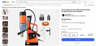

Not sure how to make a link off Amazon, but this one
167
VEVOR Mag Drill Press, 1300W 1.57" Boring Diameter, 2922lbf Power Magnetic Drill, 0-700 PRM Forward and Reverse Tapping, 10-Speed, Electric Drilling Machine for Metal Surface and Home Improvement​
  1. VEVOR Mag Drill Press, 1300W 1.57" Boring Diameter, 2922lbf Power Magnetic Drill, 0-700 PRM Forward and Reverse Tapping, 10-Speed, Electric Drilling Machine for Metal Surface and Home Improvement

Well, I finally talked myself into buying the drill in the link; between the 27 lbs, wide speed range and finding out I had more "reward" points saved up than it cost, it'll be here about April 8-10. What can I say, the flesh is weak :geek: ... Steve

Sumboodie, same one I just ordered; claims to handle up to 1-1/2" cutters -
Walkers, I believe you're right; but I bought a SECOND one, guess my wife's right about the OCD thang :dunno: ... Steve

In that price range, I would probably choose this one
It has the longer stroke range (easier to switch between twist drill and annular without running out of range)
Slightly more powerful motor so it might last longer , Also claims up to 2" annular.
Doesn't come with cutters, but most drills that DO (even the spendy ones) tend NOT to be sizes you'll ever use (at least for me :rolleyes: )
Your call, not everybody's as "****" as I am :unsure: ... Steve

The one in your link is $199...Vevor themselves has the same drill for $170.99? Very confusing :dunno:
Not really, just the way it is. Anything I buy from vevor I always price check Amazon & AliExpress. When I ordered my tube bender it was almost $100 less then both(Amazon & vevor website) from AliExpress & shipped from vevor in Canada.
