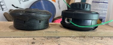

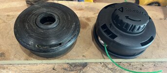

I wore the bump head out on my XRU09 string trimmer. It never worked that well anyhow. Ordered a hopefully better replacement. Makita does not sell individual parts for the trimmer head, but it's a universal design with a M10x1.25 LH spindle thread. Careful ordering from Amazon. Lots of **** and misrepresented products.
Hey @engineer2 !
We finally wore out the bump head on our XRU09 as well. Parts list is clear as mud as it looks like it could have come with up to 5 different style trimmer heads.
Through process of elimination, I think we have the B-05119 trimmer head. We need a new spool Item 4 and spring Item 3. All the parts listings come up as no longer available although I did find some new full heads. The end of our spool looks like it just wore thru completely and then the spring ejected and that was that.
What did you end up buying and how do you go about locking up the shaft so the assembly can be replaced?

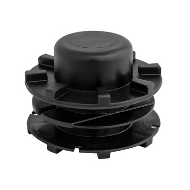

Here is picture of the new Makita B-05119 trimmer head
I found this Makita spool with a different part number but it has "B-05119" buried in the part number which happens to be the part number of the trimmer head I think I have....
A-89202 - SPOOL B-05119 - Makita Original Part​
No luck on the spring though......
Pictures of our worn trimmer head. I have cleaned out the spool and the bore is fully open to its tip

Good info! I bought a Makita 197296-3 Bump & Feed Trimmer Head, M10 X 1.25 LH from Amazon and it was the exact replacement.
Thanks!
That model number head appears to be scarce has hen's teeth just like my believed model B-05119.
I will call Makita customer service this morning. Wish one could buy direct from Makita.

Spoke with Makita customer service. Guy confirmed that the XRU09 trimmer has a M10x1.25LH thread.
He said that the original head was a 197296-3 like @engineer2 bought and not the B-05119 like I suspected.
Regardless, both of those heads are discontinued and individual parts no longer available.
The replacement head is 191R00-0 which claims to be an easy one to install new line. Align the triangle pointers, slip a measured length straight thru, find the middle of the string and make sure it’s centered in the head, then wind the knob.
Reviews on line are mixed. Found one at the orange box store for slightly less than $30.
Wife weed whacks, so I will patiently wait for her report.
Customer service guy said any head that has that thread form would work. Surprised he volunteered that.

My wife reports that this trimmer head works great. She says she likes the easy feed method compared to the prior that needed to be taken apart and carefully wound on the cartridge.
