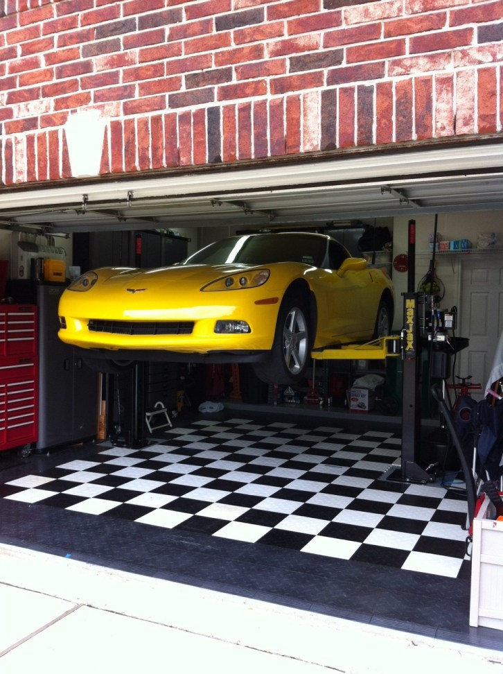

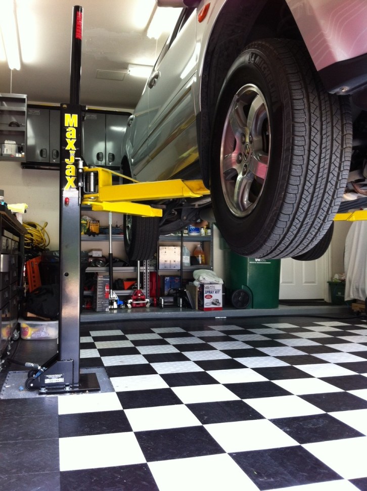

Here's a photo of a job done on the MaxJax this week:

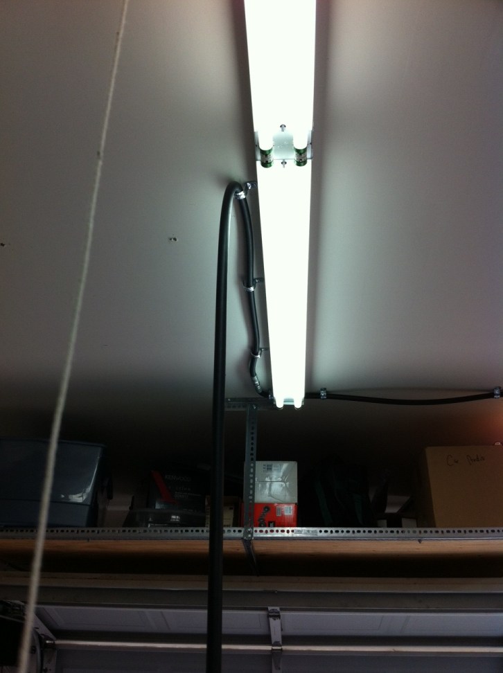

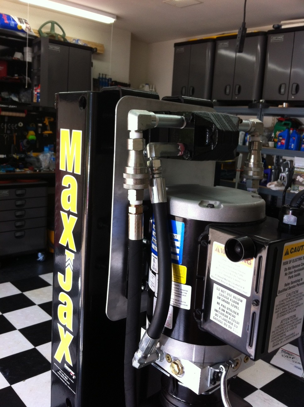

I am doing this now. I have mounted my divider and pump on one of the columns. I used the following parts.
1. 2 x stock hoses (14.5' each) - Left column
2. 1 x 96" hose - left column
3. 2 x 3/8" couplers to connect stock hoses and 96" hose
4. 1 x 60" hose for right column
5. 2 x 3/8" disconnect sets - These connect to the street elbow
6. 2 x 3" ****** - comes off divider and connects to street elbow
7. 2 x 90* street elbow - comes off ****** and connects to quick disconnects
8. 2 x 45* street elbow - Used on ram disconnect to allow hose to come straight up
I got my hoses at tractor supply and the other parts at www.discounthydraulichose.com
I created a mounting solution using some spring hangers I found at northern tool. http://www.northerntool.com/shop/tools/product_326674_326674. I had to notch the inside of it as the arms would contact it at full height and make the whole assembly lift up. :eyecrazy:
These hang over the top of the column. I made a mounting plate out of some aluminum sheet I had around. Here are some pictures.
I still need to mount the hose to the ceiling. I have seen no issues with having unequal length hoses after bleeding multiple times. I have a total of 37' of hose on one side and 5' on the other. Seems to work ok.

Nice post, Steve and good job! Could you clarify a couple of things?
Is the 96" hose for the left column just an addition to get the length needed by three hoses to go up and over?
How do you intend to hang the hose that goes up and over to the other side?
What did you order in terms of hose specs?
You lost me on the mounting springs thing! I like the post mount approach though!
Costs?
For the hose that goes to the other side, I'm thinking of going straight up from the column-mounted pump assembly to the truss that is conveniently located directly over that column, into a piece of conduit (rigid pvc?) that spans from the truss all the over to the other side, then have the hose exit straight down to the other column. I don't think I 'need' the pvc across the top, I just thought it might look neater than a hose lumbering and sagging across the great divide between the columns. I've got like 11 feet to cross. I was thinking of a single suspension wire at the middle of the conduit up to the rafter to keep the 11 ft pipe from sagging.
Thinking out loud here...

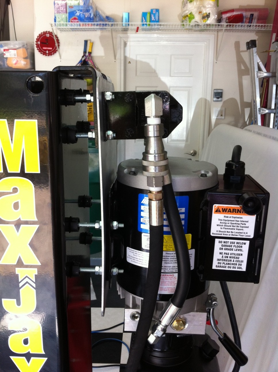

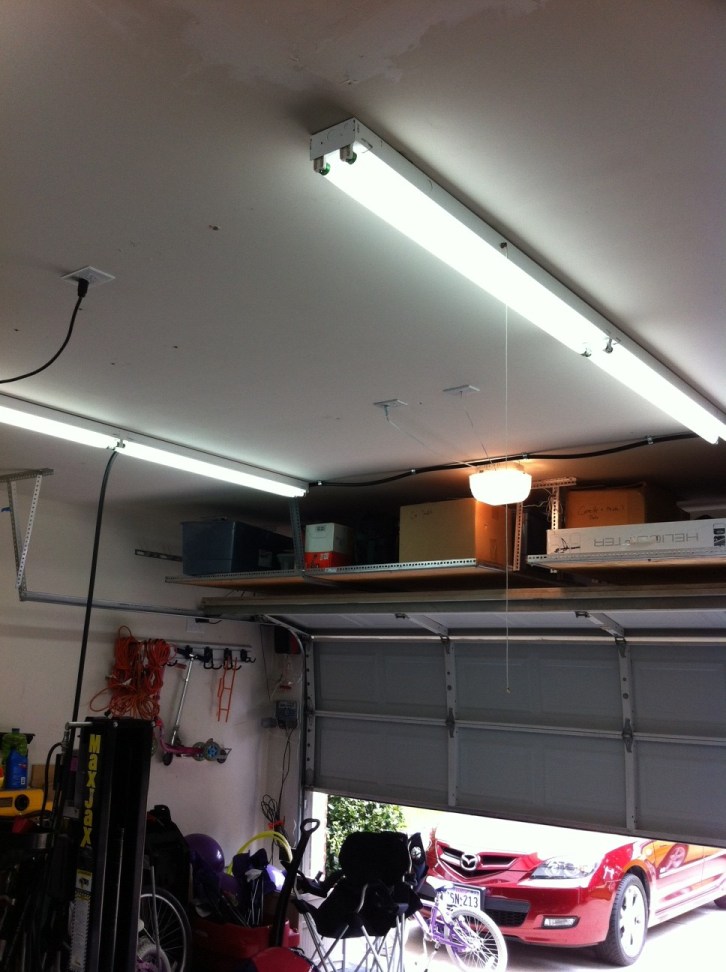

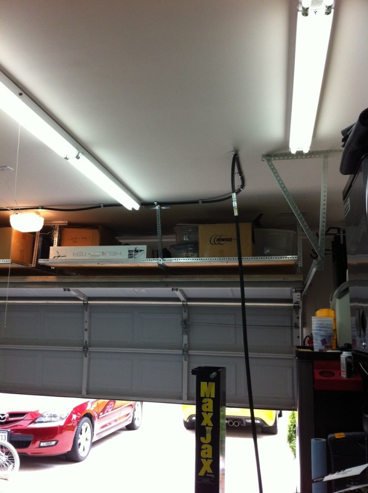

Heres what I did. I snaked the hose through 1-1/4" pvc electrical conduit. I picked the hose up locally for around $70.
olytdi
Dec 3, 2011
2,202
Olympia, Washington
The pic doesn't enlarge for me and is small:dunno:
From what I can tell this is a very clean install -- nice!
So, your power unit is wall mounted on the far side with the cross over to the near side, right?
what did you do in terms of the hose from the wall mounted power unit to the column closest to it? Does it come down the pump to the floor and over to the column?
thanks!
Mike007
Dec 4, 2010
2,623
thanks!
The picture should enlarge now.
Although not required, I joined the two 12' hoses with a hydraulic coupling for the sake of keeping the hose lengths close. I then spooled it up under the pump and then obviously it connects to the column right there.

Here are some answers:
In my case I could not go staight up and over. I have lights in the way so had to go up sideways, over, sideways and then down to the other column. I needed about 35' to do that so used the 2 14.5' hoses + an additonal 96" hose for a total hose length of 37'
I am not done but I am using drywall anchors into the ceiling and 1" metal conduit hangers to hold the hose. I plan on finishing this weekend and will post pictures.
They are 4000 PSI 3/8 hoses like these http://www.tractorsupply.com/hydraulic-hose-3-8-in-2-wire-36-in-l-1810018. Northern Tool sells silimar ones.

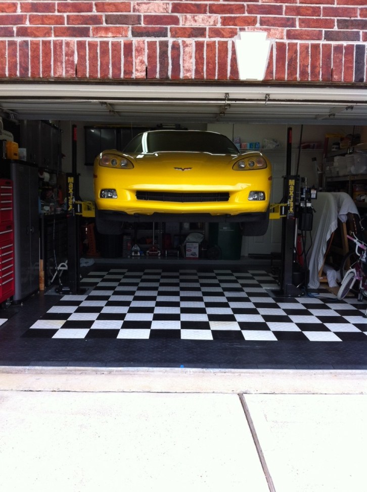

I finally got my lift completed with the hose routed to one side and the pump mounted to one of the columns.
Here is the hose routing:
Here are a couple of shots using the lift.
So glad I got this lift. I am able to get all 3 of my cars to full height. The only downside is I need to close my garage door a little bit when lifting the Honda Pilot.
Steve

Annual tire change and brake check on my HHR. I love this lift and it's so much easier on my back.
