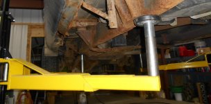

- Decided to place the lift to the right hand side, leaving more working space on the left. While the car is in place or on the lift, there is 4 foot wide walkway between it and the RH wall, even with the lift column in place.
- I have 3 cars currently to be lifted - '65 Mustang, '2000 Miata track car, and Dad's '51 Shoebox. I can do wife's driver as well if needed; my truck doesn't fit in the garage well anyway and I pay people to work on it ( it's an appliance to tow the race car and haul **** ) so not worried about working on it. Placing the posts 121" apart (outside of baseplates) works although I'm at the end of the arms to lift the Mustang on what passes for a frame on it. I wanted to be able to open the doors to the first detent in the hinge without hitting the column. The Ford frame is wider so it will be fine. The Miata is a little narrower but you lift it by the rockers so actually fits well.
