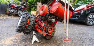

Okay, that's not the answer but it's better than most. My goal for this spring/summer is to simplify and sell off junk. So I bought a second Gravely. I don't know why I looked on CraigsList, maybe to see if I could just sell my broken Gravely. And there it was - second owner, the rare and useful 8 speed gearbox and about 25 years newer than mine.
For $200. Plus he had a tiller he'd throw in because he just wanted it to go to a good home since his kids didn't want it.
My original one quit working because the timing slipped. I tried to find someone local who would just fix it for me but the one person who works on Gravely's said it would be an expensive hassle so it became another project I did not need instead of a useful tool. $200 was less than the repair bill and the tiller (I already have one) was worth that.
And that's how you end up with two vintage tractors...
I was never able to use the tiller I had because my tractor was geared too high and you need a slow ground speed to do the tilling. Now I can till 'til Tuesday.

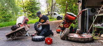

So once I got back from Mexico (that's another story) I pulled it out of the van and started swapping over the dual wheels and the restored brush hog attachment. The two are the same basic design but the new one has an updated carb, timing and a governor/speed device. Oh, and a choke. That makes a huge difference in cold starting.
He had the strangest way of starting it which I loved. He had an enormous 110v electric motor mounted on a sheet of plywood and he threw a fan belt over the pulley and onto the pulley of the tractor and then just pushed them apart until there was enough tension to spin the tractor motor. It was a brilliant and truly a farm style solution; what do I have to solve this problem right now with no additional effort.
Since I've gotten it home I've had zero issues starting it via the pull start. First pull every time. I am not going to touch a thing on this less my "fixing" breaks it. I need to adhere to the farm adage: If it's not broke, don't fix it.
Then again when I got the first one it came with all the parts to add an electric start and I'm tempted to install it just to get them off the floor. It adds a bit of weight but if the tractor has sat for a long time it makes starting easier. Jury is still out on that since it's another project...

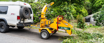

Part of wanting to get the tractor going was to continue to clear the property. I've mostly eradicated the blackberries and so I use yard work as a way to get away from the computer for a break. It's also turned into date weekends because Katie loves gardening and helping me.
Look at those arms. I've been lifting weights for two years and I don't have arms like that. Wtf?
I rented a chipper for our last date - I'm very romantic that way. Girls love chippers. Drives them crazy.
Renting a tool is a good way to motivate yourself to finish something since the clock is ticking. We got rid of most of the downed tree limbs that were left, cut down a lot of brush and generally did a lot of thinning and clearing. Next work date is to finally clean and repair the trailer after Lara's stay. Then take it out for 4th of July and decide if we want to keep it or sell it. If I sell it and the motorcycles in that black trailer I would consider taking out that upper driveway and converting it into a garden. It's already leveled and gets good sun.

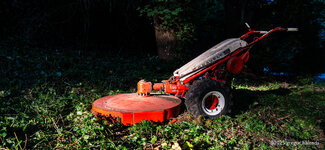

The new tractor is setup with the old (restored) brush hog blade and it's so much better with the 8 speed gear box. It will really crawl now which makes eating the blackberries and thick grass/weeds much easier. I came home from the gym, already sweaty, and decided to just take the tractor and cut the front down as another form of therapy - relaxing and meditative and it made me so happy to just do this one thing. It occurred to me that tractors are like girlfriends - you can't explain how awesome they are to people that don't have them...
Having both is pretty great. I'm very lucky right now.

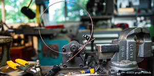

She decided she wanted to build a "fish lamp" and she asked for my help. I have always wanted the shop to be a place where the kids could explore but it's not worked out that way. They know it's a place where I can make anything but it's not had practical applications for them. That's changing. I told Nadia she needed a sketch before we could start and so that's our starting point above.
We talked about using dowels and sticks or wire but in the end the "wire" that I had the most of was welding wire. We started with 3/32's wire and just started bending it with our hands. Then we moved to my slip roll/circle bender.
This gave us smooth, repeatable bends. Sadly, I was not in the "photo" zone while we were working on this and only shot a few photos of the process because I was focused on helping. And my help was mostly the welding.
And by welding I mean bronze brazing. I decided it would be easier to braze the rod together because the bronze had a lower melting point which saved me the trouble having to be super careful with heat. The bronze also flowed into the joints which we didn't bother to prep other than snipping them to the right dimensions.
Nadia cut and bent the rod and I brazed it. We built a "fin" to test our plan and see if the process would work.
With that success we moved on to the frame. No process shots, sorry. It was a lot of us both wearing welding hoods and holding things without burning our fingers. We moved fast as she put this off and we only had a few days.

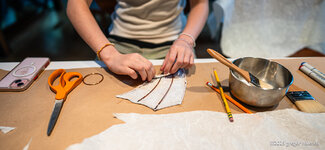

From there we moved to the paper covering. The original plan was paper maché but we skipped the flour and went with hand made paper and archival glue so it wouldn't yellow.
The test fin again.
