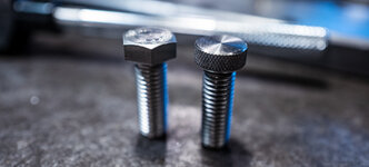

While I was in Colorado I got a call from the coffee roaster that I had done work for before. He wanted me to make another burner solution for his giant Probat. While I need to be working on the BMW the money would be helpful to pay for the those new forks I just bought.
In the process of trying to support and drill the very long wands for the burners I realized that I have always just supported material with pieces of scrap and that if I took just a few minutes I could make a machinists jack.
I didn't want to make it complicated so I took a 1/2-13 stainless bolt that I had and chucked it up in the lathe and turned down the flats.
Stainless is hard to knurl but this scissor style knurler does a decent job by allowing you to put pretty heavy pressure on the material without pressing hard against the bearings in the lathe. Use lots of coolant and blow the chips out as it turns.
The base is just a chunk of turned down 303 stainless. 303 machines easily but can't be welded so I keep it around for spacers, or for just these sort of projects. Now I can position this tiny jack under the work and clamp it down far outboard of the vise. It's a small thing that I've been meaning to make for a while.
The other thing I needed to fix was my bench vise. It came on my welding/fab table and while it's pretty clapped out it's always worked so I've just lived with it. Yesterday I couldn't get the rotation to clamp so I finally decided to do something about it.
Both the captured wrench and the bolt were pretty hammered but the bolt was the worst offender so I decided to remake that. I simply bought a stainless bolt of the same size and drilled a hole in the head and turned a piece of stainless bar stock to fit, welded it on and then cleaned up the weld. Since the wrench was wonky I then machined the flats of the bolt down to fit the wrench. The bolt is not english or metric but "Vise Wrench No1" sized.
Those two small shop improvements made a big difference to finishing out the new burner yesterday. Today I want to buckle down and finish them so I can get onto the bike.
