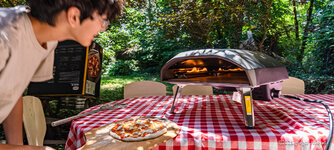

Summer has been busy and I mistakenly suggested to the kids that we start a pizza popup for their summer job. i-KK7XjnG-X2.jpg
We are still using the Roccbox but we picked up this Ooni to test a theory. It doesn't have the mass of the Roccbox but it has a larger surface and it has two long burners that cover two sides. Ironically the pizza we like the most at this point is from the recipe that I developed for our home oven which has convection broil. I'm not entirely sure what makes that better - the 1/4" steel, the convection or the lower temperature that is possible.
The Ooni can go lower than the Roccbox and I bought a 1/4" steel plate to replace the stone. This was our first test with it just stock but at a lower temperature - about 550-600F compared to the Roccbox's 650-750F. I'm convinced that steel is better for pizza than stone but I need to test the theory in a pizza oven. I know it works better in a home oven as I've tested various stones and also steel in thickness of 1/2", 3/8" and 1/4" and 1/4" is the sweet spot. It recovers fast and gives the heat quicker. Not sure why.
So next is to put a steel in the Ooni and see.

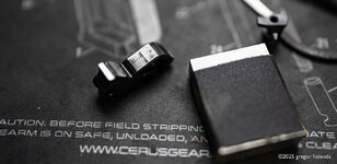

So one of my goals has been to just get back into the shop. For all the reasons. Working in the shop is a place where things make sense and taking things apart, making them better and putting them back together is satisfying in a way that few things are.
I've been shooting for most of my life and I've always enjoyed it. Machines are functional puzzles to me - there are all these different shaped pieces and they only fit together one way but unlike a traditional "puzzle" when the parts come together you have something useful. That can be a car, a motorcycle, a bicycle or in this case a gun.
I've competed in Bullseye for as long as I've been in Portland and I've enjoyed the people and sport of it. Most of my guns are either related to that or inherited from my father. I wasn't looking to get anything new until Oregon proposed a magazine capacity ban of 10 rounds. I didn't have a gun with more than 10 rounds but the idea of not being able to have one set me looking for something that had more. Not sure that was how the law was supposed to work.
Anyway, I ended up with a Sig P320 on a whim as I liked Sigs and it seemed interesting. While I was at the store the salesman showed me a CZ Tactical Sport 2 which was heavy, solid and built for competition. The Sig turned out to be a dud with a lot of malfunctions and so I went back and ended up with the CZ based on a club members advice. He shot practical pistol matches and they seemed interesting. Our bullseye season is only in the winter so I was curious. Besides, it's a competition gun and I love things built for competition.
I ended up trying out a practical pistol match and despite being good at bullseye I was downright bad at practical pistol. Humiliating. I hate being bad at things but I love getting good at things so this experience was fairly captivating. Also, I really loved this gun. I can't explain why but it sort of reminds me an old BMW motorcycle - well made, simple and extremely effective and reliable.
Which is just the sort of thing I want to play with and modify.

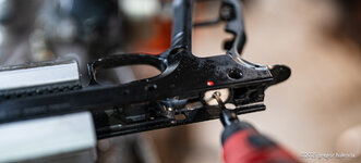

So of course the first thing I did was find some scrap aluminum and make a work stand for the gun. There are ones you can buy and making one breaks my "don't make what you can buy easily" rule but my larger goal was to spend meditative time in the shop.
I had sent the gun out to have the slide milled for the red dot. I contemplated doing the work myself but having not spent much time in the shop I was a bit concerned I might screw it up and that would scrap the slide. The place that does the work has a CNC that matches the dot profile perfectly.
The other part of this is that I've wanted to take my Pardini apart for a few years but there is zero information or guides and it's very complicated. The CZ is the opposite. There's a dozen YouTube videos that tear the gun down and it's a fairly simple design. I've never taken a gun completely apart before and I wanted to do that.
It was fairly straightforward and also very enjoyable. Unlike the rest of the world at the moment this all made sense. The other reason for taking it apart is that when the slide was milled they ceracoated it to protect the steel but they didn't mask off the rails. This made the gun tight and it malfunctioned a lot. I'd already sanded and smoothed the rails but I was still having some problems so I thought I'd go through it and basically blueprint it.
Also note that I'm using two of the hammers that I made for Lucas. Neither of them were right for the job... (that's foreshadowing)
After taking it apart and then putting it back together I decided I was ready to actually try to improve it. So the first thing I did was establish a base line trigger weight which was 2lbs 1.3 oz. Not sure why but triggers are generally weighed in english and not grams.
Then I cleaned the bench, gathered and organized the tools and colored on the parts diagram every place where metal touched metal and there could be friction.
Being careful to avoid the sear/hammer interface which controls how and when the gun fires I sanded and polished all the parts on a surface plate going from 400 grit to 1500 and then to the polishing wheel. Some of the deeper machining marks were left to make sure I didn't take off too much material.
I used a small dremel which was not adequate and that got me to finally fix the broken Foredom footswitch that had been gathering dust. But the dremel was small enough to get into the frame and smooth areas that contacted the trigger bar.
The aforementioned hammer and sear are the two parts that make up how a gun goes bang when you pull the trigger. There's a lot of warnings about not modifying them so of course I did. Not to change their geometry but just to polish their faces. I used sandpaper on a machined block to keep things square.
And I used the lathe/dremmel combo to polish all the pins where anything pivoted that might create friction.
It was incredibly satisfying to polish all the internals. It's low hanging fruit, things that aren't cost effective for the factory but that when taken together can make a noticeable difference in the overall feel of the action. Everything was polished to a mirror finish.
So without any spring or parts changes I took the trigger weight from 2lbs 1.3oz to 1lb 13ozs so a 4oz reduction and a much smoother trigger. And the trigger on this gun was already very good - but now it's better. It doesn't feel lighter and my other competition guns also have triggers around this weight so it doesn't feel light to me. It just feels smooth.
This was a super enjoyable project that was relaxing and satisfying and I'm looking forward to doing some more gunsmithing. Sadly the gun won't make me a better shot (only practice will) but at least I know it's not giving me any excuses.

I find this interesting too. I had always heard that the porous nature of pizza stones was what made them work so good, that and their heat holding qualities. The porous stone is supposed to let give the steam a place to go so the crust gets crusty, but considering it's Gregor and all, you DO got to wonder. Experience trumps theory often enough.

Curious, what kind of 1/4” steel are you using for the Ooni? You said it recovers better. What are your thoughts on why it’s better than the stone? Does it seem to cook the crust better because it gets hotter?
Just mild steel - A36 I think. I bought a sheet from a metal wholesaler but I've not cut it to fit the Ooni yet.
In the home oven I started with a stone because that's what everyone says to do. Which is probably because pizza ovens are made of stone so that has to be best right. I think that stone is slow to give off its heat.
I'm going to cut that sheet to fit the Ooni and then bake several pizzas both ways and see what happens.
BobL.
It might **** moisture out of the crust but I've not experienced that. The steel seems to put the heat into the crust fast which makes it crispy. I'm not an engineer so I couldn't tell you why 1/2" seemed to not work at well as 1/4" - maybe it's a balance of thickness to recovery? To be scientific you'd really need to test all this changing one variable at a time.

It's all about thermal conductivity and thermal mass.
Your 1/4" plate will heat up to desired temp quicker, recover quicker, and is likely transferring more heat to the crust.
In theory the 1/2" will hold the heat longer. In practice you're probably in a rush to get it hot and start slinging pizzas. I know I would be!

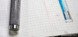

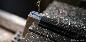

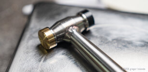

So I teased that I needed a hammer. I've made a few for Lucas and the small ones were too small to be useful. They couldn't easily knock out the pins on the CZ.
Those are probably 1/2" 304 stainless. So I wanted to make something new and I wanted to make the faces changeable. It had to be larger and a bit heavier and I wanted to try to make it a dead blow. Mostly because I went down a rabbit hole of "machinist hammers" on Google and there were a few nice ones but no dead blows.
There's that third hammer - made from aluminum. It's both too light and too large. And the tiny one behind it - way too small. I need a goldilocks hammer. So in my stock bins I find a bunch of 1/2" and 3/4" 304 stainless. The 3/4 seems like the way to go. 3/4 is conveniently 19mm which is a nice number. Also a 12mm bolt has a 19mm head so I could just buy a few stainless bolts and turn them down. And I have a M12x1.75 tap and die already.
None of the machinist hammers I found on the inter webs are pretty or cool looking. In fact I don't think the ones I made are "cool" looking but I decide that this hammer should be the coolest looking machinist hammer in the world. Small achievable goals. So I decide to make the head 19mm and make it with tapers and chamfers so it feels a little modern.
At this point I realize that while I can buy a 12mm stainless bolt there are no Delrin or Brass 12mm bolts - at least at the hardware store. And while I could try to cut the threads with a die this was a good opportunity to single point the threads on the lathe. When I bought my lathe it came with a handful of gears but not the 127 gear which you need to cut metric threads. It took me over a year to find one. I have all the gears now.
A lathe is sort of a giant multi threaded screw. By changing the those three(four) spinning gears you can change the feed/speed of the carriage to be the same as the pitch of a screw. It's quite cool and fairly tricky to do. It's like "Lathe 301" to single point threads.
So the left hand side charts are the combos of gear, switches, levers and whatnot that make up the various screw pitches. That top chart was not on my machine. I found a photo of a lathe that had metric gears and I copied it and then remade the chart but with my own text in the small box below so each time I needed to do threading I could remember the process. I had it screen printed on an aluminum plate to match the stock one and tried to match the typeface too.
At this point I also realized my lower gearbox was low on oil...
I didn't take any photos of the thread cutting because I was attempting to shoot video (and next I'll attempt to edit it) and because I just about destroyed my flip up thread cutting tool because I forgot that brass, while "free machining" meaning it doesn't need lubricant to cut, is also sticky as a fly trap and if you don't take tiny little cuts you'll **** your tool in and break something. Which I did several times.
So I cheated and used stainless bolts and then single point threaded the delrin and the brass.
I don't have a taper turning attachment (that search has been running for 10 years now with no hits...) but I use a drill to spine the compound at a super shallow (4 degrees) angle and while not ideal it works. My thought for the dead blow was to drill through the entire head and then fill it with shot.
My knurling is always something I get lucky with. I never have a plan or do all the complicated calculations you're supposed to do. Your knurls need to be cut like threads so the carriage is moving in a way that the knurl doesn't smash itself. I do a few light passes and just mess with the levers until it looks like it's not doubling. Then I crank it down and feed it across and back without disengaging the feed meaning I reverse the knurl so it's also cutting backwards. This seems to keep it in place.
My first end cap I knurled in place so that it was a "hidden" cap but I decided to cut the knurls off and took it down to 18mm and then had to turn the head and faces to 18mm as well. This way the stainless end cap is another hammer face.
The knurl above is pretty good. It's not perfectly clean and part of that is because I wasn't flooding it with oil and simultaneously using the air hose to blow the chips away so they didn't get smashed back into the knurl which is why they look a little fuzzy. But they are sharp and triangular. The bottom "cap" is the steel head for the hammer. I have no idea what I would put inside but I'm thinking snacks.
I considered tapping the head/handle and screwing them together but there wasn't enough material. I've not welded stainless steel in a long time so my welds aren't great but they're burly enough.
I used scotchbrite to remove the heat coloring from the hammer even though I did consider keeping it for a bit.
At this point there are bunch of things I'd change if I were to do this over. I did drill out the handle up to the taper to remove weight. The balance point with the heads on is just forward of the knurling. If I were to make another I'd open it up a bit more to 14mm and then single point or tap the threads to M 1.00 pitch so I'd not need as much depth. I'd also do a deeper drill into the taper of the hammer.
I think we've talked about this before but 90% of the load is carried by the first three threads, and 99+% by the first seven. I think the first thread actually carries 70% of the load. So more threads means I need less depth. An M1.0 thread would only need 5-6mm of engagement/depth.
So my tricky idea was that I ordered tungsten shot instead of steel. It's much heavier so I need less and or can make it heavier in less space.
The whole hammer weighs 275 grams which is heavier than I'd like - not much but a little. The tungsten is 14g and I'd like it to be more. If I went to 14mm I could lighten the whole thing a bit and then also have room for more tungsten.
But I'm happy with it. I didn't expect that 14g of tungsten would have a very noticeable effect but it does actually keep the hammer from bouncing. So that's very cool. It transfers force much better so you need a lighter hit to knock out a pin so that's another win.
I really enjoyed making this and if I had a CNC and some drafting skills I'd consider refining it and then making a short run of them. I really need to find a job shop here in Portland that I could establish a relationship with. I'd love to start to make and sell a few things. If you know of a shop that might be a good fit let me know.
A second round iteration would make it perfect I think. Maybe I make another in one size up? A 1" or 25mm head/handle would be the ideal size for the mill and I don't like the soft blow I'm using currently. But is it the "coolest looking machinist hammer in the world?" Hmm, not sure, but it is exactly what I was hoping it would be and I like it better than any other I've seen so for me? Yeah.

"I think we've talked about this before but 90% of the load is carried by the first three threads, and 99+% by the first seven. I think the first thread actually carries 70% of the load. So more threads means I need less depth."
While this is true, with your head tight against the body almost none of the load goes thru the threads, as long as the head stays tight.
Nice hammer. I still have the one I made in HS shop class, and it has some of the same issues you ran into. My head was too light for the handle, so i hollowed is as much as I could. I never put a cap on it to hide my "snacks" in, nice touch.
