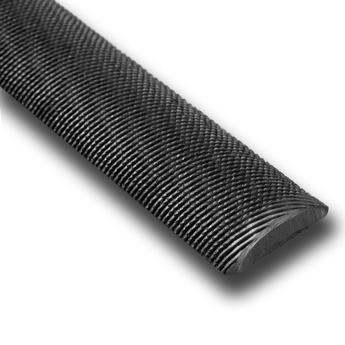

If I am removing the nozzle to clean I will just use a ¼ " rod and push the splatter out starting from the threaded end. I will also use a band saw blade that has been ground down into a taper to scrape out the nozzle while using. I just use regular side cutters to cut the wire.
I do have a couple pair of mig pliers that I never use.
W
Wamsutta
Jan 8, 2014
10,861
Amarillo, Texas
Why though? A cheapish normal or half round ******* file does the trick. No special tool required
It's the same thing as a regular half round file, but it only has teeth on the round side. The idea behind that is so you can use the file without taking the nozzle off. The flat smooth side of the file won't harm the contact tip. But the thing is, I'd be taking the nozzle off anyway.
scooby074
Oct 26, 2008
5,229
Nova Scotia
you use the file tang to knock off the **** . no need to remove. I almost never remove the nozzle unless changing tips. use tip dip
files knife edges get used to remove slag from the weld etc where wire wheels fail to reach. Deburring etc.
ive been around a ton of welding professionally , including working in heavy fab and never came across the special smooth welders files
Edit. OK. I had to look it up. Its only a 4" file??!!? That thing is ridiculous. $13.50 Who buys that? Everybody carries a 10-14" standard half round file
