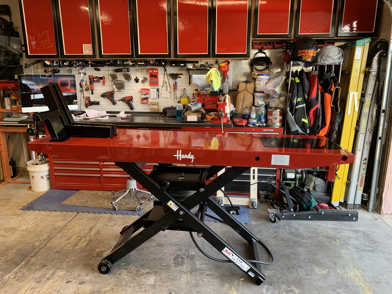

Woohoo finally got me a motorcycle lift. :)
Very nice. Glad to see you went to the top shelf of motorcycle lifts, you won't be disappointed in a Handy, although they are a different company than the originals.
I've had my original Handy for nearly 25 years and my new SAM 2 for nearly 2 years now. I really like the SAM 2 where I can drop out the lift for tire replacement but the original has seen a lot of projects over the years. You'll love the drop out section.

I looked at the SAM2 real seriously but ended up with this one. The air bag is different, it's real bouncy until you let some of the air out and lower it on back down on the locks.
They're both awesome lifts. I have the original Handy which is dimensionally identical to the new SAM 1200 with the differences being the SAM 1200 is an air spring or bellows style lifting system, has a rear wheel dropout and has 200 additional pounds of capacity.
I keep the SAM 2 setup in the shop for most use and will bring my original into the shop if I have a long term project but still want the SAM 2 for the quick in/out jobs.
The SAM 2 is great for doing either front or rear wheels due to both ends dropping but I really like the longer 40" ramp which is great for lowered bikes. That was one area I wanted to address as I was constantly dragging bikes loading them with the standard 24" ramp.
I really like the color of yours, I just went with the standard gray.
JasonJ
Aug 4, 2006
424
Las Vegas
Are you able to to remove front and both wheels at the same time? It didn't seem the Wheel chock aligned correctly to allow that, almost like it was one or the other.
zmotorsports
Oct 20, 2009
21,629
Northern Utah
On a standard wheelbase bike it's one or the other due to having to shift the bike slightly forward or rearward. The front wheel clamp can be mounted to the drop out front or the next bolt pattern back onto the center section for rear tire removal.

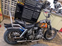

Great choice on the Handy with the drop out plate. They're work horses. My old one has the big pneumatic cylinder and still lifts my FLH with ease.
Your new Handy lift is making me want to sand and apply a fresh coat of paint, in gray of course, to mine. Yet another project to put on the 'To Do' list.
You can check out my progress on the 74 FLH and other stuff here: https://www.garagejournal.com/forum/...d.php?t=408052
