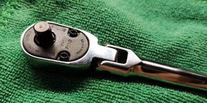

These are my 1/4" Snap-On's.
What you perceive as sharpness/uniformness of engravings is actually a focus/lighting issue. I think Koken stamping is if anything sharper and better defined. Here are two Kokens and a Snapon.
View media item 94070
Note also that Koken doesn't need to brag like Snapon does. The stamping is properly on the bottom rather than all over the head.
I'm not a fan of Snap-On's new stamping style, especially newest with "USA", plain stupid and ugly. Already there is a "USA" at the handle. Agreed, it's bragging. I prefer older style stamping: deep and sharp.
I don't know why they changed the stamping, the only thing make sense to me is: style change. Though there are metal deformations at the edge, the stampings on the head are still pretty deep and uniform.
From you picture, I noticed the following:
The Koken to the right has crude, industrial finish, the "Koken" logo is shallow and weak. Is the backing plate uneven? The flat part of the handle seems rough. The chrome plating looks much thinner than Snap On. Is there a part number stamped somewhere? Based on the workmanship (finishing quality), this Koken is a $30 ratchet.
The chrome on the ratchet to the left seems better, but still looks thinner and not as shinny (especially the head). The "MADE IN JAPAN 169" looks uneven, like someone punched on by hand. The white screw breaks harmony, it would have looked better on both side with a heat treated screw. The blacking plate lacks detail. Based on the workmanship, this Koken is a $50 ratchet.
This is Snap On, notice the recessed area at the screws, and the perfect stamping on the handle.
Snapon, direction switch finish quality: are you serious? Their directional lever "design process" looks like they finished the head, and somebody realized that it was supposed to have a directional level. So he spat on the head and they drilled the hole for the lever over the wet spot. Koken is superior here.
Okay so you're admitting that the Snap-On stamping has deformed letters, but giving them a pass because they're "deep"?
The Koken logo is shallow because it's stamped into the steel backing plate. However the stamping is sharp and clearly visible. The backing plate has radiuses ground into the edges - it's not uneven.
Your own photo showing a Snap-On backing plate shows that half the letters (including the Pat Pending) aren't even fully stamped.
Uh huh, you can tell the thickness of the chrome plating with your eyes. Give me a break man.
You cannot tell chrome thickness with your eyes. You can't. It's literally not possible, so stop pretending you can. Shinyness of chrome is an aesthetic choice. I've seen the shiniest most polished chrome on the nastiest cheapest ratchets. Chrome plating so thin it chips off the moment you pick the ratchet up.
The screw is not white. Harmony? Seriously? Backing plate lacking detail? Why does a backing plate need to be littered with words? Would you rather have the shallow, not-fully stamped and malformed letters the Snap-On backing plate has?
The Koken backing plate is secured by recessed screws coming through the other side of the ratchet. So I'm not sure why the back plate would need recesses.
