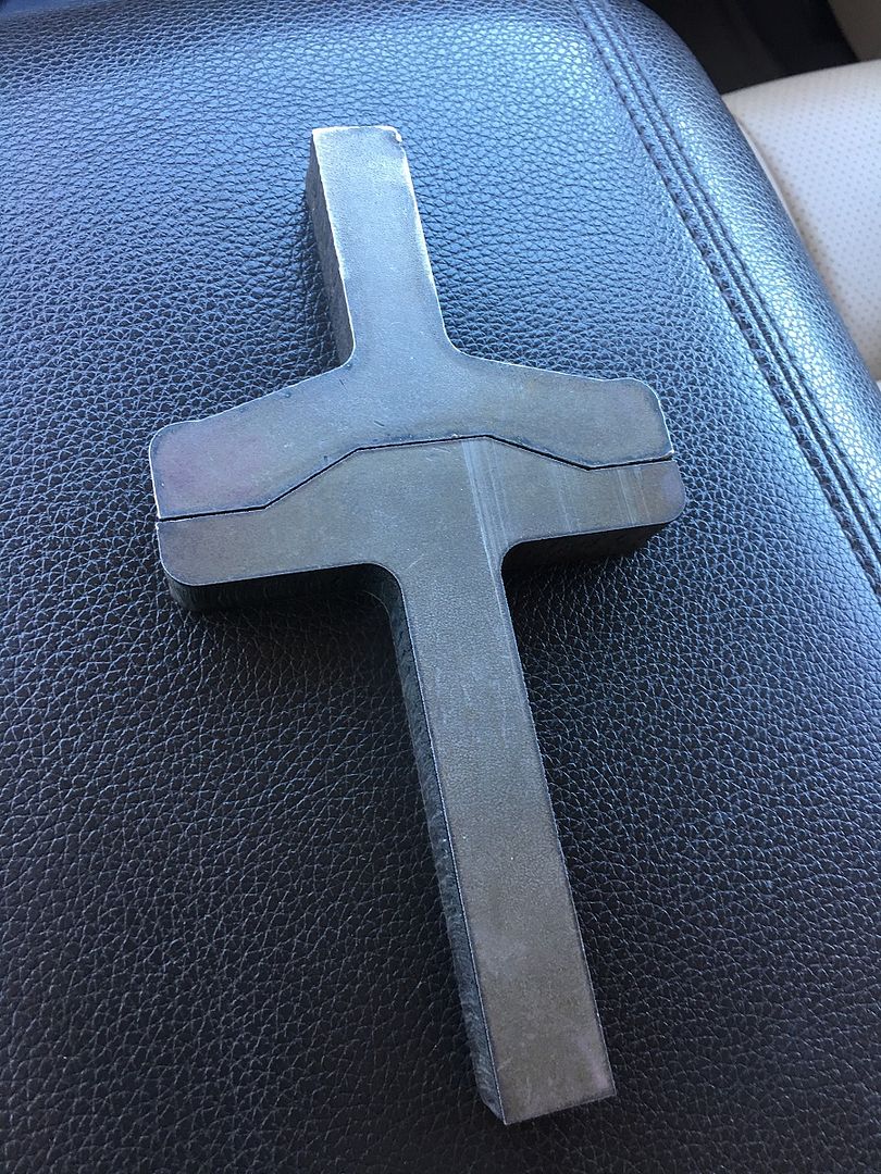

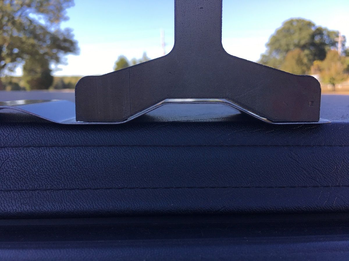

Picked up a new set of dies for the Lennox for a different shape...
here checked to the sample we were sent...
forming a 19 gauge sample on the Lennox:

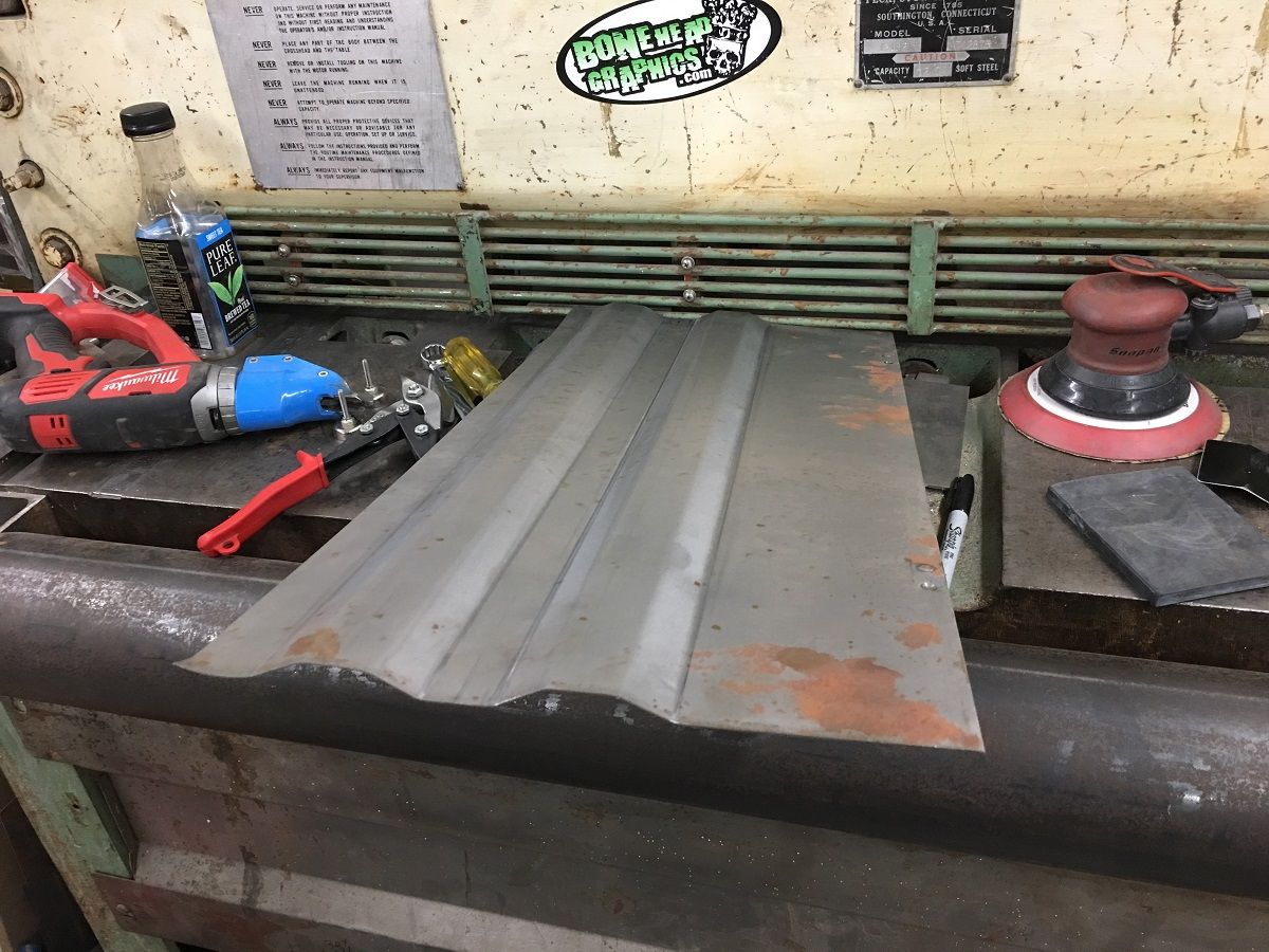

A buddy is using a 2008 replacement bed floor to replace the floor in a 66 Ford pickup. He has some ribs that stop in the middle and other that change width. So we’re going to make full length beads all the same width as per 1966 out of a newer part.

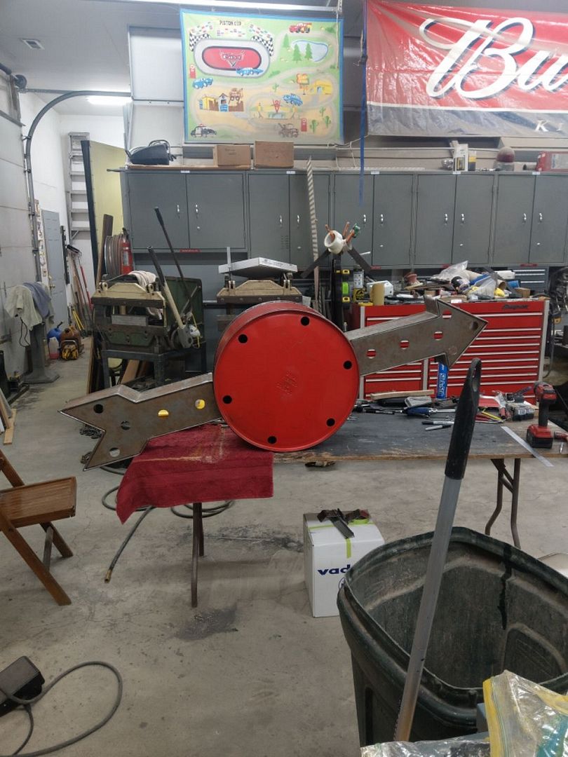

Mike has been plugging along on the Drummers Lounge sign, the arrow is close to done, it still needs fastening hardware added for the access panels, and holes added for the lights..

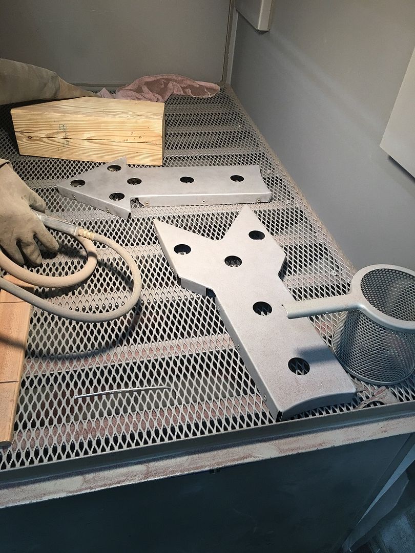

Meanwhile, Mike continues on the Drummer's Lounge sign, all the light holes are in place and he is media blasting...….
