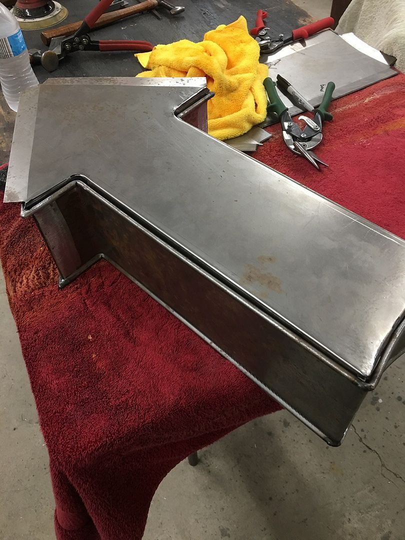

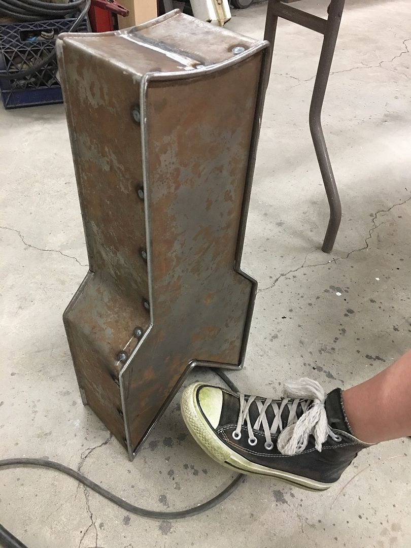

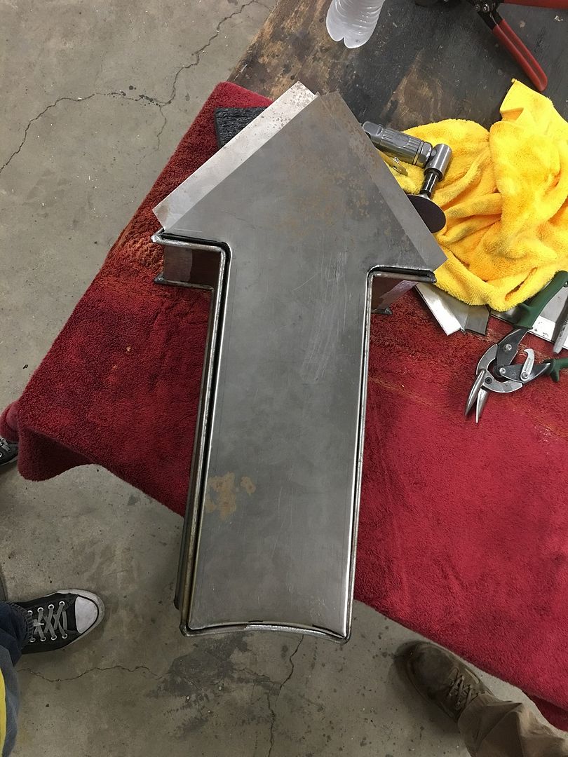

Progress on our arrow sign, we got one side of the filler panel of the tail plug welded in place. The other side will be held in place with pan head screws to allow access to the lighting components.
The point of the arrow is bent up, the corner radius is formed by stretching using the barrel end body hammer and a piece of steel angle as an anvil.

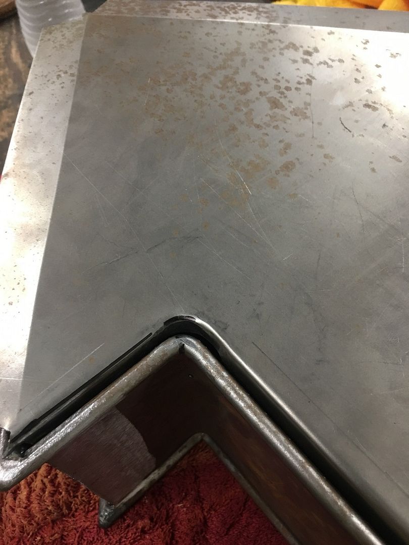

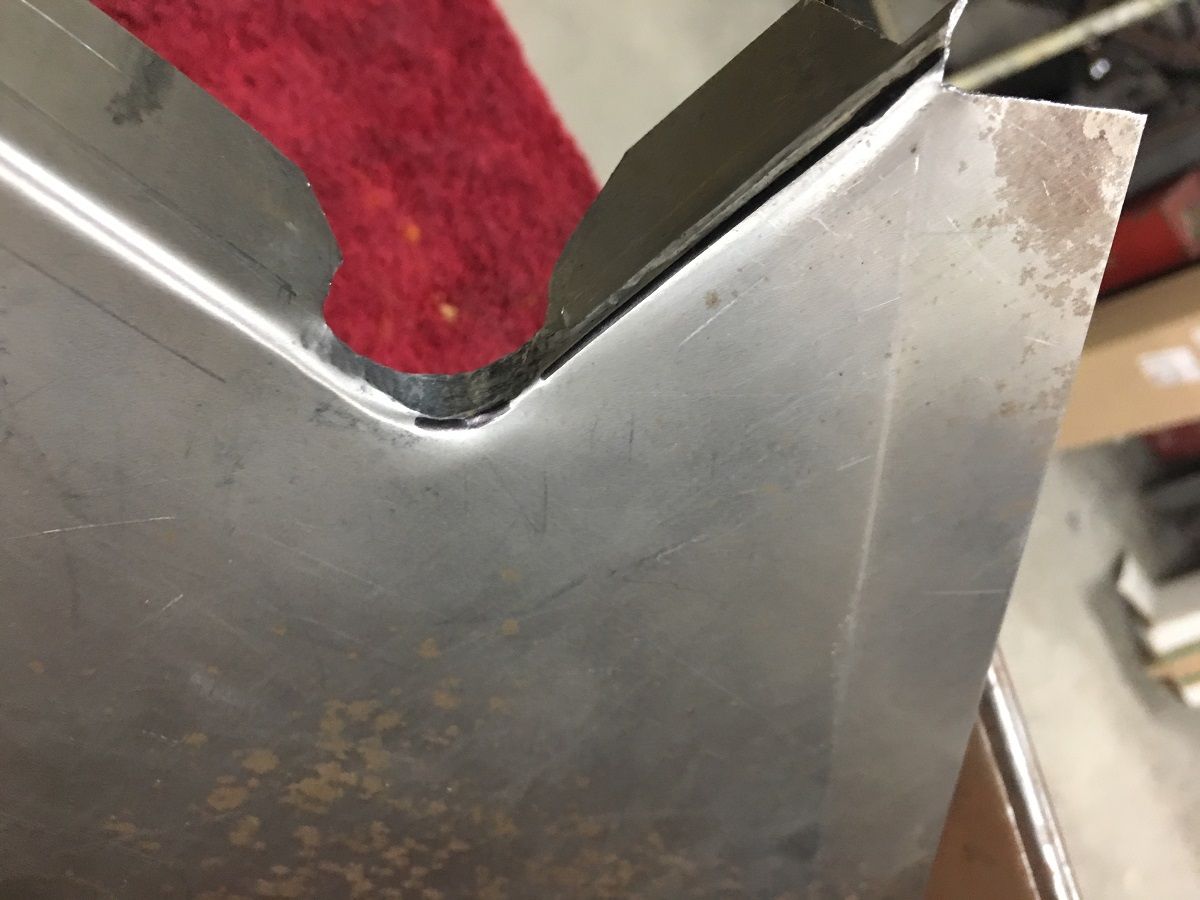

All ready for welding. Meanwhile, Mike has been working on the pointy end of the arrow, here stretching an inside corner to better fit the housing....
And adding holes for the plug welds....
