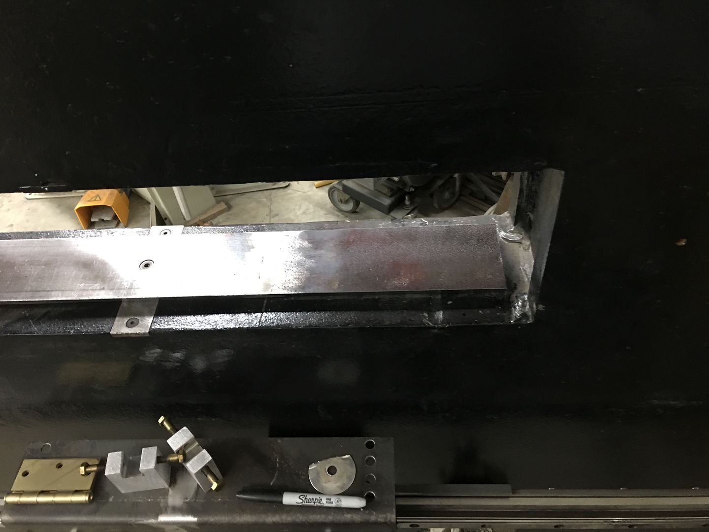

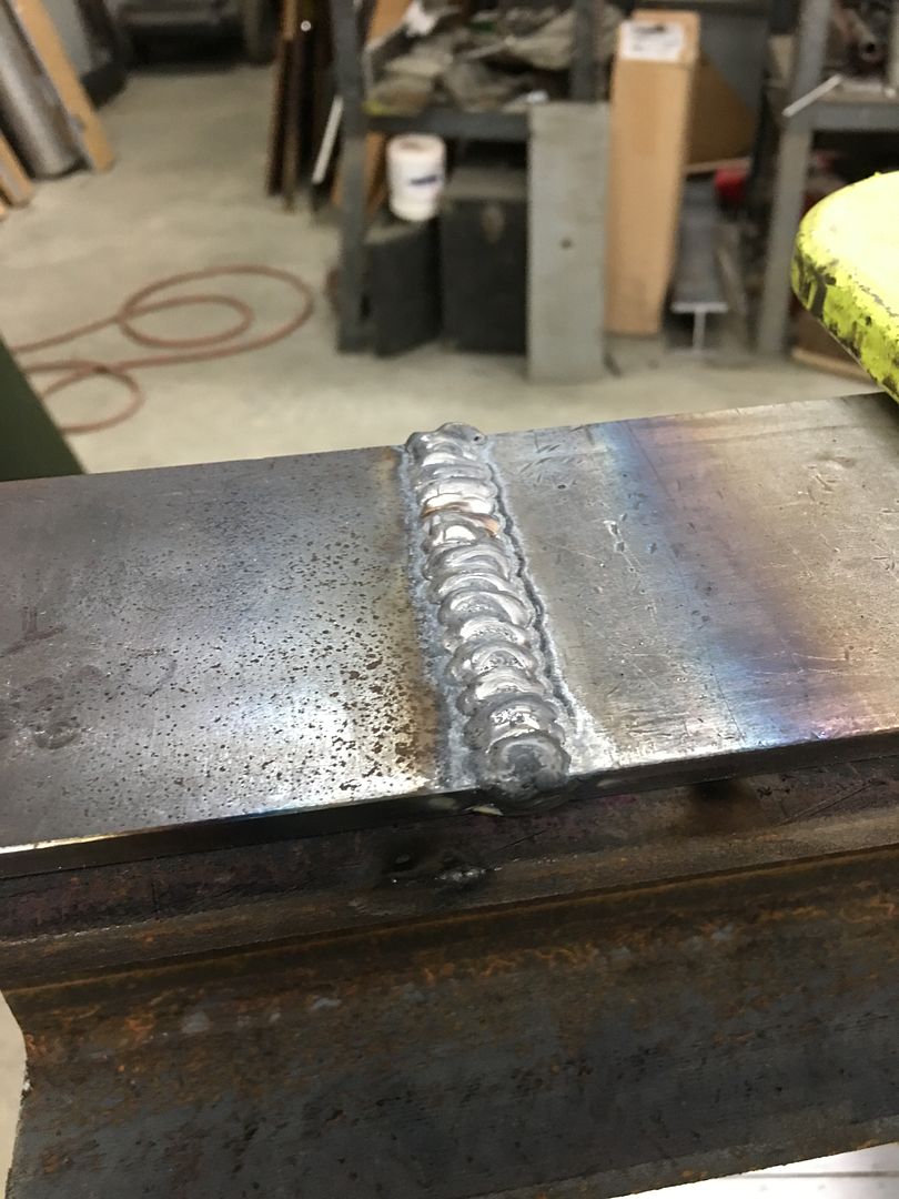

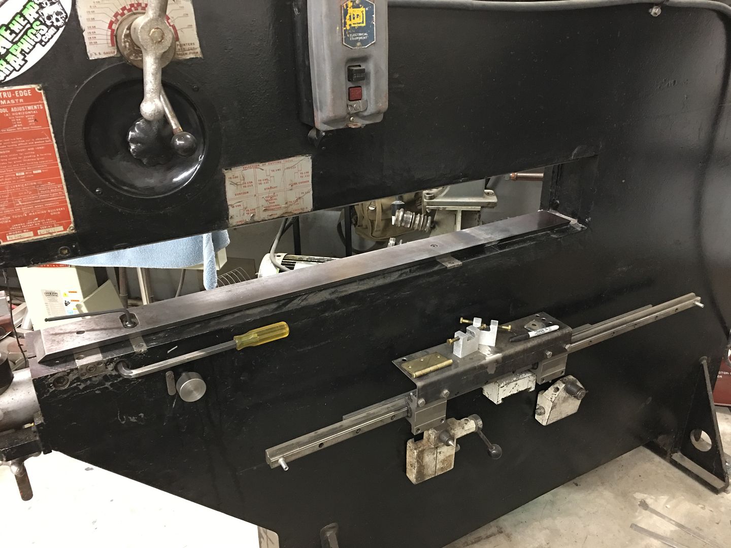

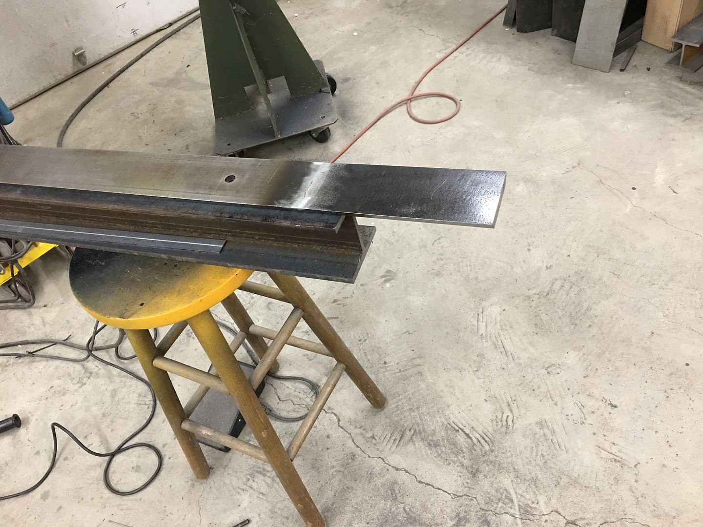

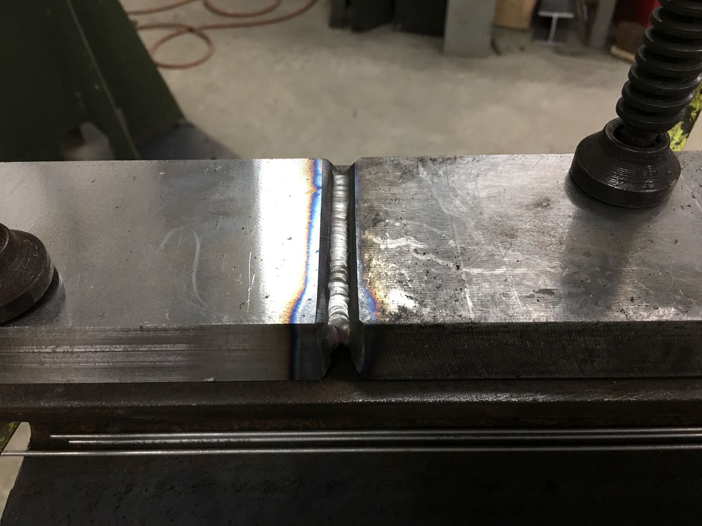

Last night was equipment maintenance of sorts... Finishing up our dovetail extensions on the Lennox Nibbler. When I had the set of dovetail extensions made we neglected to check BOTH the top and bottom. I pulled the top one off as it is used less frequently, and gave it to my machinist as a sample. As it were, the bottom is .045 thinner, and we just got this last piece back from surface grinding last night. Time to finish this job, all welded, cleaned up, and ready for the next louver job. The back edge of the dovetail to centerline of the dies is just shy of 48”. I think that will do us.
Final weld pass is not too pretty, but this side was "reflowed" to add some contraction for straightening the dovetail.

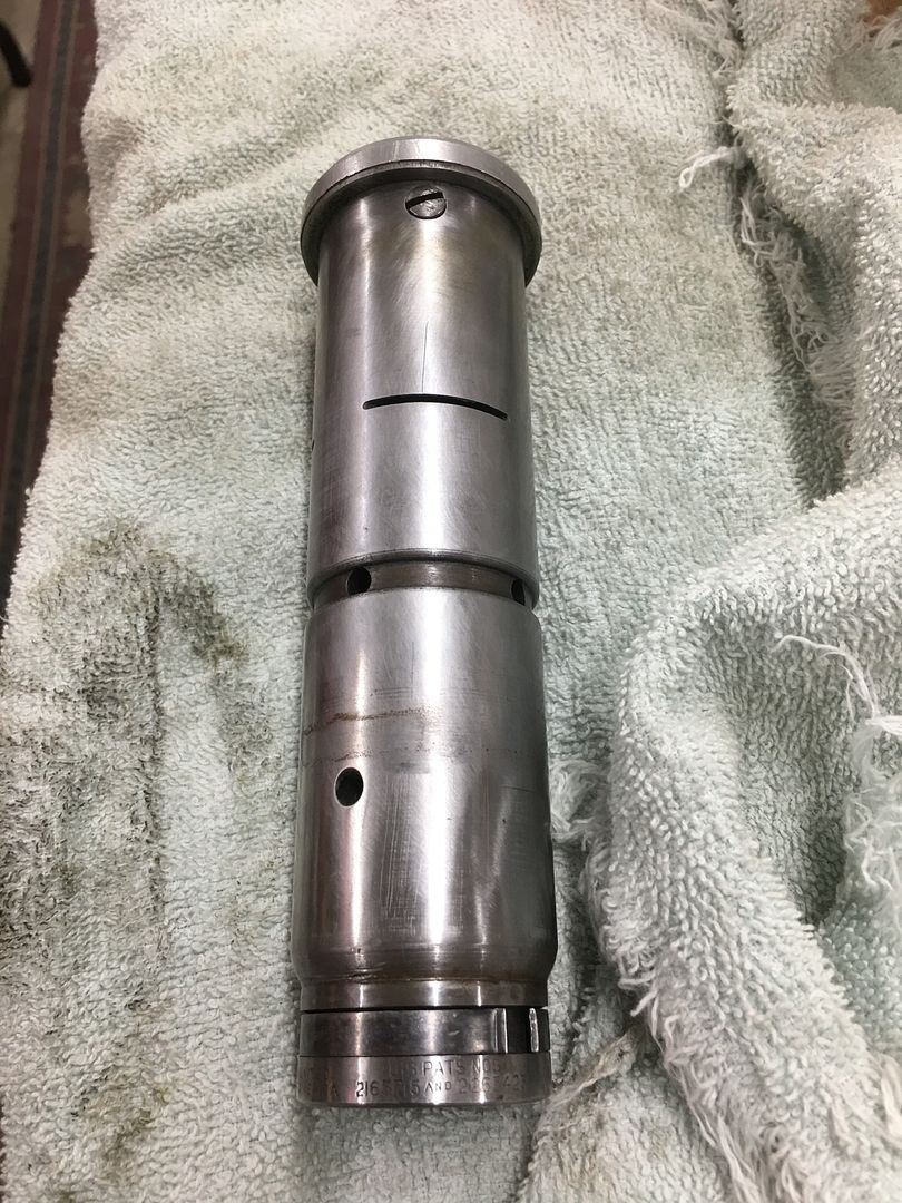

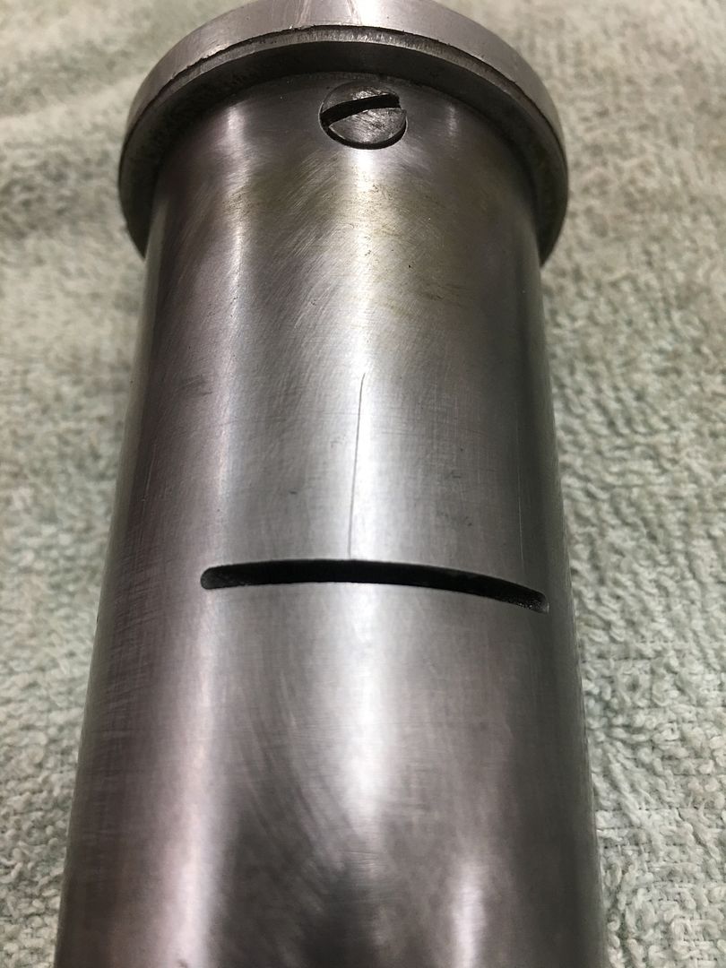

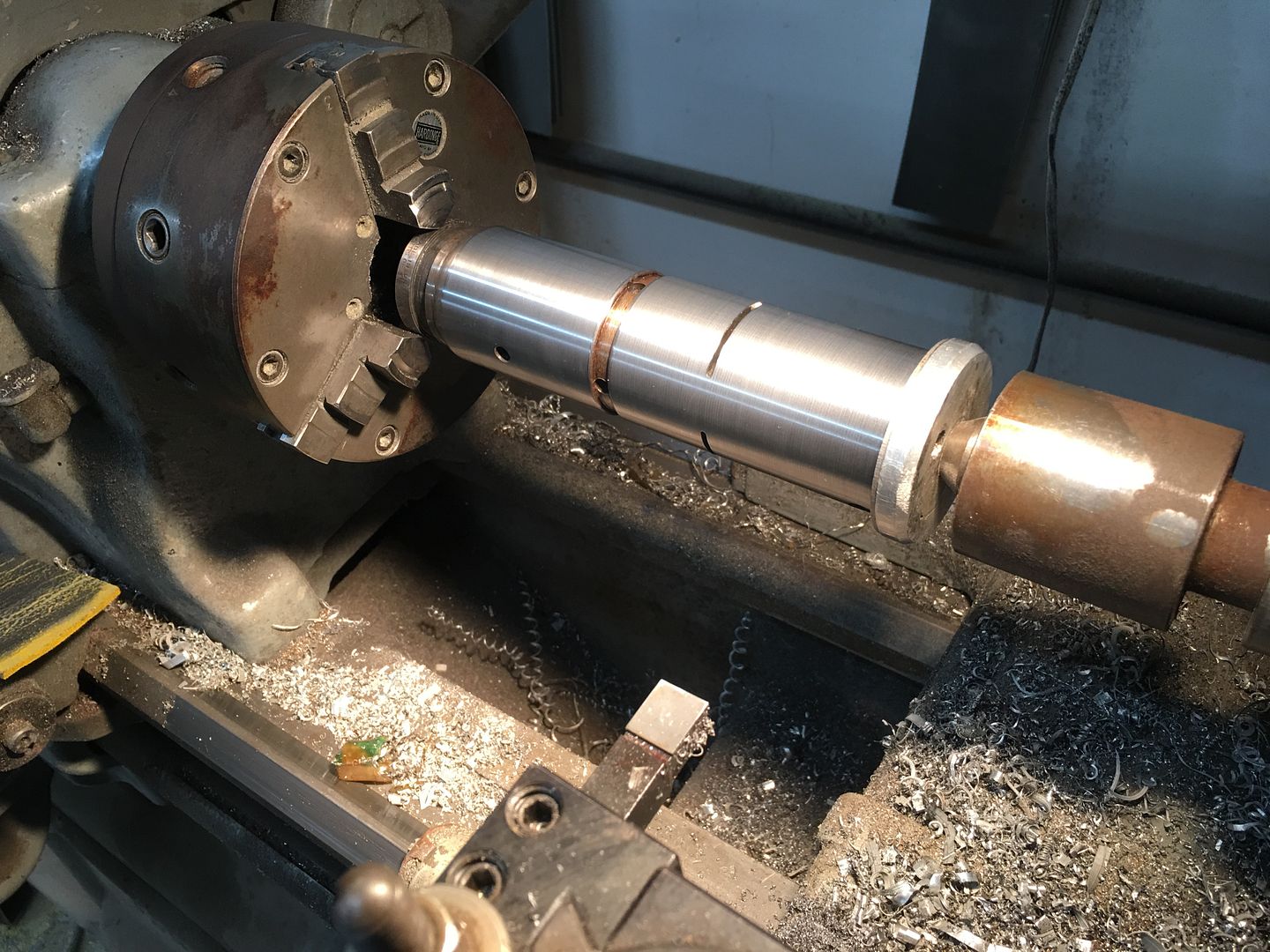

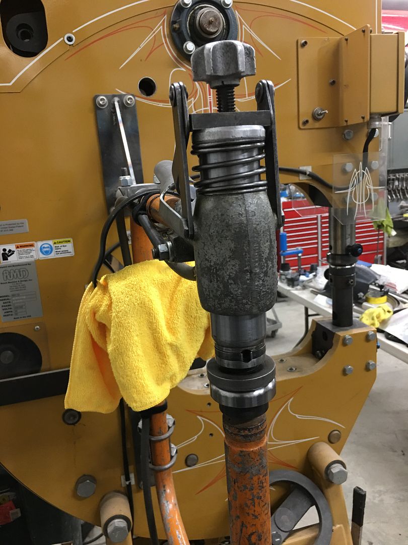

Some equipment maintenance, my Watervliet planishing hammer has always had some issues getting started. You'd hear air blowby, and would have to bump the hammer to get it started. Pulling the piston apart, there was a noticeable scratch...
So it was chucked up in the lathe and turned until the scratch removed.
Everything reinstalled with new O-rings from Renato Muskovic in Vancouver, and it's now functioning as it should..

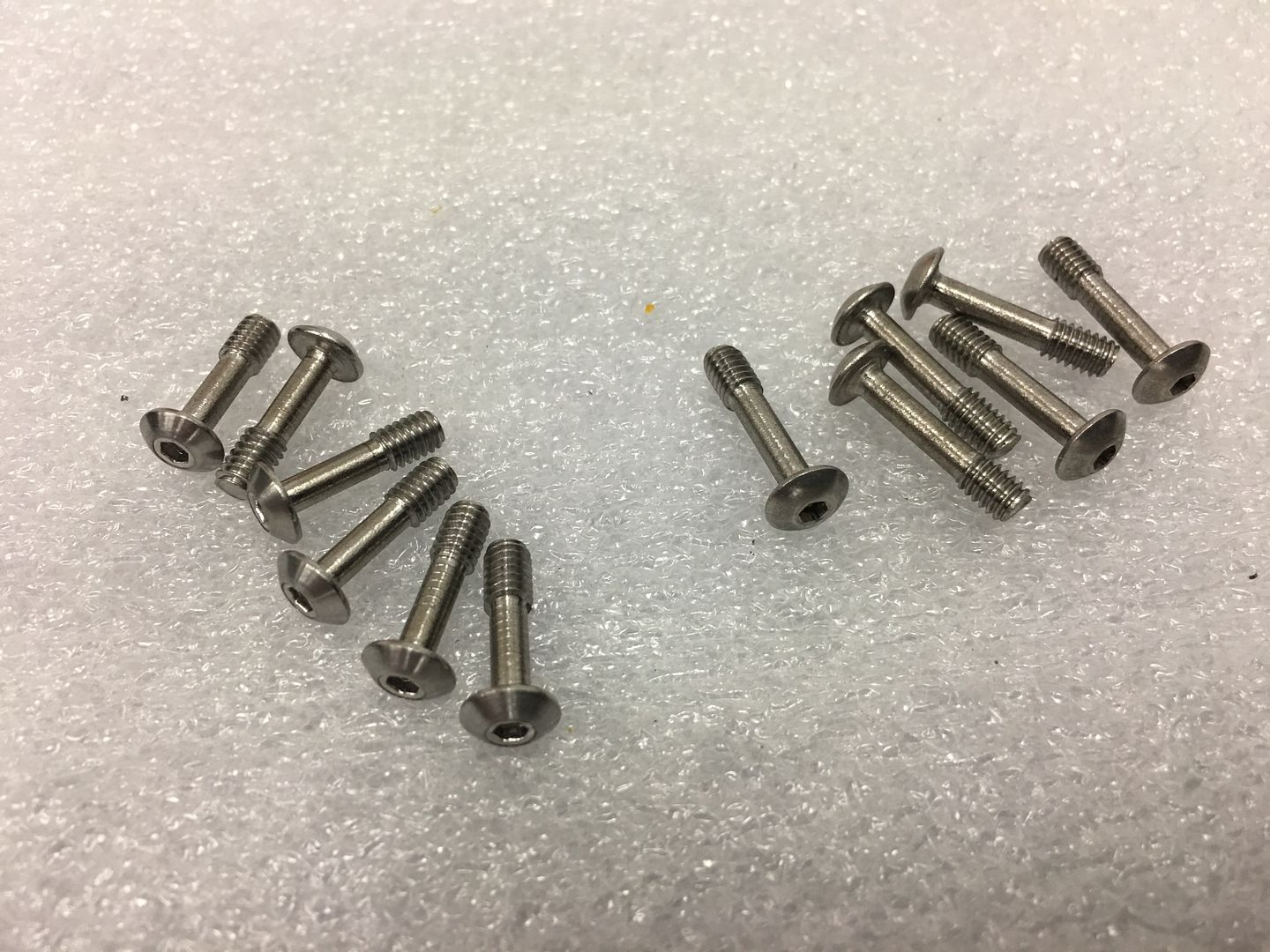

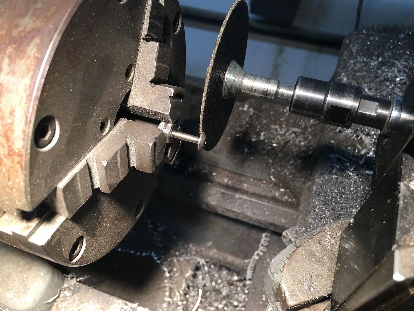

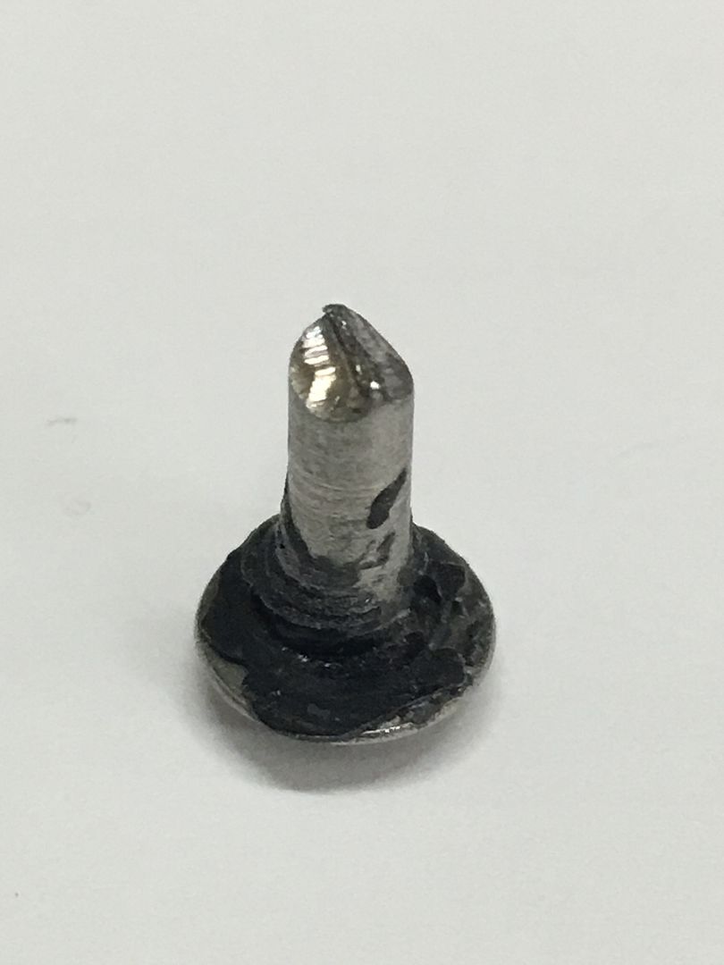

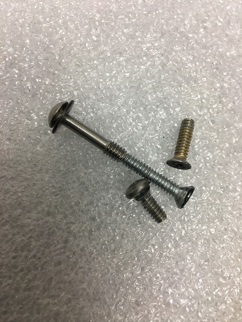

On another lathe job, we needed to make some captive screws to match some existing. We had a "refurbished" piece of equipment that had mis-matched hardware as they just put something in the hole. Note the 8-32 captive screw and the 6-32 screws used as filler, one with epoxy to hold it in place.
We found another screw that had been wrung off, so they trimmed the remaining piece off to fit better, and epoxied this in the hole....

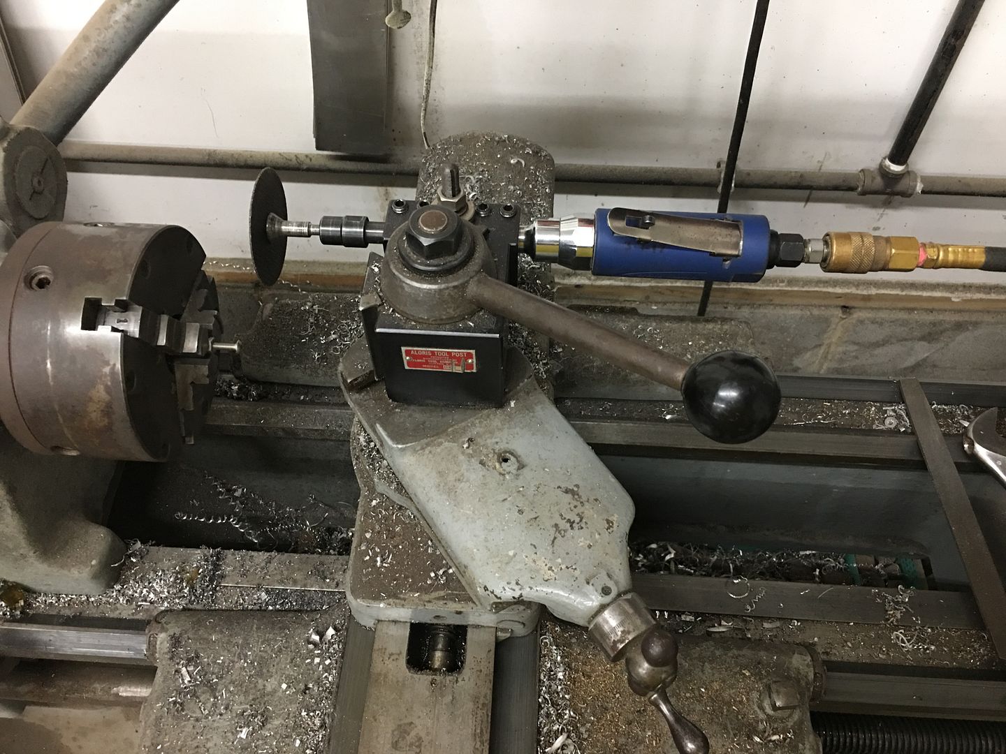

With all the strays removed, now to make our replacements. My go to supplier, McMaster failed me in that they only had Phillips head captive screws. So we ordered the socket drive screws fully threaded so we could make our own to match originals..
Added our "surface grinder" to the Aloris tool holder..
Finished product....
Yeah, we work on just about anything..
