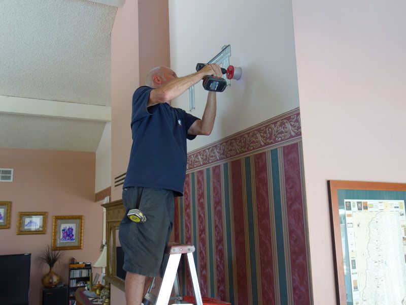

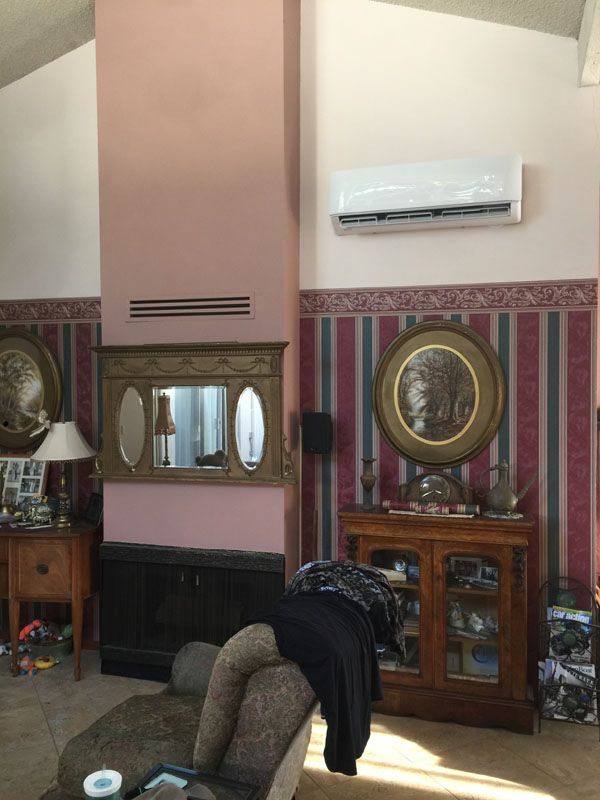

Hi all just finished my install and it was super easy. Took me about 6 hours not counting the time to weld the brackets for the condenser.
I’m also going to list some extra pieces of line set in the classifieds. I needed part of a piece so I bought two sets. Thought maybe somebody could be in the same place and want to save some money.
