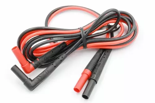

The 4mm test light tip adapter is from Warwick Test Supplies in the UK
The PICO clips are the best (I've tried all the plastic insulated versions and they just don't last like these)
Test leads
