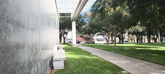

I know, not really a garage related topic, but it's a concrete topic... :)
I see a lot of threads about concrete like strength, finish, durability, etc. Lot's of folks see a little crack on their newly-poured concrete slab and ask if the sky is going to fall, etc. On some threads I've mentioned the term museum-quality concrete. What exactly is that anyways?
Last week I chaperoned to my kid's field trip to the Kimbell Art Museum in Fort Worth, Texas. For those that don't know, the Kimbell is a world-renowned building built in 1972 and designed by Estonia born Louis Kahn. It's a relatively small building composed of a series of these post-tensioned cycloid vaults. Spans are like 100' or so. Very simple and elegant design. This was early post-tensioned concrete.
In 2013 the Renzo Piano pavilion was completed across the lawn of the same property. Actually my first time going to the Kimbell since this part was completed. It's a different building, slightly different materials, but pays a tribute to the original building. The concrete is incredible, similar to the Ft. Worth Modern Art Museum just across the street from my memory. I know that getting this quality of concrete takes an enormous amount of effort, from design, concrete supplier, contractors, subs, etc., not to mention cost, hence why I've called that, museum-quality. Anyways, I just snapped some random photos with my phone, nothing really specific. I'm certainly not a concrete materials expert, but I have worked on some cool projects similar to these on the consultant side and have learned how some of these unique buildings are put together.
So if you find yourself in some museum kinda bored, look around and check out the structure...whether concrete, steel, timber. Better yet, if you are in the area, stop by and check this out, as well as the other museums all within walking distance of each other.

That’s not craftsmanship nor museum quality, that is a ”sack and patch” finish. Easily achievable on any concrete if someone wants to pay for it.
With all due respect, that is a ridiculous and uninformed statement. That is an as-cast architectural concrete finish, which required meticulous design and craftsmanship to construct....... not to mention an obscene amount of money.

Form facing materials are part of the equation but form design is also critical. Every form element must be designed for minimal deflection. In addition, the forms need to be virtually waterproof to avoid mix water from escaping, which creates color variations and sand streaking. The carpentry needs to be of finish quality. Panel sizes and tie layouts need to be arranged symetrically. Then there's crack control. A rich, free flowing mix with properly sized aggregate is important as is extremely thorough vibration.
This type of concrete is orders of magnitude more difficult than the average structural wall. You literally need to get it right the first time because invisible repairs are extremely difficult.

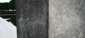

Do you know for sure that is “as cast”? If so, then I retract my statement. I have never seen concrete like that with some post pour finishing.

Thank you @LLWillysfan ...I would hope you'd chime in.
@Rusted Nut definitely as cast. I know what sack and patch, parging, rubbing, etc. looks like. Not stained either. None of that here. Actually, I don't even recall seeing any shrinkage cracks! Unbelievable.
I'm not sure on the form work. I believe they use some MDO or phenolic overlay plywood. Very likely a one-time use? On some of these projects a mockup is almost always required and usually part of the contract requirements.
We just finished a project with board-formed concrete smallish retaining walls (although it wasn't architectural exposed concrete). We required a mockup and the contractor wound up doing two of them to get the desired grain effect on the concrete from the wood forms . The concrete sub still struggled with a bit of honeycombing on the actual walls. Obviously wasn't anything near what the Kimbell resembles, it was more like a rustic look. Likely will get grafitti as it was in a public park. LOL
Just to clarify, I'm not implying that this kind of construction is ONLY found on museums. I've seen some really high end homes with this type of construction. But unless you live in one of those homes, you probably would not know. On the other hand, museums are open to the general public so that's what anyone can relate to ☺️...just gotta keep it down on the noise, as our third graders quickly found out.
Nothing really like this on your typical tilt-wall concrete panel warehouse, retail, cast-in-place or precast parking garages, or commerical buildings that I can recall; those buildings typically get an architectural "finish" (we call that a "fu-fu finish", except parking garages and warehouses. Some hospitals or university buildings may have a similar marquee building or even a museum on their campus. Whoever is the pilatrophist with the highest donation would get their name on the entrance of that building.
First off, Rusted Nut, I'd like to apologize for my snarky response. It was unwarranted.
It's definately an as-cast finish. You can see the sheen imparted by the smooth form facing material and there are still tiny air pockets still visible, all of which would be obscured by any subsequent finishing operations. They obviously had to patch the tie holes and I'm sure there was a little rework required here and there but most of that concrete looked like that right out of the forms.
A 'sack and patch' finish involves patching defects & tie holes followed by the application of a loose mortar onto the surface. The excess mortar is removed with burlap or the edge of a steel trowel. This is done to fill all the air holes and provide a more uniform color but it doesn't hide much.
The point I was trying to make was that the entire approach to architectural concrete is fundamentally different than it would be for a basic structural wall. It wouldn't be uncommon to sack an architectural concrete wall but it's not going to change a sows ear into a silk purse.

You are forgiven for being snarky. I guess my initial post was a bit snarky as well. I’m a commercial superintendent and have done a number of projects where the contract documents state as cast finishes, and then owner hates the finish and demands it be re done to look like such and such a project, that was a sack and patch or similar.
Taking a better look at the photos, yes I see the pin holes and such, it is “as cast”. A nice job at that!
