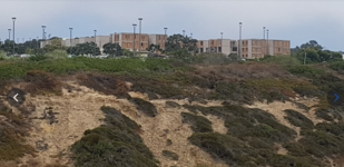

Very nice. Years ago, I got to do some fire protection engineering work at the Jonas Salk Institute in Torrey Pines near La Jolla CA. The campus is on a cliff over the ocean with amazing views. Kahn built this masterpiece in the 1960's, and it's amazing. The modular research labs have "interstitial" spaces between each floor and are plumbed with Pyrex glass piping for all the various hazardous chemicals used there. Lots of nasty stuff like Aids research, so bio security is really strict.
It's an amazing building and I highly recommend a free tour if you're ever in the area. Interesting thing is the primate research lab that is built fully underground to keep the animal rights protestors at bay.
