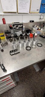

Together, Jeff and I decided to run a stock compression ratio, with his custom rods and pistons, and his borderline OCD assembly habits.
So, the engine at FRP:
Then he put the long block all the way together, put the timing belt on, and shipped it back to me.
