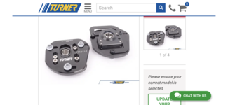

Because I've been paying attention to the car, it decided to blow both front struts all over the driveway, so I started to repair that with some new 86-1249SPORT Koni yellows.
Instead of the usual rubber strut mounts with separate bearings, I have a set of adjustable tops with built in strut bearings, because the rubber mounts you can get now are hot garbage and last like a year on the outside.
On taking the struts apart though, I noticed the passenger side's upper spring retainer was all wallowed out (which was likely causing some noise on that side).
So I un-wallowed the hole.
Then I re-bored to size and faced each side.
Then I gave it the ol' Krylon treatment.
It's been a little cold and windy, so I haven't gone back outside to reinstall them.
I also had to replace a stud in the ring up top (also on the passenger side), since I cut it off, on account of the nut was stripped.
I think the cause of the wallowing was the nut on the top of the strut. I'm going to use the old nuts as a jam nut this time, so that I won't have it happen again.

Nice repair. Think I might have gone for adjustable strut plates?
no704
Apr 27, 2016
5,243
I was thinking more like this. Used to have some on a gti rally car. Not these but similar and lots cheaper.
