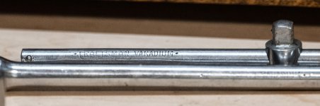

A 1970s era German Saltus S.A.E. set with an interesting ratchet.
Obviously, incomplete. Just missing 3 of the smaller sockets and a breaker bar.
Some of the sockets are marked as SALTUS CHR-VAN and others just as CHROME VANADIUM.

CRTDI
Jan 11, 2010
1,533
Because of the Indestro-ish pseudo beaver tail? The oddly bulky construction of the head? the knurled button dial selector? Or?
The overall appearance/style, plus the very thin handle thickness. Can't be very nice to use for long periods.
30,890
:lol: It’s just one of those you don’t see every day, between the brand and the drive size.
True that. Strange how permanently their double flex socket head wrenches have been crescented into our lexicon, though!
Thanks, just curious. Maybe that's what's making the head look even thicker. At first I thought maybe it swiveled the way it sits so high above the frame like that. Not sure why it's not flush.

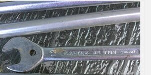

12,035
Crescented, I like that term. Sounds better than Vise-Gripped or Channellocked. :)
As for the Saltus, this is the wrench I posted earlier in the year. Authentic German. Bad photos, just want to compare the two because it looks like the same font as on the ratchet. Sorry to get off track, but since the name was mentioned.E6C35E04-35DC-4679-9E5A-AB912BEC3B97.jpegF9E02CF2-0E91-499A-8406-F38091FC8A08.jpeg6026CF55-41E4-44E7-9AF1-CEF481DC1492.jpeg
Thanks for posting this. The script looks similar to me as well. I believe Saltus supplied tooling to the German military at some point. It's been super hard finding any vintage info for his brand.
