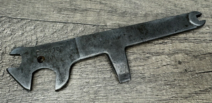

As far as I am aware, the Canadian Govt. property mark always had the broad arrow fully contained within the curve of the C. Therefore this mark on the mystery tool does not denote govt. ownership. In addition, the vertical shank of the arrow is way too long. 1755354849216.png

Sure looks like a screwdriver to me, but more like something you'd see in the 18th century.
After some searching, the small C broadarrow mark is an English variation used in the 30s. I believe this to be military, maybe a screwdriver for a hydraulic buffer system on a field gun.

To me, the fat end looks user-modified, or, shortened; based on the way it's ground down and how close to the end that N is. If so, there may have been more letters before the N.

It's so close, but not quite an exact match

If it's ~5" long, I am guessing it's maybe about 3/8" thick maybe a little thicker at the "head" where it seems to slightly taper.
It's made from 1/4" plate. Of note is the wider end, it has a bevel, coarsely hand ground as per pic. Flip it over and there's a similar bevel there too.
Looks like some remnant of a letter to the right on the "N". Unfortunately this looks like it may have been modified from something else

O.K. this getting interesting/something. First, it would really be nice of the O.P. to lay it down on a scale a re-submit a new image; measure the width and thickness of the blade tip etc. - especially if asking for identification assistance & especially in light of an earlier request for additional info. Don’t mean to be grumpy; such a request is just not necessary in some generations.
The ‘tool’ has always appeared to me for turning or twisting application; not necessarily as a screwdriver; Private Lugnutz’s hydraulic buffer extrapolation from the tool stamping tweaks a new thought direction as does the ‘keys’ in the limber box he posted.
If the tool is involved in the operation of hydraulic buffers, be they railroad or artillery; seems reasonable they would be described/pictured in tech manuals - I currently lack the computer skills to access them.
In a hydraulic system, if you wanted to adjust a valve and not have it easily re-adjusted, one way would be to cut a slot in the valve stem and make a ‘special stored away tool’ for that purpose.
Another though that rattles around is a pry; but hydraulic buffer is pulling the rational toward a tee-handled adjustment tool; that works pretty well with one arm sawed & ground off.

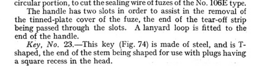

A yes or no answer would provide a misguided impression. There are dozens of TM's for large British guns with hydraulic buffers on Google Books, all dated between the 1880's and early 20th century, all of them referencing screwdrivers and/or keys in descriptions, in lists, in tables, etc, but most of them do not include an illustration of any of the tools. The guns, carriages, valves, packing diagrams, etc, are illustrated, but no tools. So it's not that I can't find this tool, explicitly. This tool might in fact be the tool or a tool like it being referenced. But the manuals are not definitive.
Here is a good example, from a 1914 Q.F. (Quick Firing) 15-pounder, which literally cites a "Key, hydraulic buffer" by name, but provides no illustration or description.
Other keys (breech, fuze, fuze hole, primer, etc) are listed and described (though not illustrated), but not the hydraulic buffer key. Not sure why.
I have found a few later manuals starting to show more tools. Here is a figure from the 1928 Handbook for the BL 60-pounder, for example. I like the robust look of the blade. I really like the look (and implicit turning and spinning function) of that tommy bar with respect to my artistic rendering and extended logic of @Mintgrun's very good observation! But note that it's not associated with the hydraulic buffer. I'm getting strong inferences. But it's not definitive.
Absolutely fantastic research. Since your earlier post, I dabbled around using reg. Google; found several mentions of an oil drain tool on a British hyd/buffer system, but the picture was unintelligible. Maybe this could be another lead.
