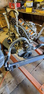

You can rig up the radiator and pressure test your work.
This is a Jeep 4.0 being tested. Spray each core plug with soapy water, radiator tester pumped up to 15 - 18 psi.
