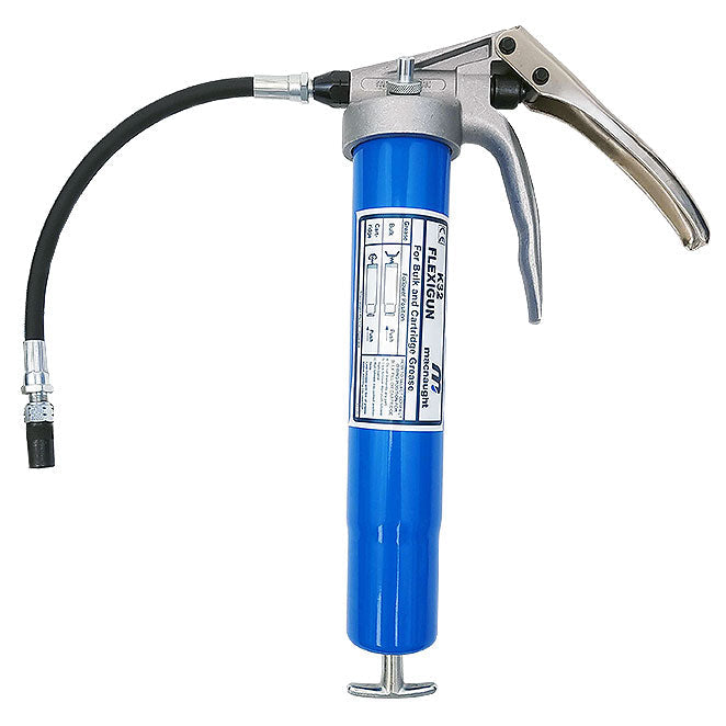

I just received a Macnaught K32, I had been wanting one for a while when someone posted that they were on sale for $45. This thing is built like a tank, makes the current China made grease guns look like they are made from paper mache. They are still priced at $45, probably till the end of the month, available directly or through their Amazon store.
Thanks for the link. I've been needing another grease gun and was about to purchase another Proto but based on several comments here I opted to try one of these Macnaught guns. Just ordered one.

So i got the k32 delivered today. Put a tube of green grease in and so far so good. Only thing is the tip once locked on does not let go too well. I had to completely unscrew the end so it would release the zerk!
I like the lock n lube tip but it seems huge and i already have some tight spots. Any other brand you can suggest
