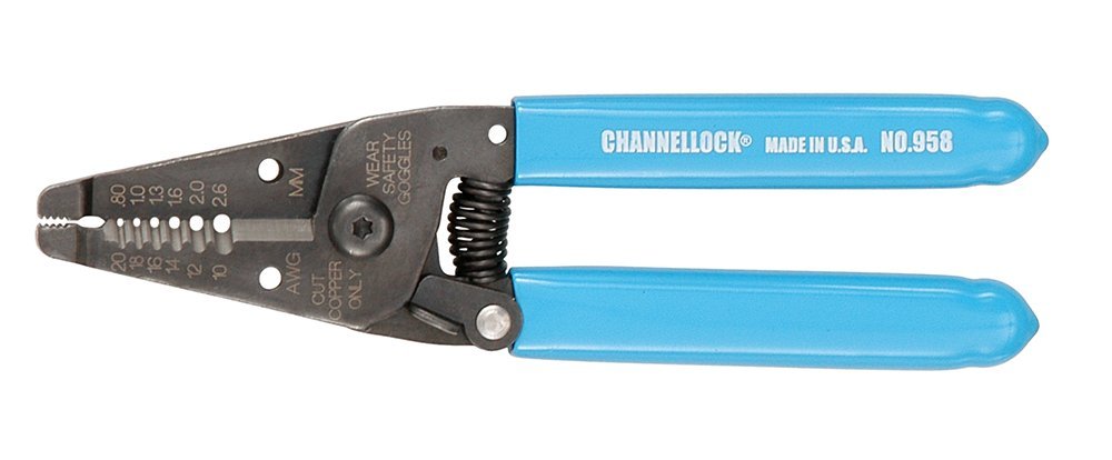

Also, curious to know, how are these Channellocks?
http://www.amazon.com/dp/B00004SBDJ/?tag=atomicindus08-20

I'll compare the Ideal to the Channellocks and go from there. Both wire strippers could potentially be keepers here.
I use these, they are slightly longer more leverage , identical to the Channellock 908 http://www.sears.com/craftsman-electricians-tool/p-00982563000P?prdNo=5&blockNo=5&blockType=G5

I received my Ideal StripMaster today. This wire stripper is awesome, exactly what I needed. I returned the Irwin for this. I also have the $10 Channellocks. Should I return the Channellocks or keep both the Strip Master and Channellocks?

Instead of getting the pwcs7, I purchased Channellock 909 Crimping Tool with Cutter. :)

I've decided to keep both. The Channellocks are the same as the Klein Tools; all probably made in the same factory.
