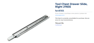

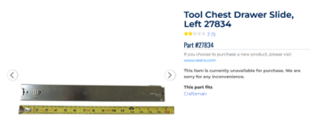

I also have some old Waterloo built Craftsman tool chests, and they have served me well for over 20 years. Here's a pic of my 40" 14-drawer and 26" 6-drawer Griplatch chests, both manufactured by Waterloo in the USA way back in 2001:
Unfortunately, the slides on one of the drawers is failing, so I've been considering replacing these old chests with something newer. I like the full-width drawers on the new chests, and the heavier duty slides. But after looking at my options for replacement, I haven't found anything with a drawer size and arrangement that I really love. The closest has been ordering some custom Rousseau cabinets. But before I did that, I found this thread and figured why not see if my slides can be replaced and just try the number posted in here for Waterloo parts: 660-826-0960
I honestly expected it to be disconnected or assigned to some other SBD department, but holy **** this number is still active for the Waterloo parts center in Sedalia, MO and they can still look up parts for old Craftsman/Waterloo chests. And yes, as of November 2024, they still have the Craftsman Griplatch ball bearing slides.
For people searching, here's the part numbers:
The left ball bearing griplatch slide is part# W27834
The right ball bearing griplatch slide is part# W27835
Here's the Sears part photos and you can see these slides have the metal receiver at the top for the griplatch drawer catch, and the correct tabs for hanging in the cabinet frames.
At the time of this post, the slides are $16.70/ea. when ordering from Waterloo. After ordering over the phone I received an e-mail receipt from SBD. On that receipt is the following contact info:
Email: [email protected] for orders and [email protected] for inquiries
Phone: 800-833-8851
I'll update this post once they arrive. Hopefully, it's the same slides as pictured and I'm good to keep my griplatch chests for another 20 years.
