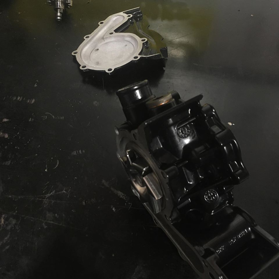

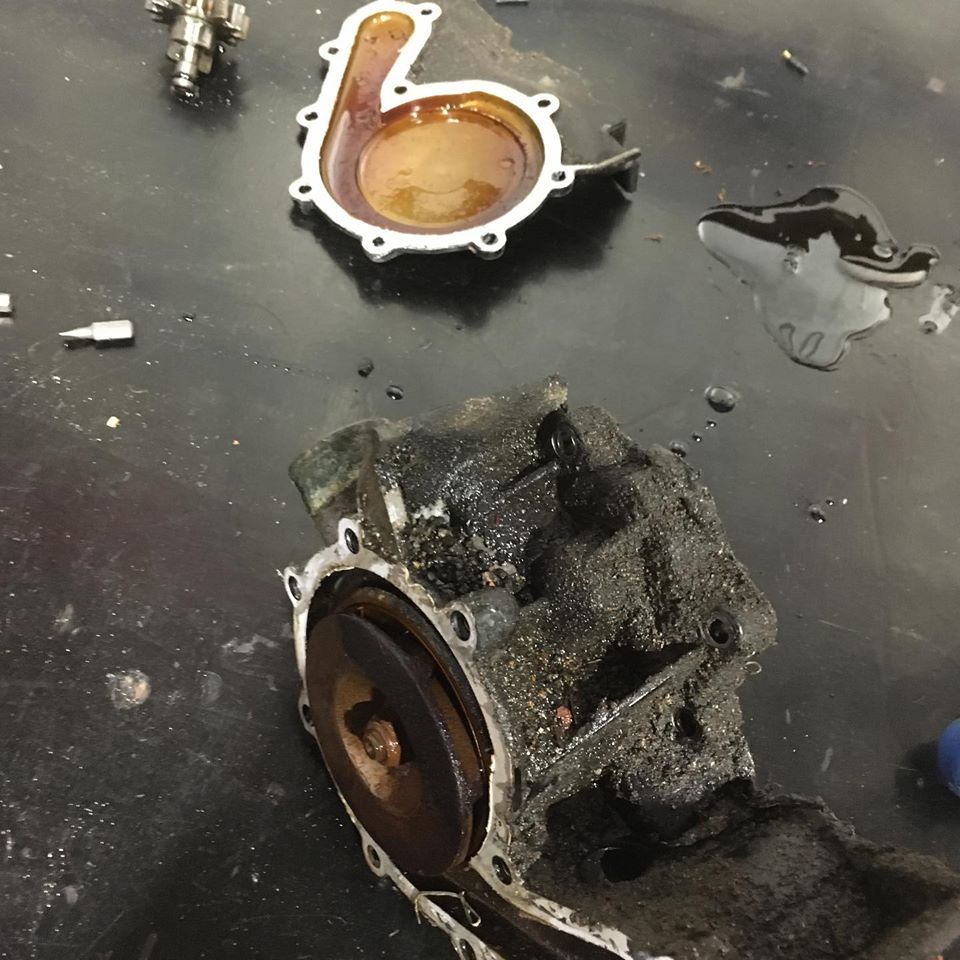

also rebuild a bmw k100 water/oil pump. it's a combined pump, front part is the waterpump, the back is the oil pump. consists of two O-rings with a small "leaking" area in between. when one or both sides are leaking, they fluid or oil comes in the area and can go through a weep hole to alarm about a leak.
when I mounted it back up, it was leaking water again, so had to replace the seal again... It's a very "strange" seal in the sence that the middle parts of the seals is turning together with the oil/waterpump shaft. it's very brittle upon mouting it, but all good now
