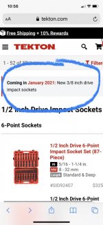

I got a dewalt 3/8in impact a last week and have been using my regular sockets on it but since I don’t want to ruin them that way I should probably get some impact sockets. In my shopping online I see tekton is coming out with new 3/8ths impact sockets.
