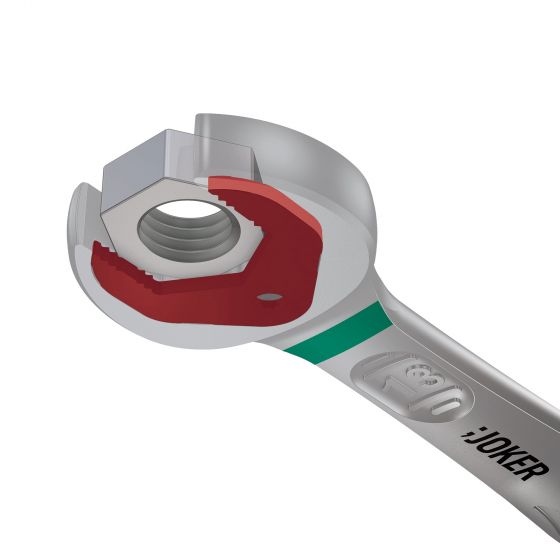

Maybe somebody make such a thing, but if not, they should.
Basically a boxed end wrench that can only go on from one side so you can put a nut into it and it will not fall through.
For example, I was trying to work on my daughters car today, and deep in a narrow slot I needed to slid a nut in and hold it so I could tighten it from the other side. Usually I have to try to balance it on my fingertip and then get the nut started and then get a wrench to hold it.
I'm sure I'm not the only one who has had this problem.
I tried my finger, but the slot wasnt big enough, and if I bumped it on the way in, it would drop down into the door and rattle for eternity, tried needle nose pliers but they wouldn't make it through the slight angle, magnets wouldn't work because it was a stainless nut.
Do they make anything like this already? If so, I need to buy a set.

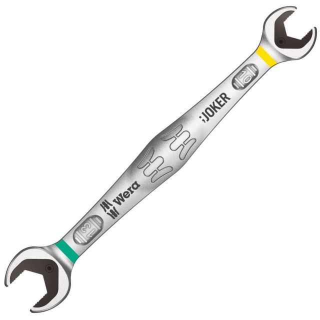

Wera have what you are asking but on the open end.
