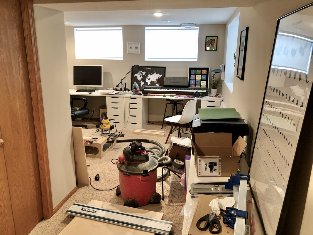

New Years Day I had off and managed to steal away to Home Depot for an hour to get some birch plywood. Getting 4x8 sheets is a real challenge for me these days. I used to use my dad's truck but he got rid of it, and both our cars are compact. I ended up having the guy strategically cross cut oversized pieces on their panel saw.

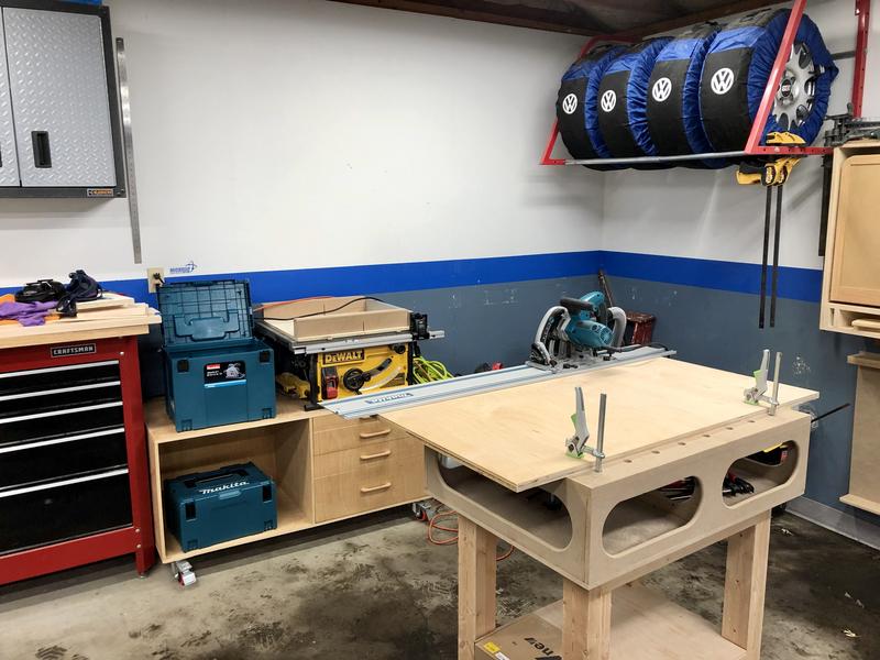

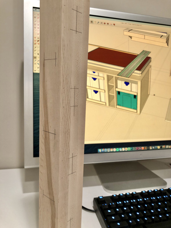

I had a goal to build a project over winter, but so far it hasn't happened. I'm going to try and do a little bit here and there in the evenings when I can. I'm trying to make a track saw workbench. Kind of like my mini-paulk-MFT cart, but bigger and way better. With a removable fence, vertical clamping, systainer storage below, etc. More details later, but so far I cut the top and bottom to size:

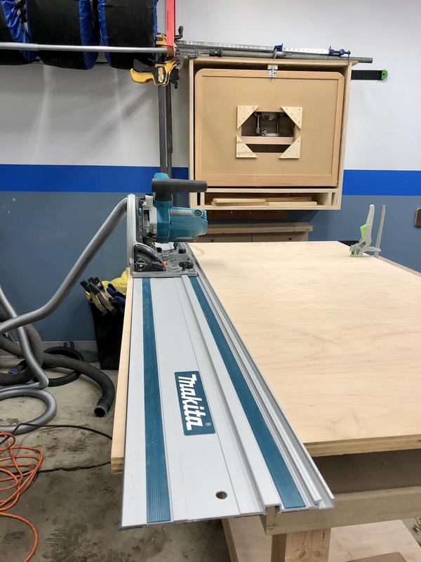

A major reason for building it is to make accurate 90 degree cuts with the tracksaw. Measuring and marking pencil marks and lining up the track works ok, but still prone to error. This track saw station will double as an assembly table and outfield table, and hopefully the foundation of many sheet-goods-based builds to come.
Man it felt good to make some sawdust again, even if briefly. It's been too many weeks!

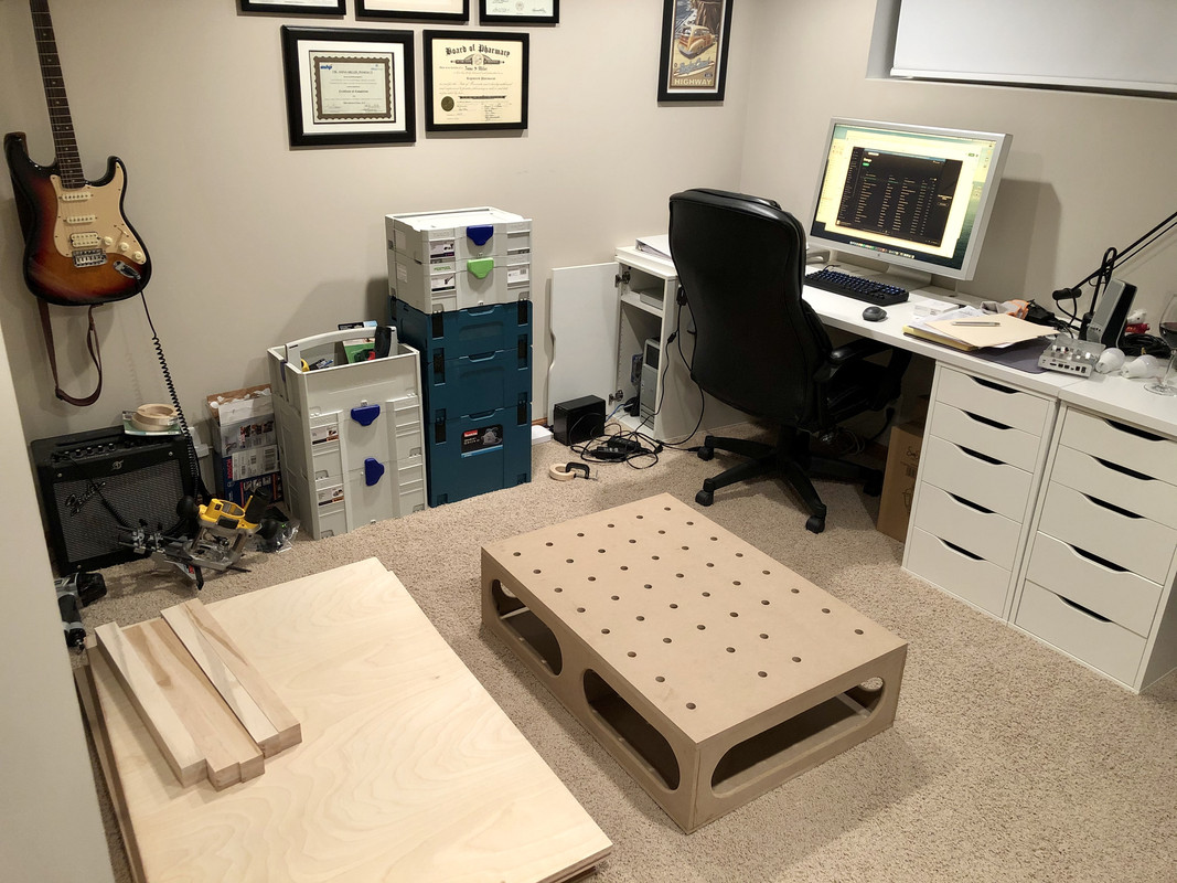

We had a cold spell a bit ago and I've since brought some of my tool indoors to the basement. The Makita box latches are prone to sticking if warped in temperature changes so I'm trying to take better care of them. Easy to carry outside when needed anyways.

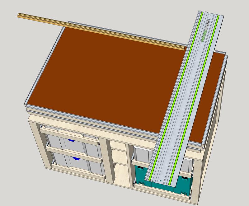

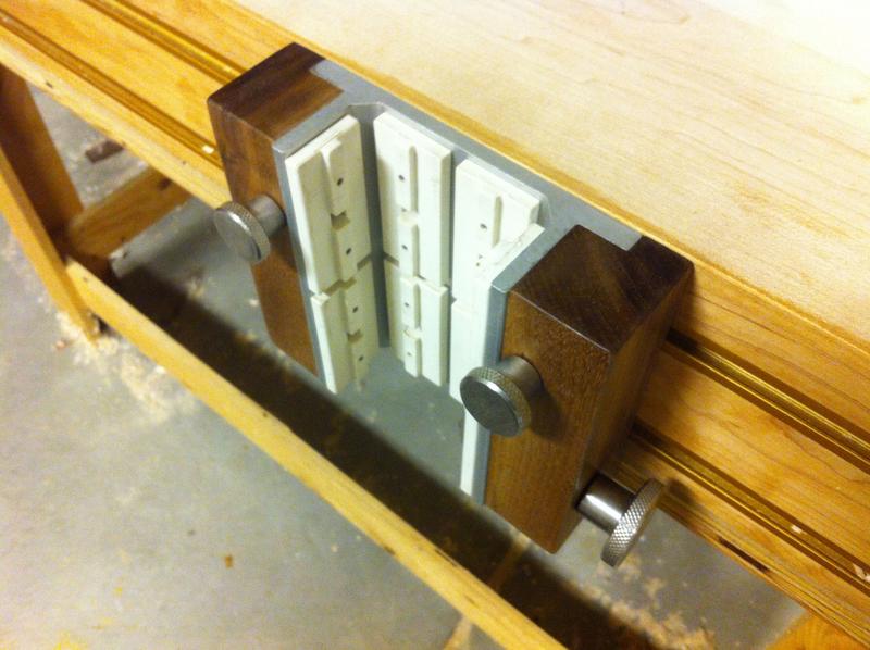

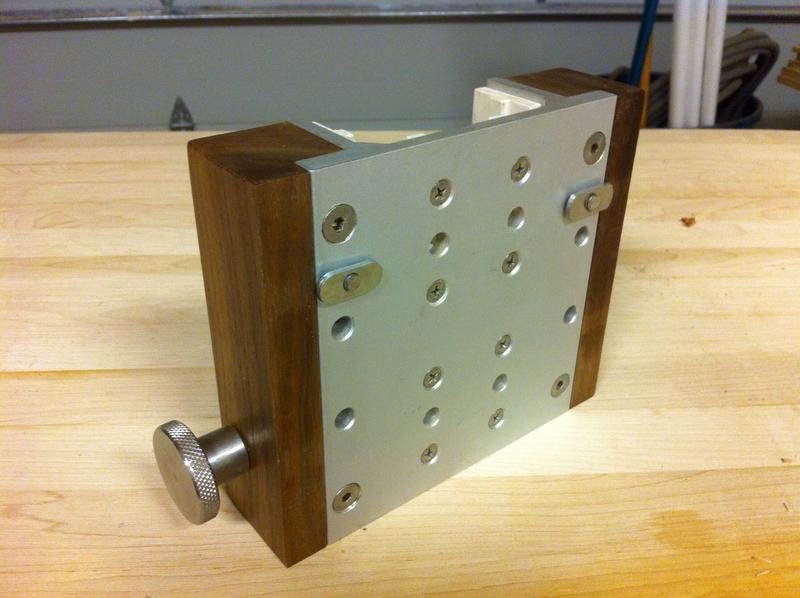

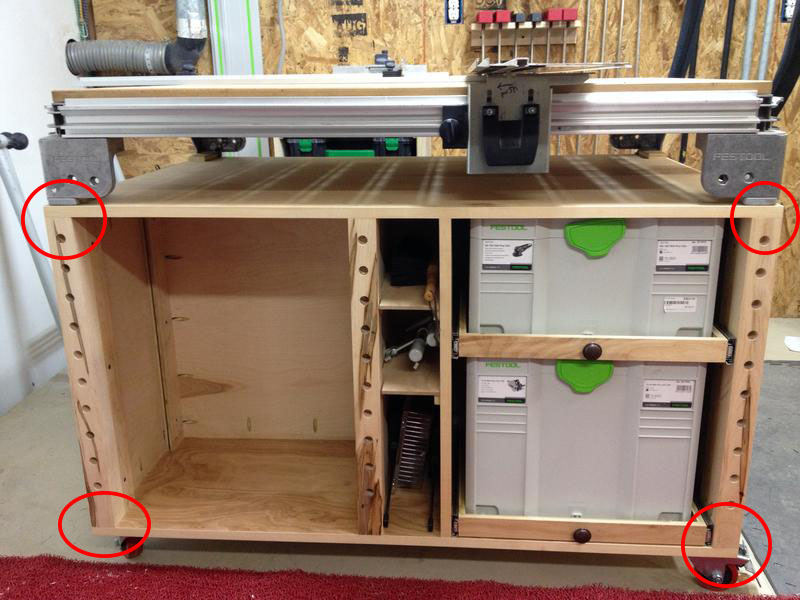

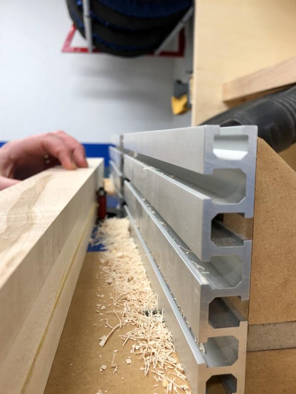

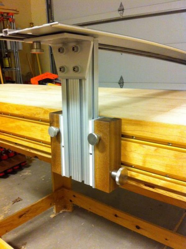

Hey Toon, I am likely not going to build my own hinge for that reason. It definitely needs to be accurate and I don't trust myself to create that with off the shelf parts, and probably don't have the time, either. I will either get the stock Festool hinge and support from their parts catalogue, or this one by Right Angle Design.
The Festool parts require a custom track profile, like the actual MFT profiles. If going that route I'd do something similar to what Guy Dunlap has done for his table here.
Details for his custom profile are in the pic below as well as forum post on FOG:
https://festoolownersgroup.com/festool-jigs-tool-enhancements/custom-mfttable-saw-extension-table/
I've also read of people using an 8020 linear bearing which is about $80. No hinge on this one but maybe you could find some appropriate 8020 parts:
For rough design of the overall bench I am going to heavily copy this one I found on FOG:
Except instead of an MFT the top will be custom, kind of like the Guy Dunlap video. I have a work-in-progress model that's missing some components but will give you the general idea, here:
As you can tell I'm still ironing out some details, but hopefully that gives you some ideas anyways.

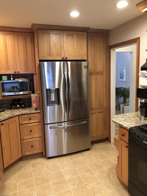

I just received the same fridge minus the door water feature as we purchased a separate cold/hot water cooler.
Sweet! I like it a lot. Outside water was pricier but my wife said she didn't want guests to have to open the fridge to get water. We rarely have guests. :lol_hitti
It also has a "Cool Select Pantry" drawer for chilling white wines. Nice :thumbup:

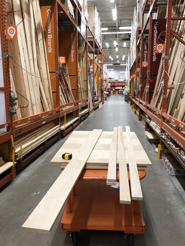

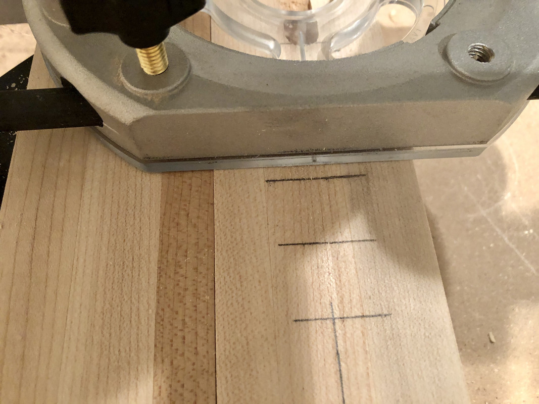

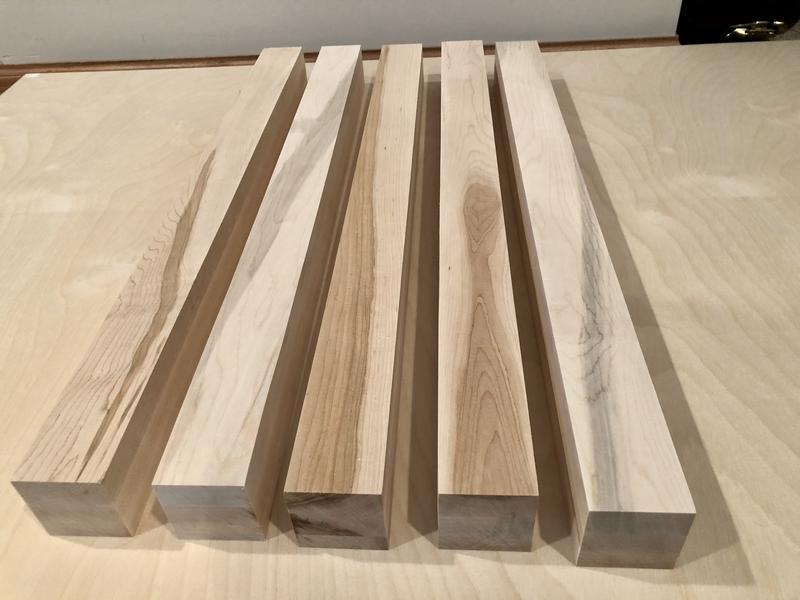

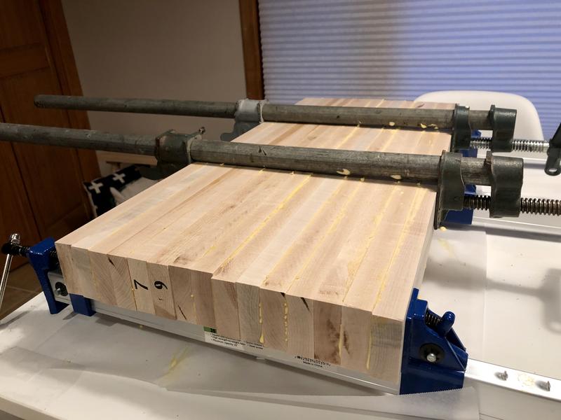

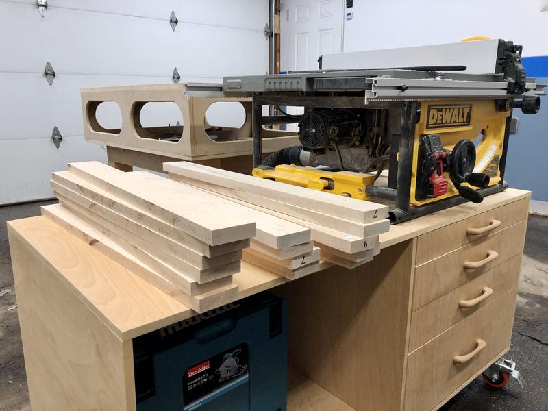

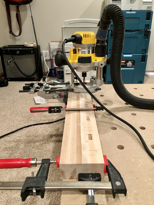

Last night my wife had a work party to attend, so after I put the baby to bed I went out to the garage for a few hours. I trimmed up another plywood panel for the track saw bench, and cut all of these maple boards:
Instead of getting thicker lumber I got these 1x3's at Home Depot when I got the plywood. They are for the legs of the bench, and my plan was to laminate three together to form one leg, and then trim the whole thing to 2" square.
Used my kitchen table as a glue up table:
I glued them all up at once (not putting glue between separate legs), thinking this would be easier than using smaller clamps and having to do one at a time.
Well I didn't use any cauls and my stupid harbor freight clamps tend to flex and some of the boards slid out of alignment, leaving me with more of a lip here and there than I can sand. Now I need to find some way to flush them up and square them up again. And since I pre-ripped to size, I'll probably end up with less than 2" width for the final like I had wanted. I should have just got some 4/4 lumber from a wood place. :wtf:

Ahh the elusive glue up. Everything seems like it is going to work just fine until the glue goes on and you knee deep in it. I have been there. I am sure you will figure it out. Have you made a jointing jig to go on your table saw? Or you could just rip one side flush with your track saw before you rip the whole slab apart.
I have seen people using sugar in between joints to keep them from moving when the clamps go on. I haven't tried it myself yet.

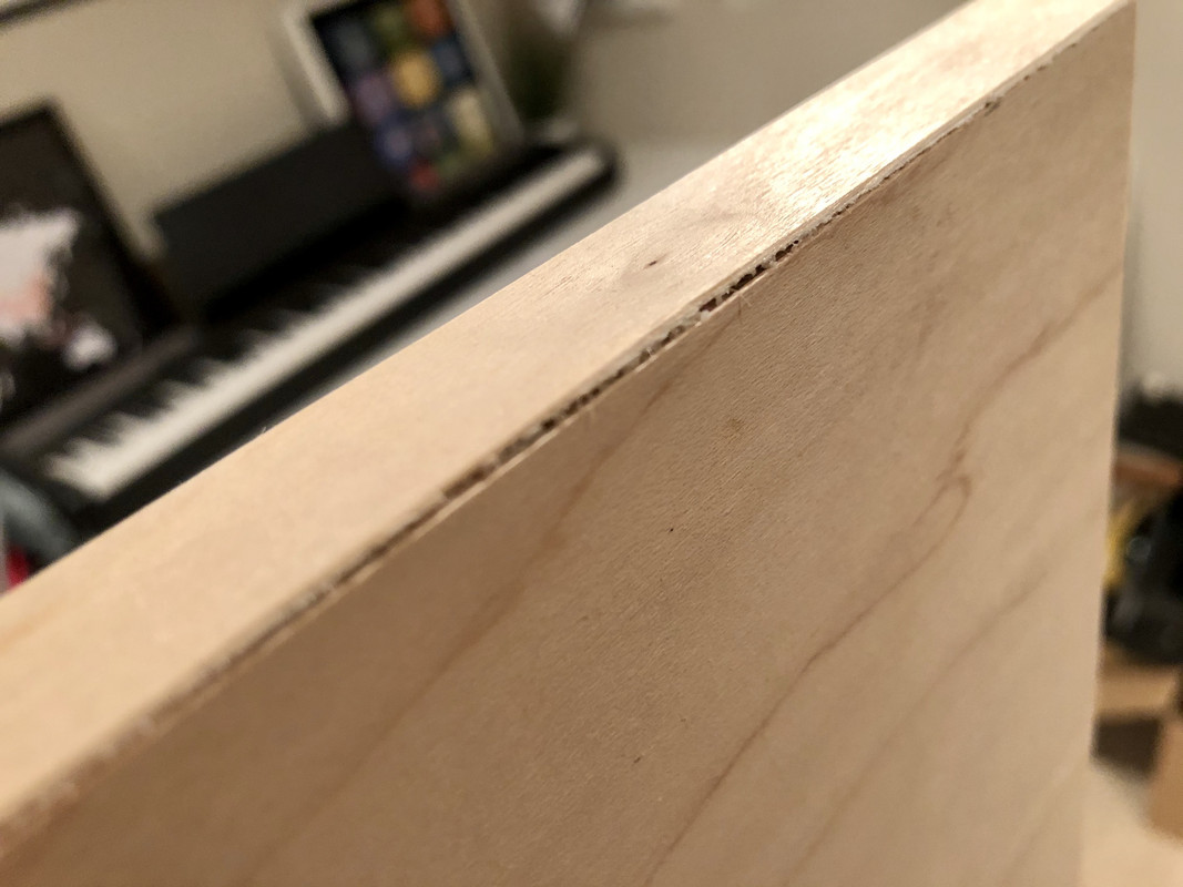

Thanks Bret, you always offer good advice and encouragement. Funny you mention the sugar trick, I had seen Paoson woodworking on YouTube often uses salt, and was going to try that but forgot! I do have a table saw jointing jig, but I made it in a pinch last year and the clamping mechanism is not good, especially for pieces this tall.

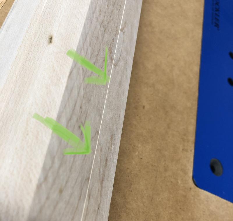

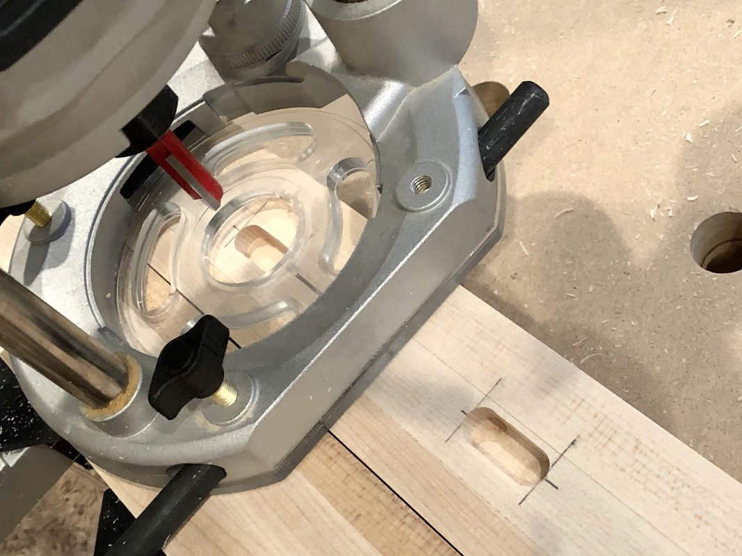

I ended up using the router and flush trim bit to get one side reasonably close:
Then stacked them together and did some brief sanding:
At that point each leg had one side that was looking pretty decent, definitely good enough to run through the table saw, so I just ripped the other side straight, in two passes, flipping it over. The height of these edges were 2 1/4" so that's a tall order for my job site saw when it's maple.

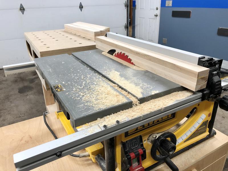

From the flip-over and essentially resawing on the table saw, there was still a slight lip so I then ran that side through the router table.

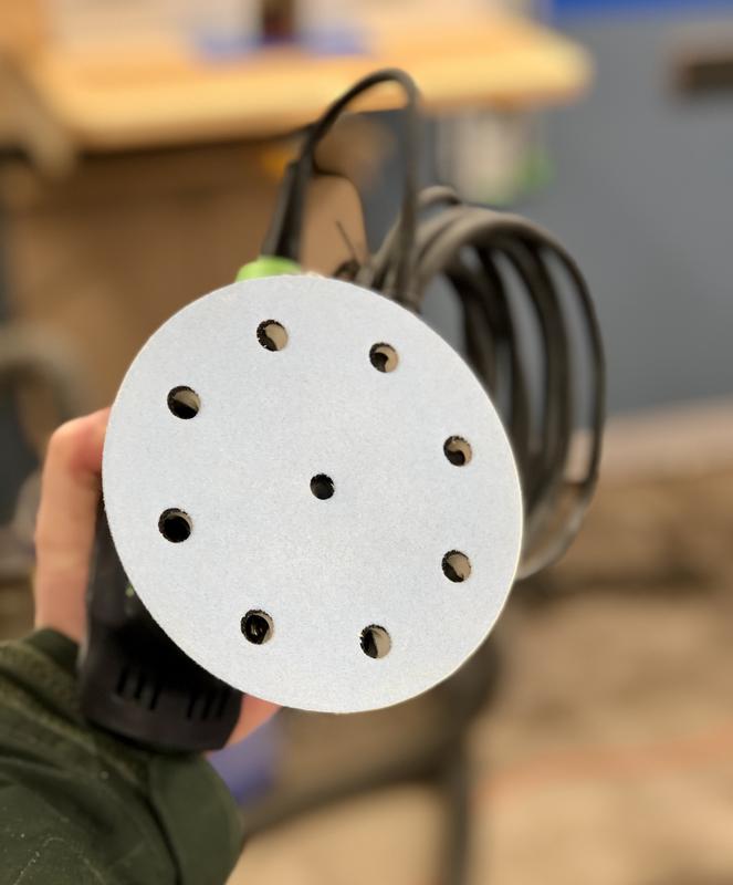

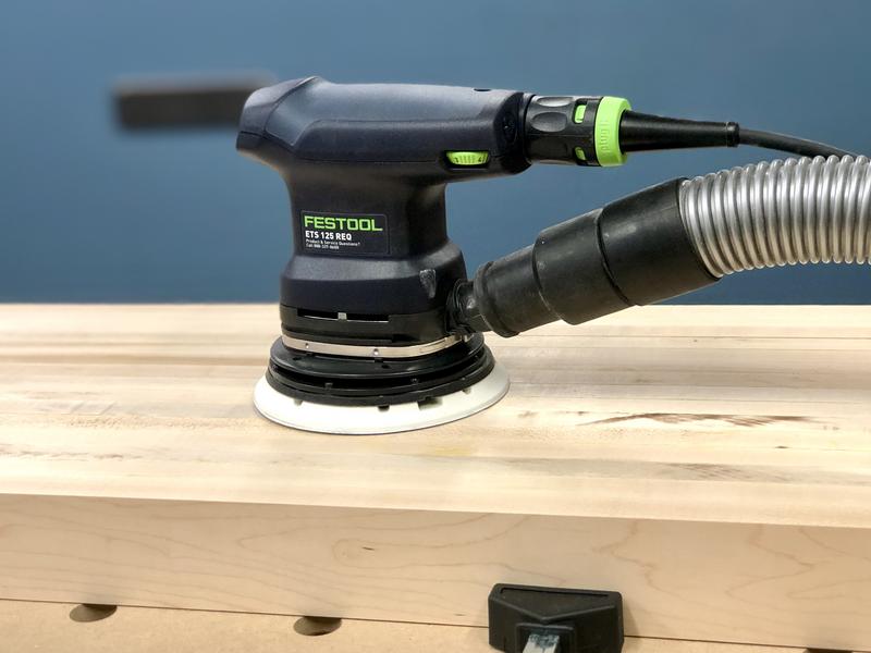

Then I could sand each piece individually. A few notes on the Festool sander, my first time using it outside of a quick test...
- it's hefty, and not quite as ergonomic as I'd hoped (might be personal preference)
- it jumps around the workpiece a bit, skittish, not that steady. Could be my technique. I tried various speeds and none were quite as smooth as my DeWalt. I wondered if it was the orbit pattern or their special sandpaper. Only 1 sheet came with the sander, 120 grit. If anyone has this model and has advice I'm all ears, essentially what I mean is it feels hard to control.
- the finish it leaves is very good
- takes a while to remove material... almost feels under powered
- dust collection is truly excellent. Better than the DeWalt. I didn't really notice any dust at all. And after 30min of sanding the sandpaper still looks brand new.

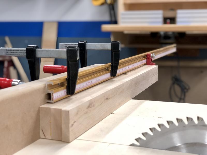

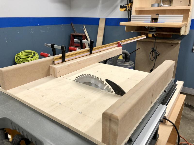

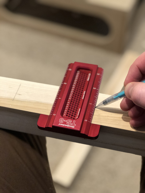

Finally I cut all the legs to length. To do this I clamped a 48" length of Incra TT+ and stop to my little crosscut sled. I bought it for the fence for this tracksaw station, and it's been sitting around since the beginning of the summer. I can't believe I've never thought to use it on the sled before. Helped keep the leg heights extremely accurate and consistent.
And allows for plenty of length of repeatability!

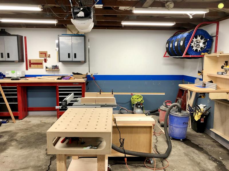

Overall pic of the shop for fun, it was about 30 F out there this morning!
In the end I ended up with 5, relatively square legs. Measuring 1 7/8" x 2" instead of 2" x 2" like originally planned, but not a big deal.
So far this project seems to be moving along, hopefully I can keep the momentum going!

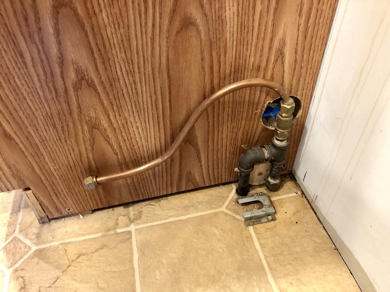

Thanks Roboto! Merry late Xmas to you and your family as well! You are correct about the piping. Unfortunately I did not have time to DIY it or figure it out to save the money. I had a big job at work this week and was getting home late, no opportunity to research. Without an oven or cooktop we were getting anxious to just get it solved. In the end Warner Stellian coordinated with one of their plumbers to move the piping with extension, new fittings, etc. For a cost of course. :mad:
This was the old connection:
I'll upload a pic of what they did later.

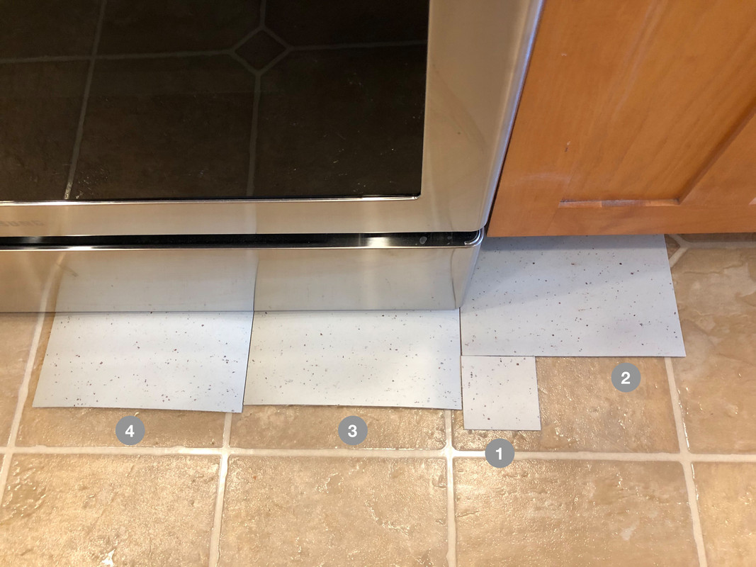

In the end the new range was delivered yesterday and the granite was cut back. It had 1/16" or less clearance on the cabinet face frames. Yikes! Just squeezed in there!
Haven't cooked anything with it yet but tested everything and it seems nice! It had damn better be because when you add everything up it cost almost as much to get it installed as the range itself!

Now you know where I hide my booze-o-hol. :bounce:
Pocket screwed the frame in from below:
And bing-bang-boom it's almost like it was meant for the opening!
:beer:

That looks great! Very fortunate you had some cabinet scraps to use. Looks like it was built that was from the beginning, nice work. Doesn't look like you'll even have to touch up the paint on the wall either - win!
N
nicholam77
Dec 18, 2016
2,698
Minneapolis, MN
Nice, that turned out really great!
Thank you!
Very true about the paint. I don't have any of that color left over from the PO's, either. We are going to repaint it in the next few months I think, when the the floors come together, but at least no eyesore until then.
Amazing woodworking skills. I could only dream....
I think you're being too kind to my abilities, but thanks! :)
I am proud that it only took 3-4 hours to install including the woodwork and problem solving. A few years ago it probably would have taken me the day.

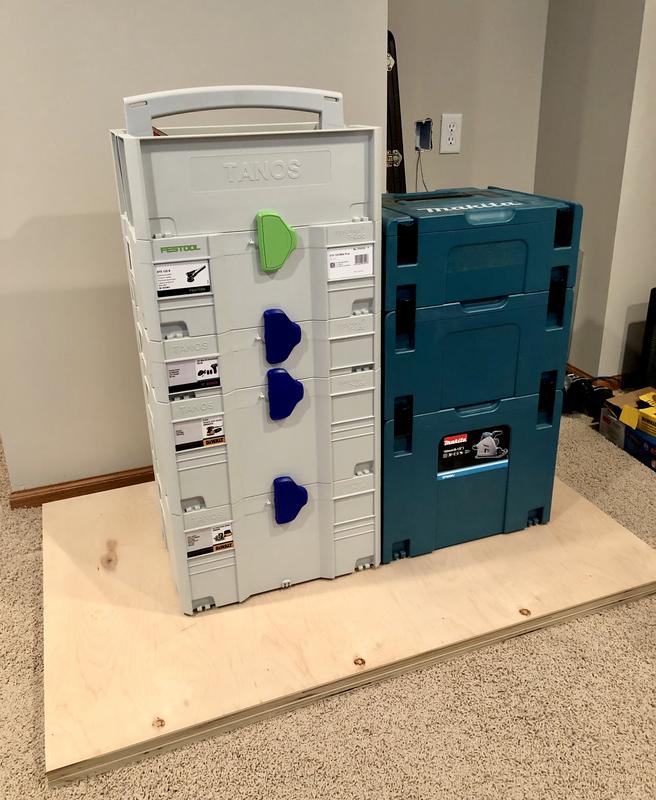

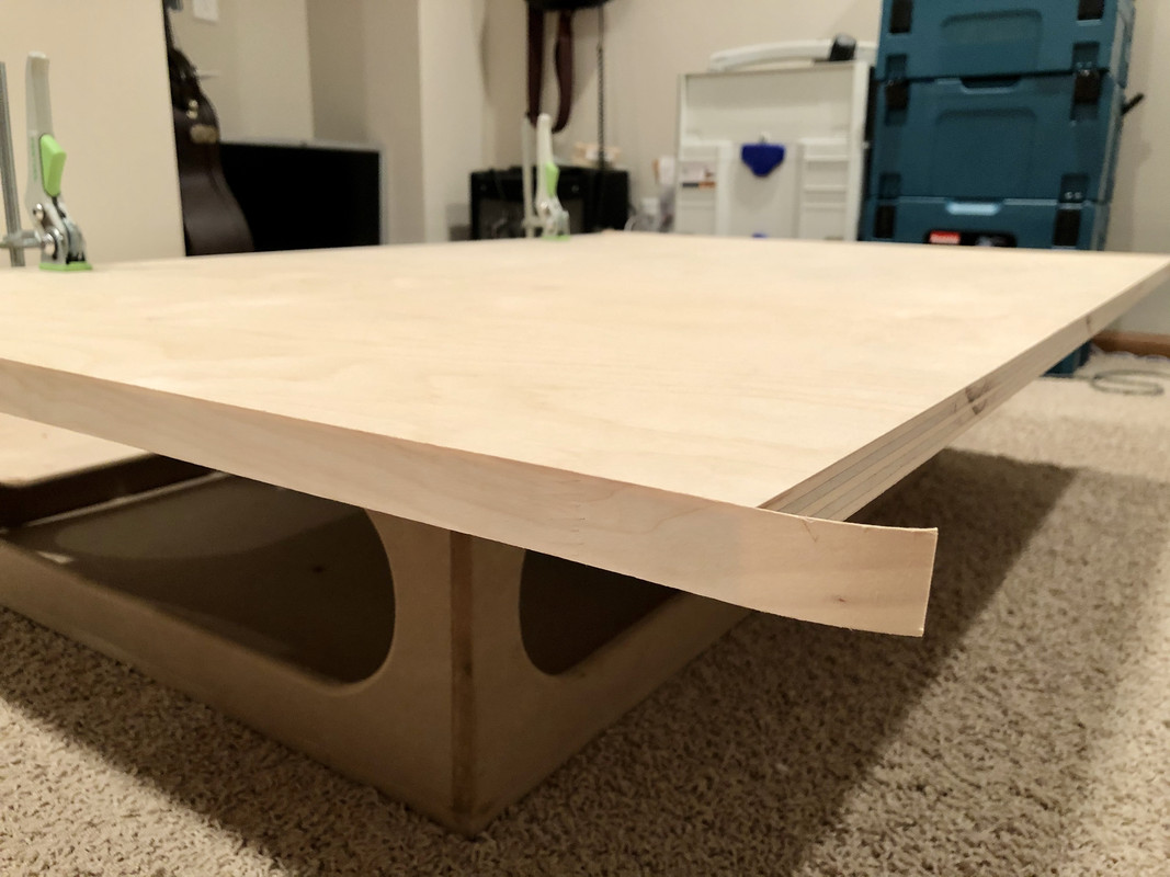

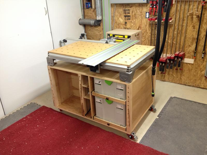

I wanted to make some progress on my tracksaw bench last night, but it was far to cold to be out in the garage.
So I brought my work inside :)
The worksurface of my MFT cart disconnects so I just took it into my basement where I am storing the plywood pieces for the bench, and my Systainer tools.
As an added bonus this way I can have a glass of wine and listen to Spotify. My kind of woodworking! :thumbup:

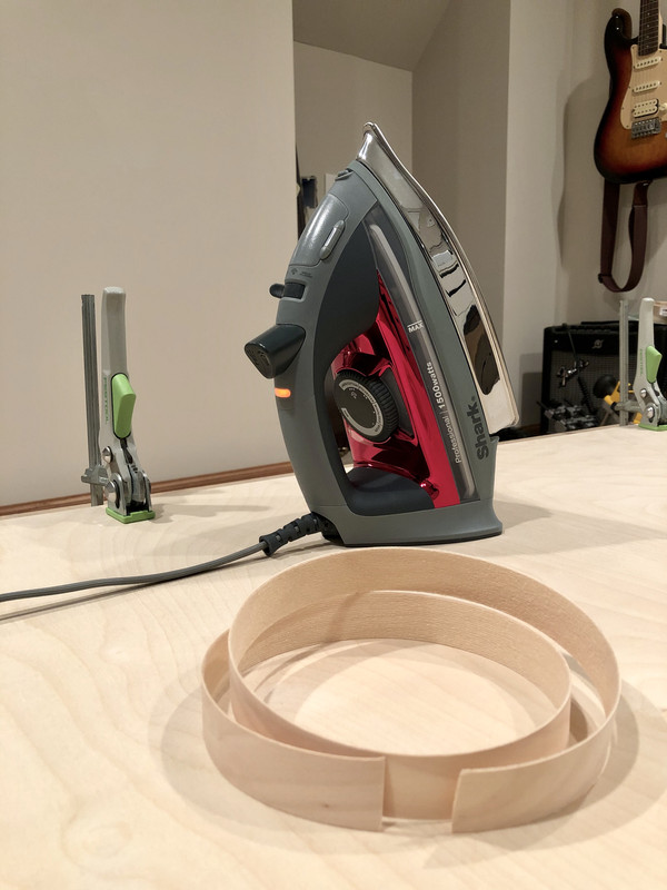

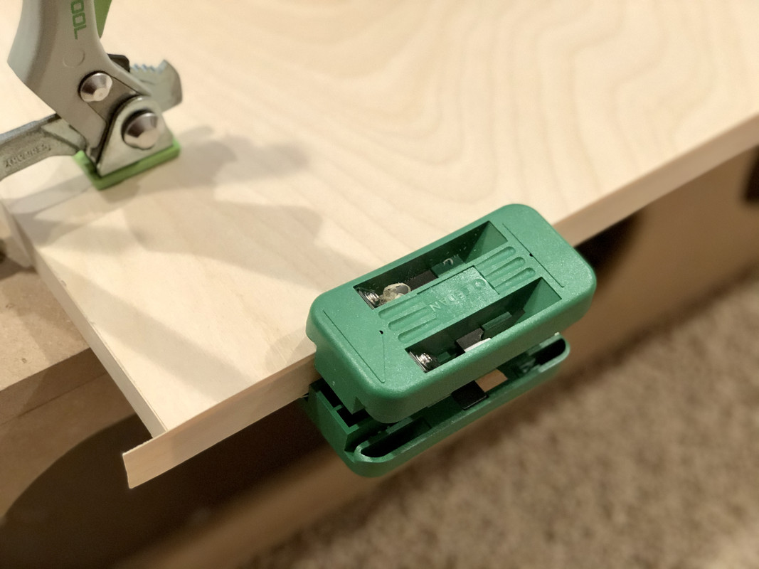

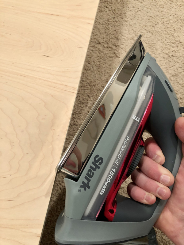

My goal was to put edgebanding on the top and bottom plywood pieces of the carcass.
I haven't ever found the need to use a pressure roller. Sometimes I use the heel of the iron if I need to add some extra pressure.
A trick I learned for trimming the ends is to lay the piece vertical on a workbench and hit the backside of the edgebanding with a chisel. This works really well, is clean, and involves no specialty tools.
Trimming the sides I had some issues last time when I made the table saw cart. For the sections I couldn't get on the router table I free-handed with a flush trim bit and the bit scored the plywood surface here and there. This time I decided to try a razor blade edgebanding trimmer:
I wasn't happy with it. It cuts both sides at once, and you are supposed to go with the grain to avoid tear out. Well... if the grain goes diagonal like it was on most of my pieces, one side will always be cutting the wrong direction with two cutters. For the most part it worked, but I got a few sections with less than stellar results:
I did think ahead and prioritized the grain direction of the "top" edge that will be more visible. Not a big deal for this shop furniture, but I have some projects in mind for the house that will use edge banding. Anyone have a recommendation on how to trim it that isn't a pain and ruin the edges?
I am realizing this tracksaw station build is going to be a lot more involved than I thought. My goal is to get it done by the time nicer weather rolls around this Spring. Then hopefully this summer I can knock out a few real projects now that my daughter is a little older.

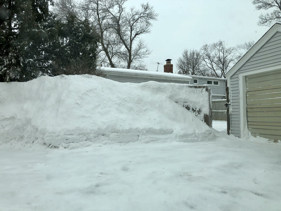

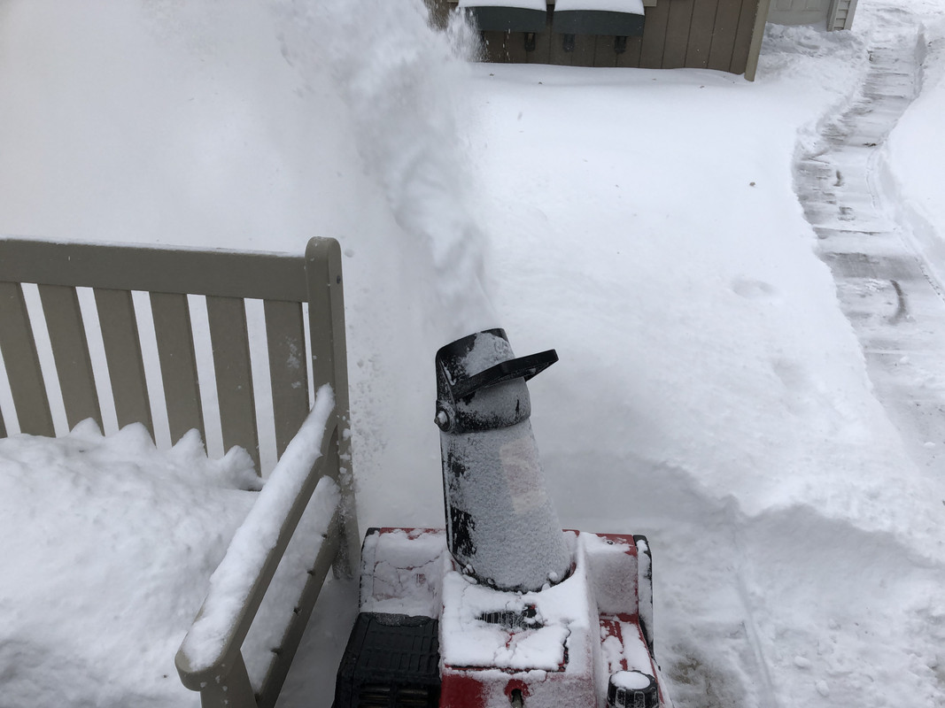

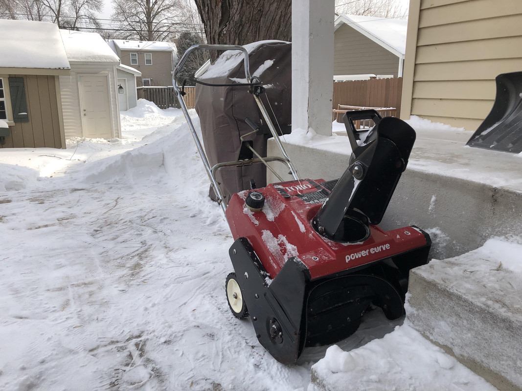

Weekend update:

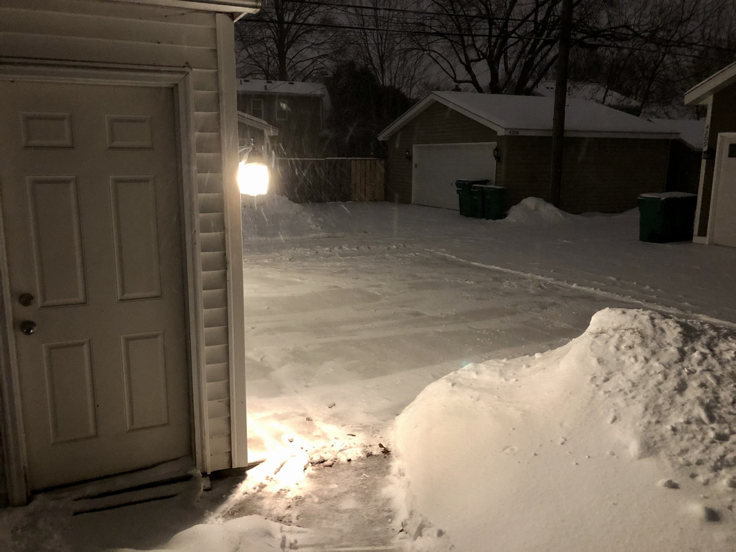

We got about 5" of snow Friday night, so Saturday morning I spend clearing it. My dad got a new snowblower and offered me his old one, so I accepted to test out on this snow storm.
It's an old Toro PowerCurve. Not sure but at least 20 yrs old.
It did an excellent job of clearing my deck and driveway. Then I made the mistake of shutting it off. I couldn't get it to start again (it's been finicky for a long time), and I think I flooded it. Later I got it started but wouldn't stay on. Later that evening my wife said it smelled like gas outside and sure enough it was sitting in a puddle of gas. So... I guess it has a leak now. No wonder my dad wanted to get rid of it :lol:
But the gas engine worked so well compared to my electric SnowJoe I am tempted to invest in a new one that isn't broken. When it really snows here, snow removal can be quite the chore, especially in an alley space. Here's a pic of a neighbors fence from Saturday:
And a pile 2x as high as my car from the plows at Home Depot parking lot:
Add in 40mph winds and windchill around -25 F and you'll start to realize why I brought my tools inside :lol_hitti

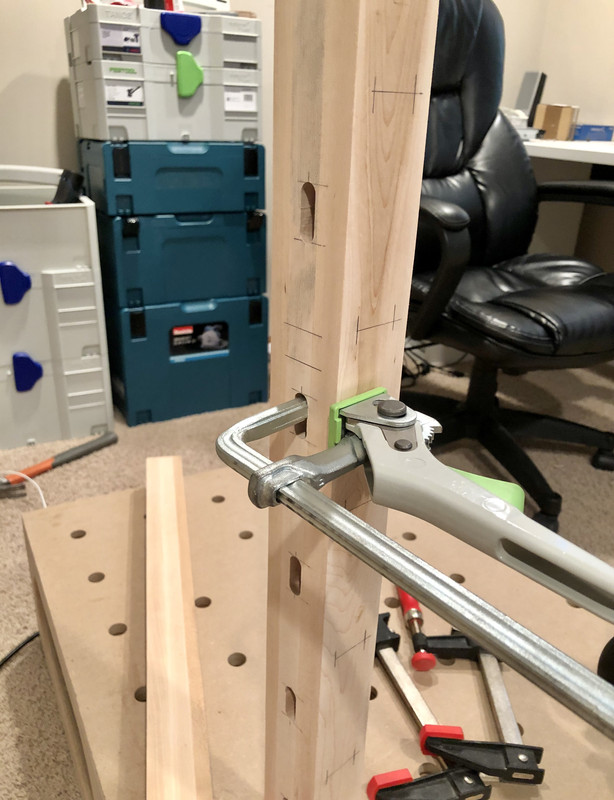

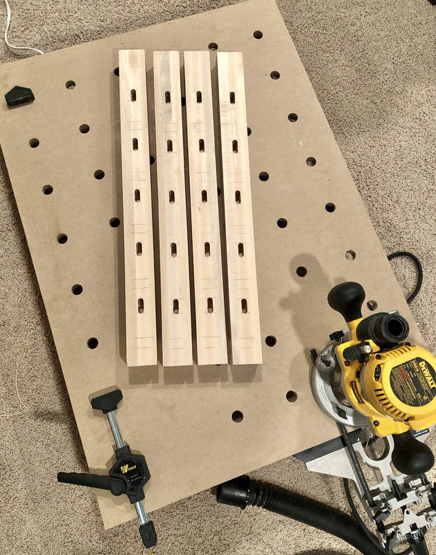

Earlier in the week I laid out 50 mortises for the tracksaw bench legs. Each one has a start line, stop line, and center line:
Woodpecker TS-3 made this a breeze. Essentially instead of holes, I'm emulating Timothy Wilmots "System Workbench", in which he made these mortises for clamping options with the Domino. (Yes, Bret, you were right I like his style!). :thumbup: Example below:
To do this I used my plunge router with edge guide:
Each mortise will be 1" deep so I did each one in 4 passes.
Because of the depth and it being tricky to know when I'm at the start or end of each pass, I quickly resorted to drawing start and stop lines in pencil on the first pass so I could re-align the base and make sure not to travel too far. Wouldn't want the bit accidently grabbing into an inch of material.
Proof of concept:
All the vertical mortises finished:
Now I need to do the 30 horizontal mortises on the fronts. Will have to take a bit different approach for this.
I will say dust collection worked quite well on the plunge base, but still a lot of fine dust in the air. I've been putting off an air cleaner because it's such a boring purchase, but I don't think I can afford to go without one any longer. Probably gonna need to cut the rest outside... despite the cold.

...But the gas engine worked so well compared to my electric SnowJoe I am tempted to invest in a new one that isn't broken...
Sounds like a sticky float. You can try cleaning the carburetor if it is serviceable (some aren't) or you can probably track down a replacement carburetor online. A few screws and some hose clamps and you could be back in business.
Also, while I'm not sure how much square footage you have to clear on your property, if you are thinking of spending the money on a single stage snowblower, I'd encourage you to look at a two stage snowblower with electric start instead. Single stages machines work great in certain conditions, but a two stage works when you really need it the most. Doesn't have to be the biggest or the best - I've moved mountains of snow over the last 10 years with my 24" MTD. The electric start makes all the difference in the sub-zero temps.
N
nicholam77
Dec 18, 2016
2,698
Minneapolis, MN
Thanks for the advice. I think I am going to try to get it fixed. Ordinarily this is something maybe I'd research and give a it a go if it seemed simple enough. But lately I've been a lot more judicious with my time on these sorts of things. It's simply too dark, too cold, and I'd rather spend my available time playing with my daughter these days. :D I did call a small motor shop near me and they said similar to what you were saying... sounds like it could be a carburetor issue. I think I'm going to take it in and see what they estimate for repairs and a once over/tune up. I watched a few YouTube vids on this model and they seem to be generally a good machine so maybe a real tune up will breath some life back into it and make it easier to start as well. I hate to throw a piece of good machinery in the land fill when it could still see some use...
If the estimate comes back too high where it doesn't make sense to repair, I'll consider what you said about 2-stage, although to be honest I don't have a large property to do. That's why I've always been on the fence about owning, maintaining, and storing a blower, but it's the 4-5 times a year we get a large amount that makes shoveling really ****. Don't get me wrong, I definitely covet a big 2-stage, I mean they just look badass and fun to use, but in terms of cost and space to store I'll have to think that over if I could justify it.

I've been going back and forth with the flooring store salesperson quite a bit about the Marmoleum for the kitchen. I've ordered a lot of samples from the manufacturer, and they vary quite a bit in color:
I am happy with the sample labeled #1, the warmer one. The #2 is way too blue for our orange-y cabinets I think.
I am trying to see what can be done regarding requesting a warmer "dye lot" and/or approving a sample before placing an order. With this much variability in the product I don't want to roll the dice on what we end up with. If we can figure out a solution, the floors might be happening fairly soon. If not, it might be back to the drawing board. :mad:
Switching topics, any woodworkers out there have a suggestion on how to attach the legs in the below workbench to the plywood top and bottom (I'm pretty much copying this design)? I will be using biscuits and pocket screws for the plywood-to-plywood connections but wasn't sure how to connect the legs. The one below doesn't seem to have any visible screws or dowels or anything.
Thanks!
