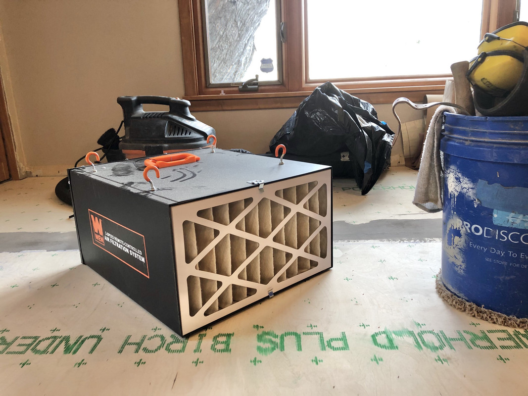

Did the new air filtration help??

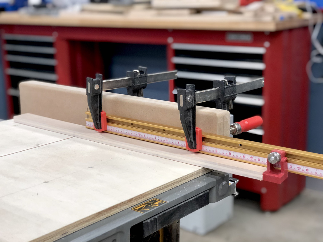

Yes and no, with that specific task. I think overall it is helping clean the cloud of fine dust in the air that can hang around after cuts on the table saw, especially.
But routing this 3/4" MDF was just too much. I had the shop vac attached to the router fence but it just wasn't close enough or getting very much collected. The new filtration unit is currently hanging above the router table, and the filter got completely covered while routing, so much so that I had to shop vac it clean afterwards. But also due to the positioning it was pulling the dust right up past my face, and with no good way to do dust collection there was still a lot of dust expelled into the air. More than it could capture. I really needed a downdraft box on the router table.
So, totally not a replacement for collecting at the source, but it's not supposed to be anyways, and yes, overall the filtration helps keep the air cleaner out there.

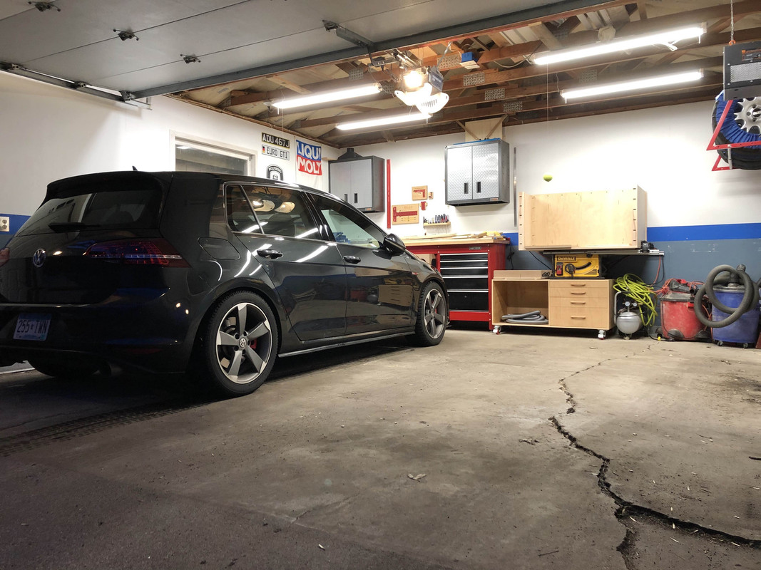

Yesterday when I went out to my car in the morning to put my daughter in the back for daycare, her door was stuck shut. Eventually I realized there was a clear, syrupy goo on the door that had seeped into the door seals making it sticky. Then I noticed it was also on the roof, sunroof, part of the windshield, ALL over my hood and random drips on both sides of the car. Picture maple syrup but clear and somewhat frozen. I have not gone through any puddles, and park in a ramp at work. I have NO idea what could have caused it. I googled it and apparently throwing corn syrup on cars is a funny prank kids do? The only times I had it out were in front of my house when working on the track saw bench, parked downtown for an hour while we went to dinner Saturday, and in my ramp at work. It's so bizarre, but I don't see how this amount of super sticky stuff could have been accidental.
Anyways, pissed, and I took it through the car wash last night. You know, the kind that rubs steel wool rollers on your car, grinding in the re-used road salt water. :lol:
I kid, but normally I only do touchless washes... or simply don't wash it at all. :)
But parking a clean car in the garage for the first time all winter made me want to snap a pic. Featuring my beautiful concrete.

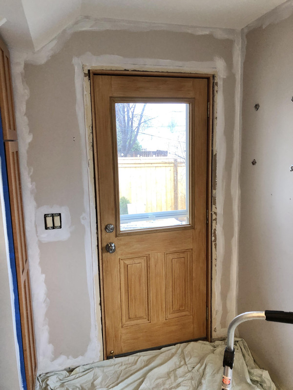

The other thing that morning when I walked out to the car, the "man door" to the garage was open. Like wide open. It's a piece of **** door that is ill-fitting and warped, and if I forgot to lock it it's totally possible it popped open on its own. But it did make me think for a split-second... did someone enter my garage overnight and splash my car with some syrup gunk? I quickly dismissed that, but I do have a Wyze Cam on the way from Amazon I intend to try out in there for peace of mind. So future post on that.

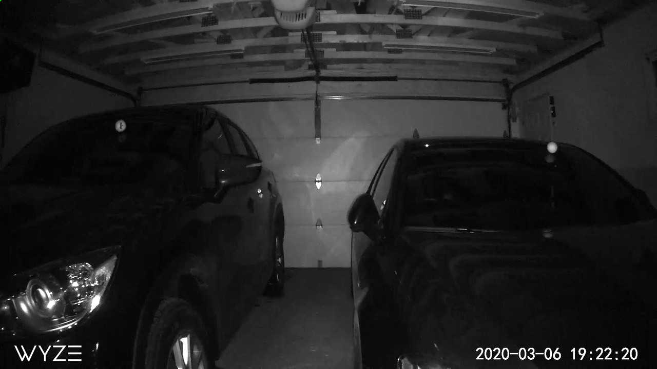

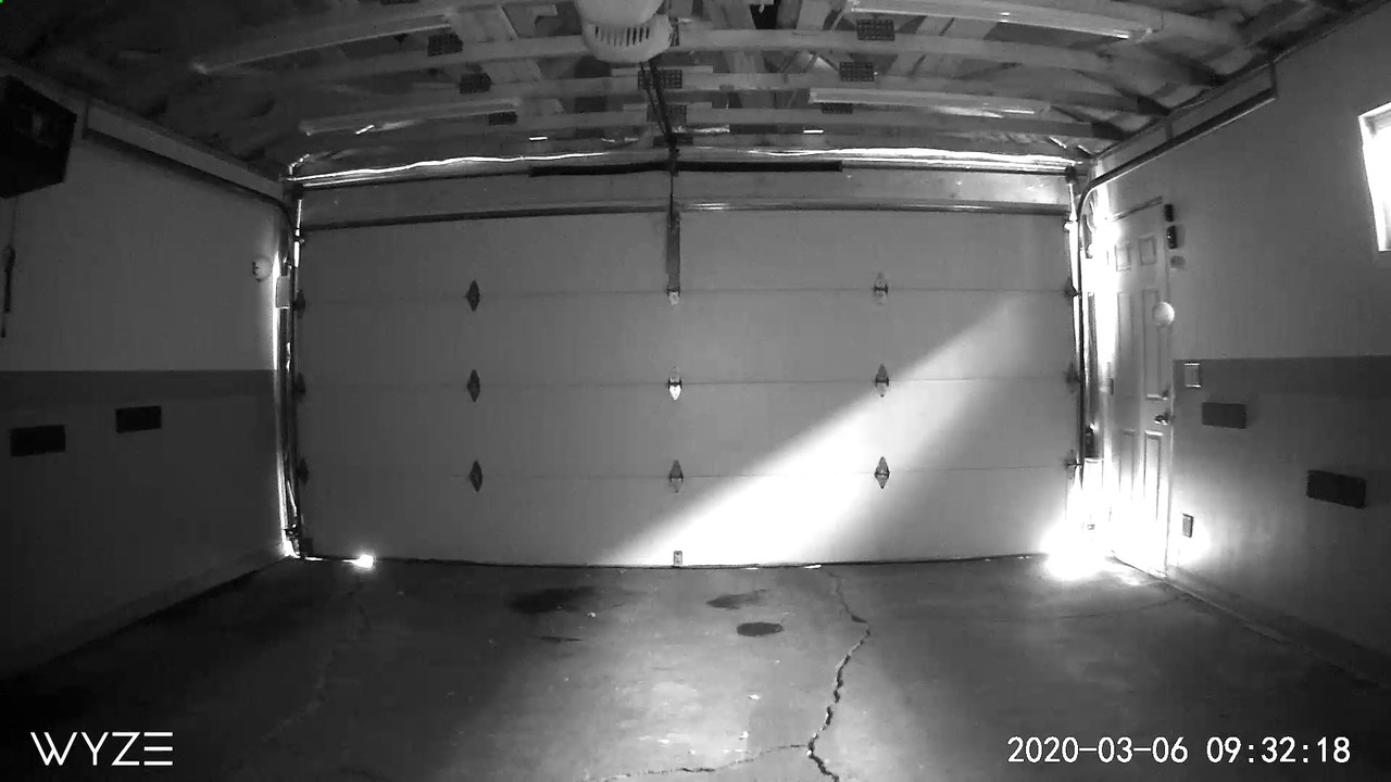

The Wyze cam showed up and works reasonably well. Can't complain for $25. I just set it on my workbench for now, but I'll have to get it mounted proper.
At night with the door closed and IR filter on:
During the day with door closed and IR filter on. You can see how awful the gaps are around the garage door and floor! I really need to get them sealed off.

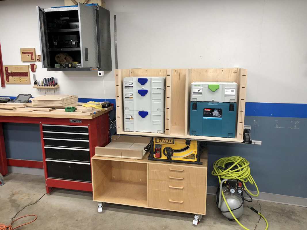

Weekend Report:

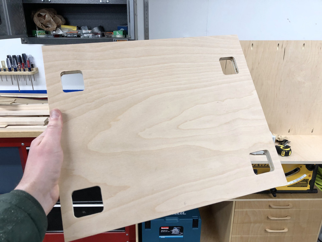

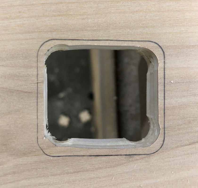

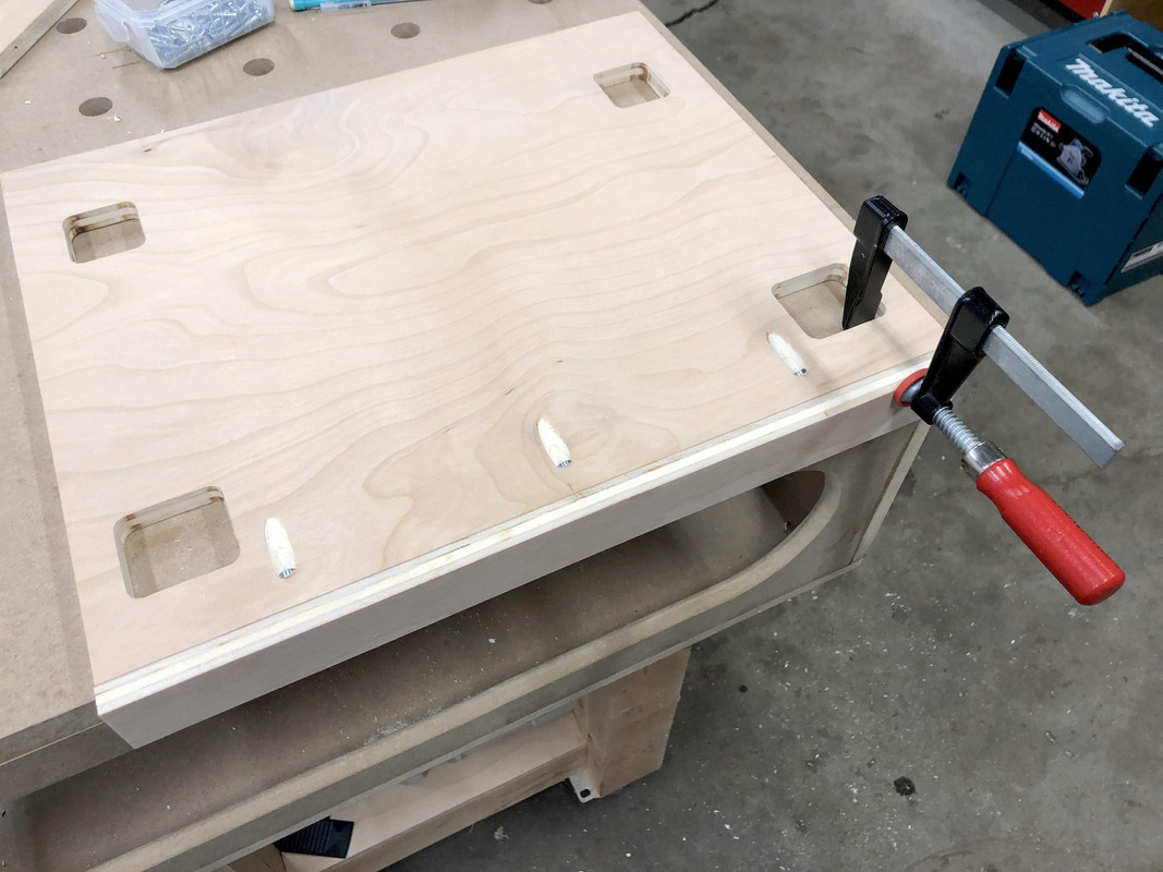

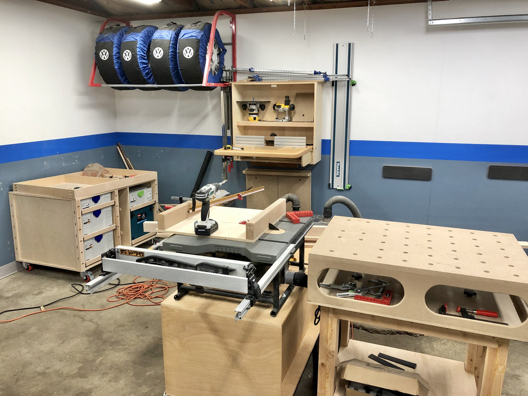

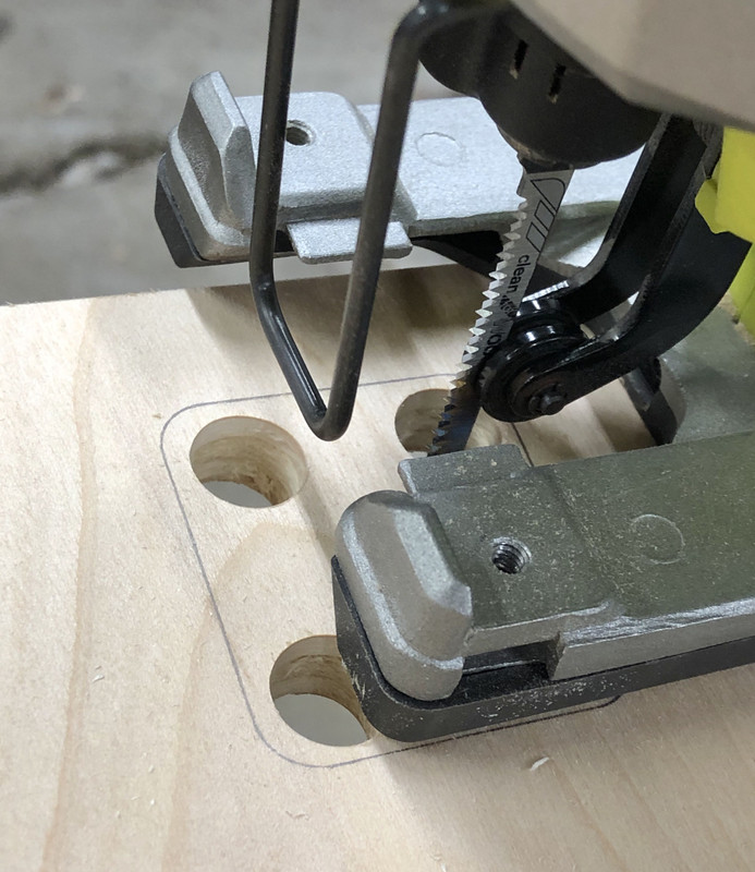

Got another couple hours on the track saw bench and some minor setbacks.
I continued working on the Systainer drawers. I cut the plywood "drawer" to size, pop it in the jig, and mark in pencil where the cutouts will be. Then I remove most of the waste by drilling out the corners with a Forstner bit:
And connecting the dots with the jigsaw:

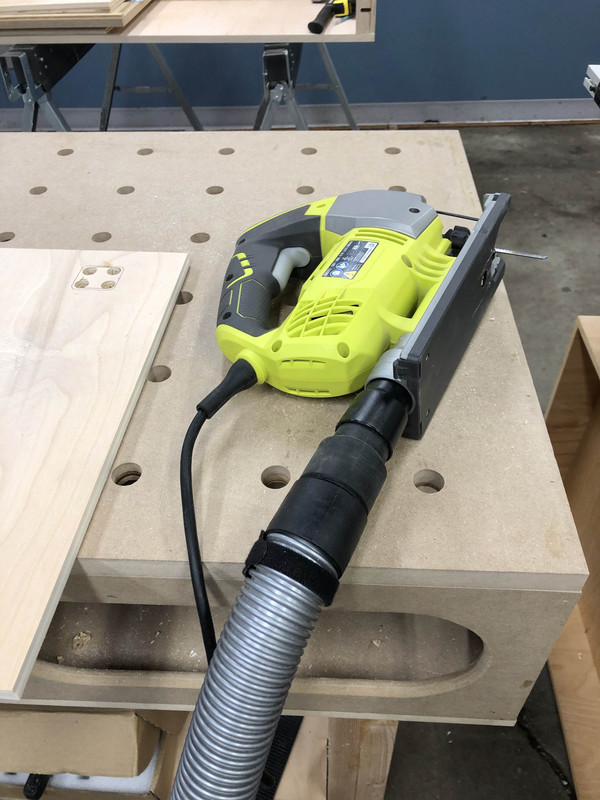

Connected the jigsaw to dust collection for the first time... works mediocre.

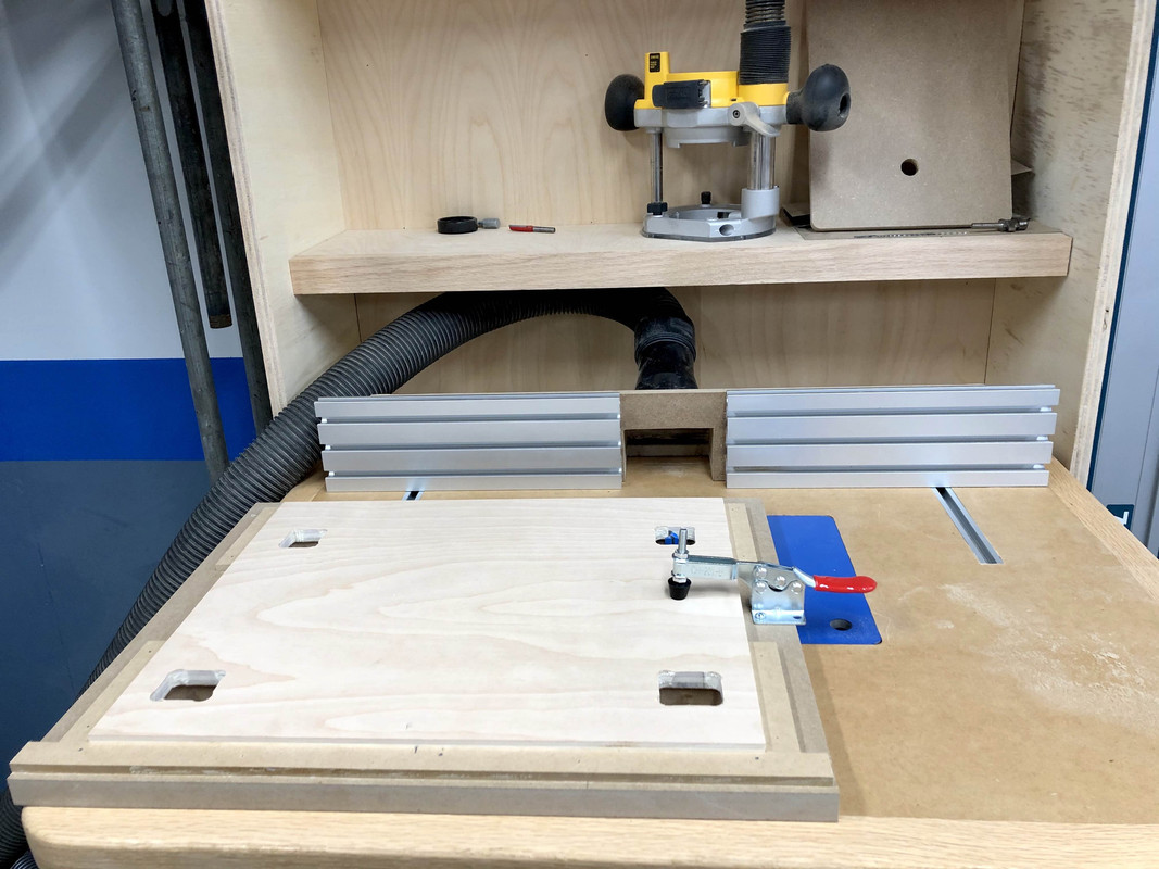

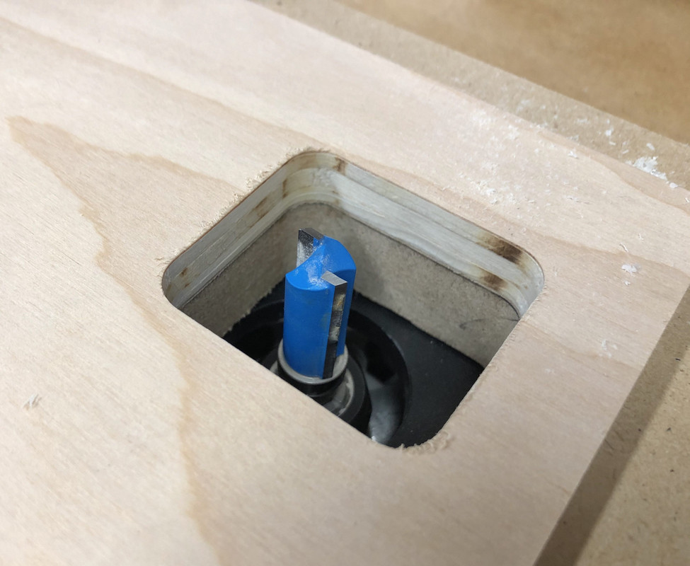

With most of the waste removed I pop the drawer in the jig and flush trim with bearing bit.
Then I'm left with a nice accurate cutout that fits the Systainer tightly.

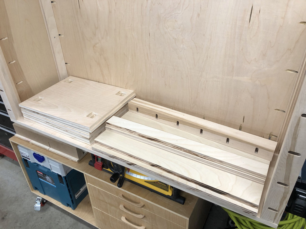

Here's were I goofed. I made the drawers 13" deep, and got 13" drawer slides. What I forgot to account for was the 3/4" front pull I planned to attach, and that to open the lid of the Systainer fully it really needs to slide out more like 14". I only have 14" depth to work with on the bench, so new plan is to only do a 1/2" pull on the front, that doesn't overlap the drawer slides, and do 14" slides. It's going to be a really tight fit, and not how exactly how I wanted it, but I've put so much work into it so far I'm not sure of another solution.
While I was routing the shelves I went ahead and made a few extra in case I add more drawers later, or somewhere else in the shop.
I also cut the other two 3/4" divider pieces to size, so as soon as my new drawer slides show up I should be able to start putting things together.

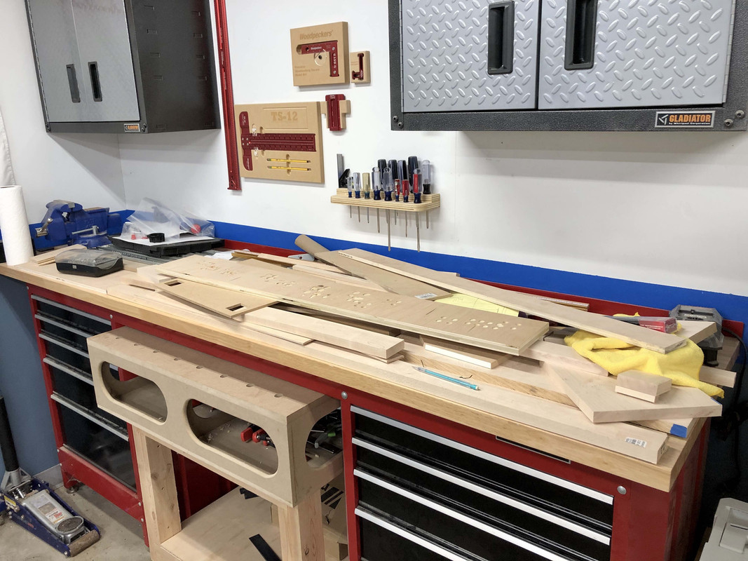

Another looming project... a place to store my damn cutoffs. I keep stacking stuff on the bench which is super annoying.

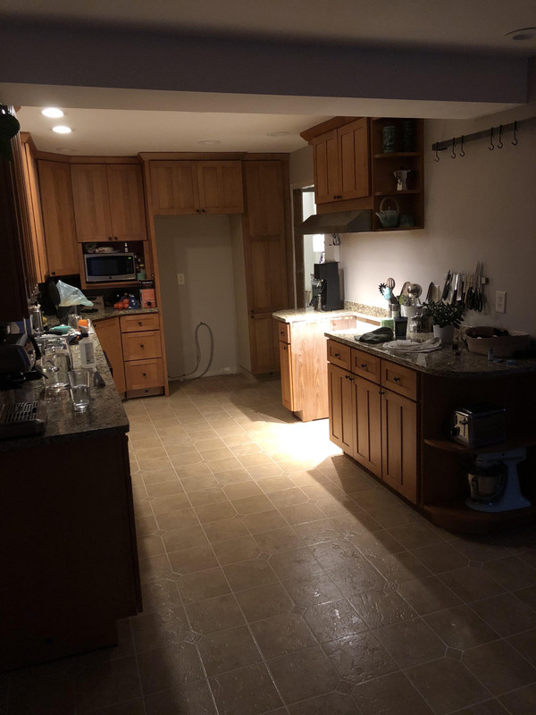

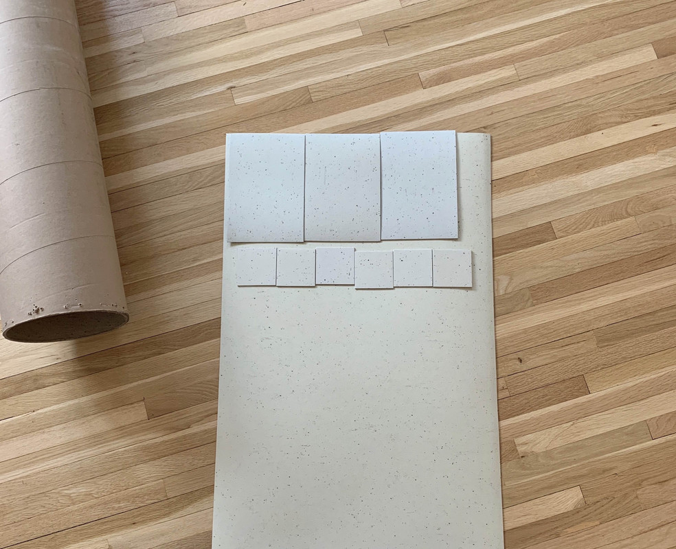

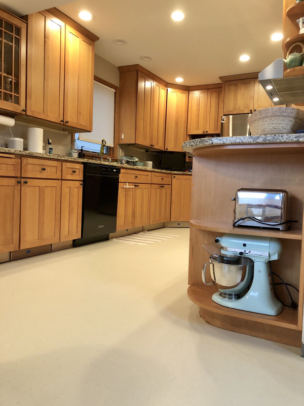

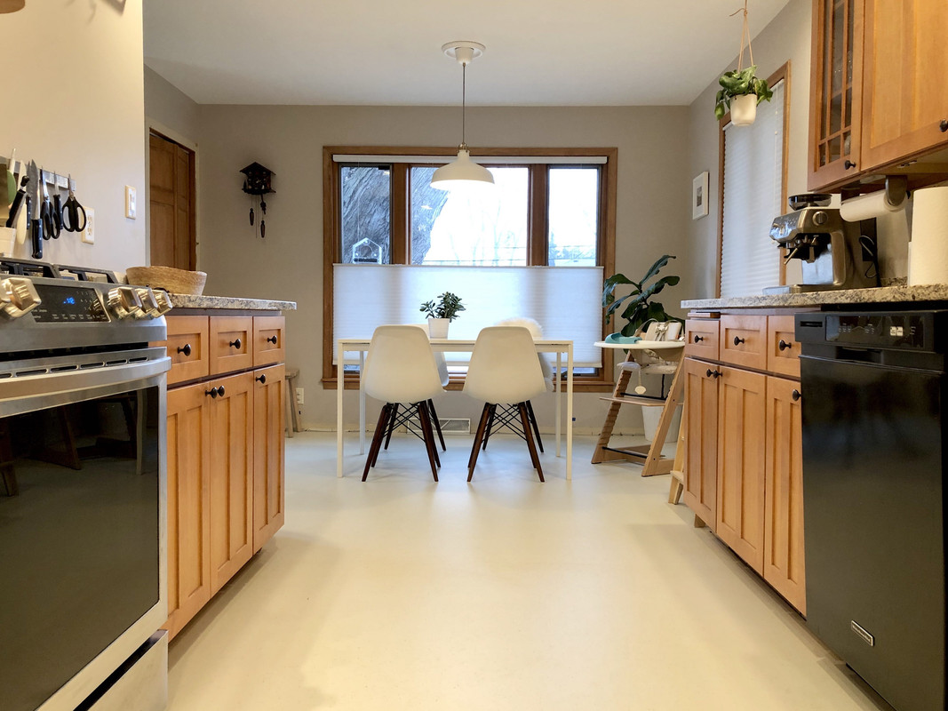

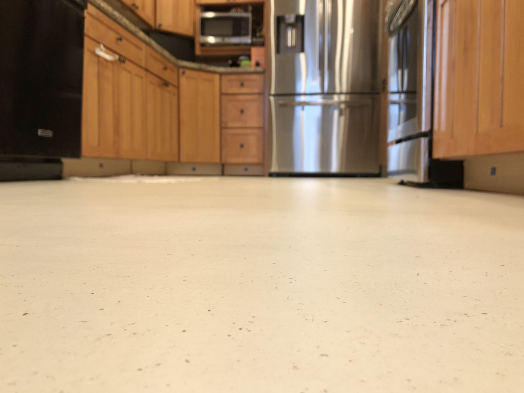

Kitchen flooring is a go. I arranged for the flooring manufacturer to send a cutoff of the material we'll get for "dye lot" (color) approval. I received that a few days ago and have been scrutinizing it.
It's a really interesting material... it definitely is a shape shifter and appears different in different lights and angles, which can even be seen in these two photos. Sometimes it looks far too green to me, but other times it looks just about right. I wish I was 100% confident, but my wife really likes it so I've taken the leap and committed.
Install is about a month out, in the meantime I will have some trim removal to do, and make some transition/threshold pieces out of wood, which I will document here.

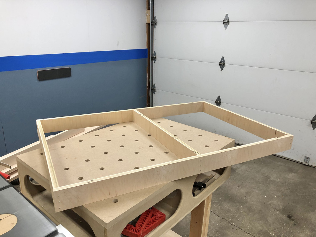

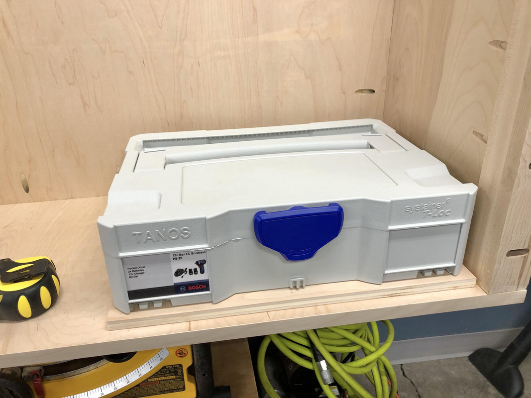

Added the middle dividers, one edge-banded, one attached to "3rd front leg"
I'm REALLY hoping these Systainers are going to fit with the drawer slides, I hope I did my math right. I know it's going to be tight.
Almost ready to put the top on, install drawers, and move on to the MFT portion.

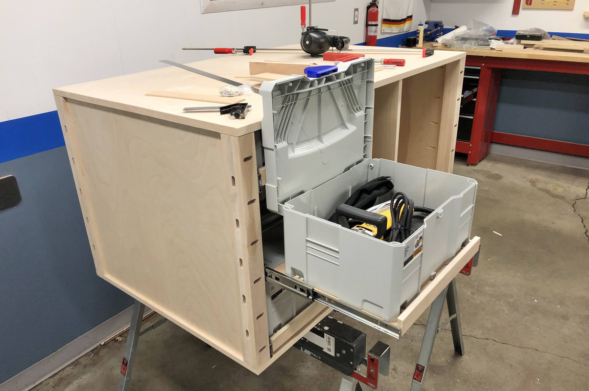

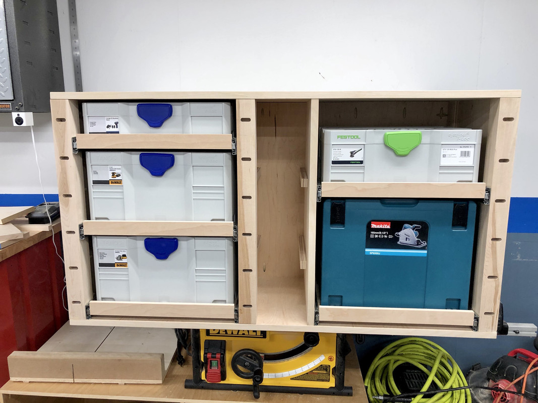

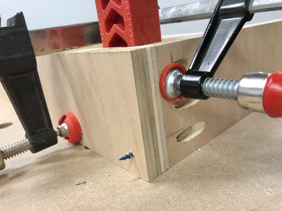

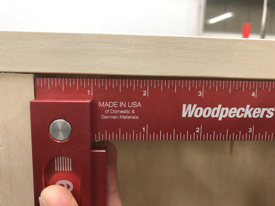

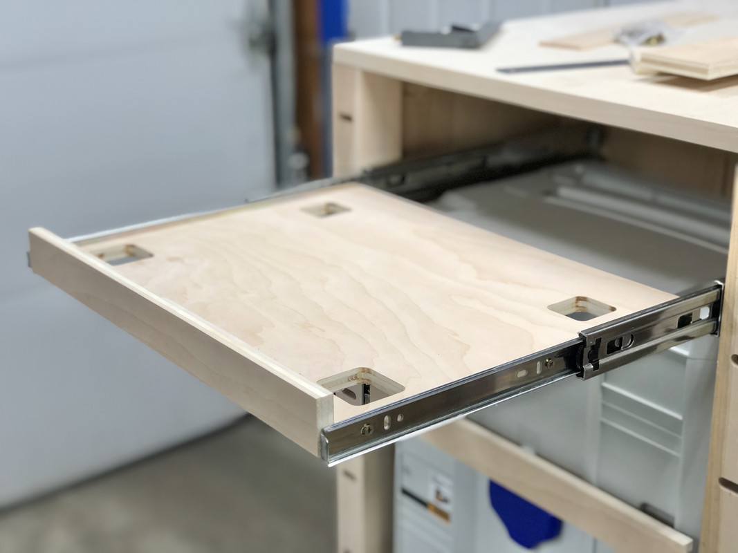

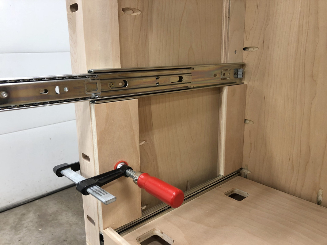

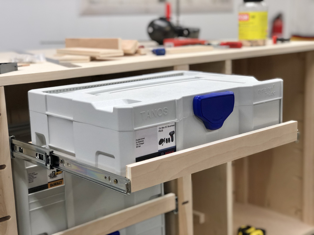

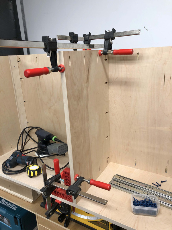

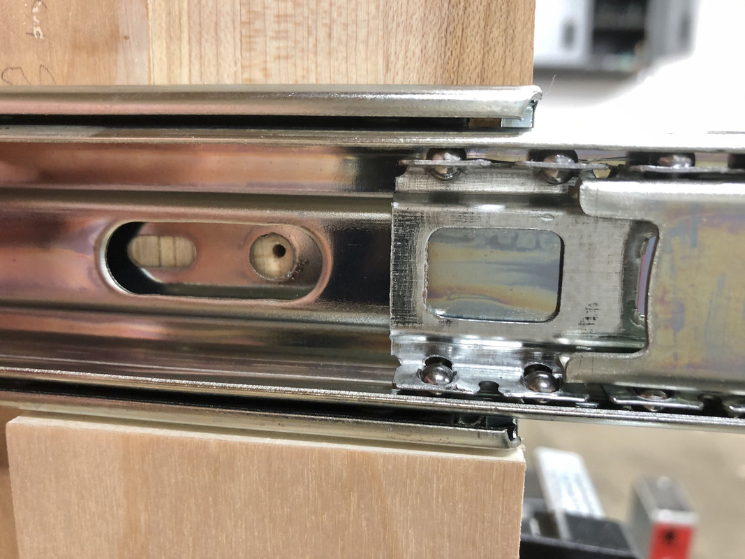

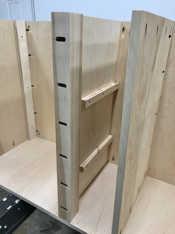

I've been able to get the top on, and get all the drawers mounted. After a LOT of repetition and steps, this feels like a big accomplishment to me. I still have a ton left on this build but looking back I can hardly believe I've made this thing during evenings and nap times.
Before sealing it off I added some cleats in the middle cavity for some future shelves:
Take a square to the top or look inside and you'll see some dirty little secrets:
Spoiler alert... all my drawer slides are working well, but these pics illustrate exactly why I'm making this bench. Building square cabinets is hard. Especially without an accurate means of squaring the cuts, or repeatability. I feel like if I had this bench to make this bench, most of my errors would be eliminated.
Drawer pulls are cut with crosscut sled for repeatability:
And fastened with the mighty pocket screw:

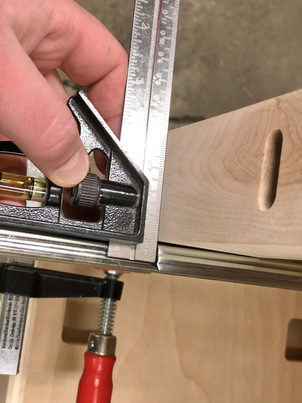

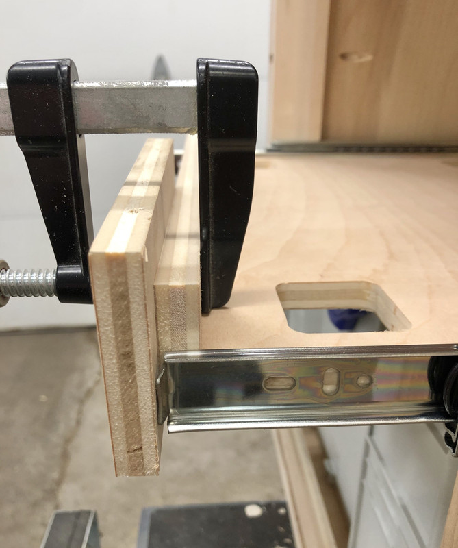

Not sure anyone is interested but this is my process for drawer slides. Start at the bottom, and use a combination square to get the slide aligned with the front of the cabinet (or set it back a bit if necessary). These I went flush.
Each slide sits on spacers to ensure level and exact spacing both sides:
Then with the "height" and "depth" set I hold it in place and carefully mark the screw positions with a scratch awl, and then pre-drill and screw in place:
1/2" plywood as a spacer to set the height of the next drawer:
Attaching the slides to the drawers, I clamp a stop block to the drawer face so the slide has something to register to to get it flush:
And then same thing, awl, drill, and screw in place. Slide the drawer out further, and repeat on the middle holes. For the rear holes, I remove the drawer at this point and put the last screws in on the workbench.
All these spacers are a bit tedious to calculate, but it makes the end result/process fairly easy.
And yes, the Systainer lids open fully while in the drawer, but just barely!
So that's where I'm at! Hope you enjoyed this little update.

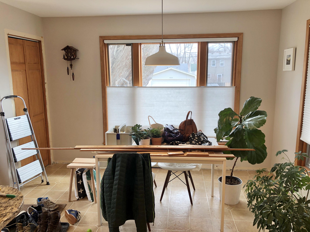

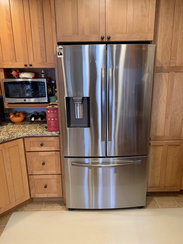

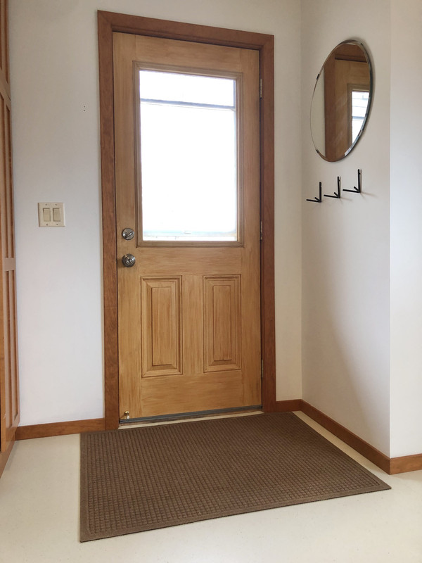

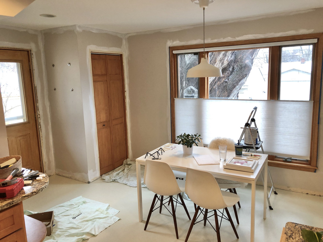

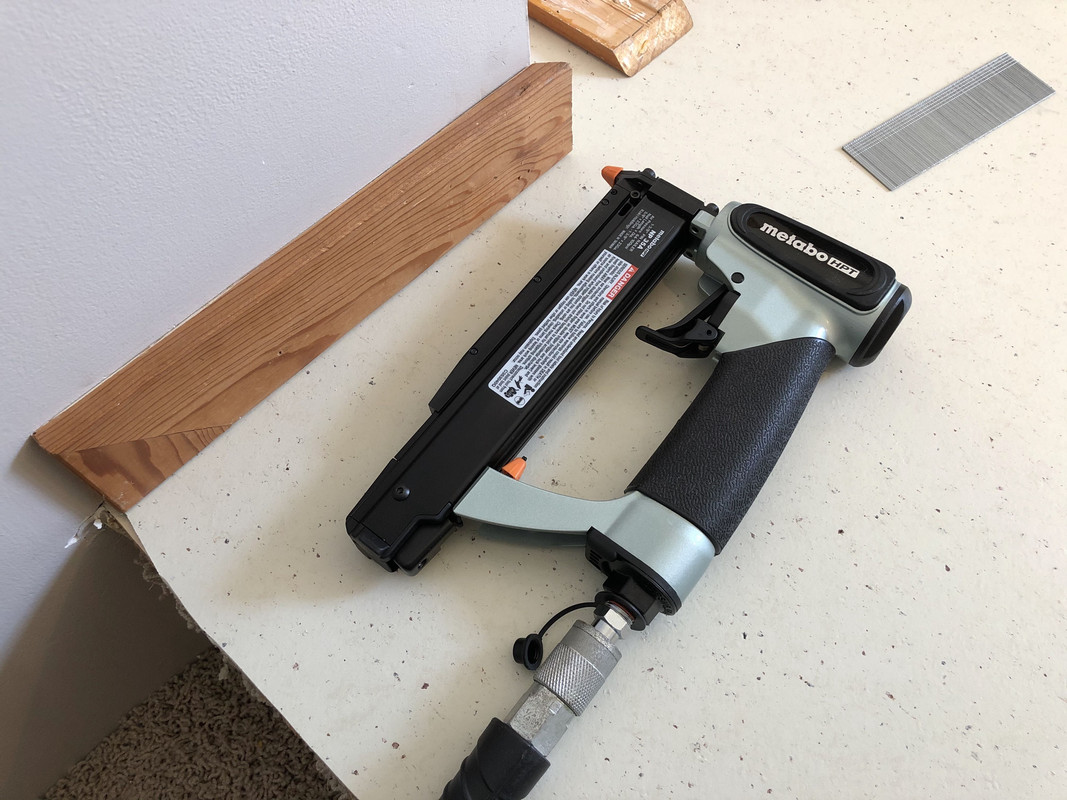

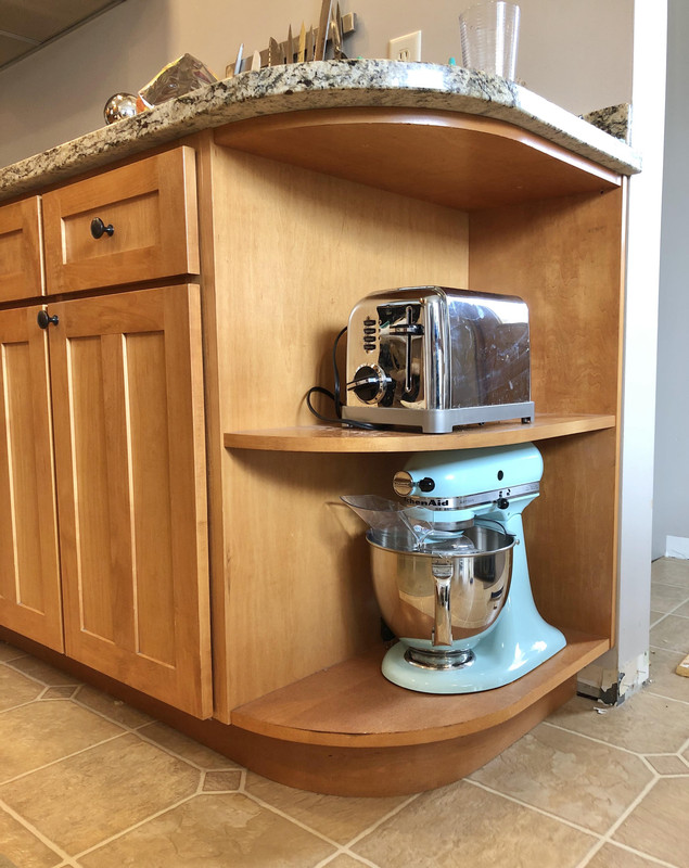

So, the kitchen flooring install got moved up. As in... should be starting tomorrow! As long as the state doesn't shut down non-essential businesses, which there has been talk of. Just need to make it through Friday.
I've transitioned to work from home, which is... interesting. Honestly I'd rather be at the office. My parents normally do daycare for us 3 days a week and are in their early 70's. They decided to stop doing daycare until the whole Covid thing blows over, which no one really knows how long it will last here. Fortunately neither myself or my wife have lost our jobs, the daycare conflict being the main problem to solve. All-in-all it seems like an inappropriate time to take on a big project, but I've been coordinating it with the flooring place for months, and they need the business right now, as does everybody. So we're going through with it.

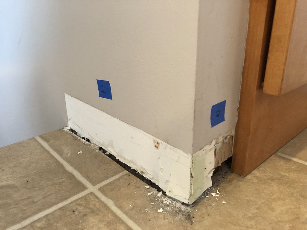

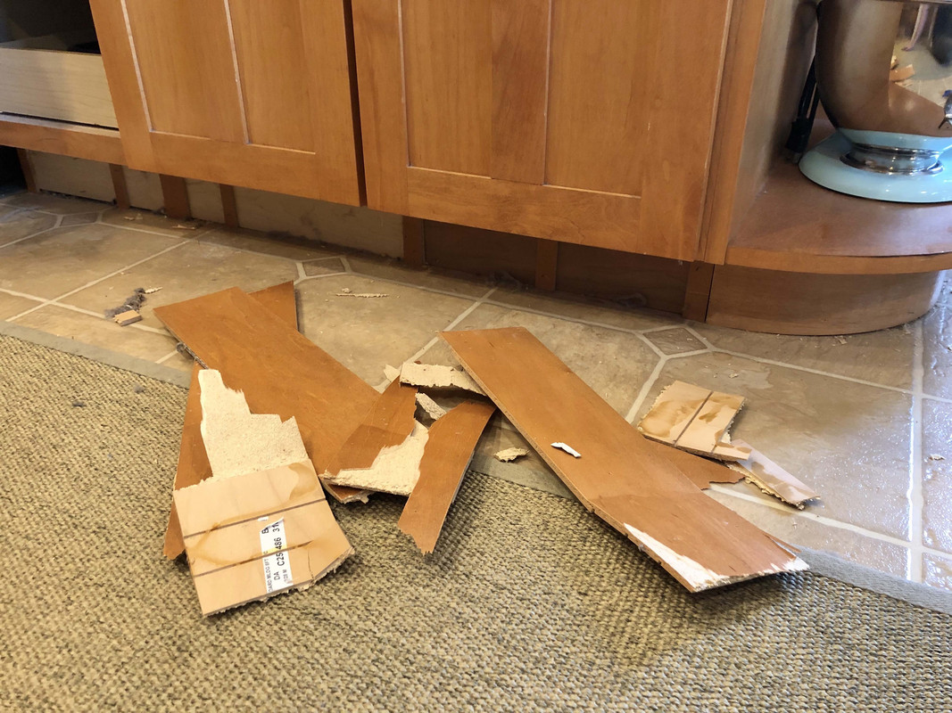

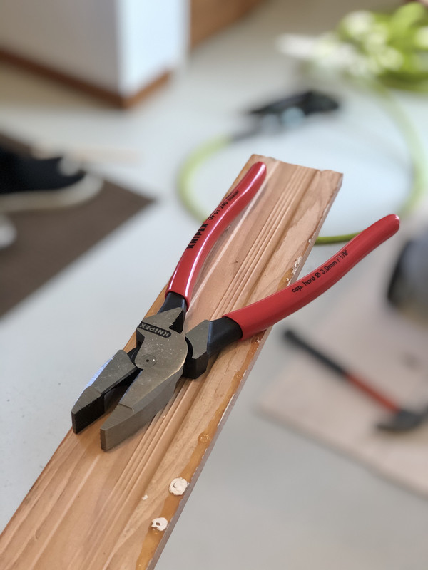

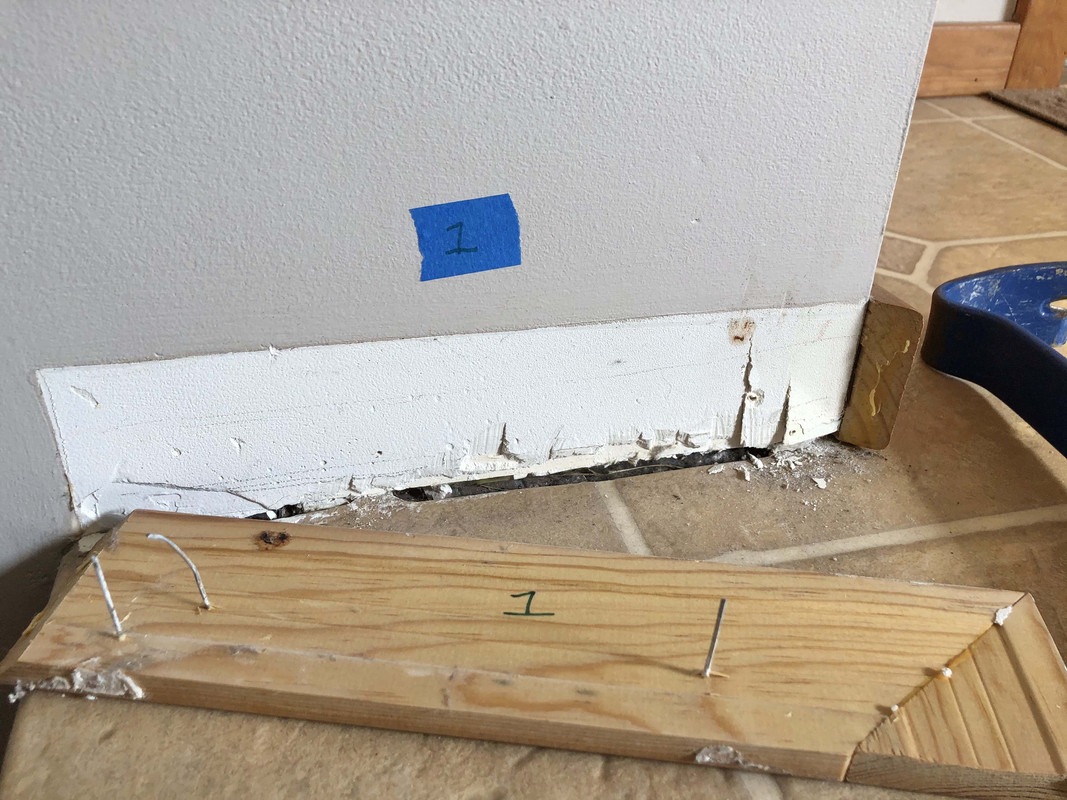

I had said I would remove and reset the trim to save some money, so I got as far as I could on that this past Sunday.
I started in one corner and every board and wall gets labeled with a number:

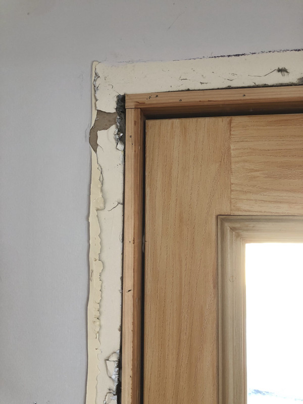

Most of it went smoothly but I ran into a few issues. The door casing was heavily caulked, and very tricky to cut free without pulling the paint away from the walls.
I'm probably going to have some mudding and clean up to do there.

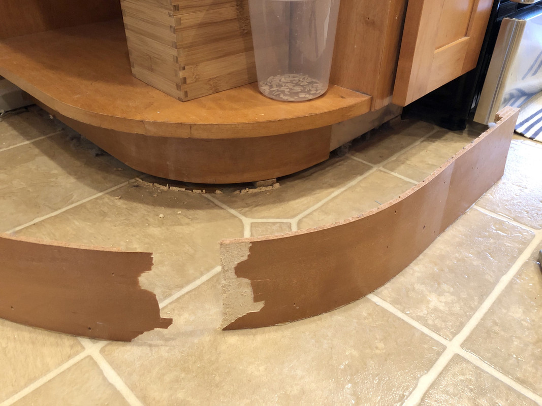

The most difficult part were the toe kicks on these curved sections. There are two of them. I love the curvature of these areas as a design detail, but unfortunately they not only pin nailed the toe kicks but also used adhesive. Made of veneered particle board, they were destined to break.
The second one went even worse. :mad:
I have one extra piece of toe kick material left by the previous owners, but it's not enough to cover both curves. I'm going to try and see if the product still exists to order, otherwise I'm *hoping* I can kerf-relief bend some 1/4" ply or even pine, and stain and poly close enough to match the finish of the cabinets.
So many nails. Many many more I haven't removed yet.
Needless to say the kitchen will be re-painted. Currently it's a very warm gray / beige color, I am thinking about continuing the same white from the rest of the main floor. I think the continuity would be nice, and it would be brighter, I just hope it looks ok with the orange-y-er wood.

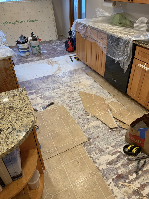

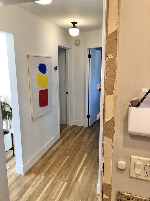

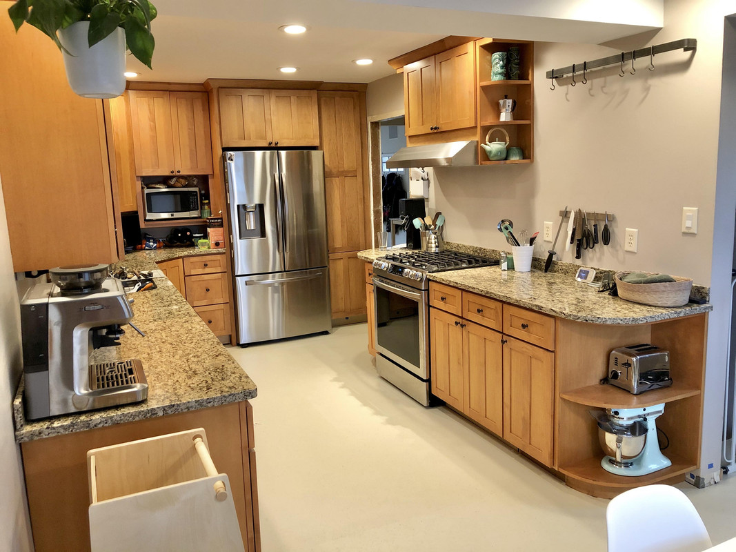

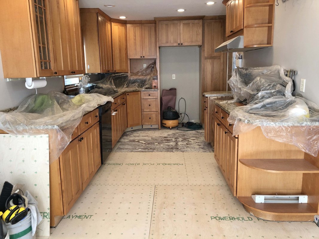

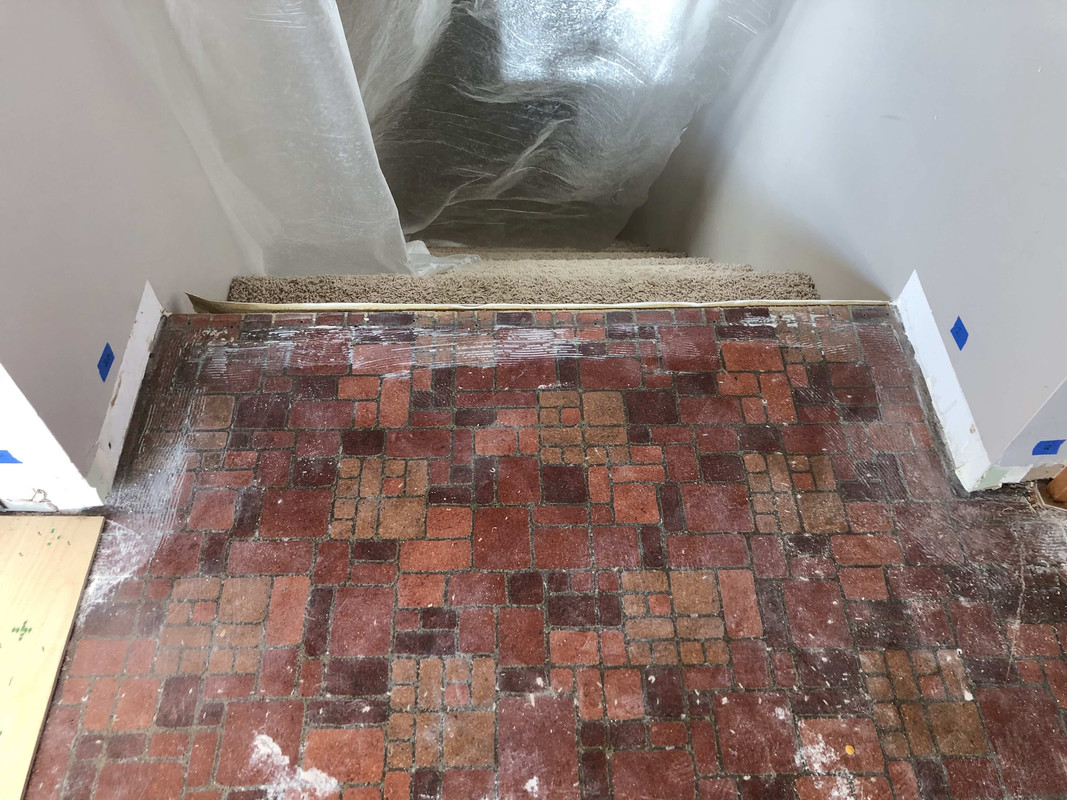

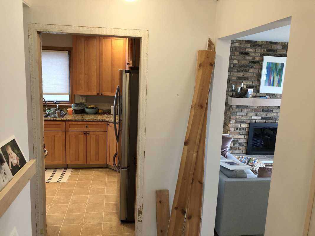

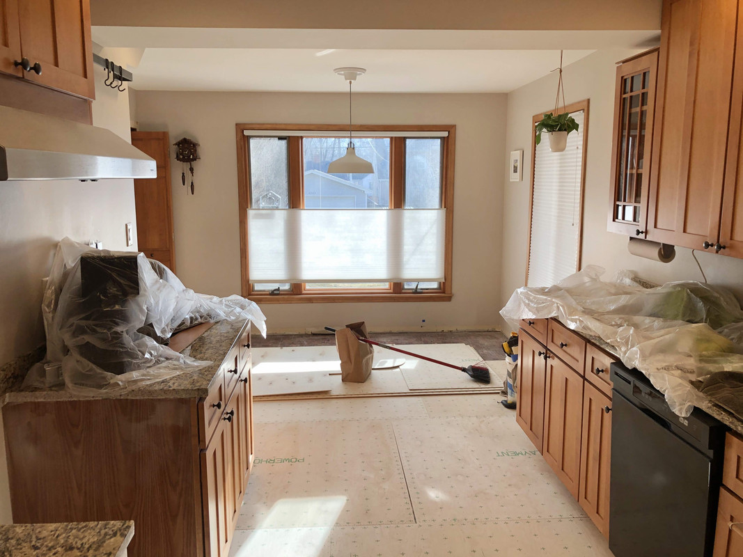

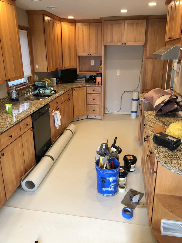

Another Kitchen Update:

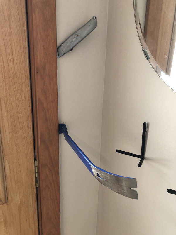

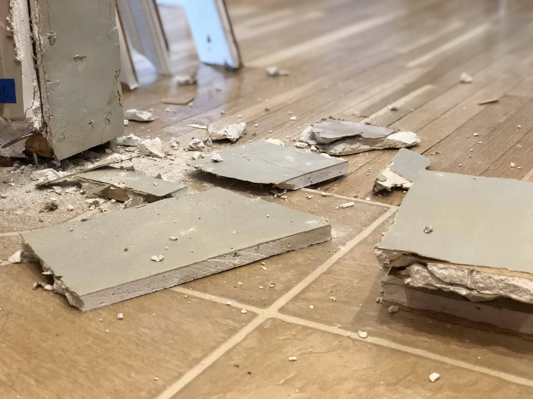

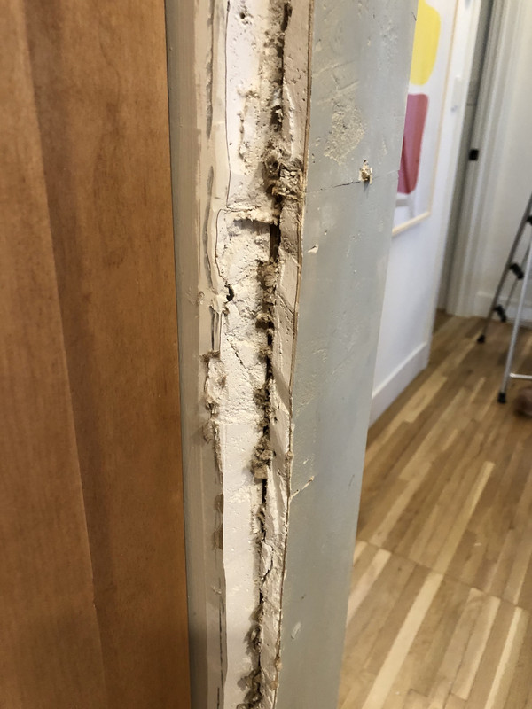

Tuesday I continued to prep by removing the trim from the kitchen-to-hallway passage, back door threshold, and closet trim.
Some drywall came with it. I'm trying to decide on the passageway if I should put some hardwood on the sides like maple and paint it white, and then casing back on, or if I should mimic the hallway-to-living room passage way and cornerbead and mud everything for a "trimless" look.
The big downside to the drywall approach would be durability, and this one really bad edge:
Any suggestions for filling that gap? Something stronger than regular joint compound?
Then we got the appliances moved to the living room ourselves. I usually try to take daytime pics because they look nicer, but the reality of it is a lot of this stuff has to happen after the baby goes to bed. So here's a night pic for ya:
Yesterday the contractor started with the demo:
You can see a better look at the original "faux brick" floor under our current vinyl, same as in those old film negatives I got developed.
And then got about halfway on the plywood underlayment:
Professional labor ain't cheap, but it's worth every penny for this project, especially in these crazy times! Need to get it wrapped as soon as we can.

For the pass through/"hallway", I'd trim the 3 inside faces with 1x poplar (paint grade). Instead of flushing it to the walls on both sides, extend the piece 1/2"-3/4" out both sides. Backfill the gaps on the drywall with hot mud then finish compound.
The collision zone near the bottom will take some small dents but it's way more durable than corner bead and has a clean look without trim on the faces.

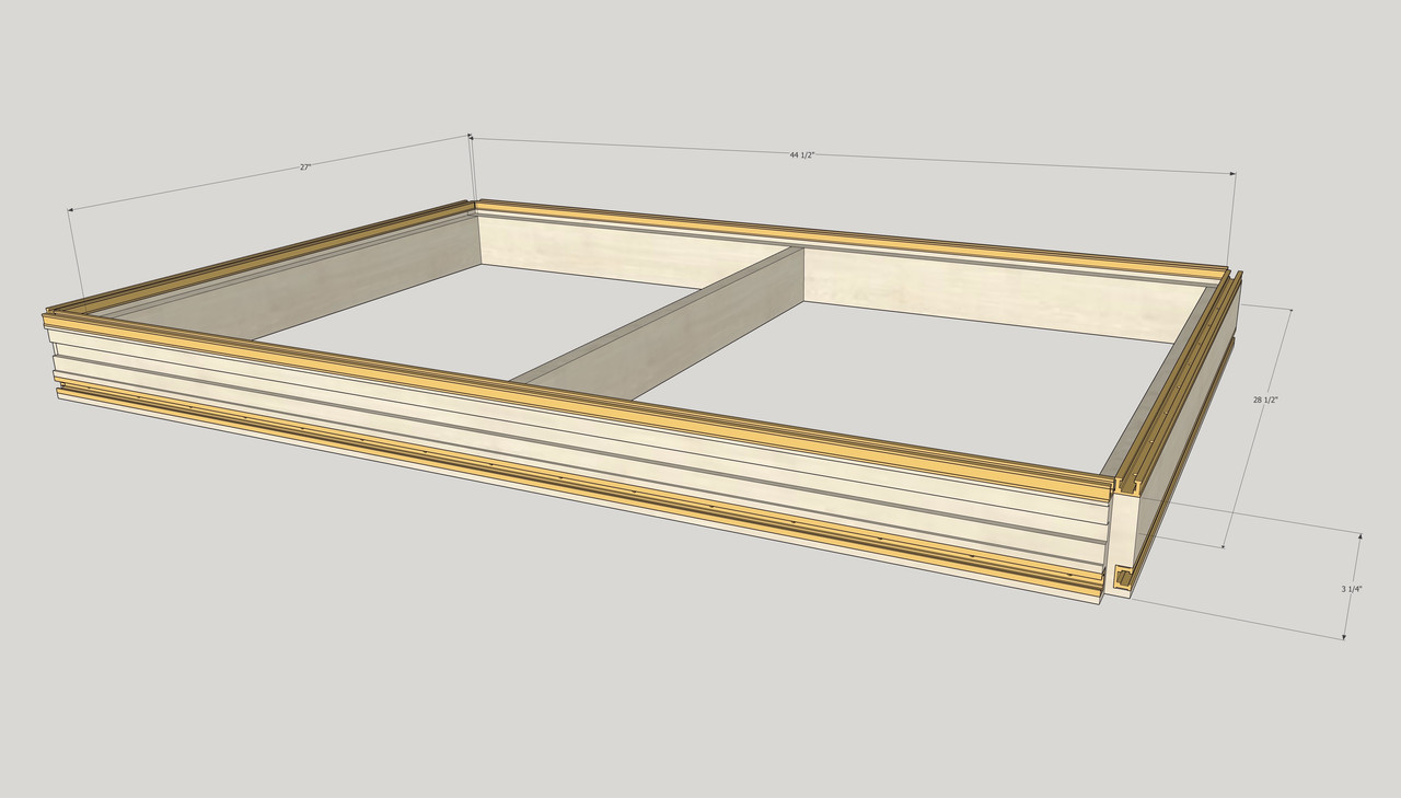

Question: What are the oval shaped cutouts on the front of the cabinet frames?
I have my own project going here to hold my small parts boxes (Dewalt Deep Pro Organizers - DWST14825):
The template was cobbled together to test fit.

Removing trim intact can be really tough especially with a lot of caulk or big nails. If you're prying on the drywall side it can help to place a 4"x4" piece of plywood or something under the prybar to spread out the load and avoid denting/crushing the drywall. Maybe you already do that, but just a tip I learned.
Ya I should be able to replace the curved sections. It's just extra work, but that's the name of the game!
Great suggestion, thanks! It was previously trimmed with a softwood and was extremely beat up.
I'll Google it right after this, but I might as well ask you, what is "hot mud"?

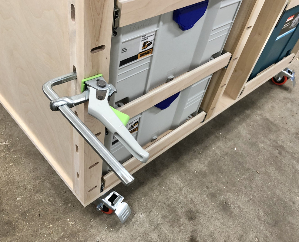

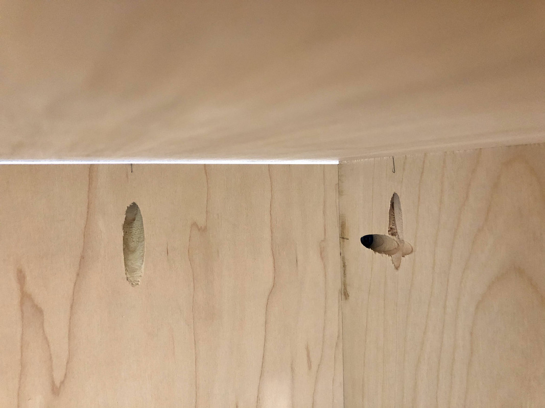

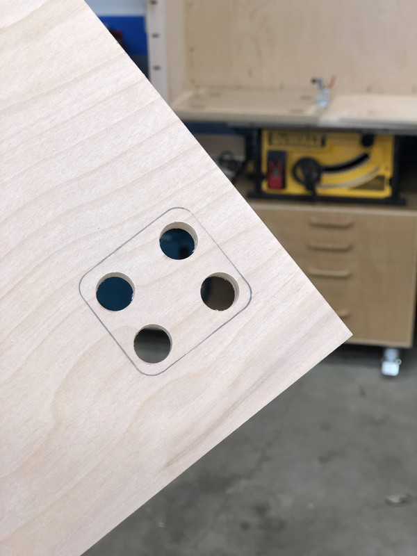

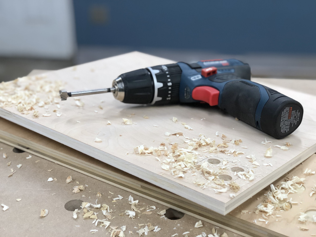

Hey Trapps, the oval cut outs are for vertical clamping of boards or panels. They are designed to use the Festool / Bessey quick clamps. The horizontal ones on the face I would stick a small piece of wood kind of like a floating tenon that protrudes and supports the bottom of the workpiece, and the vertical ones on the sides accept the clamp:
The reason for so many is adjustable heights for the material support. Use case for this might be holding a panel in place vertically to apply edge banding.

So... the floors are installed. My photo hosting service is undergoing maintenance and not letting me upload new pics at the moment, so the big reveal will have to wait until that's sorted.

Ok got the pics figured out.

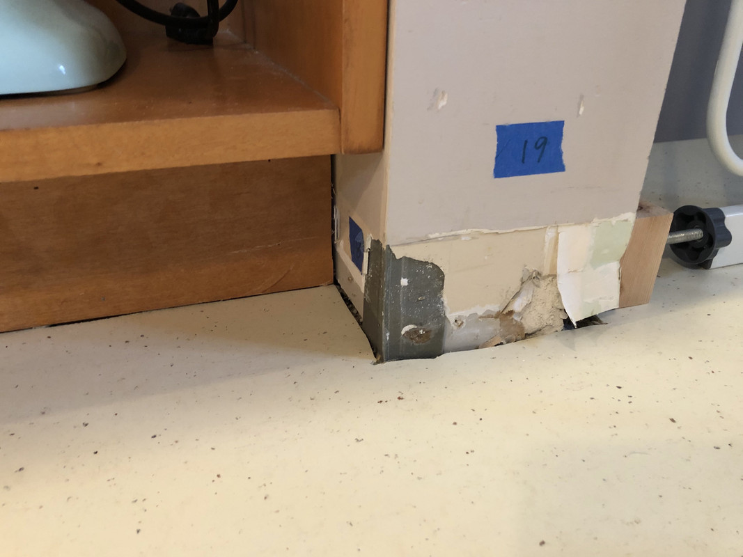

Doing the underlayment the contractor made a lot of sawdust. He shop vac'd it of course but there was still a thick haze in the room so I brought my air cleaner inside. Seemed to do the job.
I didn't take many pictures of the Marmoleum being installed, but essentially after cutting it to fit he spread adhesive and went over it with a heavy roller.
All cleaned up after he finished:
He did a good job cutting it close to all the walls and cabinets.
Up close you can see the little specks of cocoa.
Next up, before putting the trim back on, is painting. Which means I can finally get rid of this stupid hanging pot rack we don't use!
Yesterday I started painting, taping everything off and cutting in some primer.
Normally I don't like using painter's tape, but it's going to be tricky around all the cabinets so I decided to use it.
I think it especially comes across in the last pic -- this material reflects a lot of green in certain lights, just like I feared. I'm going to reserve final judgment until painting and trim are done and I've lived with it for awhile, but so far I'm a bit disappointed in that. Other than that, the install went well.

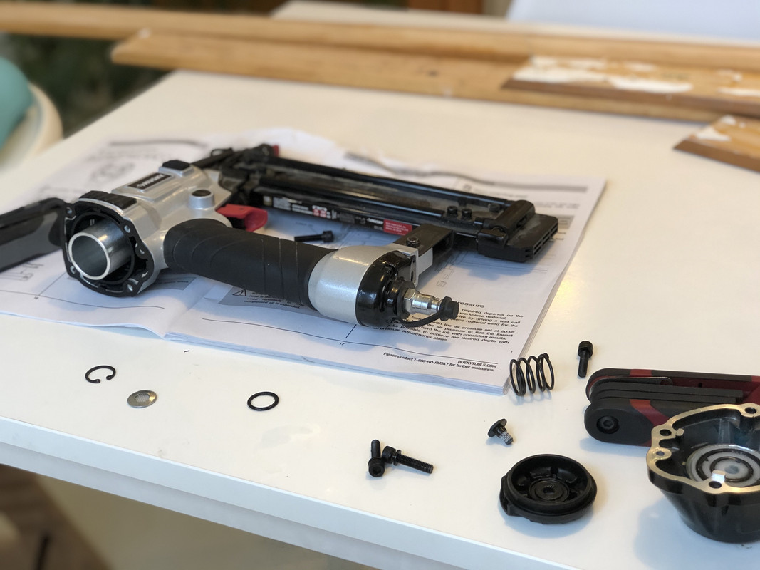

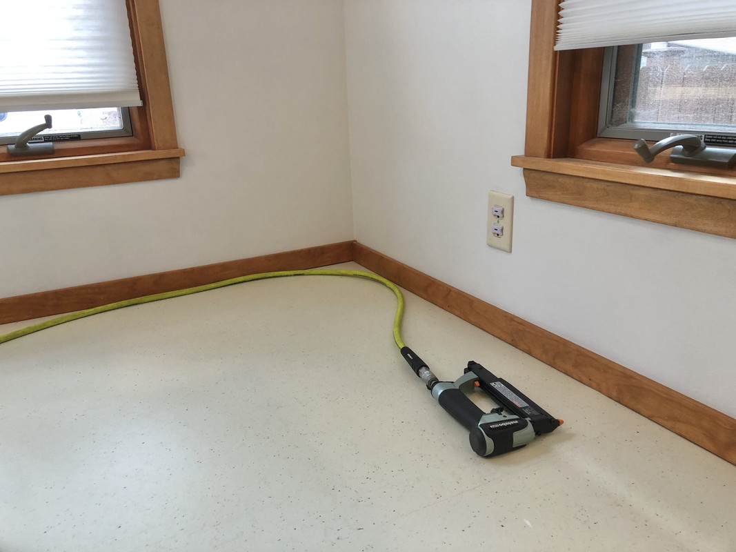

I shoulda looked at that Rigid nailer combo because I started putting the trim back on and had a mishap with my 18-gauge gun. The first shot seemed to blow a seal, because afterwards, air starting rushing out the exhaust and wouldn't stop. No jams, nothing I could find. So I started removing the back and it "exploded" on me.
Lot's of gaskets and o-rings and I had no manual and couldn't figure out how to put it back together.
:lol_hitti
Some small pieces fell out of the body, a little filter looking element, which this gun had always had a rattle. I think these parts were clanging around in there loose since the beginning. Not sure what to make of it other than I think the gun is trashed. :mad:
I was going to use 18-gauge brads for the baseboard, but with that gun broken, and no brads on hand for my bigger 16-gauge, I decided to try the new pin nailer.
The max nail it can shoot is 1 3/8", so not that long to go through baseboard AND sheetrock and into the framing. But since they can hardly be seen I could use more of them, and the holding power seemed to be pretty good. I might follow up with some 18-gauge if I get a replacement some day, but for now this is what I did.
The Metabo HPT pin nailer worked great. It needed a consistent 90 PSI to set the nails, but other than that no complaints.

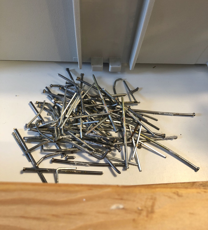

Instead of pounding or prying out all the nails and brads left in the trim, I clipped them with the Knipex.
This was faster, and didn't leave holes where the nails used to be.

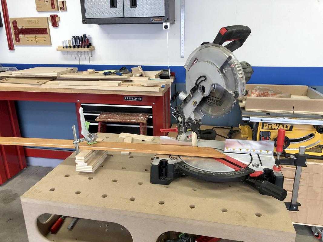

I only had to make one adjustment, to a piece of door casing, for which I dragged out my semi-broken miter saw.
Got me thinking though, if I ever make a miter-setup again it will probably be something modular that works with the new tracksaw table, vs a big built-in cabinet.

I would think you can find a youtube video on replacing the orings and such in your gun. I quickly ran across this one of an air nailer being taken apart:
If it's "broken" already, you can't brake it any worse. mess with it and see if you can fix it!

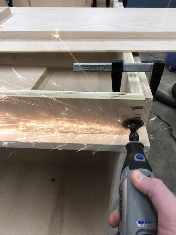

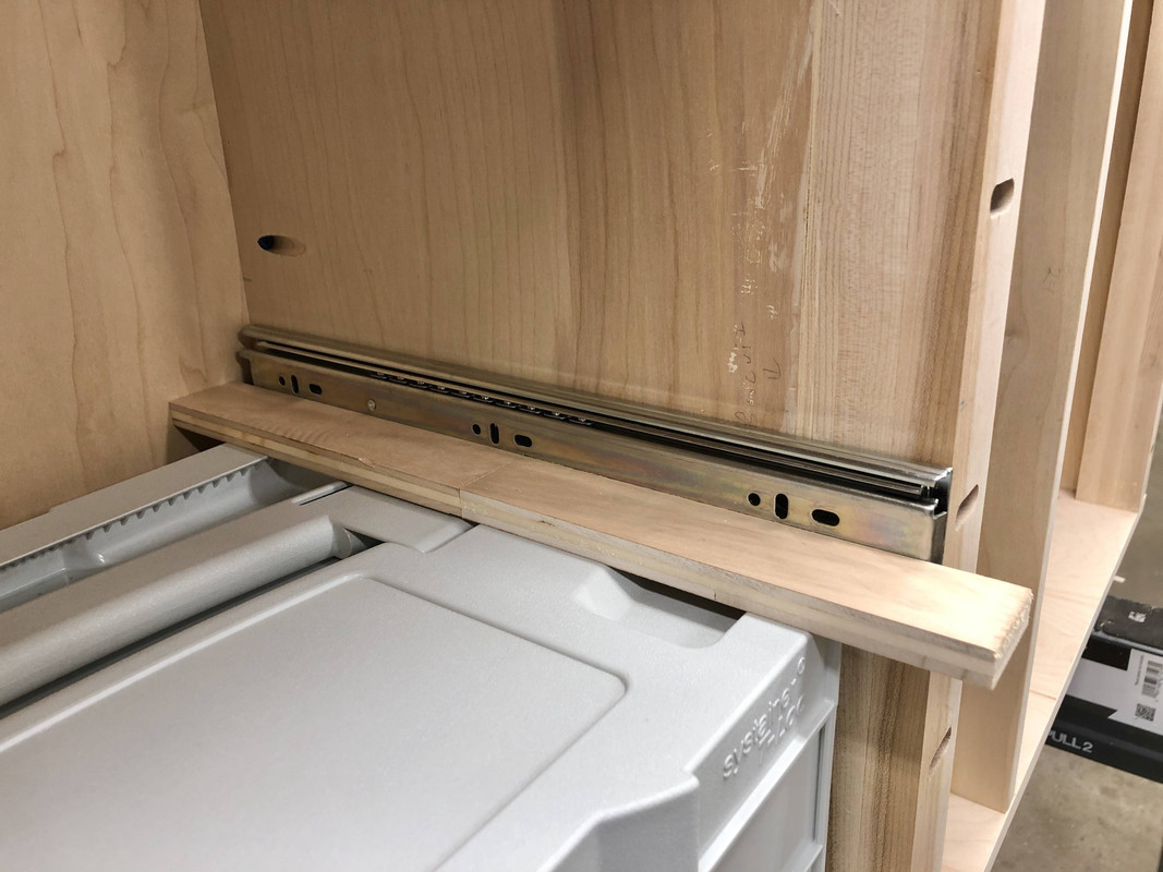

I had an "off" day in the shop yesterday. Meaning things just didn't go smoothly. The plan was to continue on the tracksaw bench build with the worksurface frame. I spent some time modeling an updated design in Sketchup (based on Guy Woodshop's), to figure out dimensions:
First error was I realized my Sysport cart base was not exactly 46"x30" like my model. Some variables like human error, the edgebanding add on, etc. So I took custom measurements for the worksurface frame. And some how cut them a bit short. :mad: This was my only 3/4" ply left over and we are in lockdown status right now. I think Home Depot is technically open but don't really want to make the trip.
Second error, when pocket-holing the plywood inner frame, I set the stop-collar on the bit, but not the jig. So this happened:
I had some shorter screws on hand, so they stick out less, but I will have to Dremel off all the tips.
I got a bunch of maple boards to do the outer frame, but now I'm wondering if I should hold off and get more plywood to fix my mistakes, or just roll with it. It's quite difficult for me to transport plywood with our compact cars, and the costs on this bench are really adding up (future post on that).
So I completed the inner frame and called it quits.

Small update:

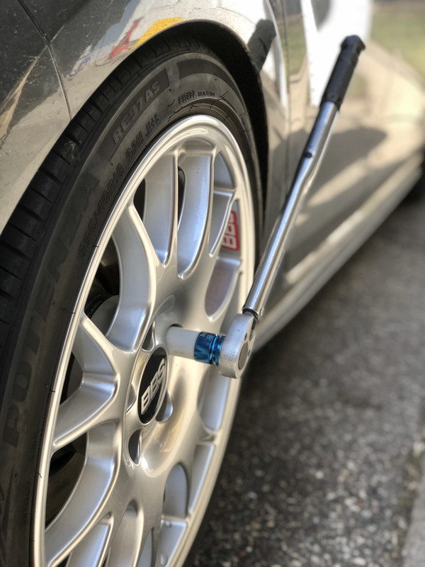

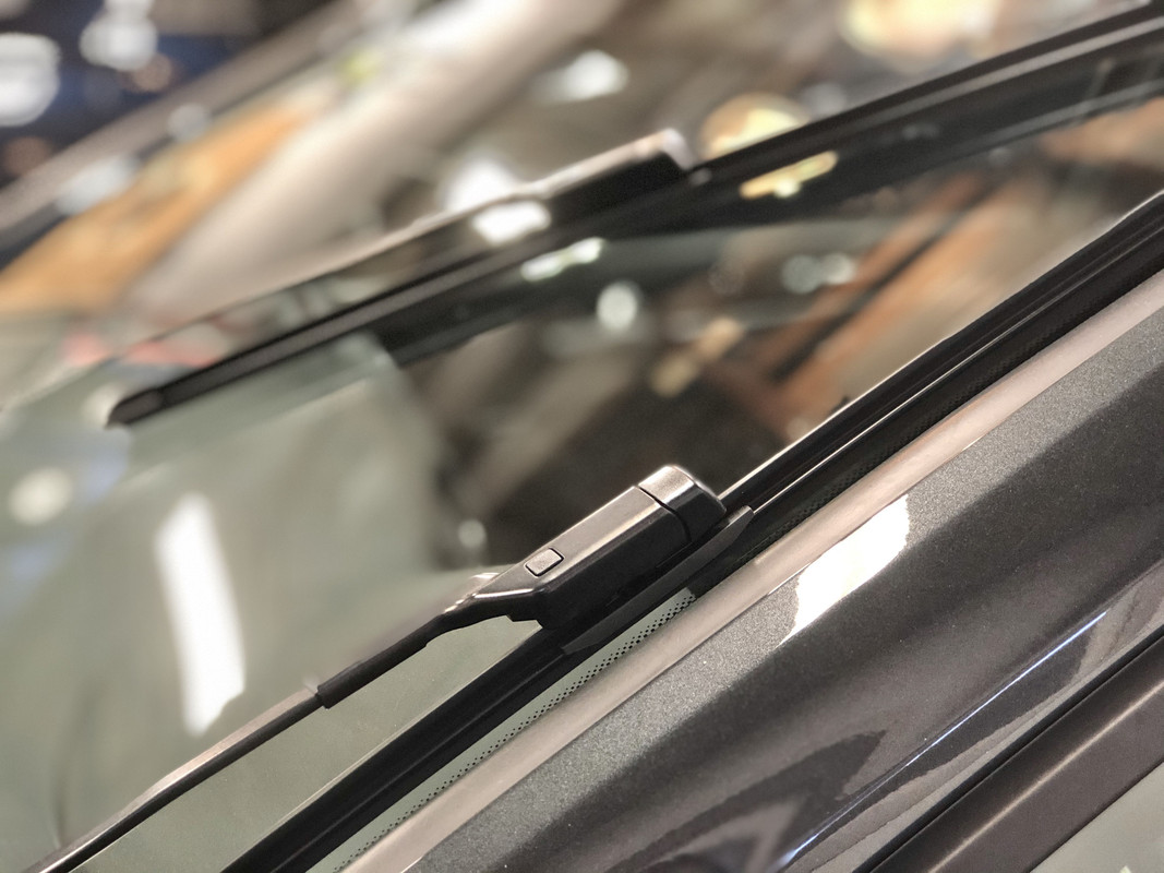

Got the summer shoes back on the mk7 today.
My wipers were totally shot so replaced those, with OEM of couse. :)
Yesterday during baby nap time I tried to fix my errors on the MFT worksurface inner frame by Dremel-ing off the pocket screw tips.
Then I resawed a piece of 3/4" plywood to 1/8" thick on the table saw to glue as a shim on the outside of the frame I made a little too narrow. No pic, so that's probably confusing, but I'll show more later.
Also ordered track saw guide rail supports:
I decided to just get the Festool parts vs. try to make something, or go with the 3rd party, but more expensive, Right Angle Design supports.
This bench has been a LOT of effort and $$$ just to cut square pieces of plywood, but on the few shop projects I've been lining up pencil marks the errors have shown through. I'm really hoping it's going to be the foundation for some future house furniture projects that *hopefully* I can achieve a more professional level of squareness and accuracy.
