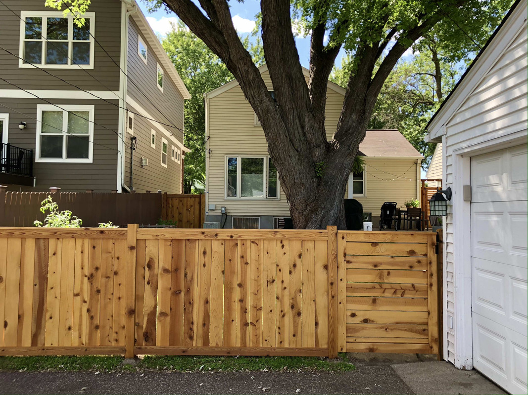

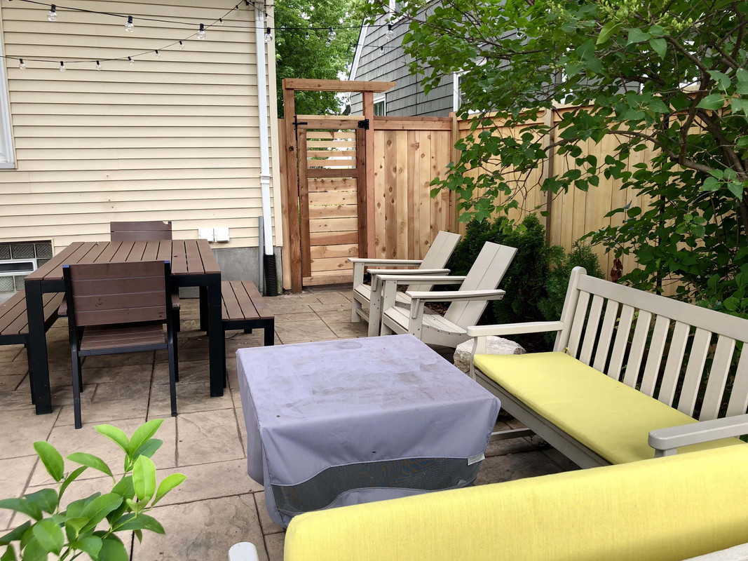

I took some pics so I can share this now. Several years ago my neighbor fenced in her yard including the lot dividing line between our properties. Which was awesome for us. But since my daughter is walking and running now, and curious and at times mischievous, the back of the lot where the garage is and the side of the house are points of exit for her. She often wants to run around to the front of the house or run into the driveway / alley which I really dislike because of the occasional cars that pass through. Basically, we wanted to finish sealing it off so we could have her out there and attend the BBQ or whatever for 30 seconds without worrying about her getting into trouble.
After several months of Covid and schedule-related delays my contractor finally got a date locked down. And then I pulled a move. I told him I was going to design a minimal gate arbor because I didn't want something flowery and pergola-like, and as I was considering it I last minute decided the gates could be more interesting.
We matched the neighbor's existing fence which is a pretty simple, "Craftsman"-style, solid non-overlapping picket. But for the gates I got some inspiration online and thought some horizontal slats would look cool. Like this:

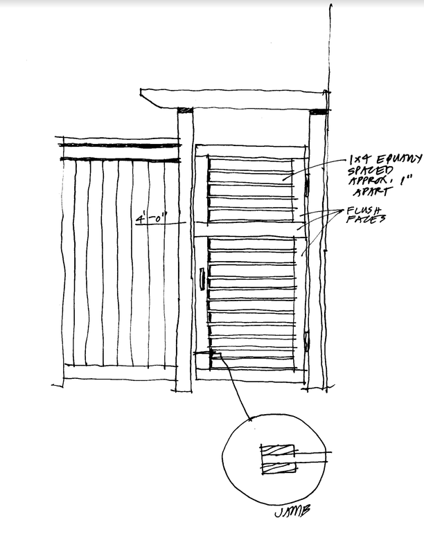

So I did some playing in Sketchup and Photoshop to flesh it out...
...and ultimately consulted my dad (retired architect) who's design opinion's I value a lot, and he made me this drawing based on my ideas which I then gave to the fencing contractor.
The contractor was game but I could tell it was outside of scope and going to be a little tricky to get what I had in my head. Ultimately I think he got 80% of the way there, and I would label it more "fine construction" than "fine woodworking", but it is what it is. I do appreciate the effort and didn't charge me any extra for the custom work.
This is the back section by the garage:
With horizontal gate:
And here is the section with main gate by the side path / patio / house:
And from outside looking in:
It's different than my design. I fought for it but he kinda missed the details and wanted to do is own thing he felt comfortable with. Ultimately I did want him to be responsible for the work. I do like the larger perforations in the top 1/3 "window", it feels more inviting than a solid 6 ft gate, but I feel like the proportions of it all are a bit off. I also wanted it to originate from the wall of the house, but he set the post with a pretty big gap. And then to cover the gap he tacked on this bizarre filler strip that is not integrated at all.
I picked up some cedar from Menards and plan to rectify a few of these details on my own.
All in all I don't hate it :D, but it was expensive, and I feel like I mostly was paying for time. They only took 4.5 hrs to do everything. Crazy. Would have taken me so much longer, but I can't help but feel I could have made the gates better, even more structurally sound, and with more attention to detail. But with a kid and work, sometimes I have to accept I can't do everything myself or it would never get done.

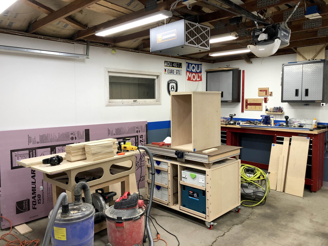

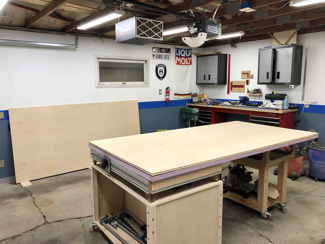

I had a short amount of downtime today so I spent some time cleaning my workbench. As I was organizing I realized I have no place for my router bits and accessories. I decided to take 20min and make a temporary solution to at least get the bits under control.

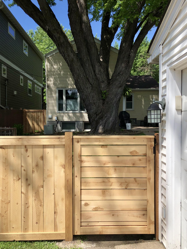

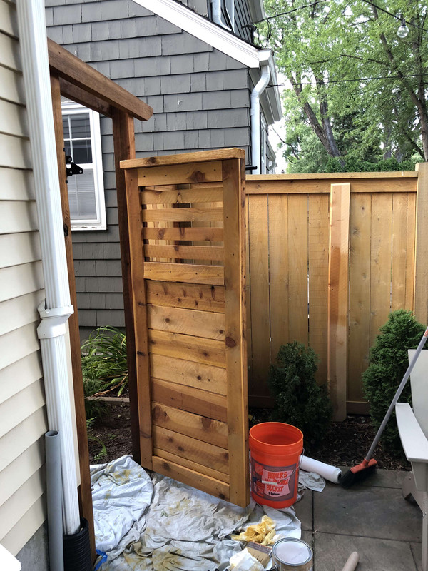

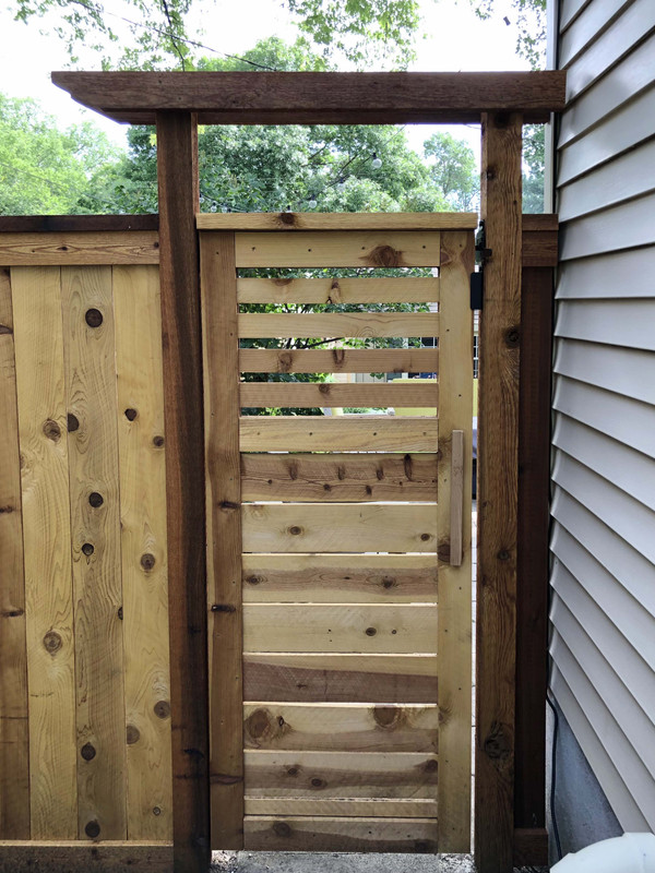

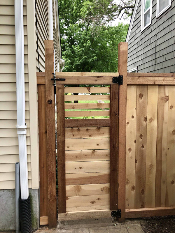

Fence Gate Fix

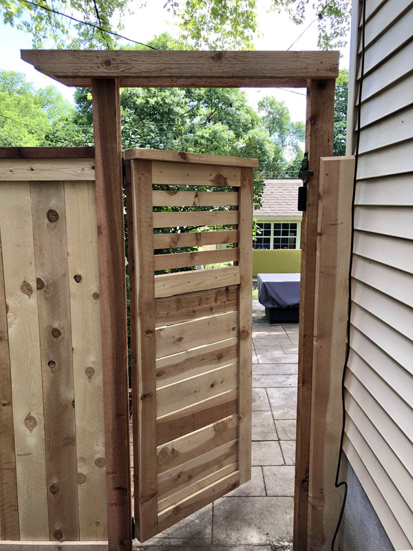

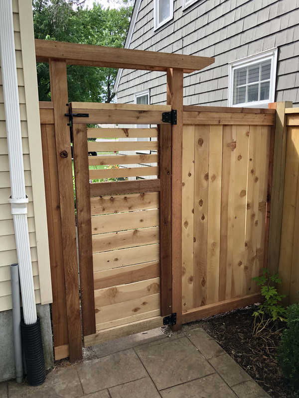

Not much has been happening over here lately -- work has finally picked up again so I've been busy with that and family stuff.

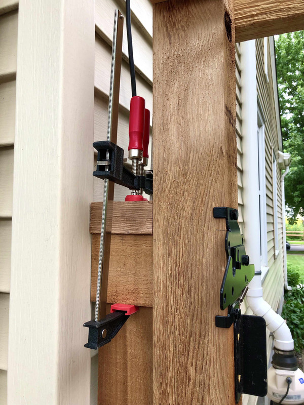

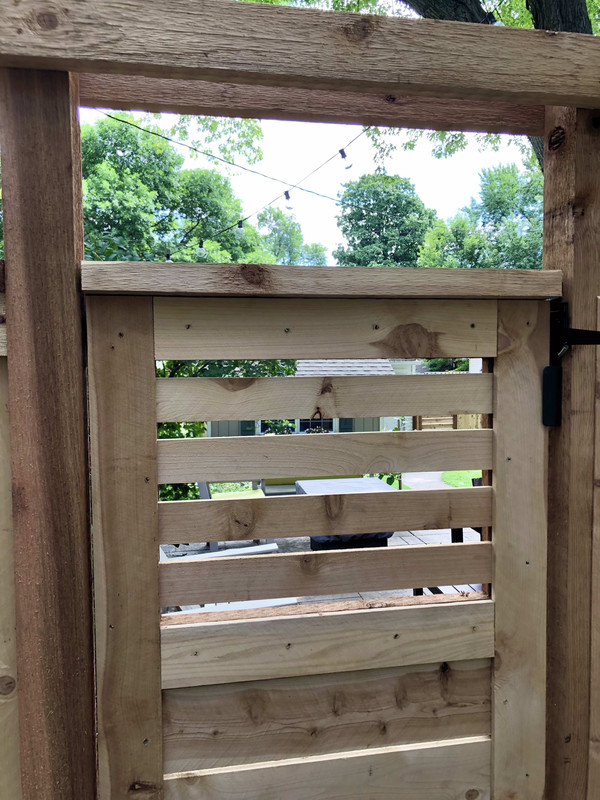

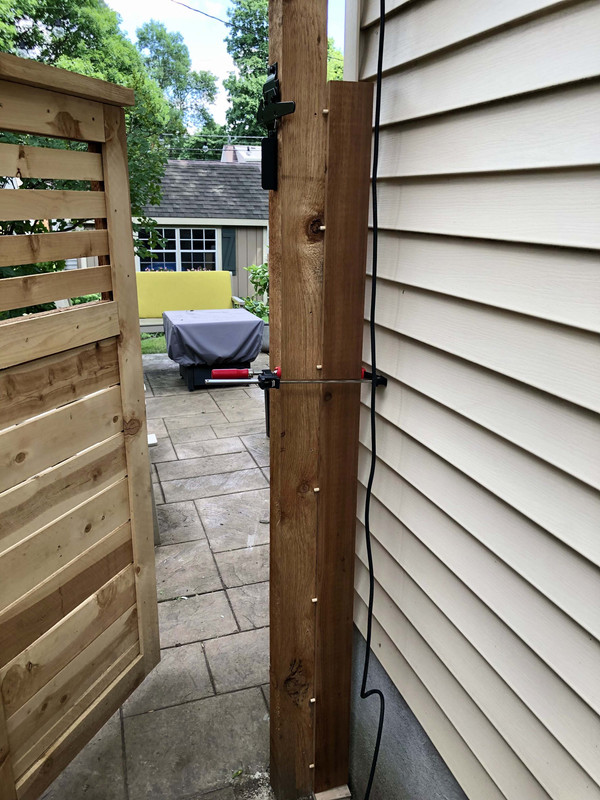

But yesterday I found a few hours to correct the two problems I had with the larger fence gate.
1) The gate post near the house was too far away, creating a large gap, and consequently the afterthought "filler strip" they put in to address it
2) The asymmetrical arbor started flush with the post near the house. My original thought was the whole thing would originate from the building, not be free-floating.

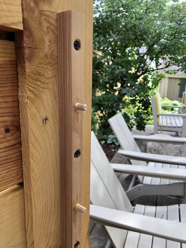

So I took off the contractor's filler strip and took some measurements.

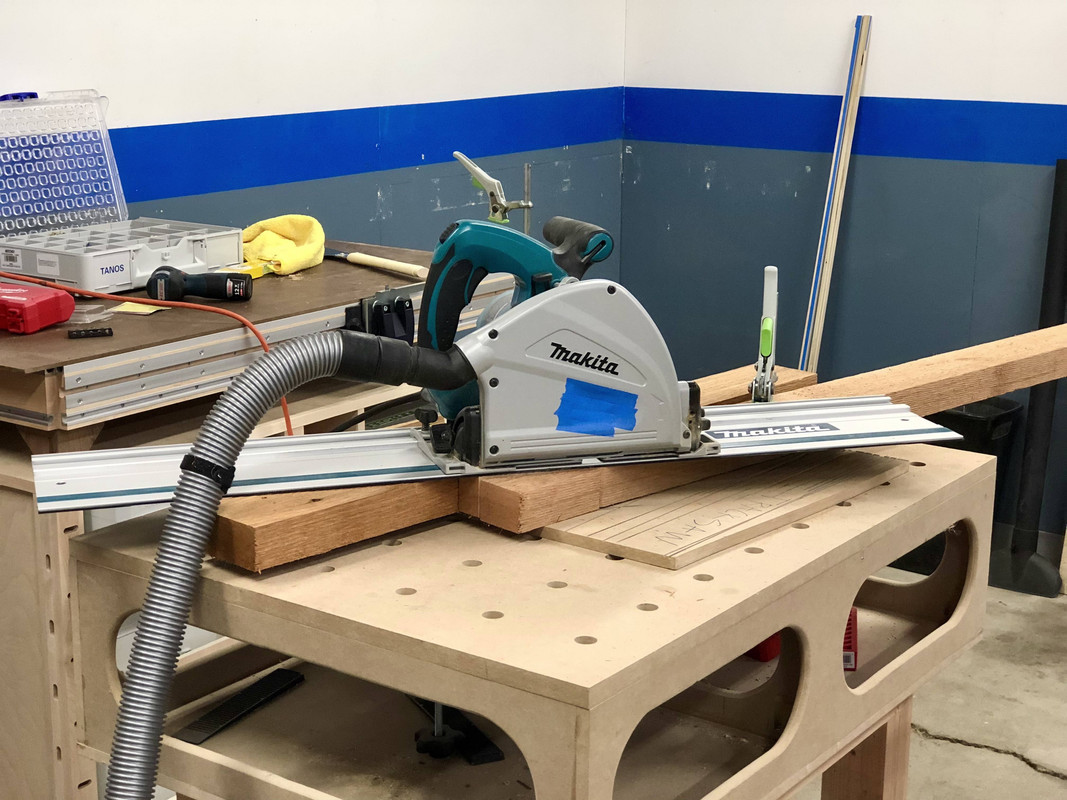

I had kept a 1x6, and picked up some additional rough sawn cedar boards at the big box store. The gate post is not perfectly parallel to the house siding, so to get a nice fit, I held the 1x6 in place tight to the house, and scribed a pencil line against the post. This led to a tapered board that I subtracted 1/2" from for a reveal, that ended up being 4" at the bottom tapered to 3 3/4" inches at the top.
To cut this taper I just lined up the track saw on the scribe line:

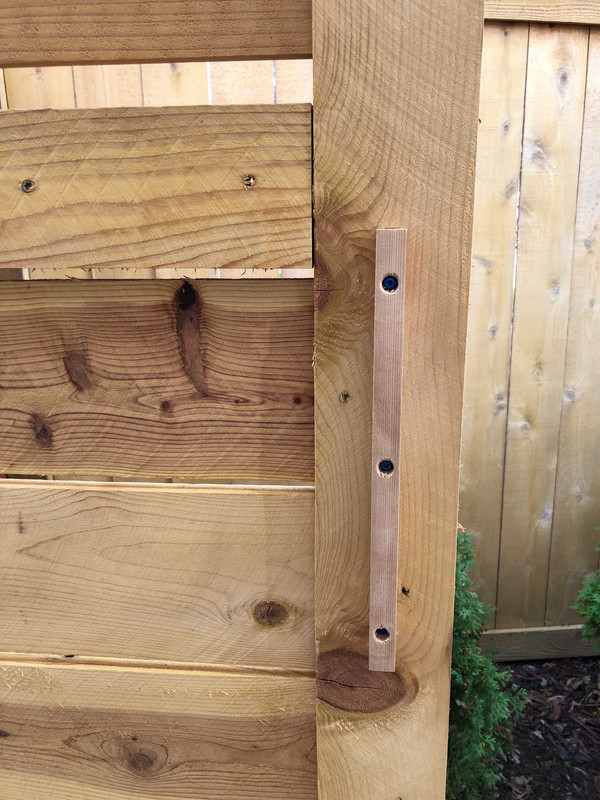

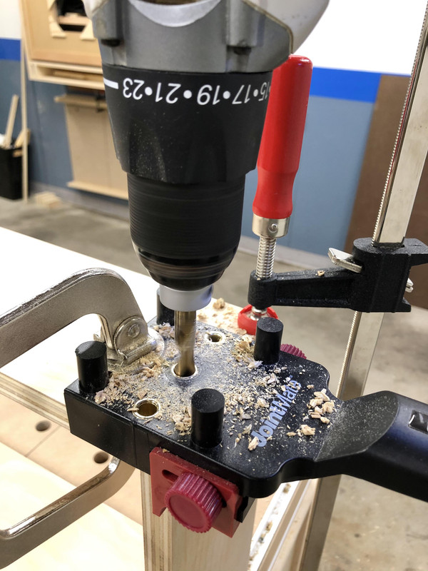

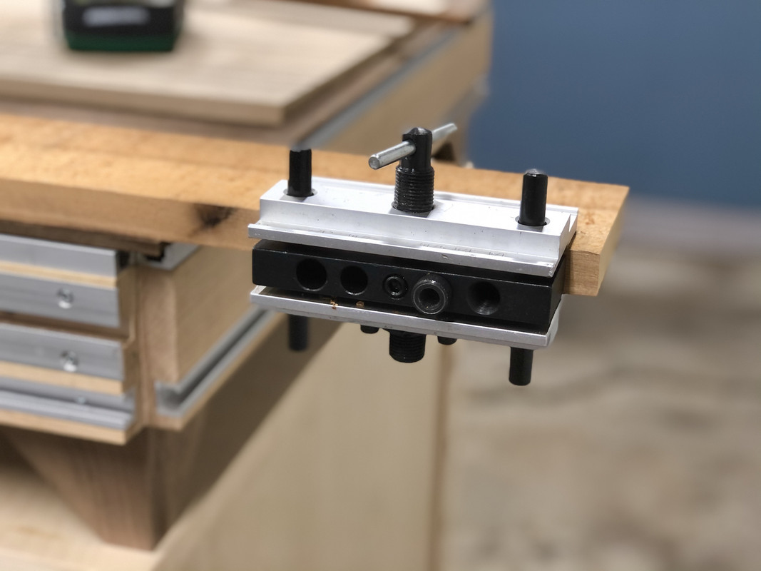

I was thinking of how I could attach the new filler strip in the center of the 4x4 post, in between it and the house, with no vantage point to drill or nail, and without a bunch of visible fasteners.
I settled on dowels. Because I left a 1/2" reveal I figured I could have dowels stick out 1/2" and just be able to squeeze the board into place. Once tight, there would be an even 1/2" gap between it and the house.
I have several cheap doweling jigs but the self-centering kind seemed to make sense here.

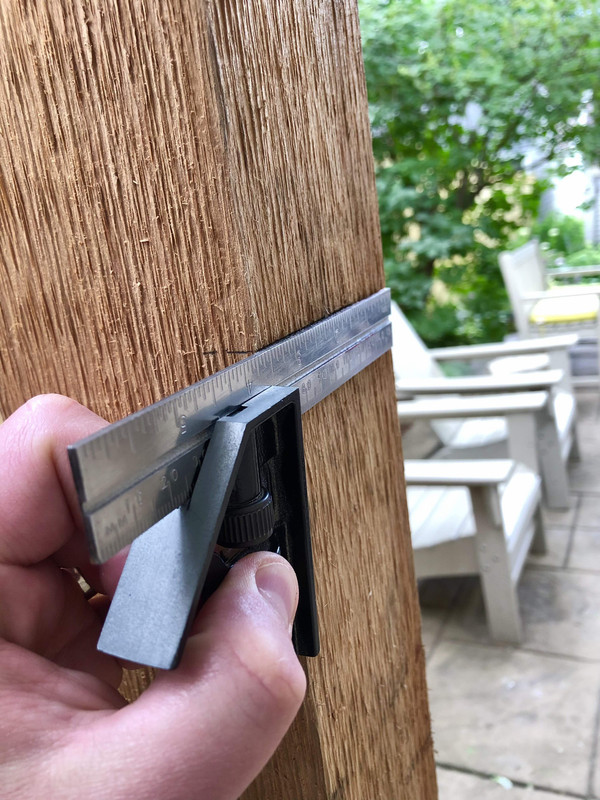

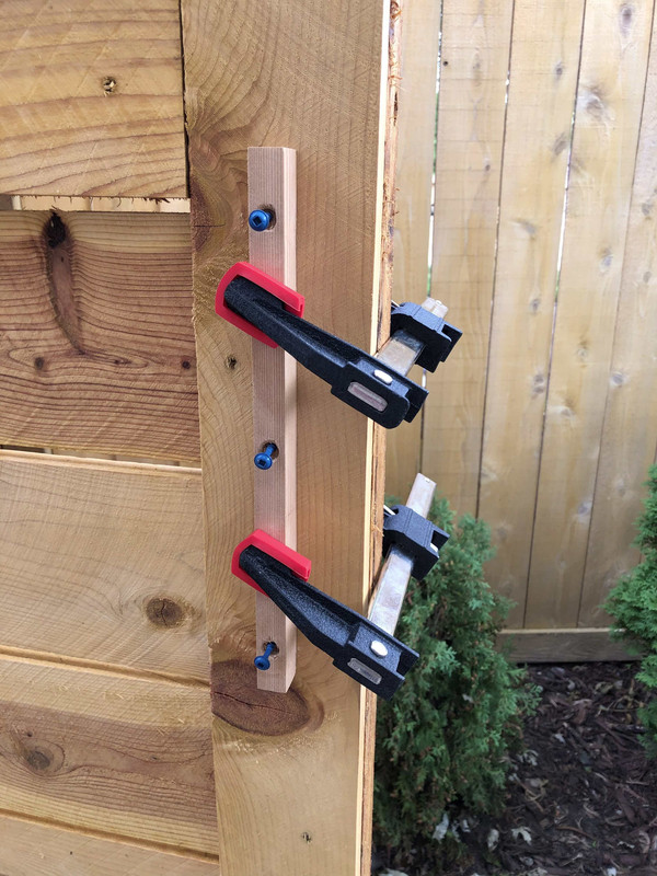

To mark the holes on the post, since it was already set in concrete, I clamped the filler strip at the height I wanted and made pencil marks in the center or each dowel.
Then carried these marks around the post with a combination square.
I felt like the marks were fairly accurate, but drilling was another matter. To even have a chance of drilling a 5/16" hole back there I needed to pick up two accessories, a right-angle drill chuck, and a stubby drill bit. I forgot to take pics of the setup because it was frustrating and there were lots of swearwords involved. "Fudgesicle! Why won't this ding-dong drill tootin' straight!" Something like that. Some of the holes had to be sloppily widened, and one I gave up on and just sawed the corresponding dowel off. But... I got a decent fit on a handful, and with enough tightbond II and clamps, I feel like it's pretty secure.
Then I cut some trim and top cap pieces to match the top and bottom of the fence on the other side of the gate. The idea being the horizontal lines would go all the way to the house for continuity.
Then it was time to redo the arbor. I kept the same design, just added 4" so it went all the way to the house. Because the angle was greater than my miter saw could do, again I used the track saw to cut a traced line:
A couple deck screws and we're back in business:
CR5PBjwB
And from the front:
It's a somewhat subtle improvement, but to me it just looks more complete and considered.
Now I'm thinking about making a cedar pull for the front of the gate.
That's all for now!

So much better!
The attention to detail makes it all come together, especially having the arbor going all the way to the house. Clever idea using dowels in the spot.

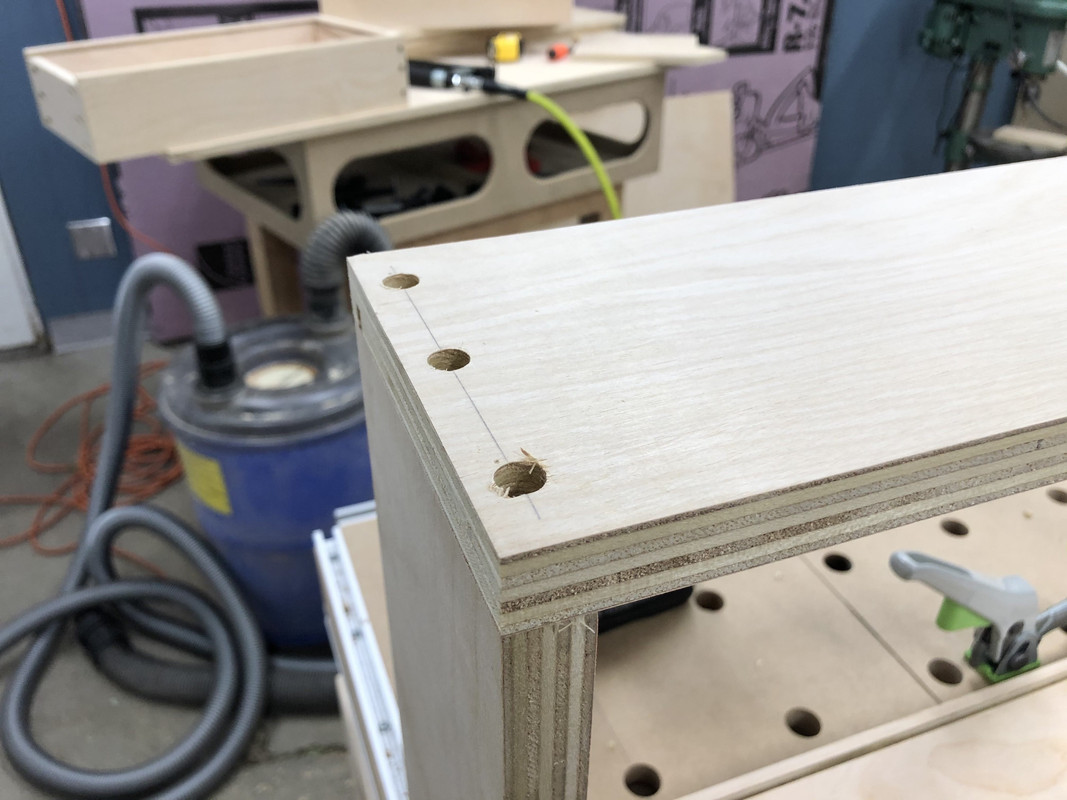

Well I had some downtime at work (home!) today and it was beautiful out so I did accomplish a few small things. Not huge, but still felt good.
1st I made a simplistic handle/pull for the gate. Going to skip some of the process pics on this one because it's literally two small cedar pieces.
But I sanded it smooth and broke the edges. The first piece attaches to the gate with some outdoor-rated Kreg screws, recessed:
This part is slightly narrower and shorter than the piece that will go on top of it. To attach the second piece I again used dowels, carefully marking out the location to drill on each:

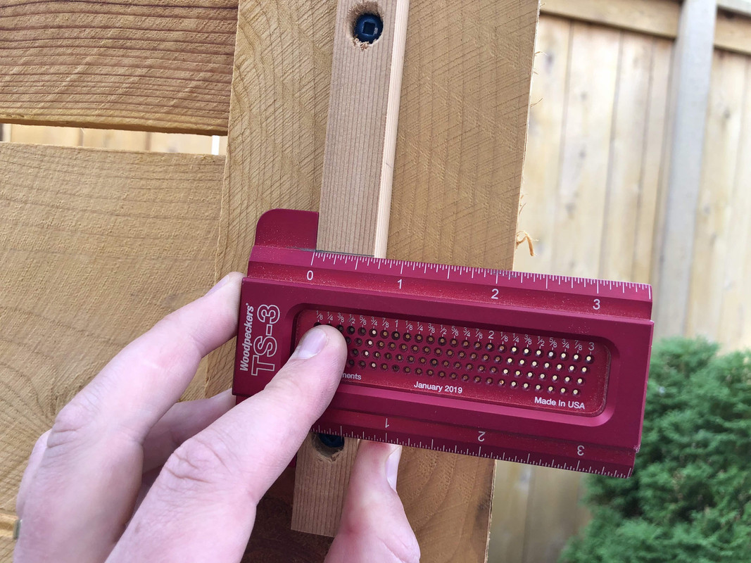

I've said it before but this is my favorite WP tool. It makes laying out parallel and perpendicular SO easy and accurate.
Using some plywood blocks to distribute clamp pressure and avoid denting the soft cedar.
Still needs to be oiled so it will get darker, but here is the final result:
The idea was it sort of looks like it's floating, no visible fasteners, and the two-step profile gives your fingers something to grab onto.

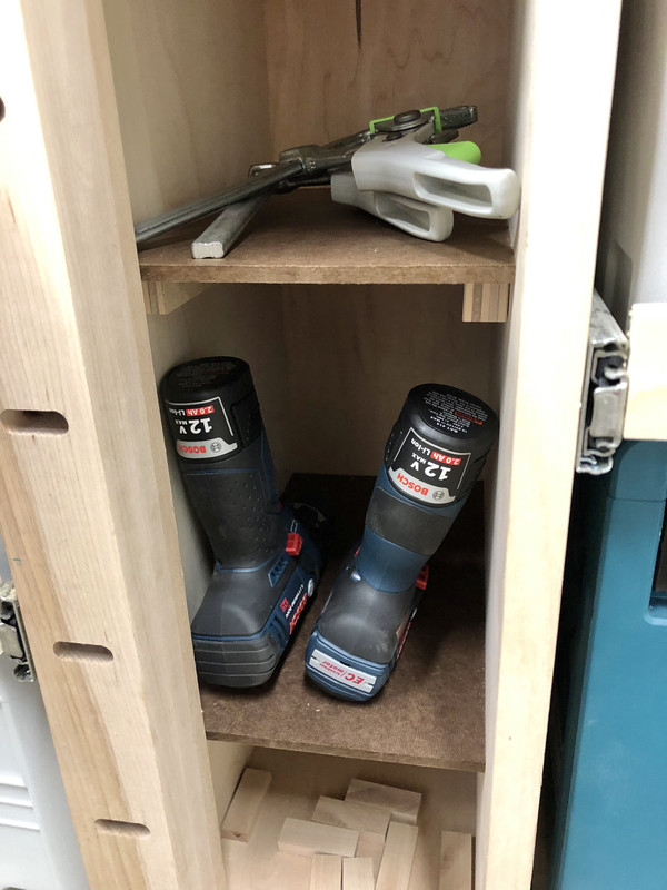

Next up... something super simple but long overdue, I added some indexing "stubs" on my track saw bench to keep the top aligned. These hide inside the walnut feet and are just small bits of plywood:
It's a silly little thing but now I can pull the bench around on the casters buy the top and keep it aligned with the bench faces. Feels more solid, too.

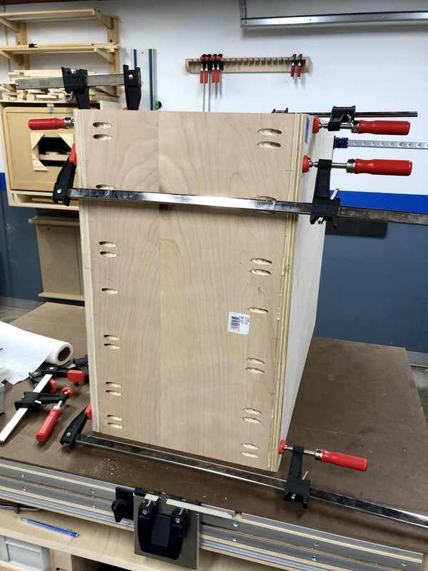

Lastly, I cut some hardboard shelves for the little mid-section of the bench:
I had installed plywood cleats with the intention of putting shelves before assembly, just never got around to it. I think they will be very useful for small items I want to temporarily move off the surface, but not back into a Systainer.

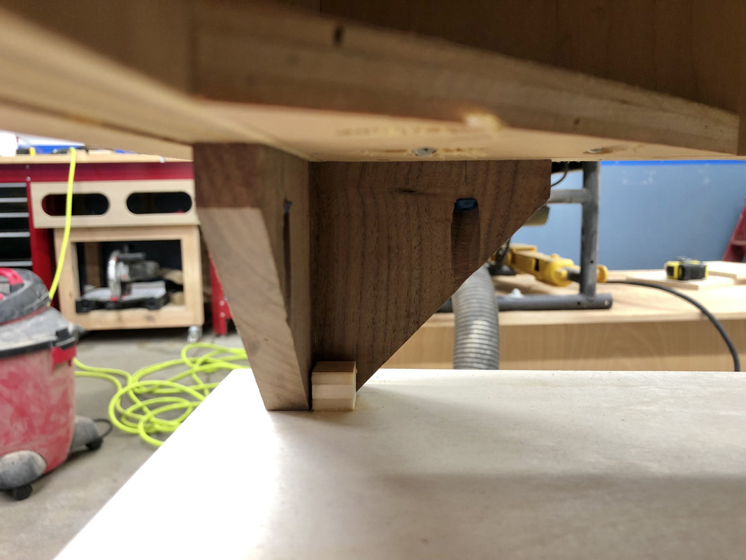

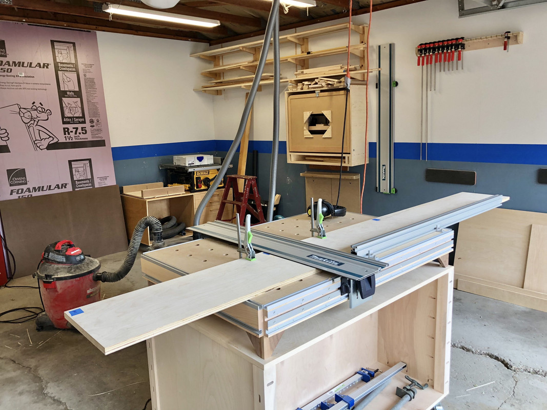

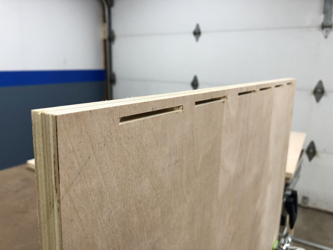

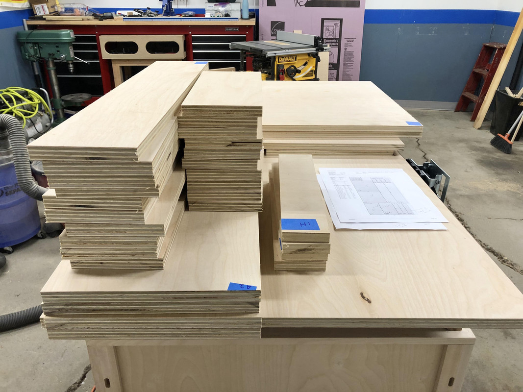

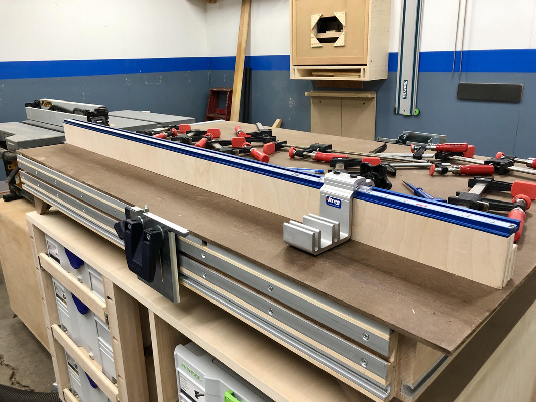

Yesterday I had an hour or so and started a new shop improvement project. :lol:
I'm kind of running out of plywood and materials so the things I can go out and make on a whim are getting limited. I sort of looked around and said "hmmm, what can I quickly work on today with what I've got?"

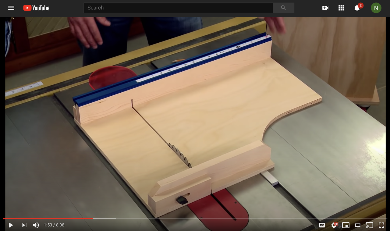

I've had it in mind for awhile now to re-make my crosscut sleds. Or maybe just make one do-it-all sled instead of two. I'm sure you've seen my current sleds -- they are pretty simple but get the job done. Some things I've wanted to add or change are:
1) UHMW runners to avoid seasonal contraction and expansion
2) fence for repeatability
3) t-tracks for hold down clamps and jigs
4) better blade guard/protection out the back side

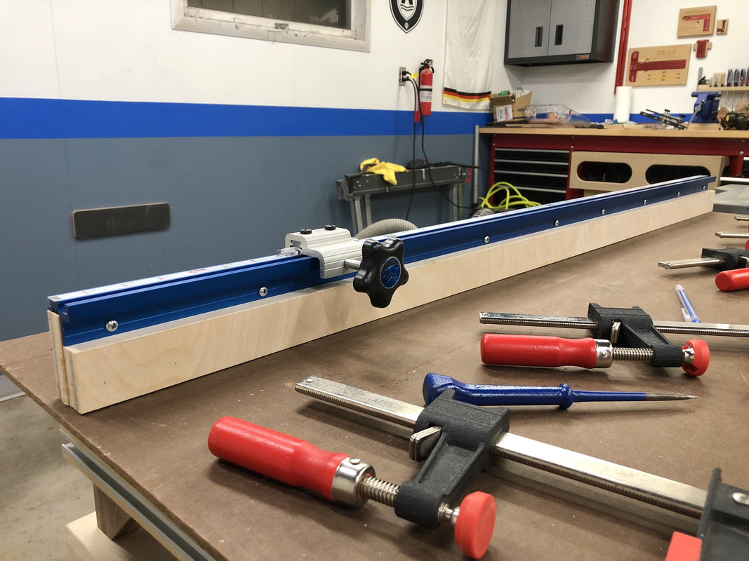

I came across this sled on YouTube and it reminded me I have the Kreg Top Track from my old miter station sitting in my shed collecting dust.
So I thought I would use that and start by making a new fence out of the few plywood scraps I have left.
My fence is going to be the full 4' of the Kreg Top Track. I started by ripping and glueing up two pieces of 3/4 plywood. I've always had bad luck with warping in my space, so I find that glueing two pieces together ensures it will stay flatter over time.
Using the beefy aluminum extrusion I got for my tracksaw fence as a straight reference. Clamping it against this ensures the glue up will give a flat result.
The back piece is shorter to make room for the Kreg track, so I edge-banded the top to make it look purdy.

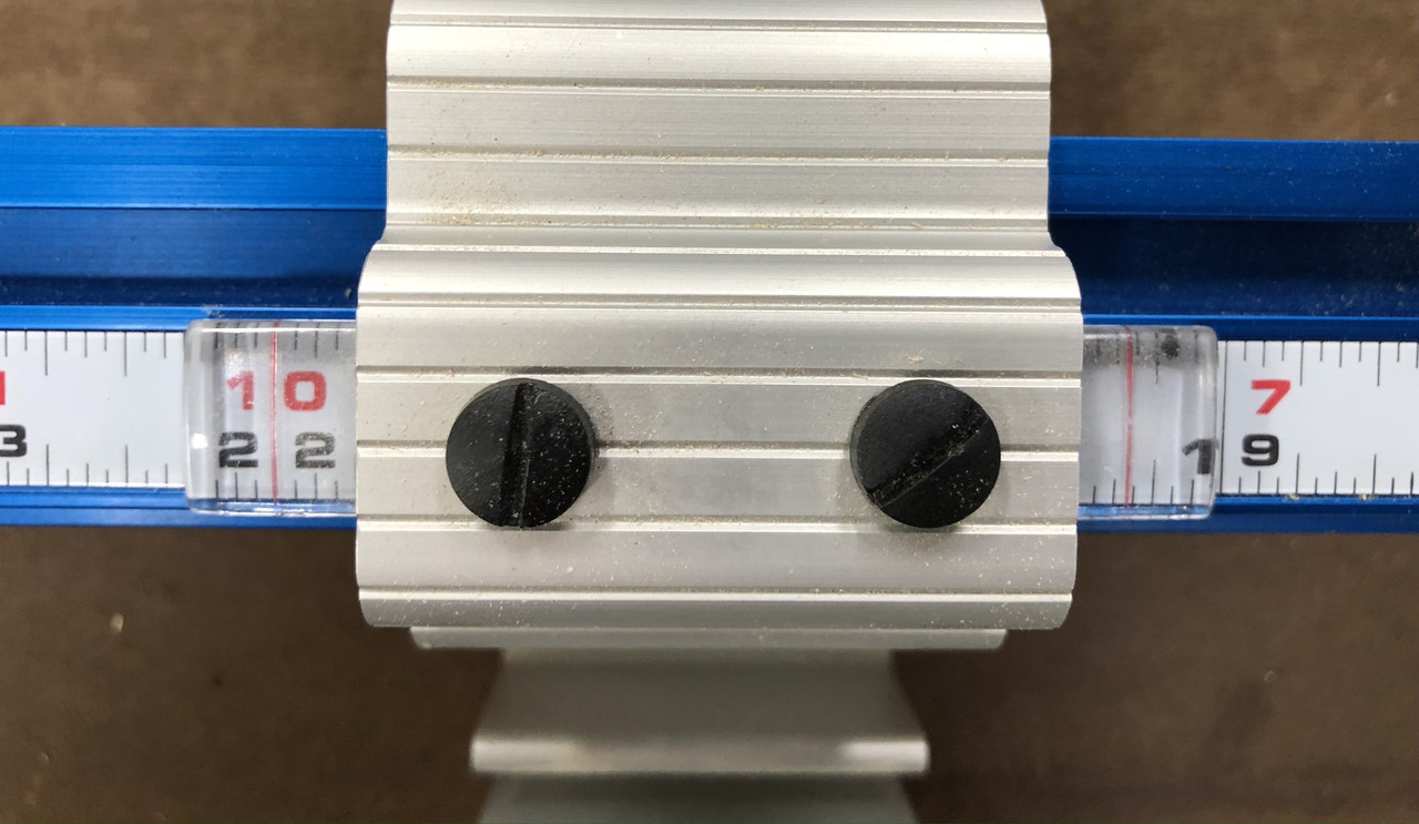

Screwed in the Top Track and all done, except for clean up the ends and wipe on some poly.
What I really like about the Kreg Stop is the hairline indicators are easy to read and precise, and it has indicators on both sides, which means I can use the stop on both sides of the blade, and they can be calibrated for different blade thicknesses.

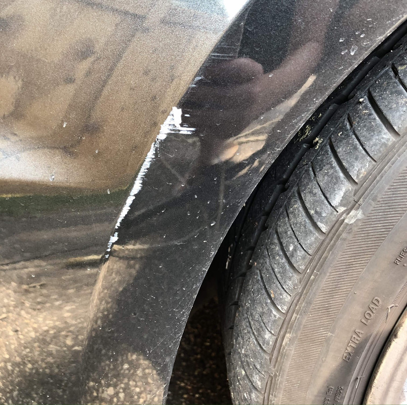

Very sadly I noticed someone must have scraped me in a parking lot, despite my best efforts to park away from everybody. There's a good 6" scrap on the front driver fender, it looked 3x worse before washing it with some tan paint and chips from the other car.
Fortunately the bumper is plastic so I don't have to worry about rust, but I'll have to look at it forever since respraying that metallic type paint is an expensive repair.

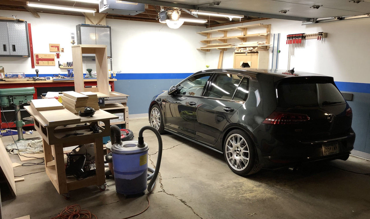

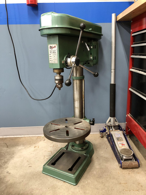

In more positive news I did pick up a drill press for the garage on Saturday. I've been thinking about adding one for awhile as there have been numerous times I wished I could drill a perfectly perpendicular hole. I posted in this thread about what size to get for my small space, and ultimately got this used Grizzly 12":
It's a discontinued model, G-1199. 12", 12-speed, 5/8 chuck, 3" spindle travel, weighs 150 lbs and roughly 12" x 25" x 40". Hard to tell but maybe was produced as early as 1995. The guy said he didn't have a chuck for it :mad: so I've ordered a replacement from Grizzly, and I need to clean it up and test it out more, but I think it's going to be a nice compromise for me. So expect some add-on projects for it like a base cart w/drawers, and larger clamping table.

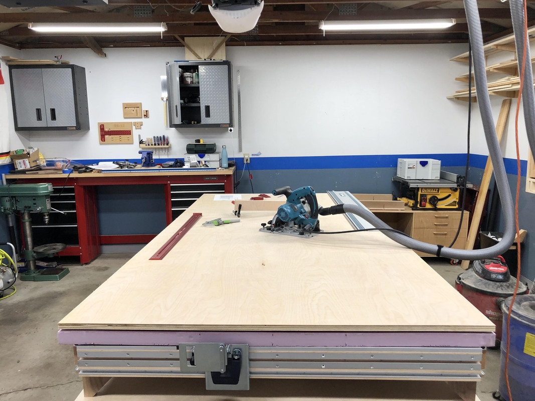

Apparently I found some motivation because I endured the almighty Home Depot F250 rental and there are now two 4'x8' birch ply sheets in my garage...
:rocker:
N
nicholam77
Dec 18, 2016
2,702
Minneapolis, MN
You can't just show us some plywood and then not give us details of your plans for it!!

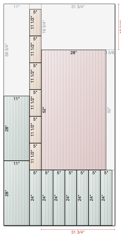

Ha! I wasn't going to make a longer post tonight, but I'm starting a new project at work tomorrow and my wife is going on a "girl's trip" this weekend leaving me with our kiddo, so I should probably update otherwise it might be awhile!

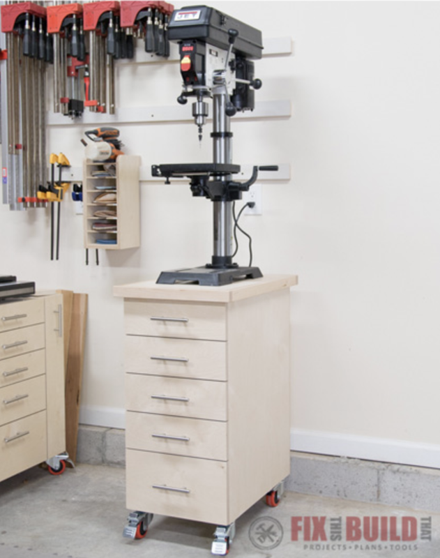

The plywood is for two projects -- a drill press cart, and a bed for my daughter. Fairly closely based off these:
Fix This Build That Drill Press Cart:
Sprout Kids Montessori Convertible Floor Bed:
The reason I'm tackling both at once is I couldn't fit the parts for the bed into a single sheet of plywood, and there was a lot of waste. Thanks to Cutlist Optimizer, I figured out I could fit BOTH projects into two sheets, maximizing yield.

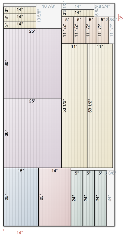

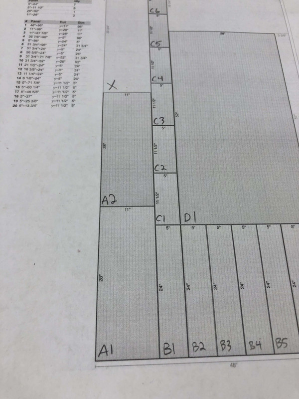

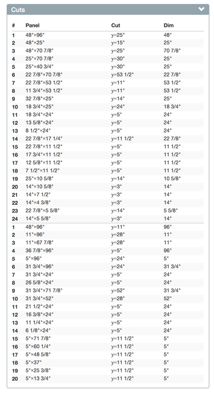

To breakdown the sheets, there were a LOT of cuts involved, and after using Cutlist Optimizer on the toy cubby build, I fell in love with it. I don't know how I would keep track of everything without it. Here's the sort of data it spits out using these "combined" projects as an example:
Not only does it figure out the most efficient use of the plywood, but it can consider grain direction as well, which I have done.
Fortunately today I had a slow day at work (home), and was able to take advantage and break everything down!

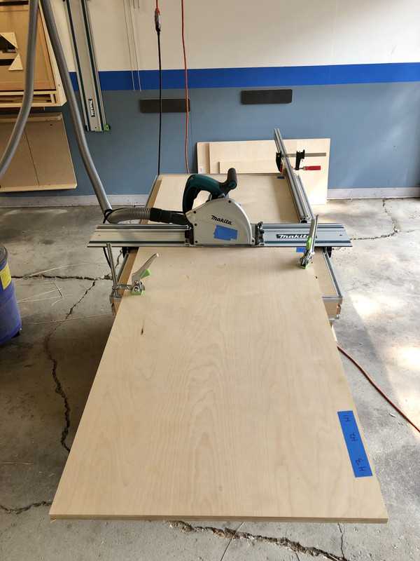

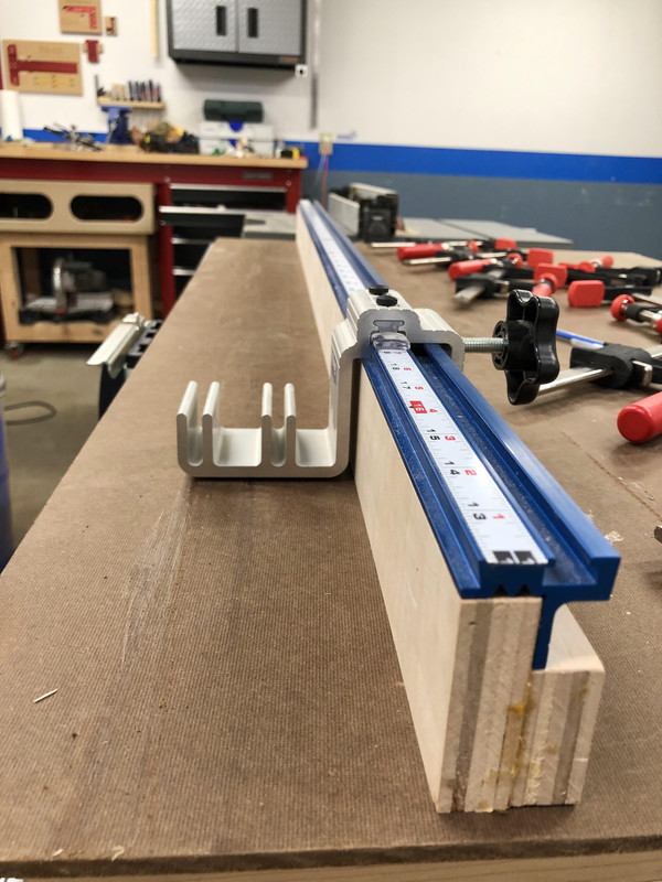

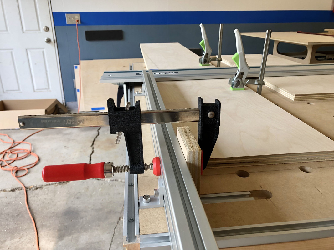

I always start by ripping a clean reference edge. And on my Home Depot trip I remembered to get some insulation foam to cut on!
I haven't been willing to cough up for some parallel guides yet, so I'm still using careful measurement and a length of plywood with stop block clamped to set the cut distances. But I can see how they would make things easier, so I hope to make some DIY as they are so expensive.
As I cut each piece off, I label it with a part number on blue painter's tape, and sometimes subsequent cuts that will be made later. This corresponds to notations I've made on the Cutlist Optimizer diagrams.
By keeping the labels in the lower left corner I know how everything is oriented, too. This really helps me keep track of what piece is what.

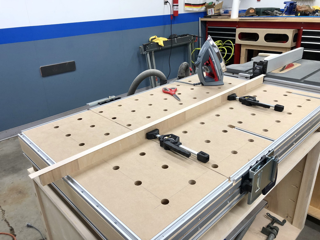

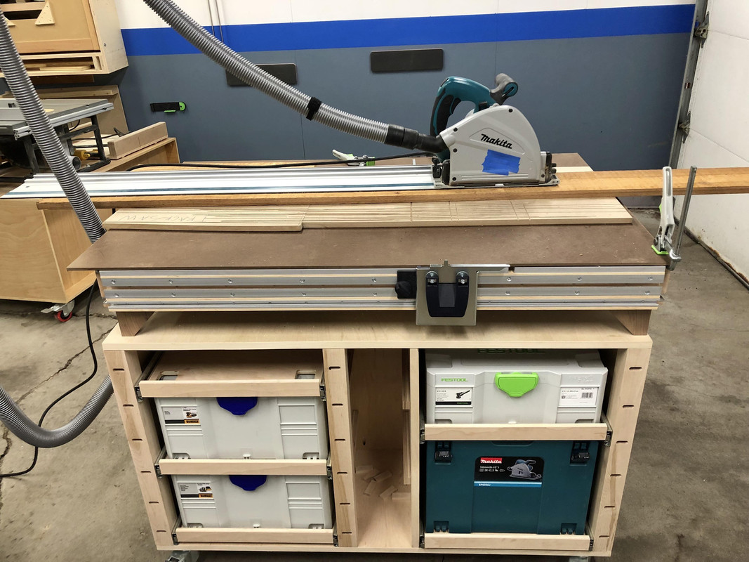

Once I have slightly smaller pieces I feel I can bring to the Tracksaw Bench alone, I convert to that.

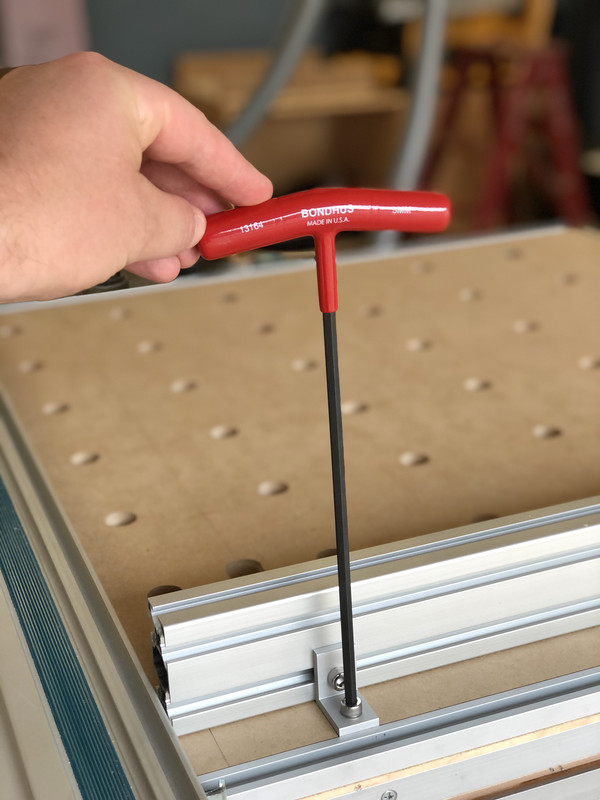

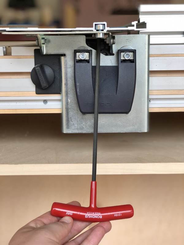

:rocker: NEW TOOL ALERT! :rocker:
I got a Bondhus ball tip 5mm allen key with a long reach for locking down both the tracksaw fence, and the Festool rail guides:
The pieces have to be narrow enough, but can be quite long!
Repeatable crosscuts are achieved by clamping a stop block, as I still need to make a proper flip stop.
Thanks to the Festool quick clamps, I can easily crosscut very large panels, even without outfeed support.
And then the last phase, for those pieces that are too narrow to get good fence reference at the track saw station, I rip on the good ol' table saw. Yes, it still has it's place!
One great benefit of the track saw, this is ALL the dust on the shop floor after all those cuts. Shoe for reference:
And just like that, after ~6 hrs work, the sheets are broken down to every part!
Not sure when I'll be able to get back at it, but... at least I can park in the garage until then. :lol:

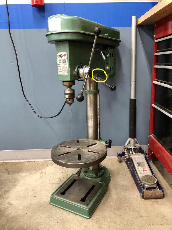

So with the drill press the top motor head assembly is not in line with the base, it's twisted to the left. I think it may have shifted when I had it on its side in the car. The head is floating and secured in place on the column with an allen set screw, but when I loosen it I still can't rotate the head. I think it's stuck for some reason.
Any ideas on what I can do? Try to spray some WD-40 up into the base of the head where it meets the column? I don't want to do anything that will damage or wreck it, but it's gonna drive my OCD nuts if I can't get it aligned.
Set screw is where the yellow circle is. You can't really see the misalignment from this angle, but it's off by about 5-10 degrees.

You should be able to rotate the base also, if the head is stuck.
If not maybe just take the motor off to shed some weight and make it easier to spin? I wouldn't think WD40 or PB Blaster would hurt anything either.

If you've got the set screw loose/removed, put one foot on the base and try lifting up/wiggling the head assembly while you twist it. I'd bet she's just a little cockeyed on the column. You're unlikely to break anything just wrestling with it, so give her the beans if you have to.

Thanks for the advice guys. I took a look at the base and the column has a flange that the mounting bolts go through, so it can't be turned. I managed to get 'er upside down and let some WD40 sink in to no avail. After 45min of wrestling with it, whacking it with a dead blow hammer, etc, I realized there is a second set screw.
:eyecrazy:
After I loosened that it turned no problem. :lol::lol::lol:
Guess I shoulda looked at the manual closer.

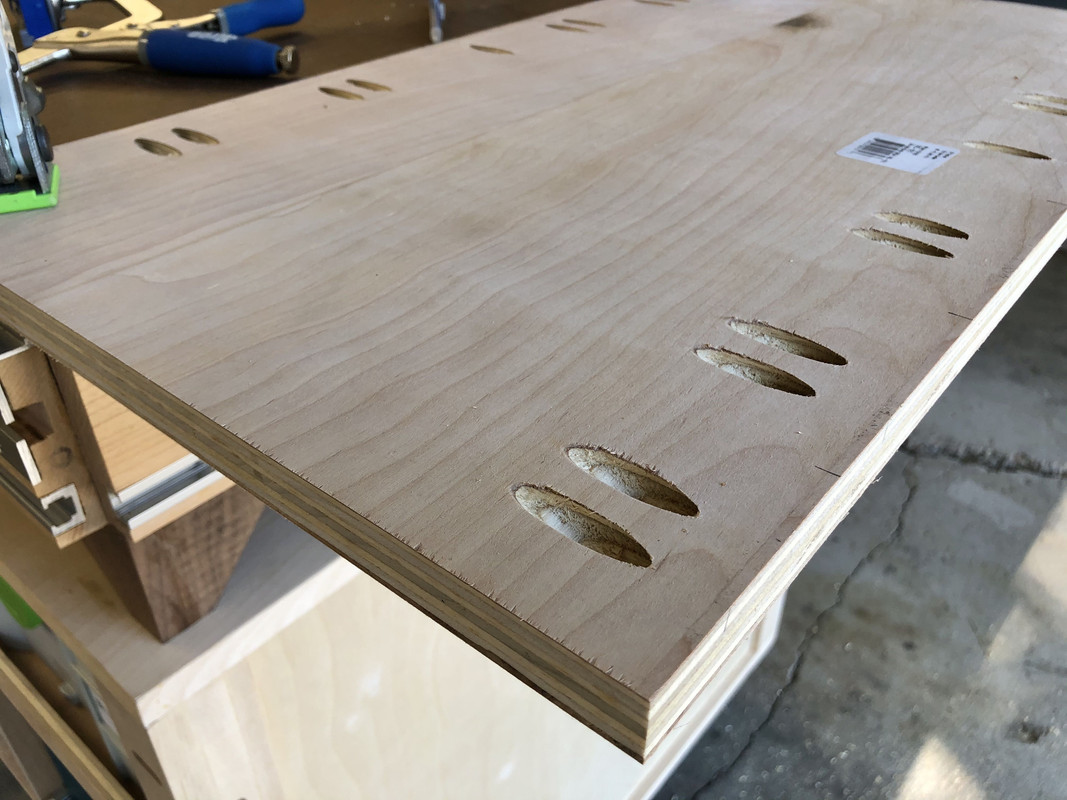

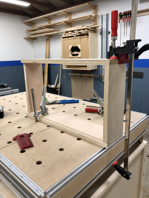

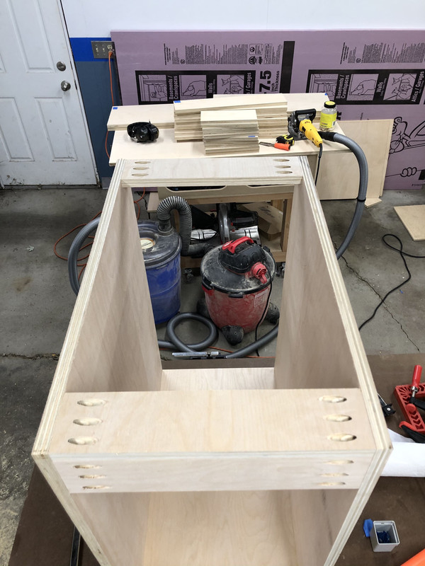

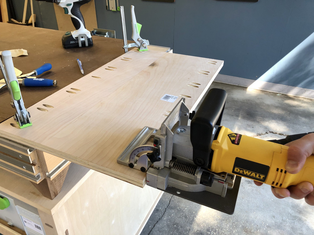

Drill Press Cart - Part 1

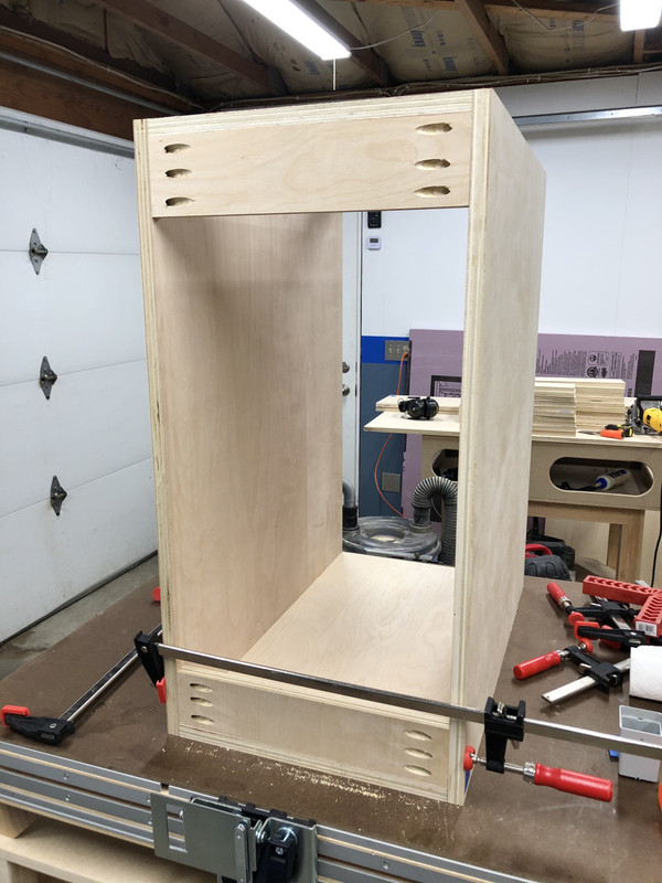

Got some quick work in on the drill press cart today, assembling the carcass.
Construction is the two sides, solid bottom panel, and then two back stretchers and two top stretchers.
To connect the bottom panel to the sides I used a $!#% ton of pocket screws. Sorry, joinery purists. Usually I put one per pencil mark but this time I doubled up since it's going to be supporting so much weight:
If you've used pocket screws you know they like to wander when fastened, so to help with alignment I added some biscuits. Despite what the naysayers might say, I think with glue the biscuits add a second layer of strength. I would never do them alone on a build like this but in combination with the pocket screws it makes sense to me.
Plus, cutting biscuits is super fun and easy.
Into vertical support mode to cut the receiving biscuits in the side panels:
Seriously loving this workstation. It does all the things I planned it to with ease.
Because of the biscuits I was able to glue, align, get some 90 degree clamps and longer F-clamps in place, and then start zipping in the pocket screws.
Another benefit of the dual-joinery is once the pocket screws are in I can take the clamps off right away and keep going.
Then the back gets two stretchers and the top gets two stretchers:

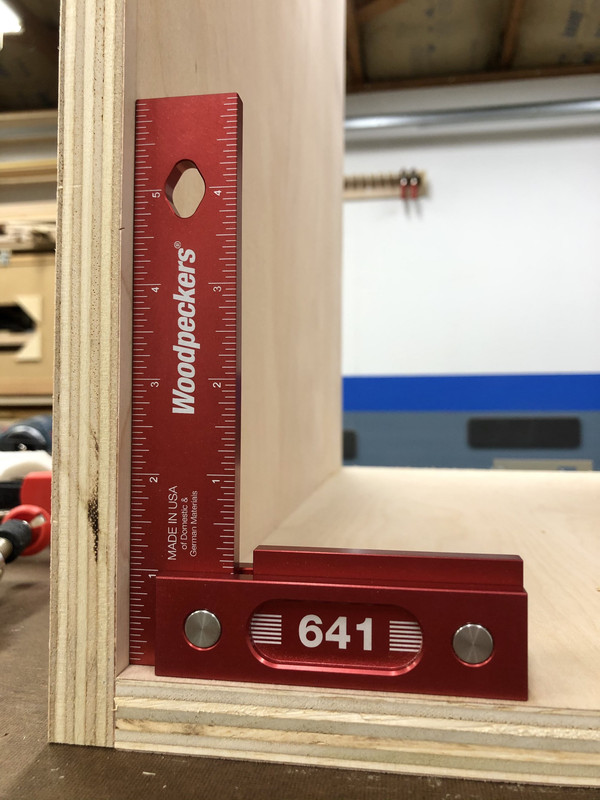

Carcass assembled. I decided to call it quits and since my wife is out of town I was able to push everything over to my usual side of the garage and leave it out, but still pull my car in overnight. Sweet!
This is one of the squarest cabinets I've built! I think I might finally be ready to tackle those living room built ins...
And you know what that means, time to call it a night and crack a beer.

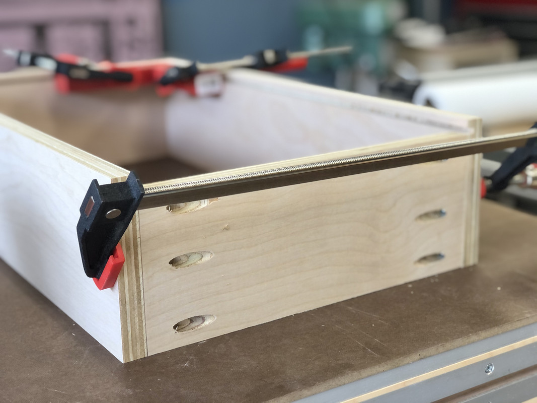

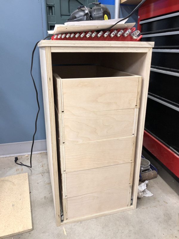

Drill Press Cart - Part 2 "The Drawers"

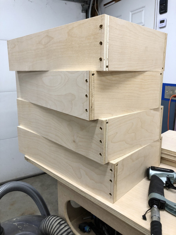

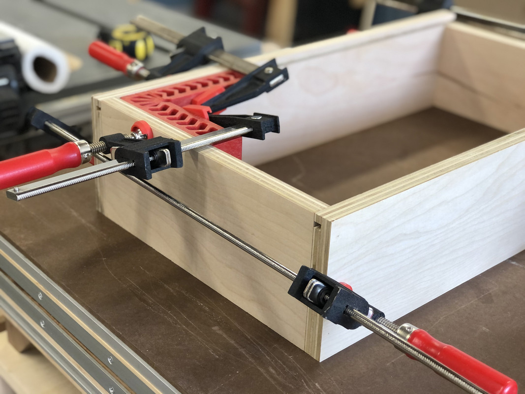

Skipped some pics here because I build all my drawers the same way and I've detailed it before I think.
Using some clamps to square it up to drive the pocket screws in the back:

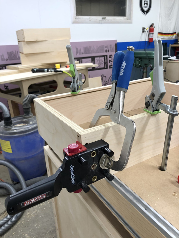

Here's where I took a detour -- normally pocket screws would go in the front as well, but this time I decided to try dowels!! :eyecrazy:
To do this I tacked the front in place with two pin nails on each side.
So since this is a drill press cart I thought it would be cool to use the drill press to dowel the drawer boxes. I didn't take pics of this... but I had an issue with holding the work piece and bored a couple holes too large. The bit also seemed to have some wobble? Hopefully not.
Frustrated I scrapped that, but since I made holes in one drawer already, I figured I better press on.
Enter the mighty Milescraft JointMate doweling jig!! I think these are like $15. Over time I've purchased 3 doweling jigs and I don't really love any of them. But this one seemed the only one that *might* work for my application.
I clamped the drawer box to my bench and the JointMate to the drawer box with a Kreg clamp.
And... the drawer started pulling apart when drilled into (guess the pin nails weren't enough).
Still determined, I reoriented and clamped vertically, adding an F-clamp to hold the front together:
Finally this worked. Unfortunately a number of the drawers have some botched holes getting there... but most of them turned out pretty nice once I got the hang of what worked.
I plan to get some contrasting dowel stock (like cherry or similar) instead of the fluted ones that come with the kits. Hopefully it will turn out halfway decent.
5x drawers total, 22" deep each. Gonna fill 'em with **** to weigh the cart down so hopefully the drill press doesn't tip over and kill me.
Luckily it's just shop furniture, but lesson learned (again) -- test things out on a scrap assembly first! :lol:
