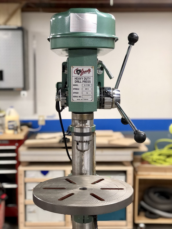

...Thanks for the advice guys. I took a look at the base and the column has a flange that the mounting bolts go through, so it can't be turned. I managed to get 'er upside down and let some WD40 sink in to no avail. After 45min of wrestling with it, whacking it with a dead blow hammer, etc, I realized there is a second set screw.
:eyecrazy:
After I loosened that it turned no problem. :lol::lol::lol:
Guess I shoulda looked at the manual closer.
Lol... we've all been there. Glad you got to the bottom of it.
Is there a set screw on both sides? I downloaded the manual to specifically look to see if that might be the issue, but no mention other than the "5mm screws" being plural. Even the pic doesn't help a whole lot either.

Nick I am a few update posts behind on your thread but IMHO you got a great drill press to start with. One of the most important things to look at for woodworking with a drill press is how much motor you have(3/4hp) is great. It has enough power to run just about an hole saw you can throw at it. And second the length of quill. I looked yours up in the manual and it is 3" which is great. My first drill press had a 1/3 hp motor and only 2 " of quill. Besides having a week motor the short quill made alot of ordinary projects very difficult. I was able to get by with it for almost 10 years. It is sitting quietly in the corner while a find a new home for it.
In addition to the rolling cart for it I recommend a good table with a fence and stop blocks. Another project for you to add to your list.
It's the other black screw about 4" directly above the one pictured in the manual. I agree... it's not very clear!

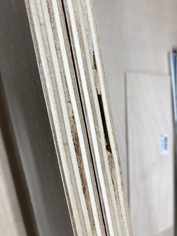

The materials for the MFT set me back ~$500, and probably over 100 hrs to build. Granted, some of the same features could be implemented for a lot less. Many times during the process I questioned "is this worth it?" But I have to say it's lived up to my expectations of it and it is truly multi-function like it's name sake.
I've actually never used Menards (nicer) plywood, but I've looked at it before. It does look nice. A bit more expensive than HD where I'm at. Biggest factor for me is Home Depot is closer and I can stay within the 75min $19 truck rental. But maybe I'll have a better solution for that in the future.
For me, Menards has a larger selection than the others for sure and I am a fan of their prefinished plywood as it seems to be better/more consistent even if I don't need the prefinished. Still got mixed feelings about quality of plywood at all of them. For me its fine for garage and storage purposes but not yet sure if I'll use it for house "furniture" purposes...I'm a ways away from furniture projects though so may give it a shot on some upcoming toddler furniture.
I'd second that, at least when it comes to cabinet grade plywood. HD sells the ply that has a very thin face layer that looks nice, but you can sand through if you aren't careful. Menards is a little more expensive, but has the more traditional full thickness outer layers that you'd expect to see from a baltic birch product.
https://www.menards.com/main/buildi...07409-c-13334.htm?searchTermToProduct=1253102
Agree with you guys. I've been using the Columbia Forest Products birch ply from HD. It's around $56 a sheet here and is not true baltic birch. I find it totally adequate and attractive for shop furniture, but I've actually been agonizing over what to use for my fireplace built-ins I keep talking about but never making. :lol: I'll have to take a closer look at Menards.

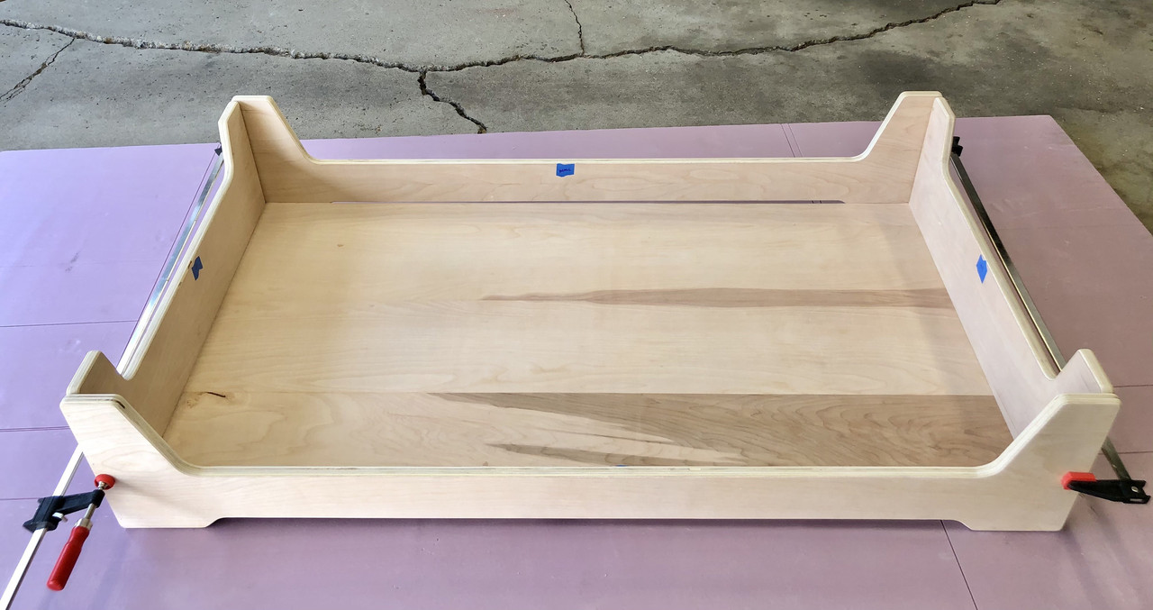

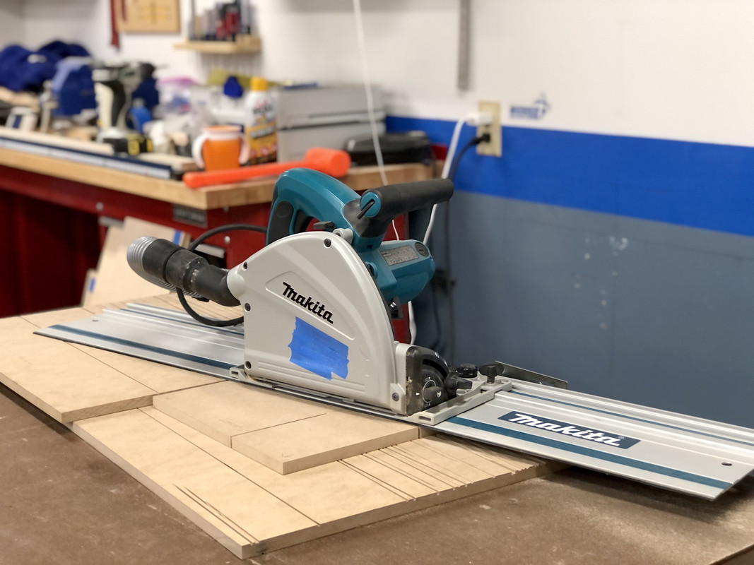

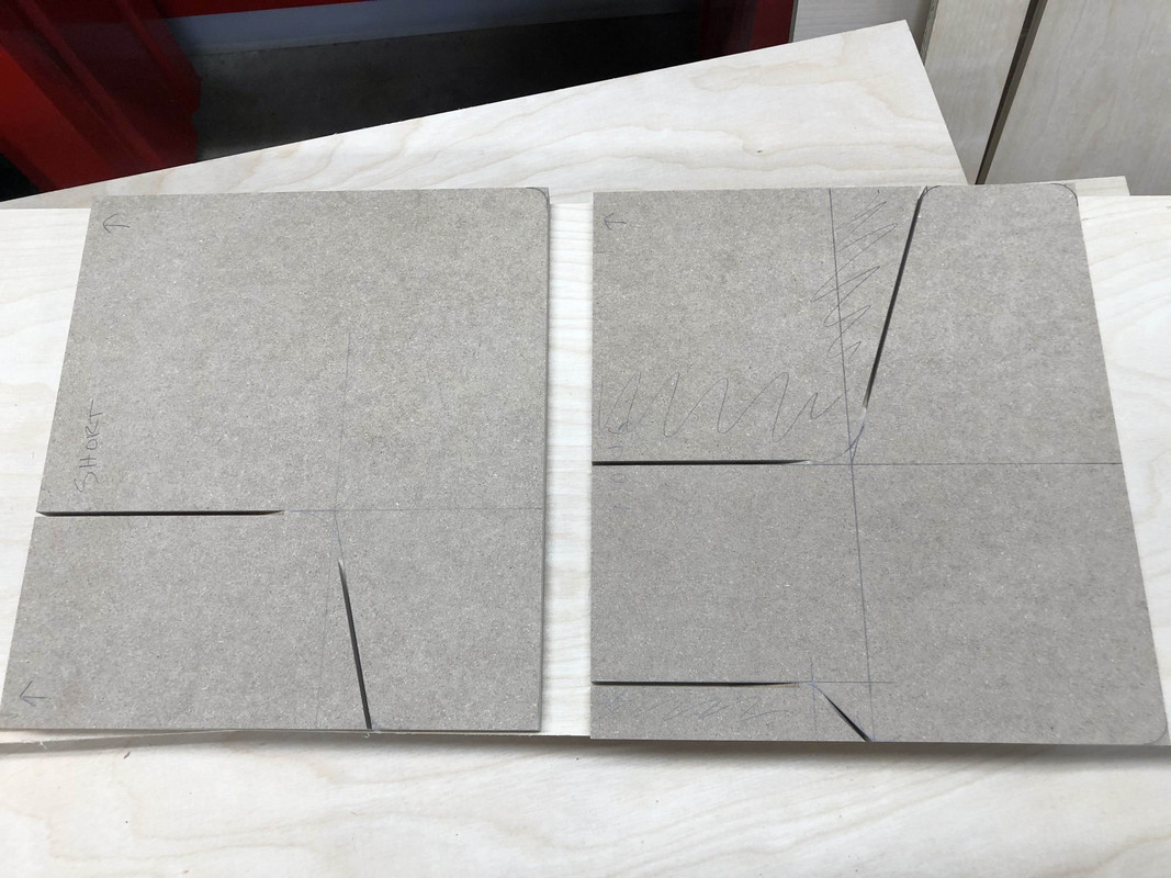

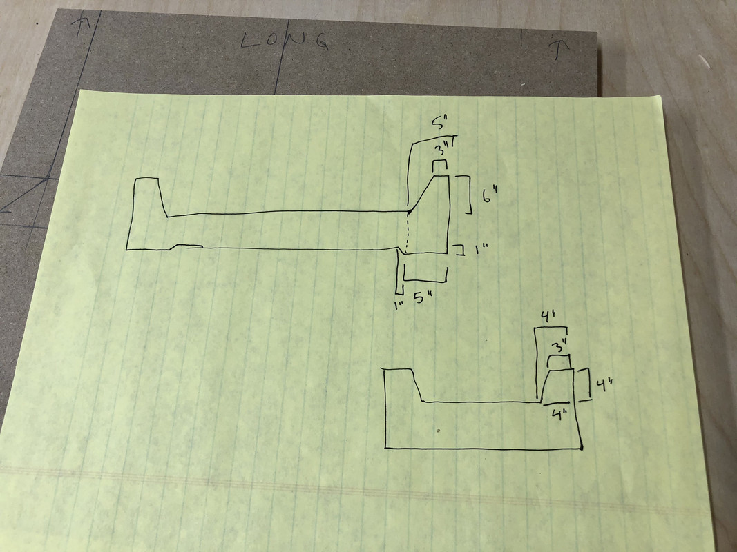

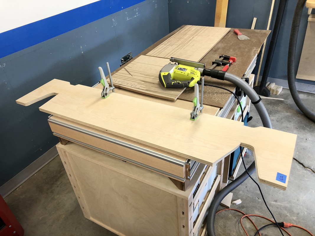

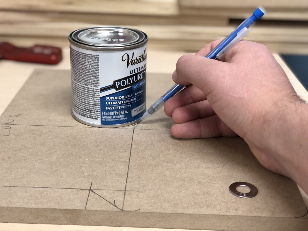

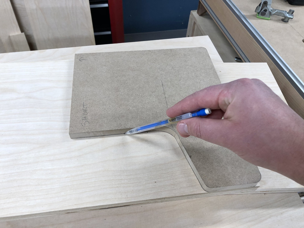

Kid's Bed - part 1 - templates
Since it seems there are 1 or 2 people interested in the bed I am going to try and document it well. At least how I am approaching it.
It's just five pieces (2x long sides, 2x short sides, mattress support). These were all dimensioned during the plywood breakdown process depicted earlier.

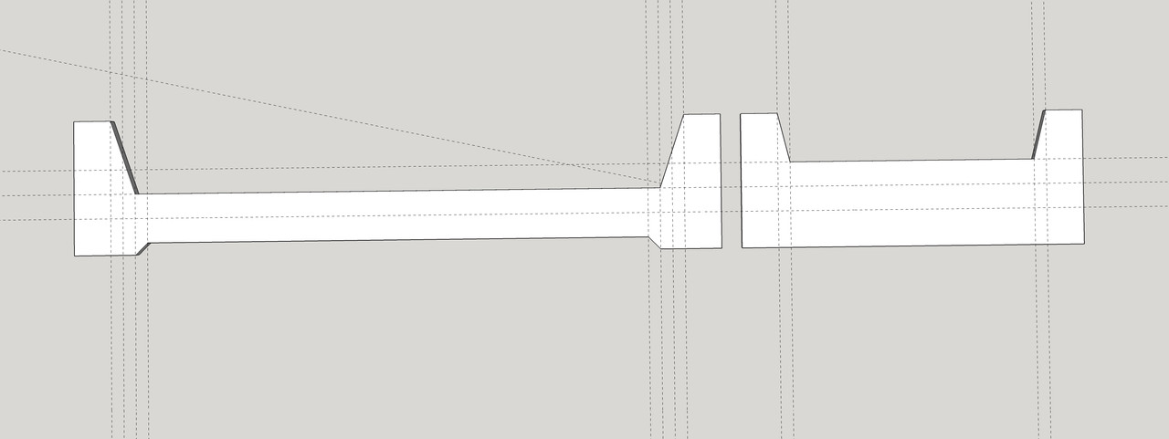

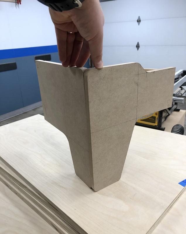

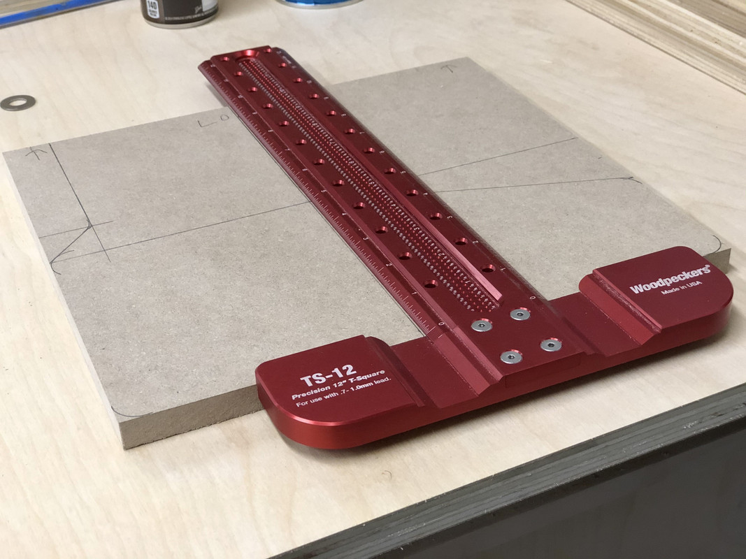

Tonight I decided to tackle making templates for the ends of the sides, as this is how I am choosing to tackle the shaping of those. The templates will then be used to flush-trim route the actual pieces.
It's not that complicated, but to copy the inspiration bed, there are some rounded intersections and kind of a softness to it.
To start I ripped some scrap MDF to the same height as the side pieces, 11".
Looking at the reference photo I laid out some quick guidlines in Sketchup, jotted some notes to bring to the shop, and laid them out on the MDF.
Next I drew the radiuses, which can be created from any circular shape on hand - varnish cans, washers, etc.

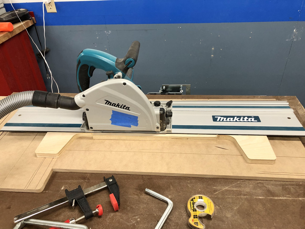

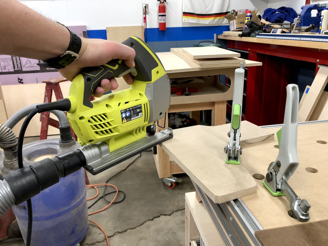

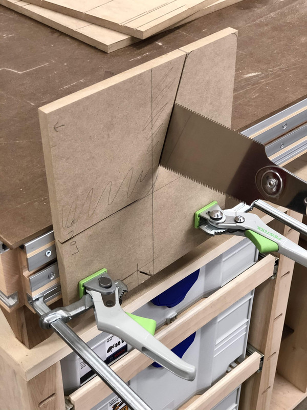

To cut out the straight portions, I think you know what tool I used: :lol:
This just leaves the curves:
For which I used the jigsaw -- cutting close to the line but leaving a little room:
Because the tracksaw blade is circular the straight cuts need to be extended on the back side with a hand saw, so I threw the templates in my MFT "vise":

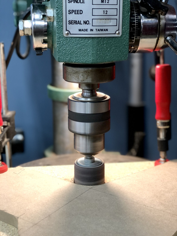

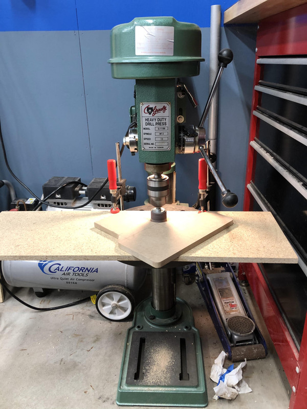

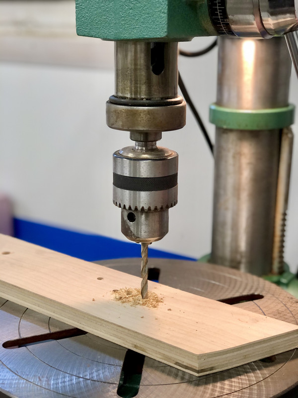

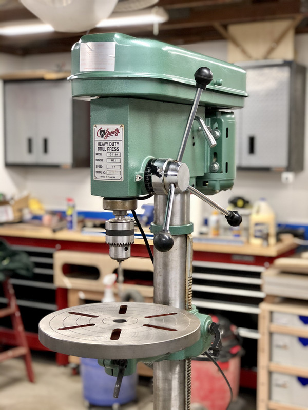

Lastly I smooth out the curves with... the drill press!! Inaugural use! Sanding down to the pencil line.
So the results were excellent. But one thing that has me worried -- the sanding drum had some wobble. And the doweling brad point bid the other day seemed to have some wobble / run out. Can any of the drill press experts weigh in? If I have an issue would this be fixable with a new chuck potentially, or is it maybe installed crooked?

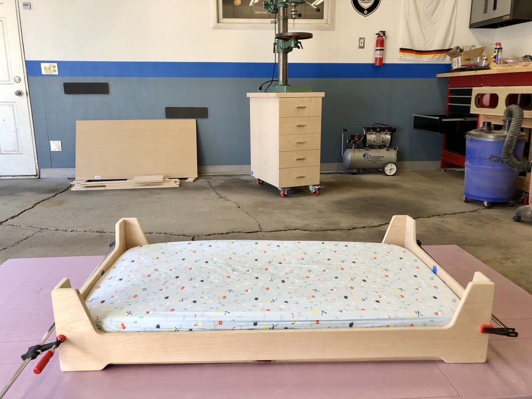

Here you can see what a mated corner of the bed will look like based on the templates:
Next will be cutting and flush trimming the actual pieces, just gotta find time to get to it!

Nick you can pull the Chuck out of its taper. It might have some trash or something in the taper causing it not to run true. Clean up both surfaces and then reseat it see if that helps it. There also could be something inside the chuck itself. Trying cleaning it out as well.
As far as the sanding drum it is usable on the drill press, but the drill press is not designed for side load like a milling machine.

Assuming this is the right model, you should be able to pop the chuck assy out by making a taper punch shown as item 73(assuming it didn't come with yours as they rarely do when used) out of a piece of scrap hardwood or metal to tap the chuck assuming out via the slot in the quill...shouldn't take a ton of force
Once the chuck is out you can check to clean all surfaces up and see if that helps with your "run out". If not, may need to remove the chuck from the arbor to clean those surfaces as well...or it may just be a bit "sloppy" in the quill and not much that can be easily doneScreenshot_20200902-104042_Photos.jpg

Thanks for the advice! I was very gentle with the sanding drum, hardly any pressure. I figured since it was just MDF and I was being careful it would be alright.

Thanks for the detailed advice. Tbh I've barely used the drill press, just something I've seemed to notice. I'll have to do more testing and probably take it apart and clean it to make sure.

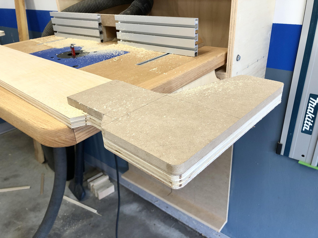

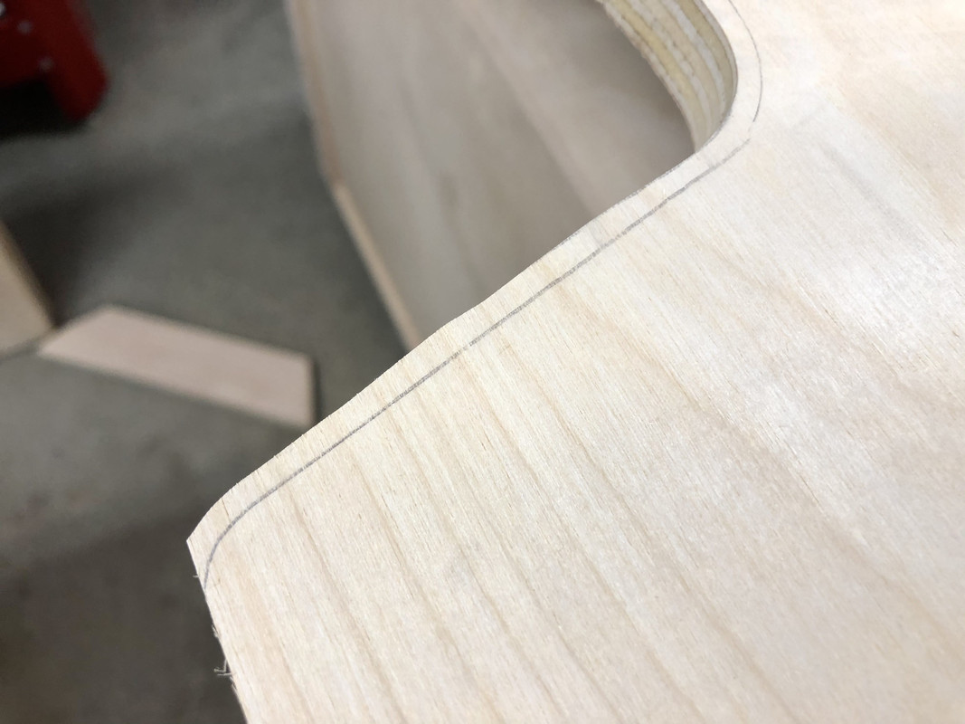

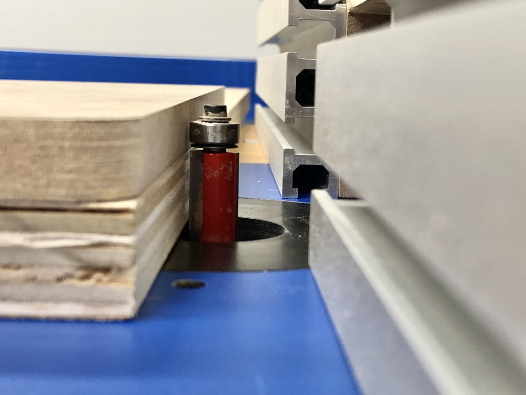

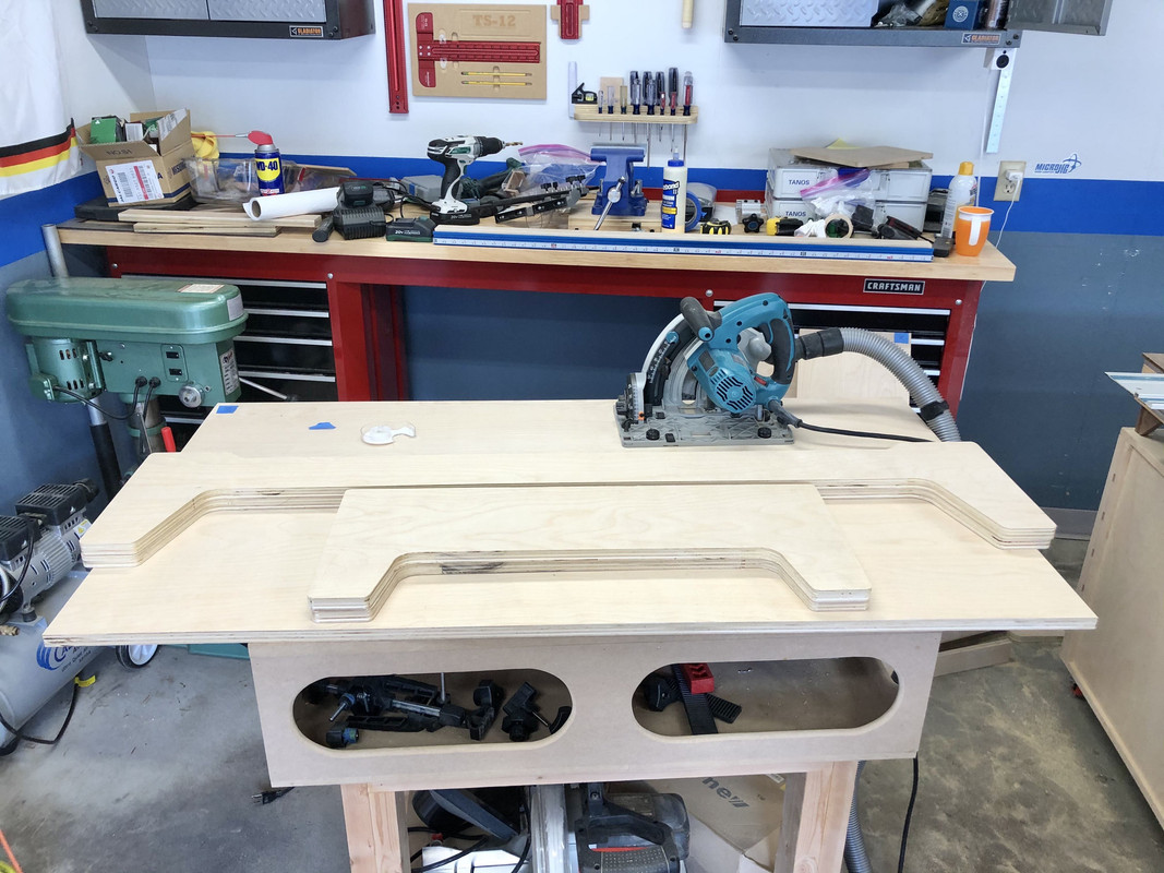

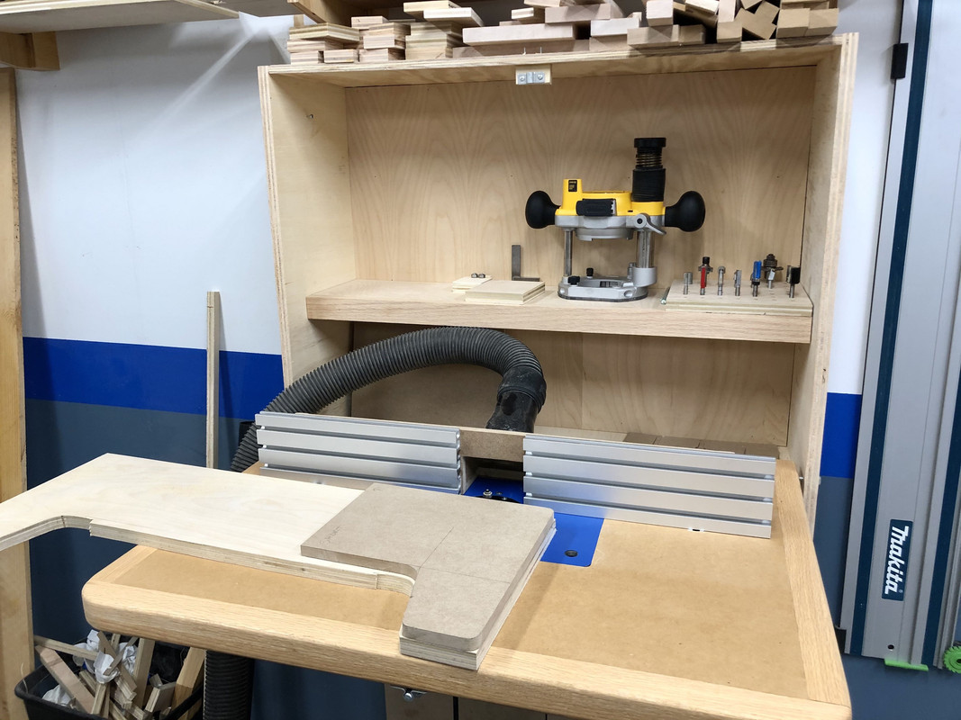

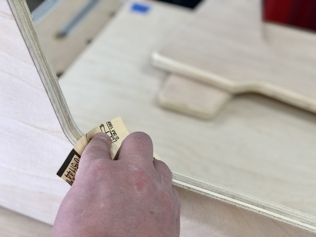

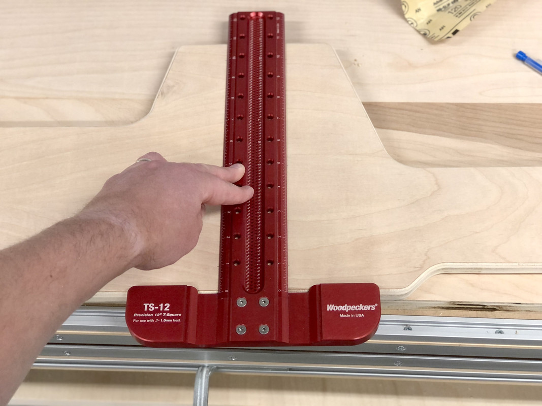

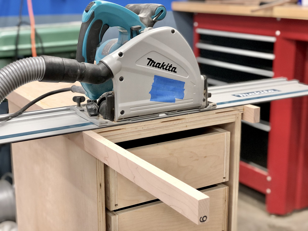

Kid Bed - part 2 - template routing the sides

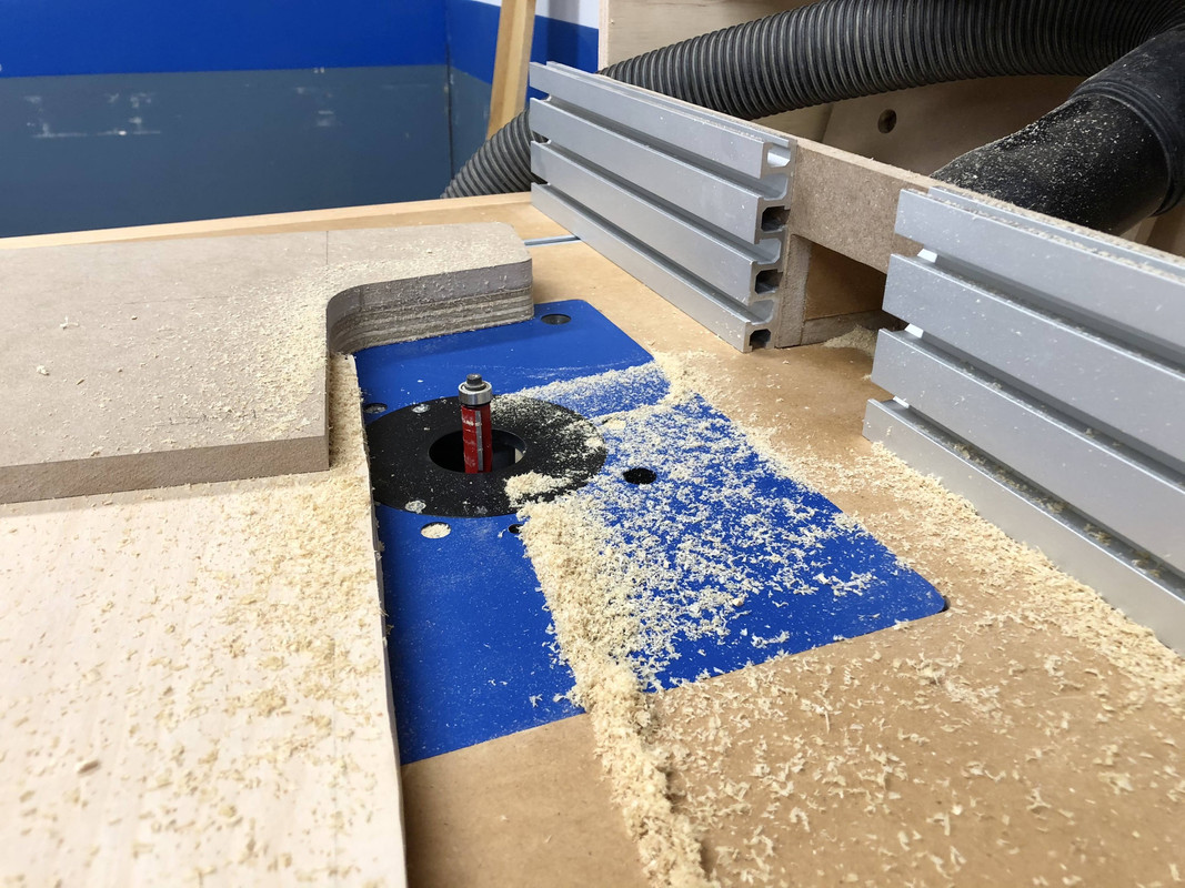

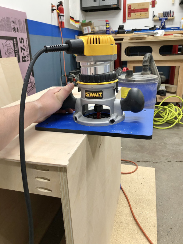

With the MDF templates made I could use them to route the plywood.
This is fairly straightforward stuff but I will document it in case anyone wants a "how to". 1st step was lining up the template, and tracing it in pencil onto the plywood.
Then I cut close to the line with a jigsaw, but leave an 1/8" to 1/4" past the pencil line. Less is better, but I went more like 1/4" since I don't trust myself with a jigsaw. :lol:
Then put the template back in place, and secure with double-sided tape.
Now it can be pattern-routed with a flush trim bit at the router table (bearing rides on template, cutter copies the shape). This could also be done handheld, but I like controlling the workpiece at the table more.
Last step was to "connect the dots" and cut the middle section between the legs straight. Track saw with it's plunge action made perfect sense for this, although a table saw could be used as well, raising the blade through the material.
After making one full side, I use that as the "template" for the other side, so they end up identical.
With the short sides done, rinse and repeat for the long sides:
Chip collection was non-existent for this task, I really need to make a downdraft box, but the router table was very enjoyable to use for this process.
And here are the routed parts for all the sides:
They will still get a 1/4" roundover and substantial sanding to smooth them out. Unfortunately with the plywood there are some voids I'll need to fill, too.
Back at it when I can.

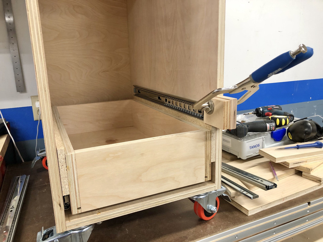

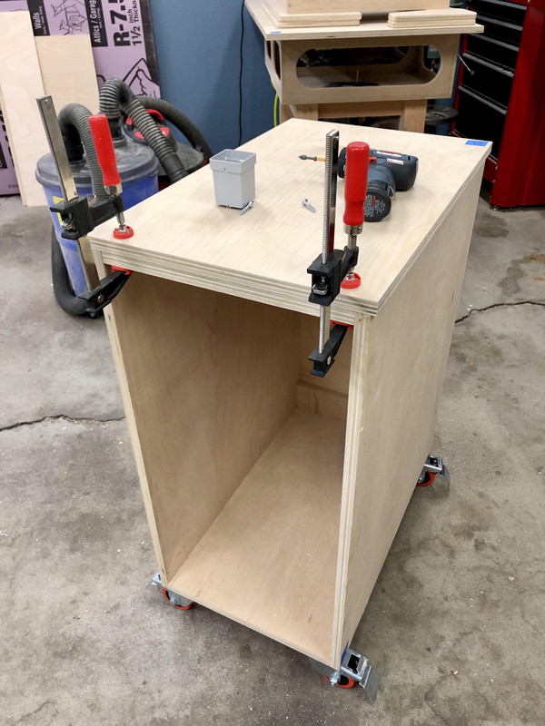

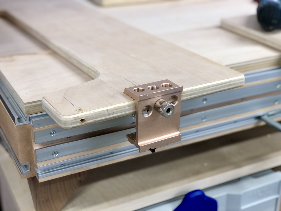

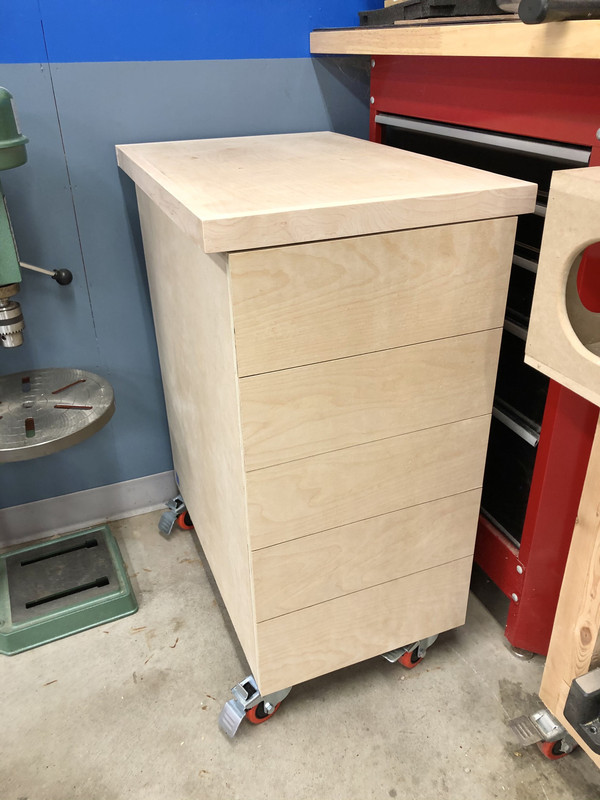

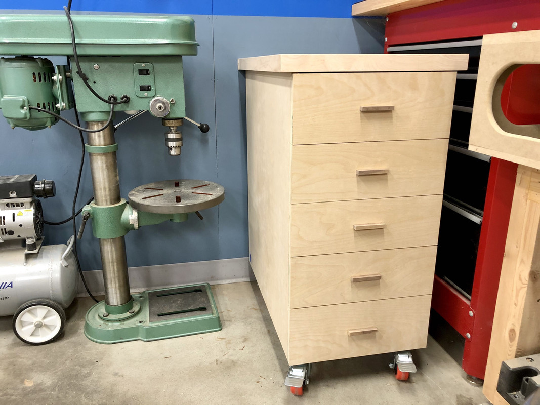

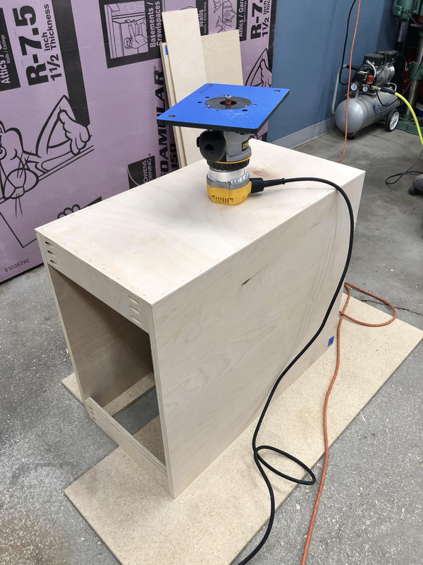

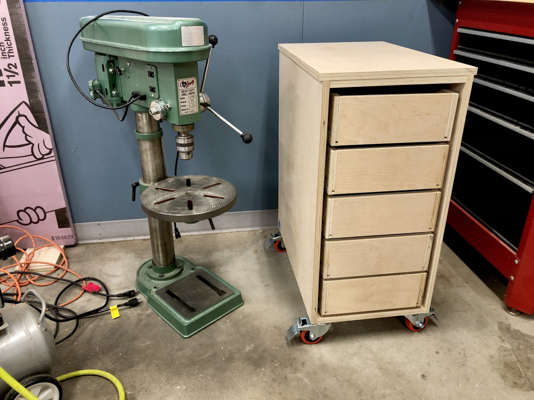

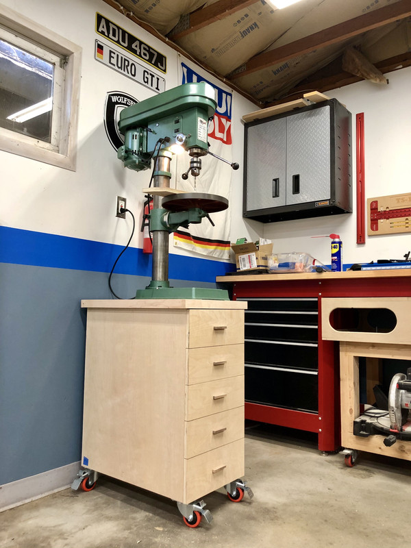

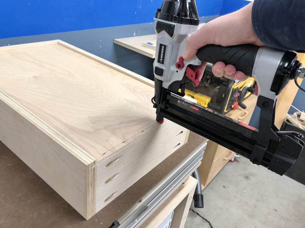

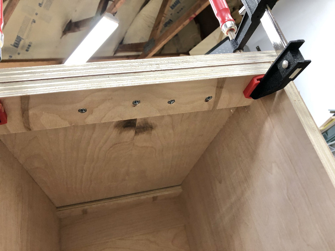

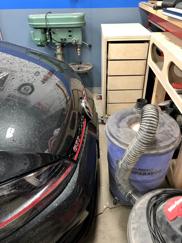

Drill Press Cart - part 3 - staple mania
Small end-of-Labor-Day-Weekend update.
Had a busy weekend with family. Mostly around the house but Labor Day was my wife's birthday so we had some extra celebration.

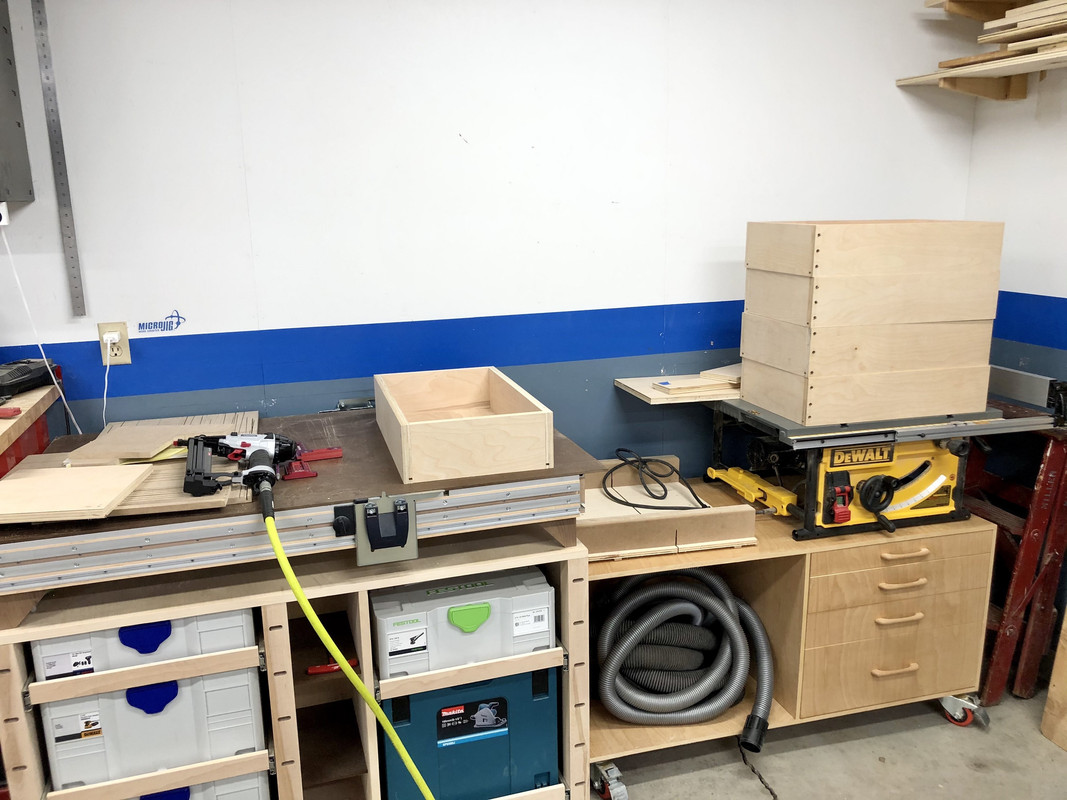

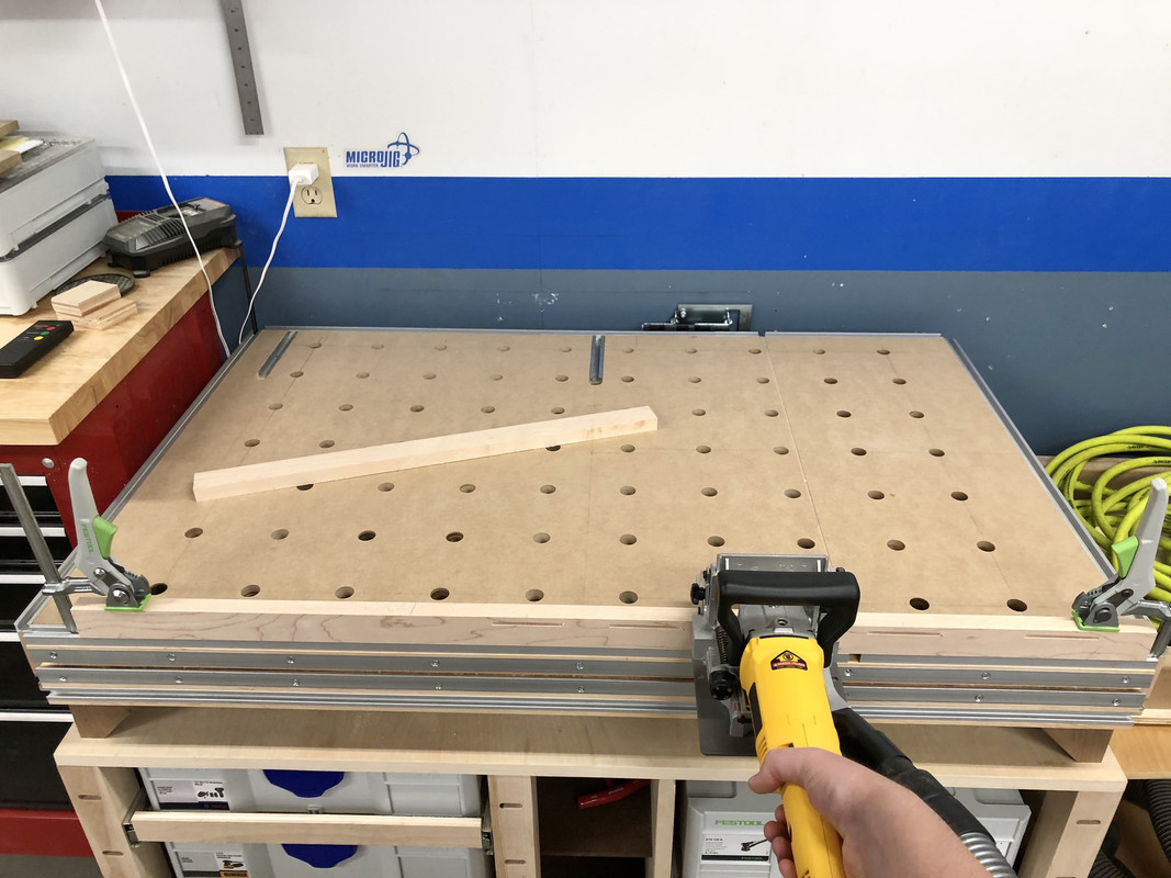

During naptime today I had a chance to do some more quick work on the drill press cart, switching gears from the bed.

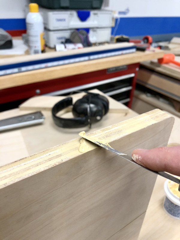

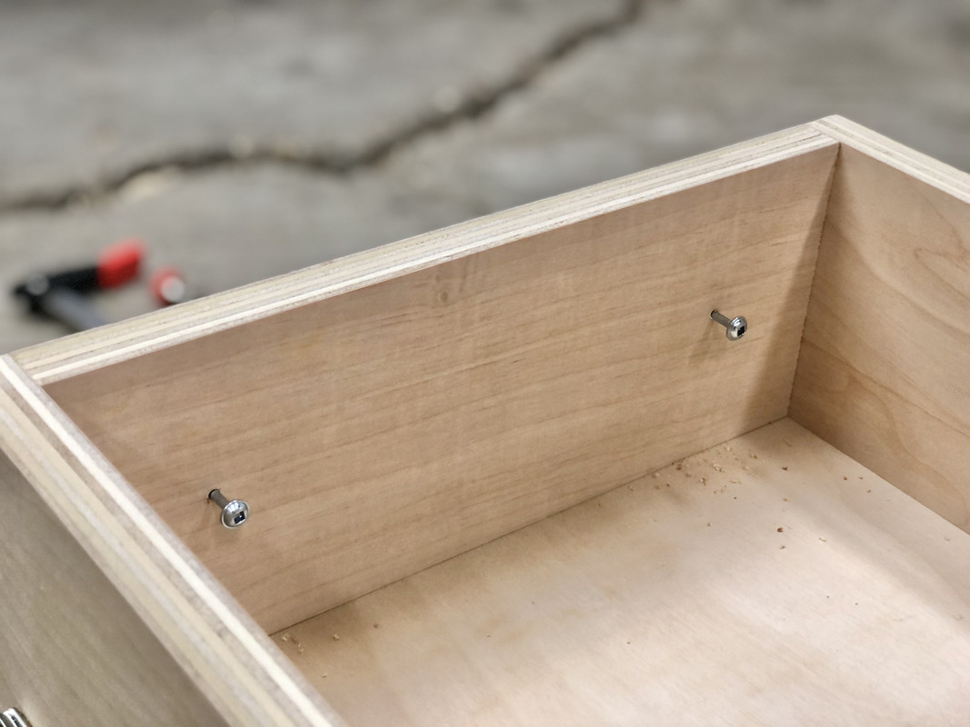

I got some 1/4" ply for the drawer bottoms, so I cut that. I cut them all with pencil marks and track saw. Don't need to to be super precise as long as they fit.
I've only every built drawers one way. I think I learned it from Jay Bates on YouTube. Dado/groove sides and front to accept the bottom. Back is cut short and bottom overlaps it -- then fasteners through bottom into the back. Drawer bottom is plywood so stability is not an issue, and it is free-floating in the dado on the other 3 sides.
Here is that depicted with the drawer upside down, back facing towards you.
Normally I use countersunk screws to fasten the bottom, but with 5 drawers I decided to try my staple gun which I've never used but came with the set.
Some trial and error setting the depth, but went fast and easy.

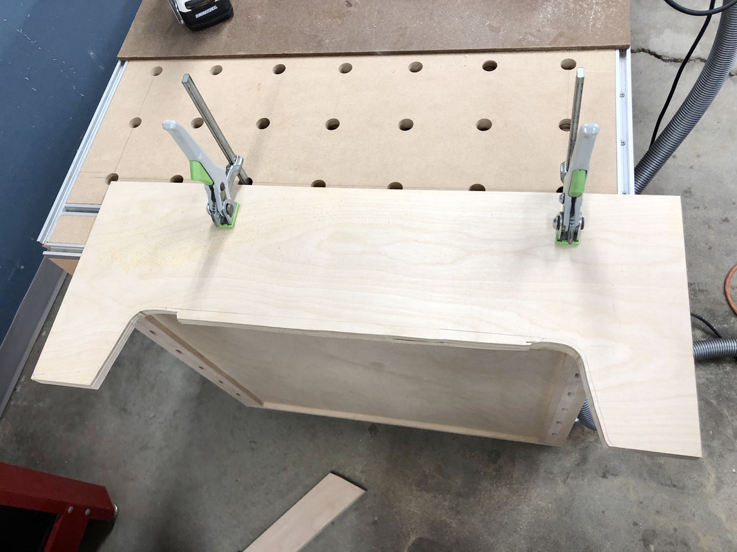

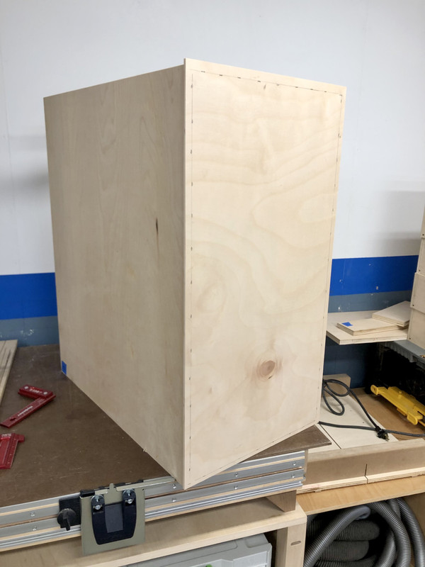

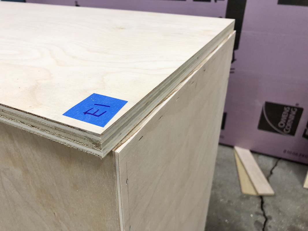

With leftover 1/4" ply, I made a panel for the back of the cabinet. This will provide additional support to keep it square and prevent racking. Since I had the staple gun ready to go I tacked that on as well:
I intentionally made it slightly oversized, so I could then use the router to flush-trim it to the sides and top.
This method works great to achieve an exact fit.

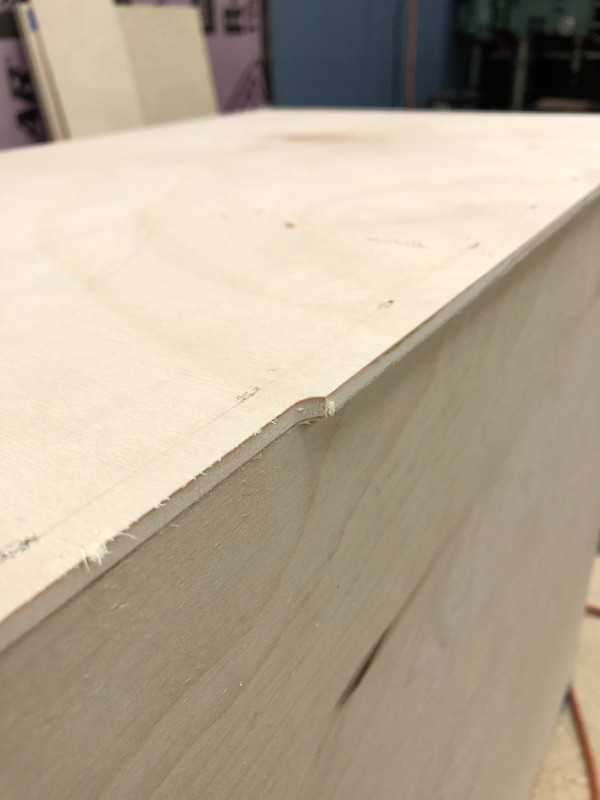

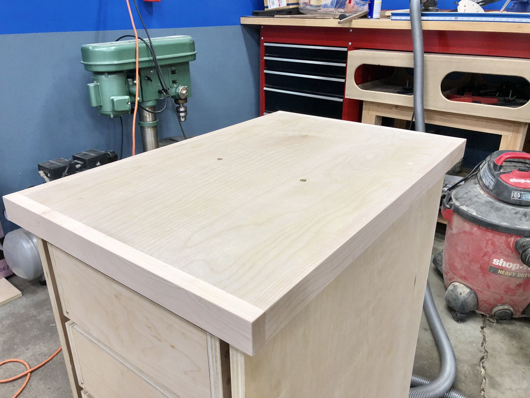

Unfortunately I already had cut the top panel before adding the thin back panel, so it doesn't overhang it:
:mad:

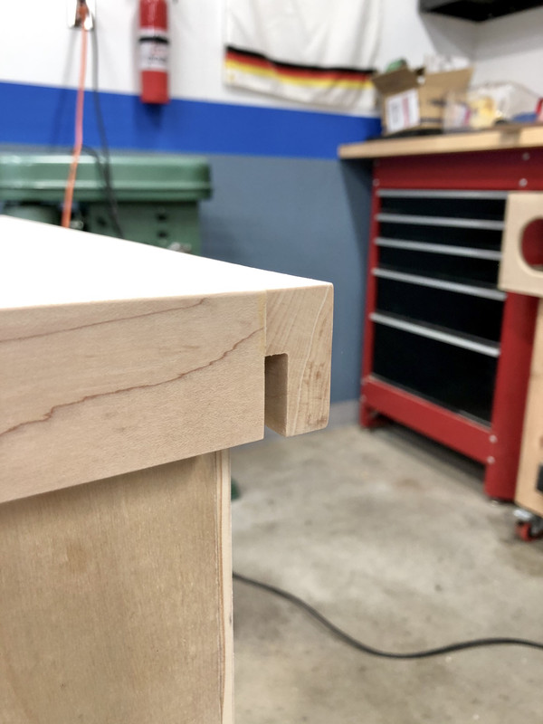

I think I'm going to cover up this mistake with some hardwood edge banding around the top.

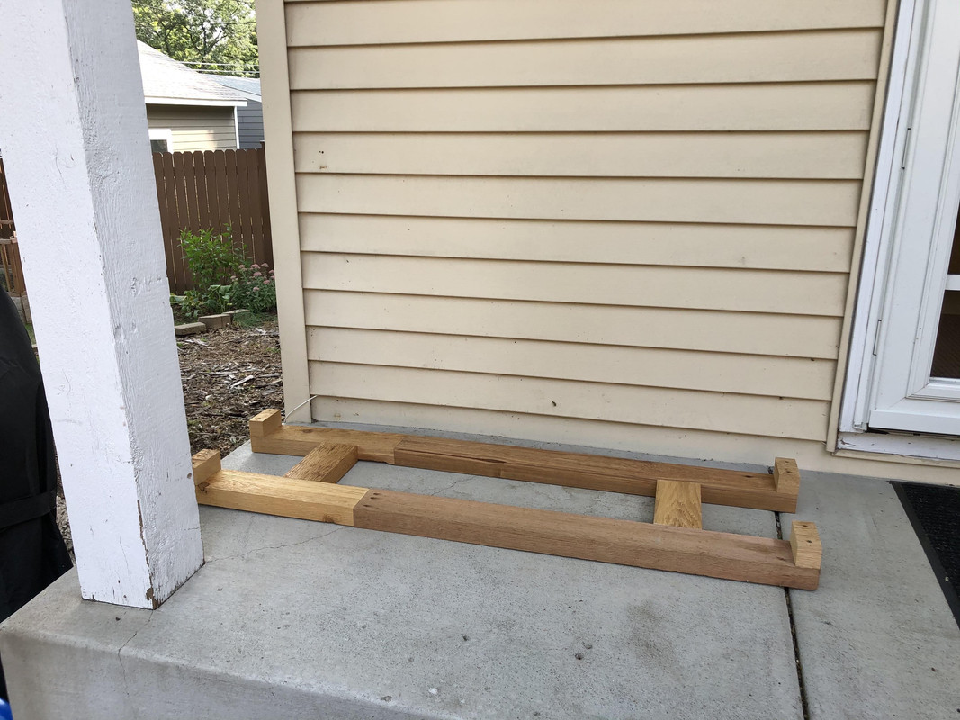

A couple years ago I dug up some overgrown shrubs on the alley side of the garage and planted some raspberry bushes. They have taken over nicely and give a nice little yield from time to time. My daughter likes to eat them when we pass by in the stroller. :lol:

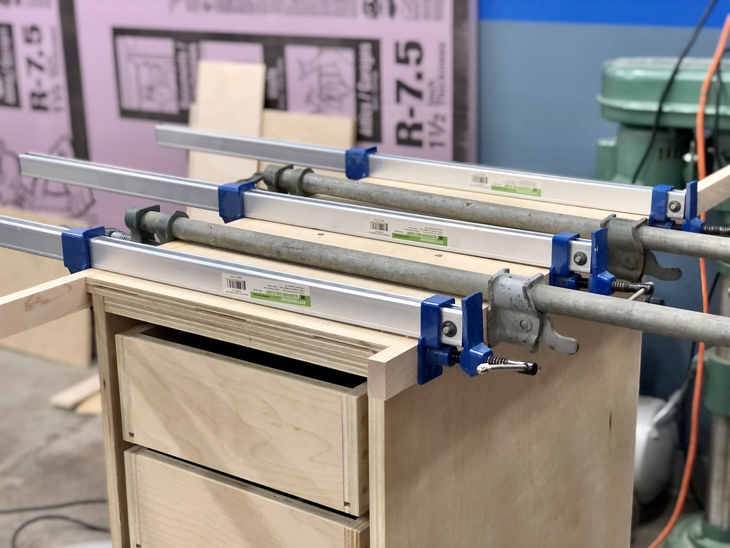

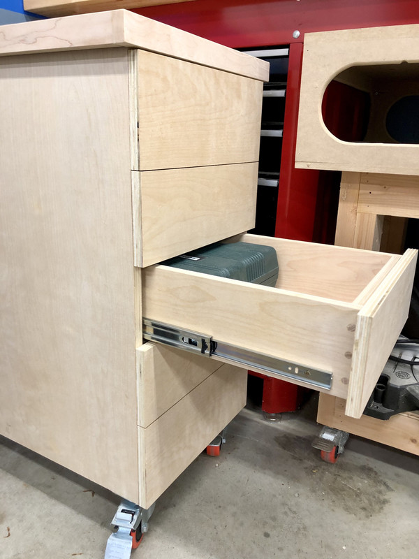

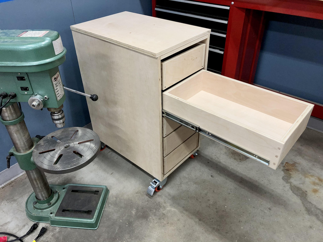

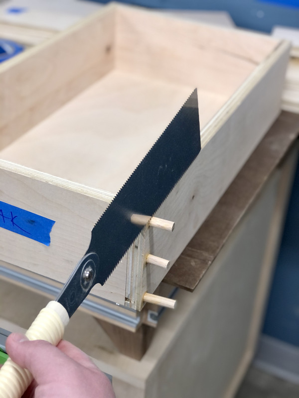

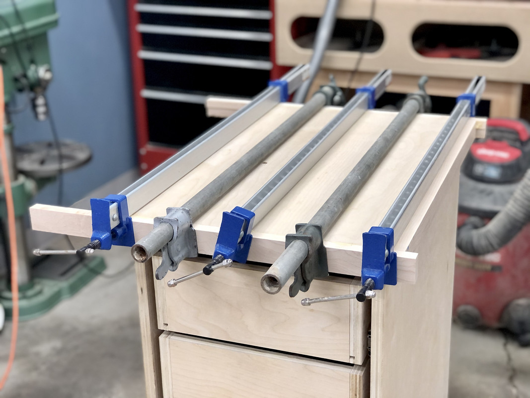

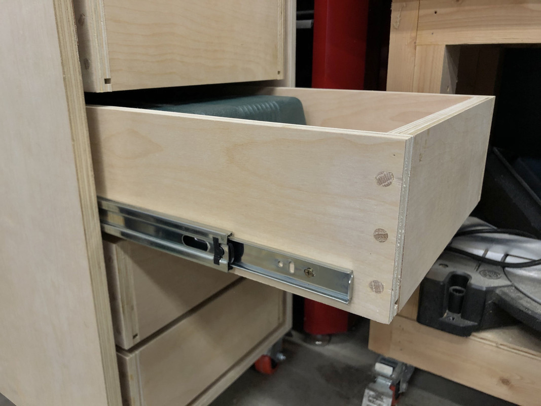

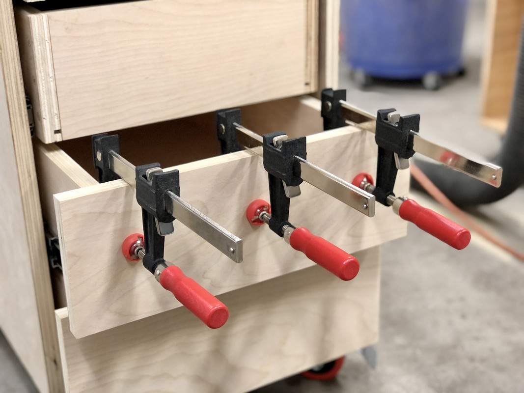

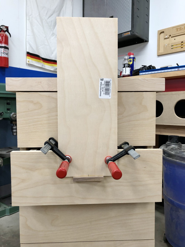

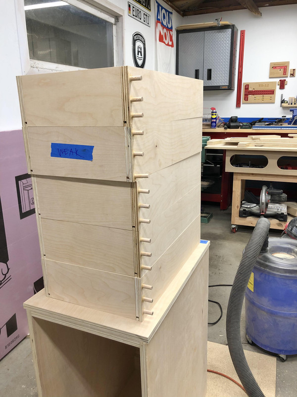

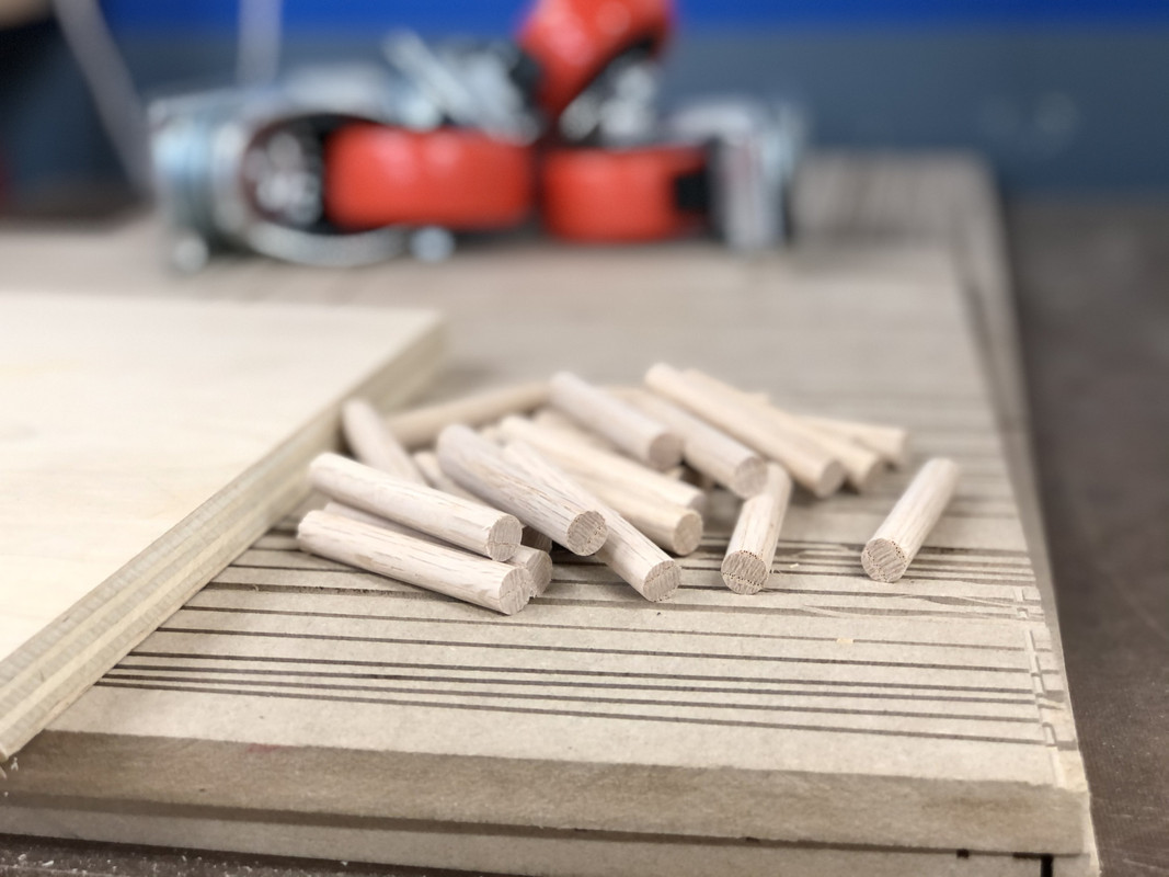

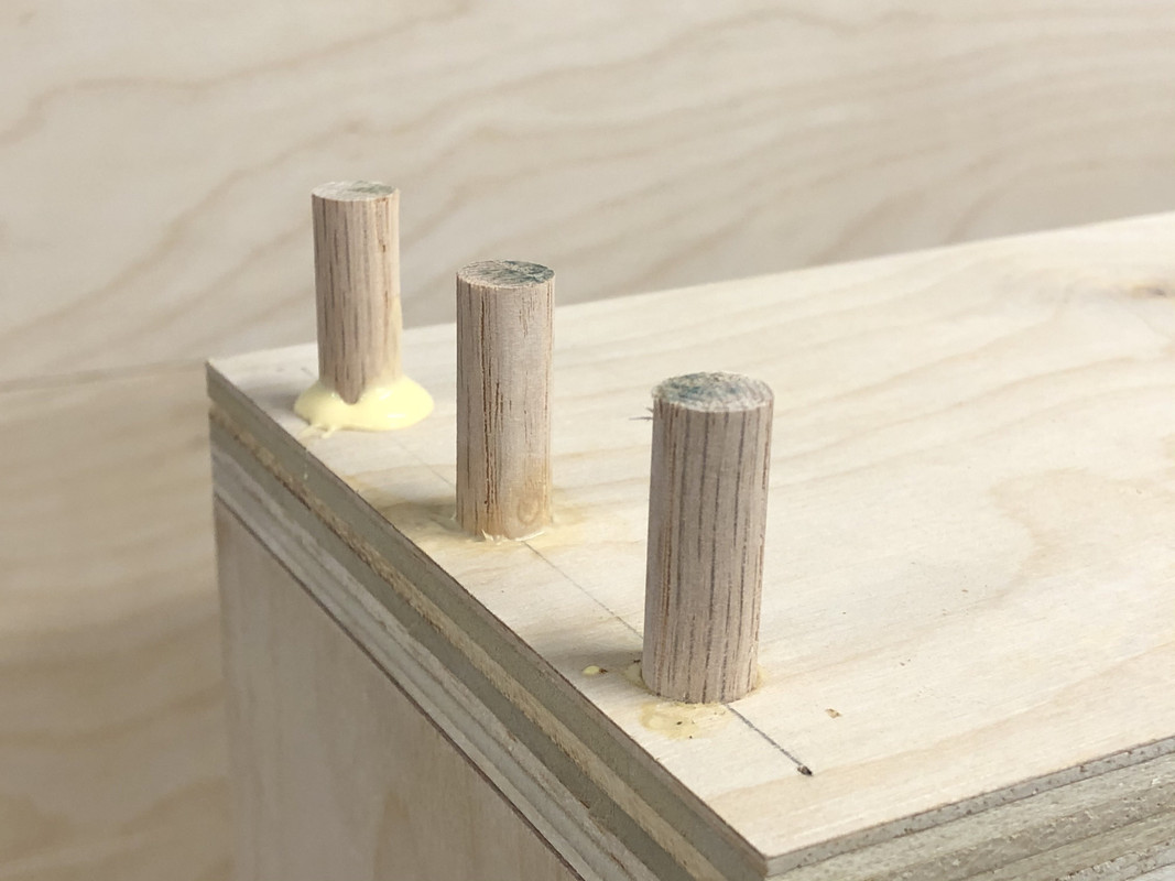

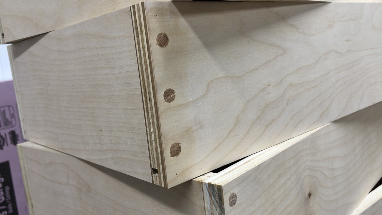

Drill Press Cart - part 4 - installing the drawers
Got some things done!

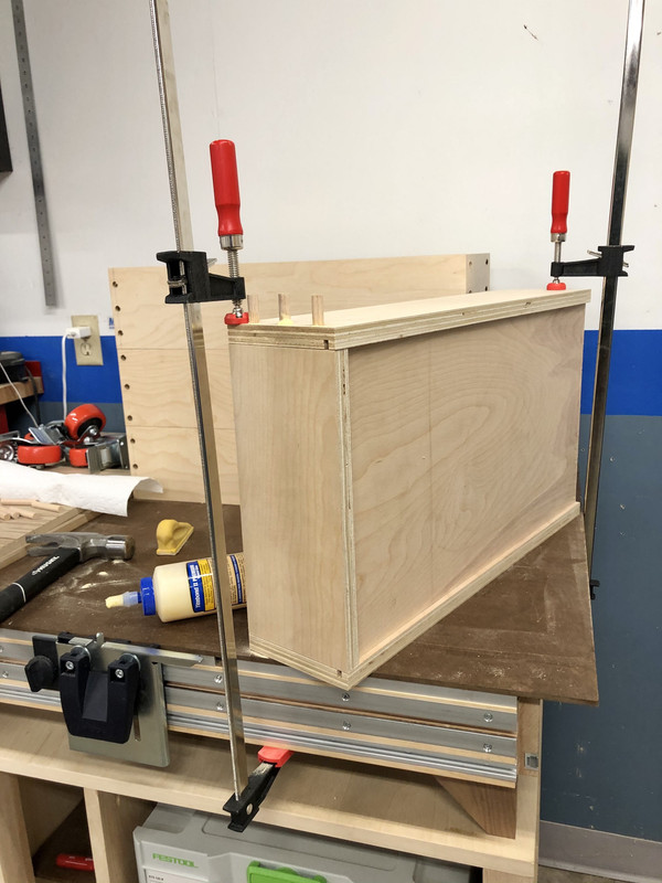

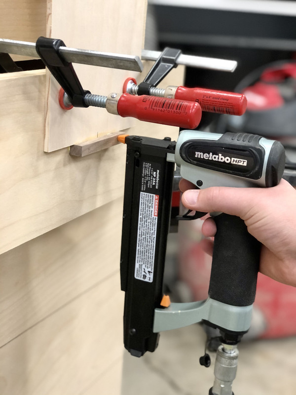

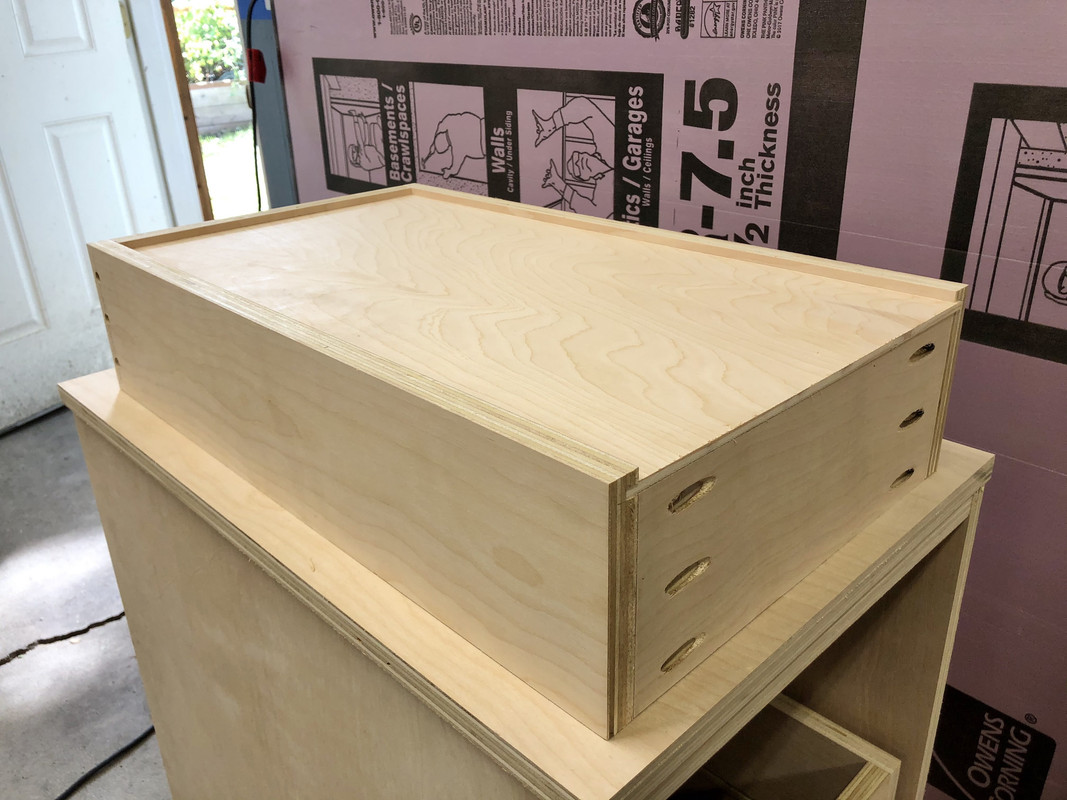

To finish the drawers I needed to install dowels so I cut some oak dowel stock. I had wanted walnut or cherry or something like that, but didn't have time to go to a specialty store and just got some at Home Depot.
Clamp the drawers for security:
Spread some glue and wham bam bam with the hammer!
I did just one side at a time since they need to lay on their side to be installed easily.
Trimmed them flush with the Japanese pull saw.
I wiped some water on a finished one to see the end grain pop:
Then on the cart I put the casters on. No pics but self-explanatory I think.
Then I fastened the top to the cart. Just a bunch of screws up through the stretchers.

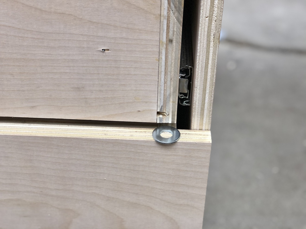

Drawer slides from Amazon showed up this afternoon so I got the drawers installed, too.
As with previous drawer-cabinet-builds, I ripped some scrap spacers from particle board to assist installing the slides and drawers evenly.
In the above photo you can also see the little plywood block in the Kreg clamp being used to set back the drawer slides 1" repeatably.
The process actually went relatively quickly.
The drawers are super long. :lol:
Earlier you may have been wondering -- why set back the slides a whole inch? Well I got side mount slides and didn't want to cover up the dowels I worked so hard on. :lol::lol::lol: Yeah, didn't really think that one through.
Good news is the car still fits but the bad news is just barely.
And the cart blocks the Craftsman bench drawers on that side. And the drill press will need to be rolled a bit away from it every time I want to use it. And now I can't walk past that side when the car is in the garage.
I'll get to the finishing bits of course, but as it is now it's more or less functional.
Funny thing is plywood was ~$60, drawer slides were $40, hardware to mount the drill press and dowel stock was ~$15, casters were ~$24. Do some quick math (yuck!) and that comes out to $139.
For an extra $139 I probably could have just found a floor model!

...Good news is the car still fits but the bad news is just barely...
Well, I guess once the next tool purchase is made, you'll just have to tell your wife to start parking in the street.
...For an extra $139 I probably could have just found a floor model!
Yeah, but then it wouldn't have been mobile and you wouldn't have those extra drawers for storage. Trust me, the first time you need to drill a hole in the middle of some long piece of stock, you are going to be really glad you can just roll your drill press to the middle of the room.
Cart looks great! Looking forward to seeing it all buttoned up with faces and pulls.
Lol! Need to make room for that planer / jointer / bandsaw :lol:
Let's just say before we got the house our apartment only had one garage space... can you guess who got it and who parked outside?
I actually wouldn't mind parking outside in the summer if I had a usable driveway, but I don't like parking overnight on the street because it is not lit well and I worry about getting hit.
All true! I'm going to have to be VERY careful rolling it over the cracked floor.

Drill Press Cart - part 5 - drawer faces
I was able to get in some more work the past couple of nights. A few mistakes were made, but it's shop furniture so I'm not too butthurt. And a few things went well, too.

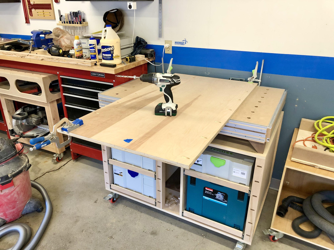

First task was edgebanding the top of the cart. Not necessary, but had some extra maple from HD so why not. I ripped it, cross cut it long, and marked out some biscuits for alignment:

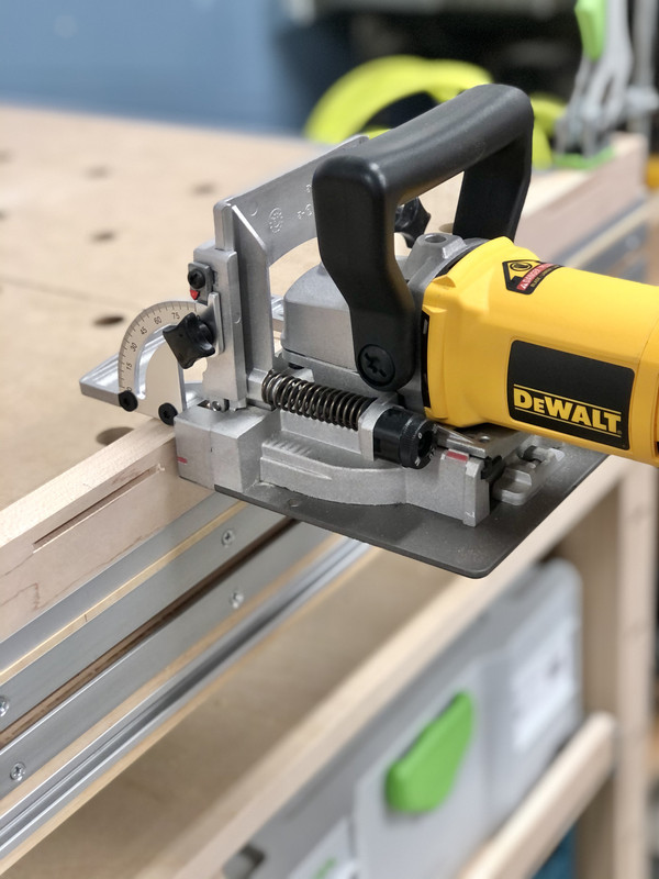

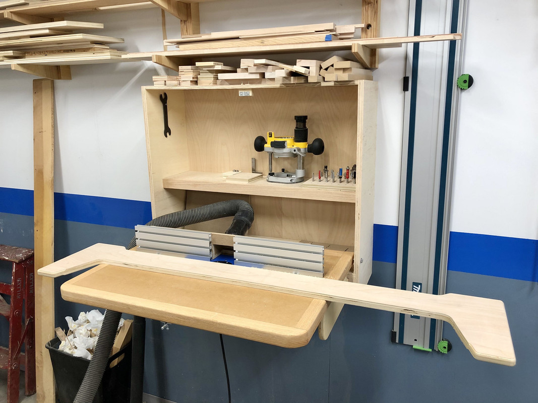

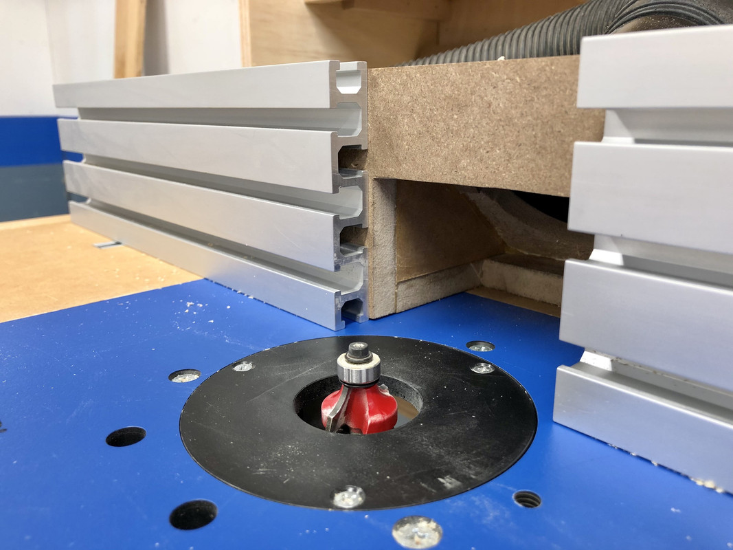

Once again the home-brewed MFT proving its worth. With the old Paulk cart I still ran into situations I couldn't clamp easily. So far so good with this one.

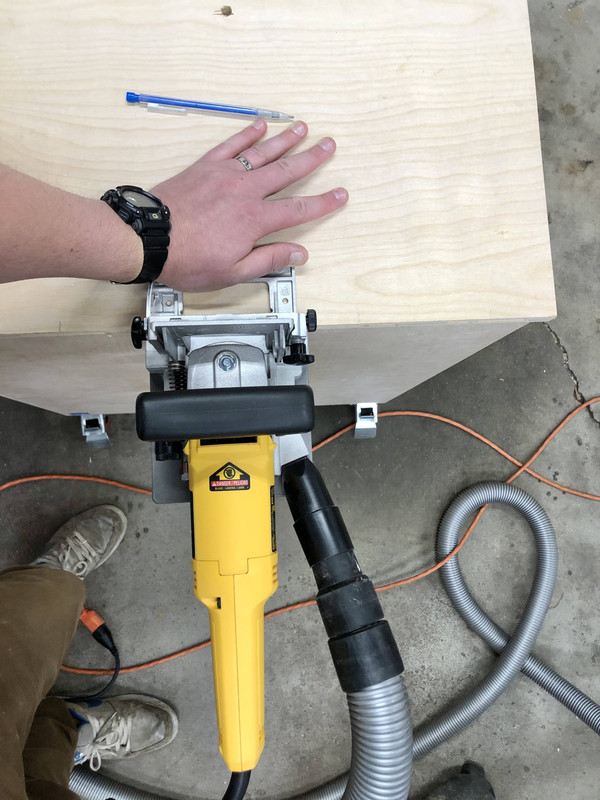

Then I made corresponding biscuit cuts in the cart top:
I know they are somewhat controversial, but the biscuit joiner is FUN to use.
I glued and clamped the sides first:
Because I left the edgebanding long, I trimmed it up with the track saw. Instead of pre-crosscutting it to length, this way I didn't have to worry about aligning it perfectly during the glue up. Trim after.
Rinse and repeat for the front and back. I thought about mitering the corners, but decided to not make more work for myself and just overlap them.
One booboo I made was the rear piece I had to rabbet out the bottom to account for the cabinet backing panel sticking out (an earlier mistake I made). I forgot the rabbet would show on the side -- I should have had the sides overlap the back piece.
Second task was the false fronts on the drawers. I cut these from a single piece of ply for grain continuity, although I oriented it horizontally and it's a bit busy so I don't think it really comes across that well.
I use some washers to set the drawer spacing evenly.
And the same trick of inserting the screws so the points just protrude and then making an impression on the false front.
This time I didn't pre-drill the false fronts and clamped them tight so they didn't wander while sending the screws home:
Side note: I used Kreg pocket screws to attach the fronts. Sometimes Kreg screws can be useful outside of pocket screw applications. They have a nice, flat, wide head, and these particular ones have coarse thread for plywood.
It worked great.
Not really a mistake, but I would comment that I think the top would look better if it overhanged the drawers in the front like it does the sides.
From here... I'll probably have one more post with the finishing touches on this, and then back to my daughter's bed.

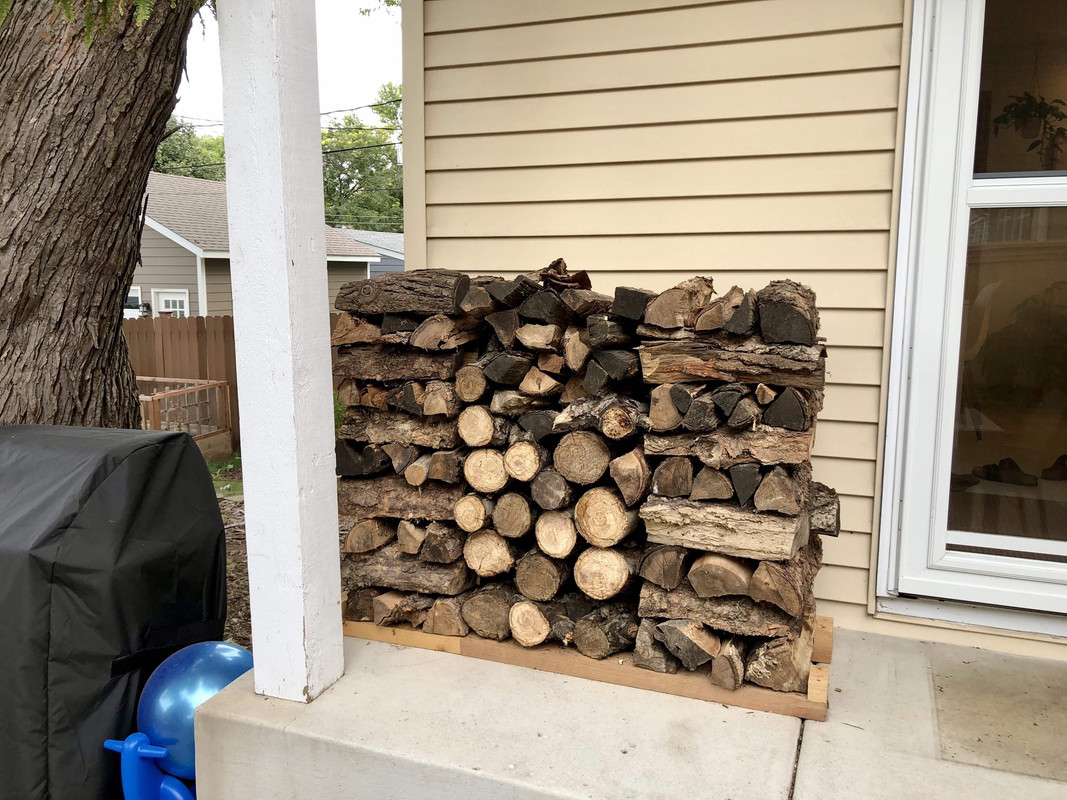

An itsy bitsy teenie weenie update from the weekend:

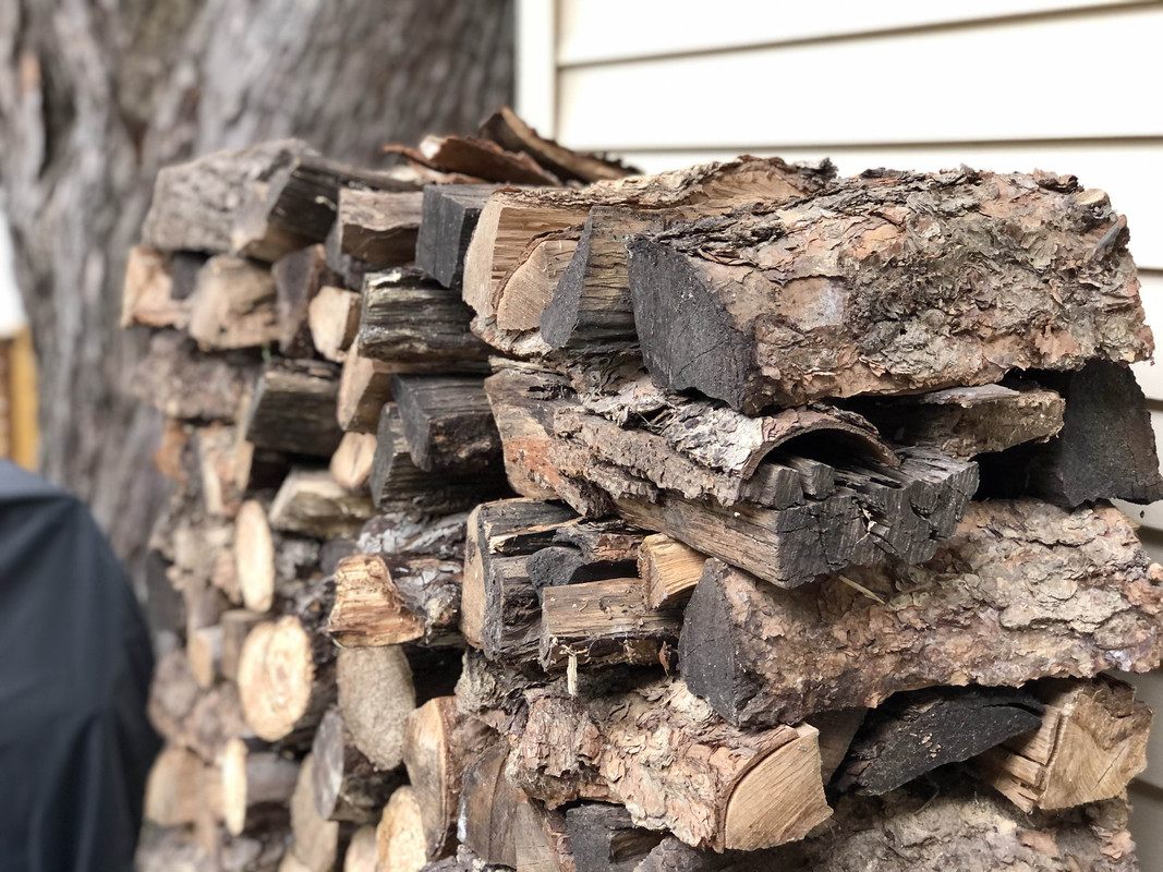

I was planning on buying some firewood for fall / winter, but my dad offered I could take most of his. My parent's as of late usually only burn a fire at Thanksgiving and the holdidays, so I took almost everything they had :D and it's probably 4 years or more old so nice and seasoned, including a birch tree from their yard. A mix of birch and oak.
I don't have a great place to store firewood on our property so I stacked it by the back door. Don't love it right by the house but will be convenient. To do so I whipped up a quick cedar base from some leftover fencing material.
Did my best to stack it nice and neat.
It's not a ton of wood, about a 4'x4'x16" pile, so about 1/4 face cord. We don't rely on fire for heat or anything, it's just a cozy wintertime ritual I'd like to pursue more, but I hope to get through the pile this season.

Depending on the fireplace you have, you can go through a lot of wood in one go, or not that much. We use the fireplace for the ambience, but also to help with the heating and hopefully bring down the electricity bill a little bit in the winter. If you haven't used the fireplace for a long time, I think a good idea is not to not max it the first time it gets heated.

Nice work! Just a word of caution on wood piles being that close to your house. Lots of critters like to make wood piles their home, and they might consider moving into your home seeing as its so close!
True true. I did think about that. Critters (especially centipedes, spiders, and mice) like to come into the home in the fall anyways due to the changing temps. But I don't like having the pile so close to the house for that reason. Maybe I will move it. I don't know if I'll have a chance to build a little firewood shelter this year so it's a bit tricky to find a spot that's relatively close for easy access, that won't get buried in snow, etc.

Drill Press Cart - part 5 - mounting the drill press
Probably some are wondering, Nick, are you sure that's a drill press cart you made? The cart seems to be done but the drill press is still on the floor?
I've been waiting for the right time to get a helping hand since it's ~150 lbs, but today I just sucked it up and did it on my own. One hernia and some bolts and washers later and she's installed!
Despite a previous post questioning the spindle, it seems to be drilling straight. :thumbup:
I wouldn't call it a deep clean or anything, but I spent a few minutes wiping it down with some damp paper towels.
Pretty happy with it and looking forward to using it on some projects. Now just gotta figure out a clamping table + fence!

Be honest... did you remember to lock your casters before trying to set the drill press on the cart, or did you have to awkwardly chase it around your garage for a few moments while hoping you didn't drop your drill press? I always seem to do the latter.
...Despite a previous post questioning the spindle, it seems to be drilling straight...
Even if there is some runout, it can still drill straight. The main thing to keep an eye on is your hole diameter. If the bit is wobbling, your holes may be slightly oversized. You'll also notice it may be difficult to start holes in the right spot when running longer bits as they amplify the runout over the increased distance.
I only mention these things so you have them in the back of your mind. If it ever gets bad, there are a few things you can try that will make it better. However, if you are happy with how its running, I wouldn't do anything. This is one of those things where chasing perfection can often lead to frustration.
Lol, thankfully I remembered to lock them. Or I woulda been in real trouble.
Good to know. It seems to be accurate enough but I will keep an eye on it as it gets more use.

Kid Bed - part 3 - sanding + joinery
Most of this work was done awhile ago, just catching up to post.
With all the sides of the bed cut, next I added a round over. But before doing that, I spend a fair amount of time filling voids in the plywood.
I think bdbecker and some others commented that there are better true baltic birch options at Menards vs. the PureBond stuff I get at Home Depot. I would agree with that and next time I do a furniture-y project I'll definitely be looking at a different source.
My round over bit was given to me by my dad and has seen better days, so I picked up a new one for this project with a better bearing, too. Figured it's something I'll use a lot.
The router table handled the somewhat skinny pieces nicely.
Then I did a lot of sanding. In order to preserve the nice roundover I painstakingly sanded that by hand.
For awhile I pondered how to put this thing together without visible joinery. In the end I settled on doweling the 4 sides.

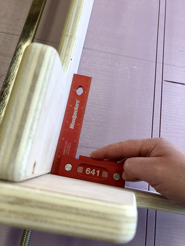

I don't use my Woodpecker's T-Square that often, but when it makes sense it sure is awesome. To lay out the dowels I indexed the bottom of each mating side with the "T", and then marked along the scales that run up both sides of the square. Since all edges had a round over at this point, it was quite useful in getting matching marks.
I think I got this little dowel jig at Rockler and while the quality is so-so it produces pretty decent results.
I dry fit it and surprisingly, it was square as can be!
I tried to think of an (easy) way to attach the floating mattress support without visible fasteners, but in the end made the compromise of pocket screws on one side.
The mattress support is not attached (just sitting on the floor) but here is a sneak peak of the final form:
