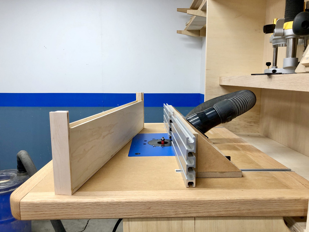

Back to the shop. When I purchased the kitchen toe kick material I got twice as many boards as I needed since I wasn't sure how well the kerf-bending would work and they took 3 weeks to ship. Didn't want to make a mistake and wait another 3 weeks for more. And they were cheap. But since it went well, I had two left over.

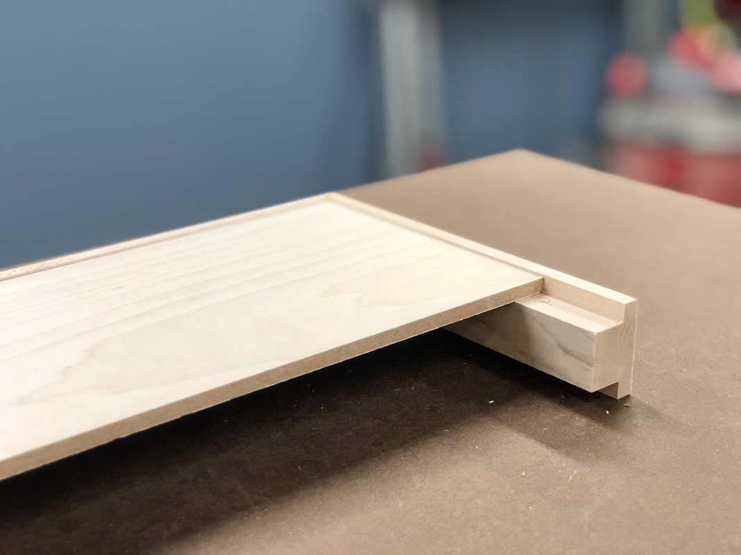

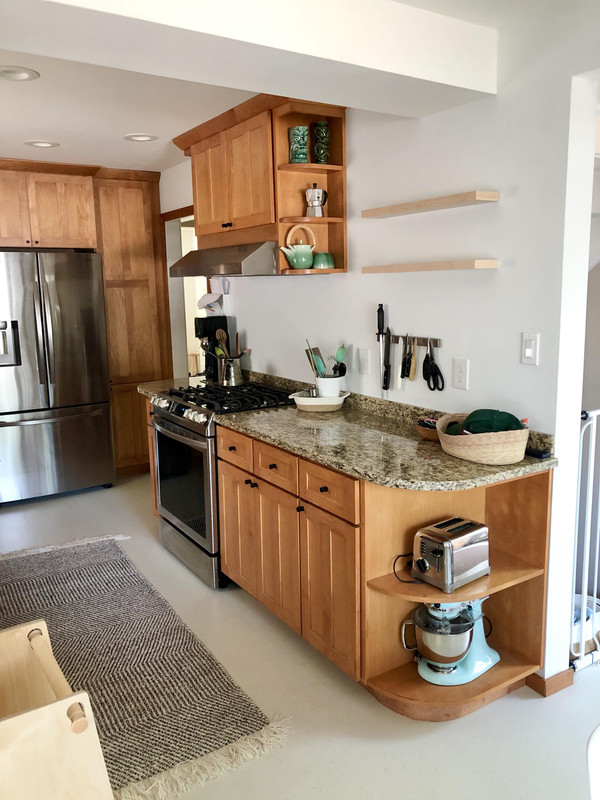

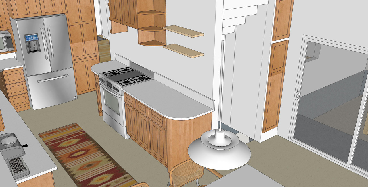

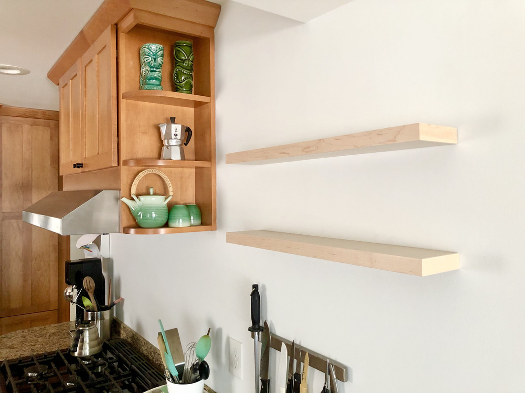

As part of the overall kitchen "remodel" I'd been meaning to make some floating shelves next to the stove some glassware. See Sketchup model Exhibit A:
Looking at the construction of the floating shelves I had purchased for the bathroom a few years ago, I remembered the top and bottom pieces were maple veneered MDF, just like the toe kicks I bought, and edged in hard maple. And they were quite expensive, about $90 each. I had just enough hard maple on hand in the garage to make the appropriate sized shelves for the kitchen, so I thought I would use that and the veneered toe kicks to see if I could make the shelves with material on hand in the same construction method.

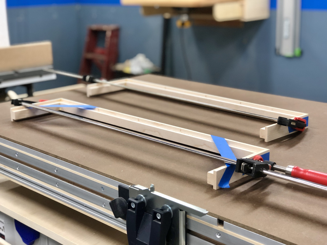

To start I ripped the front and sides to width and rabbeted out the top and bottom at the router table to make a "T" shaped profile:

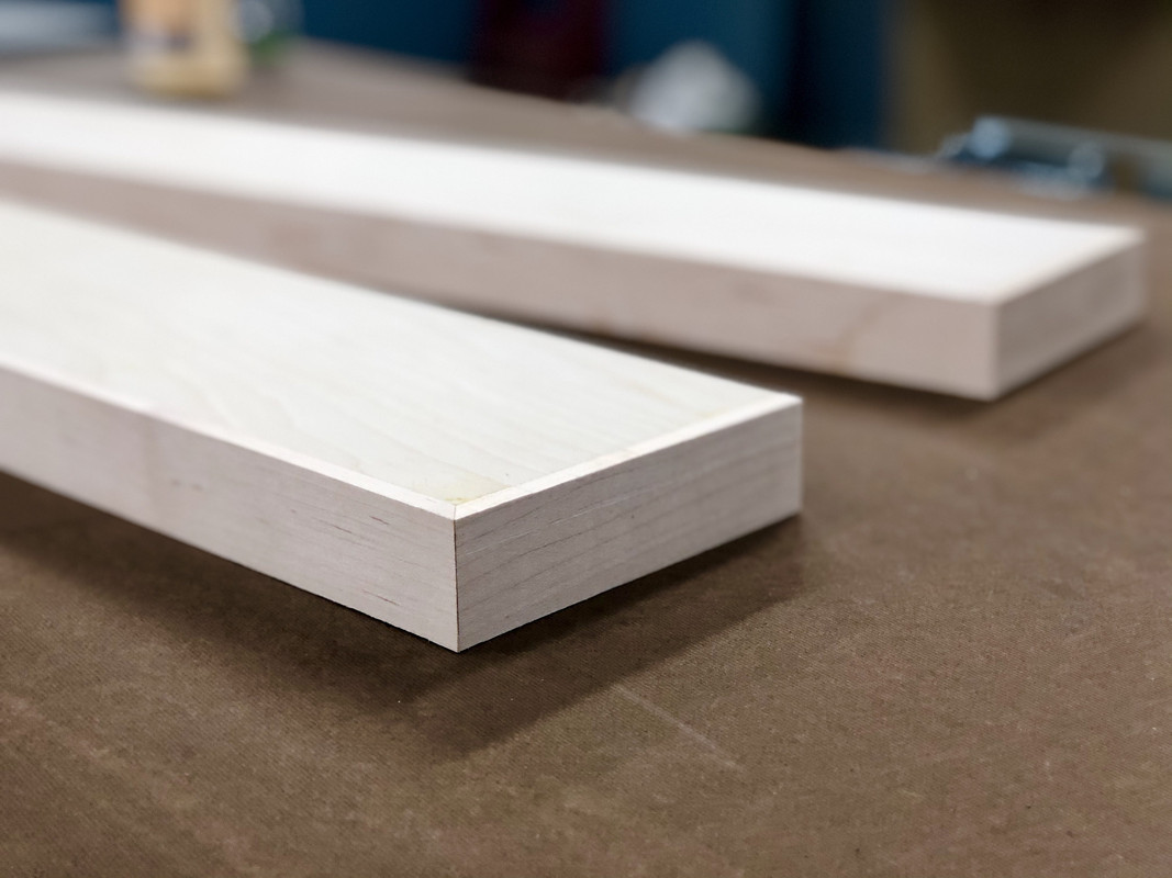

Then I carefully glued up the front to the sides, making sure everything was as flat and square as possible:
Then the veneered MDF is cut to size and glued in top and bottom:
I made the rabbets slightly deeper than the toe kick material so the shelf edging remains ~ 1/16" proud.

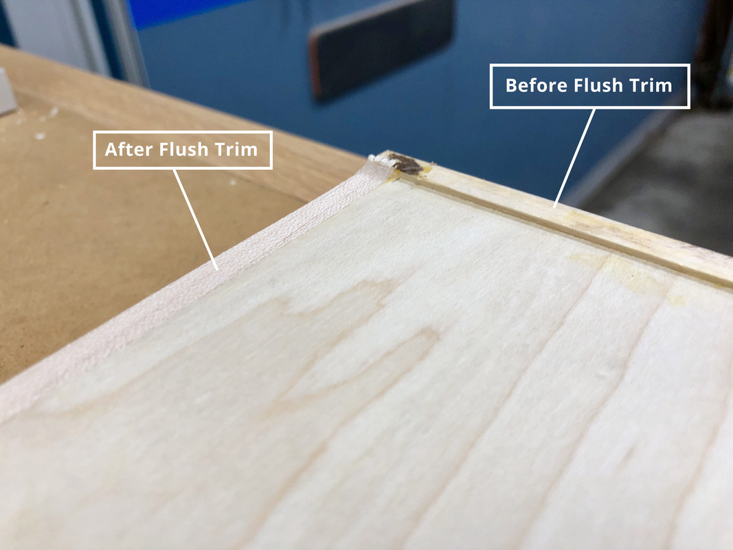

This is so they can be flush trimmed back at the router table:
This leaves a very flush joint and almost the illusion that it is a solid board, even though it is hollow.
Next I carefully sanded them:

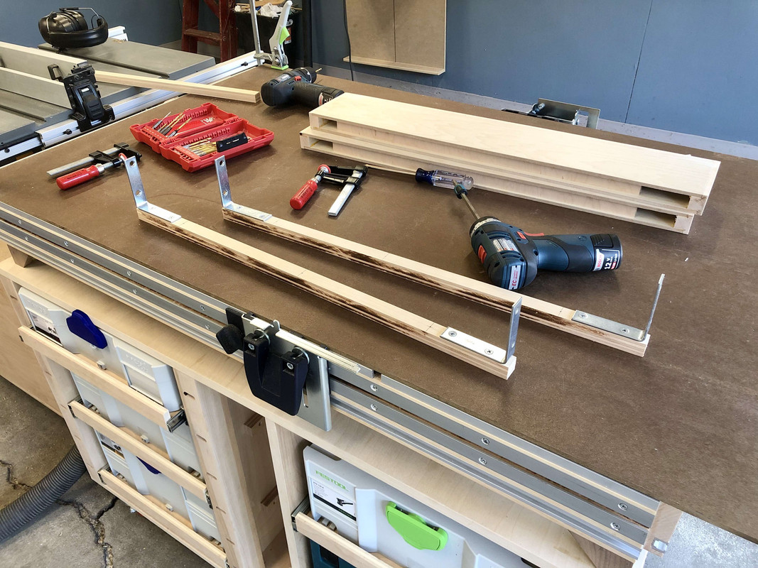

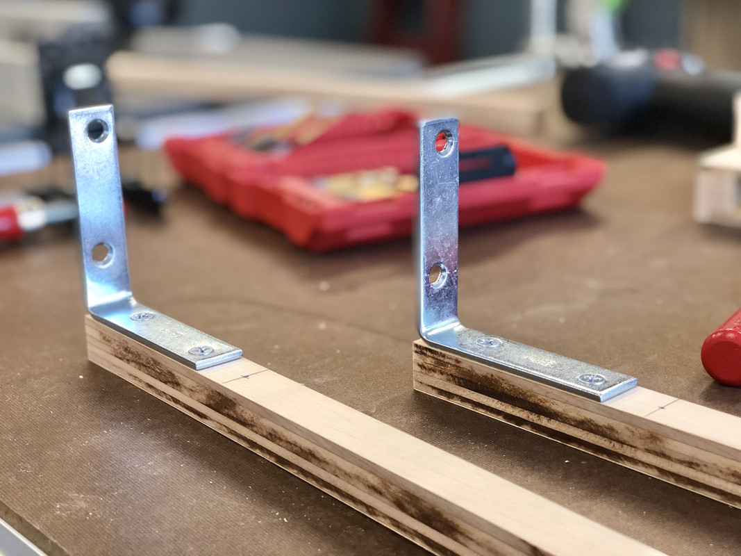

And made simple cleats of 3/4" plywood with some inexpensive L-brackets for support. These screw into the wall.
In the above pic you see the back of the shelves, I gently tapped in a friction fit piece of plywood for support of the veneered top and bottom towards the rear of the shelf, leaving a gap for the metal L-brackets to slide into.
I wanted them to be durable so I finished with 3 coats of General Finishes High Performance water-based polyurethane.
Here they are installed:
I am quite happy with how they turned out -- all the joints are very tight including the miters.

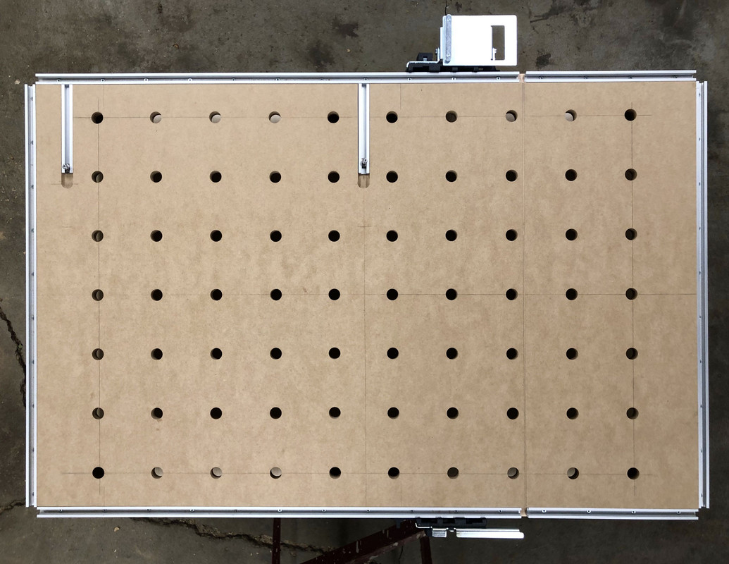

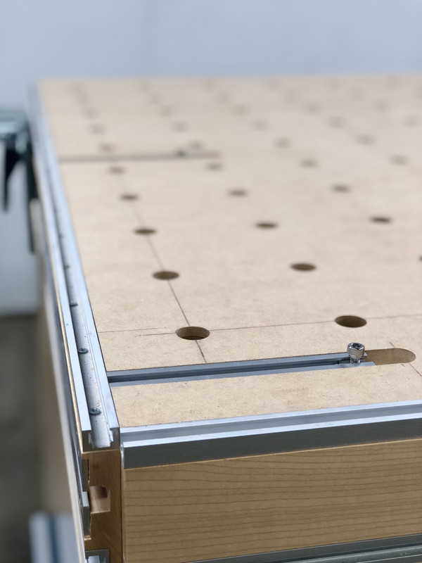

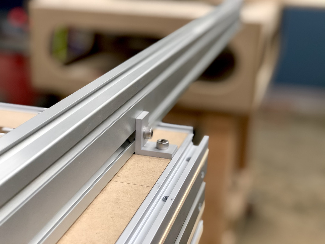

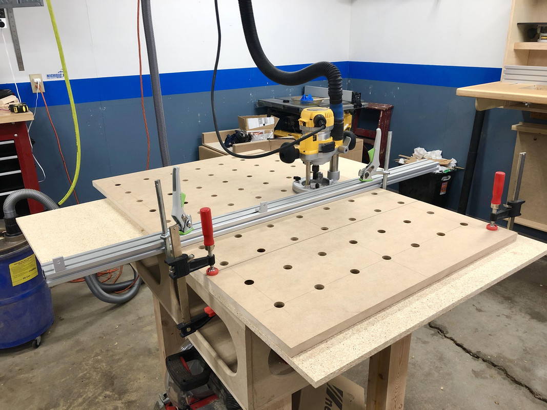

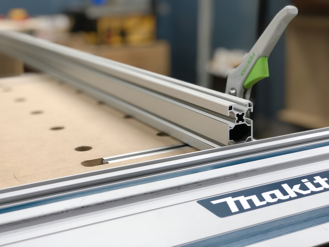

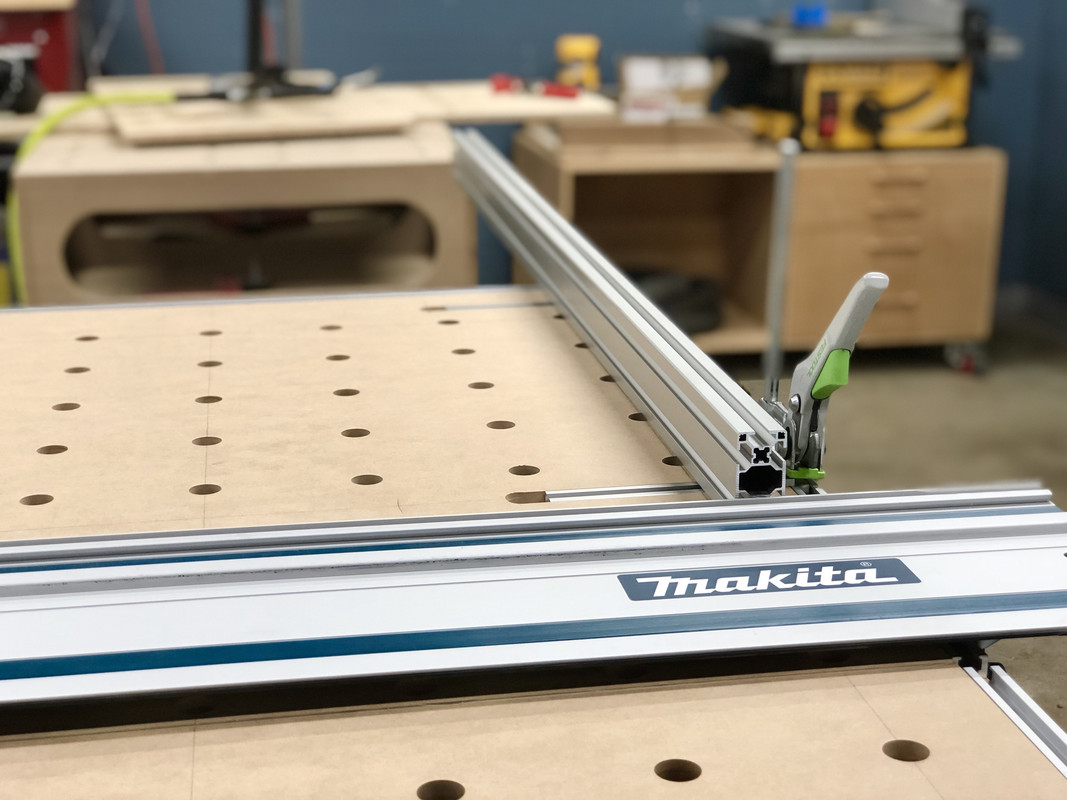

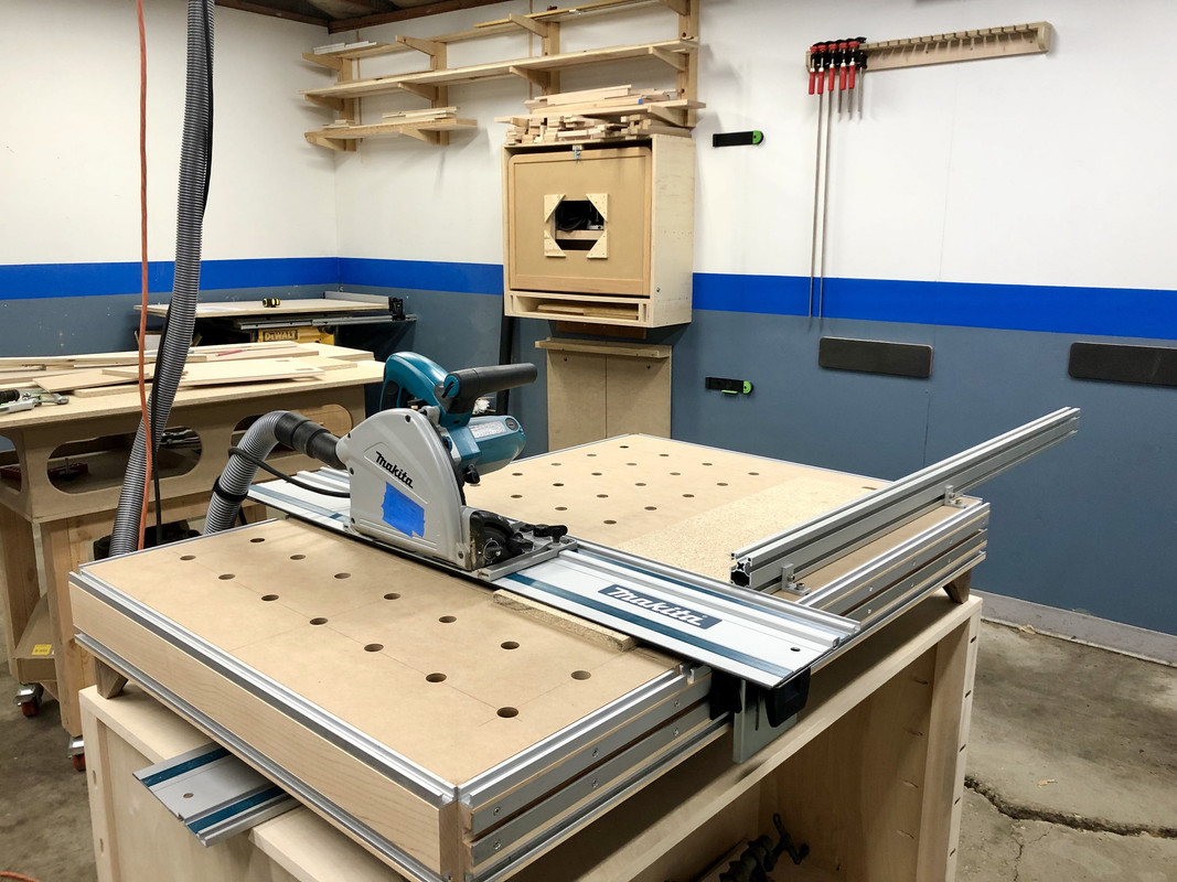

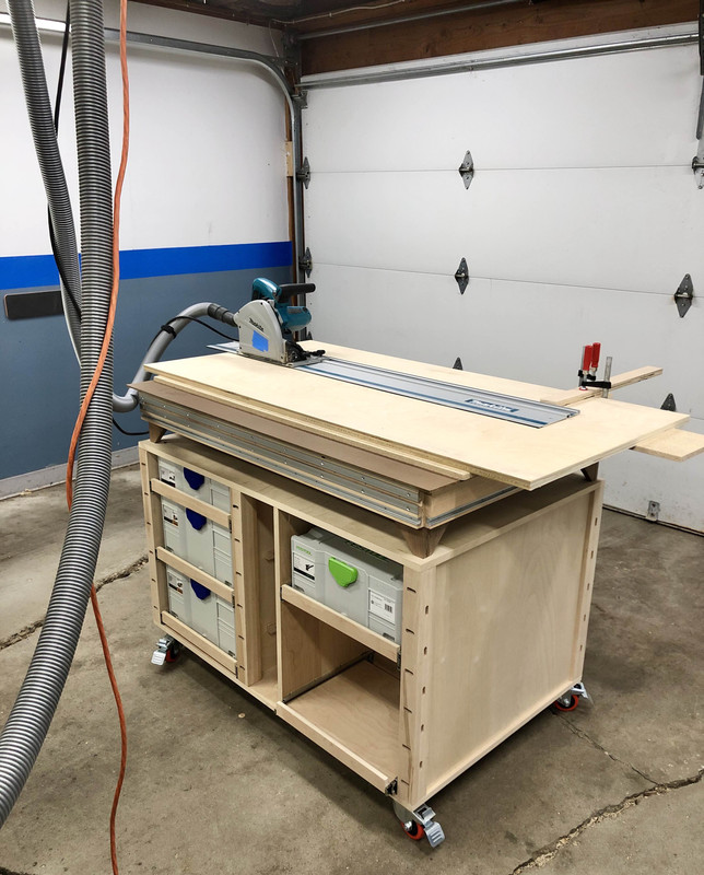

I've been staying busy and have a few things to post but I'm going to break it up into a few posts. So firstly, I recently accomplished some finished touches on the track saw station.

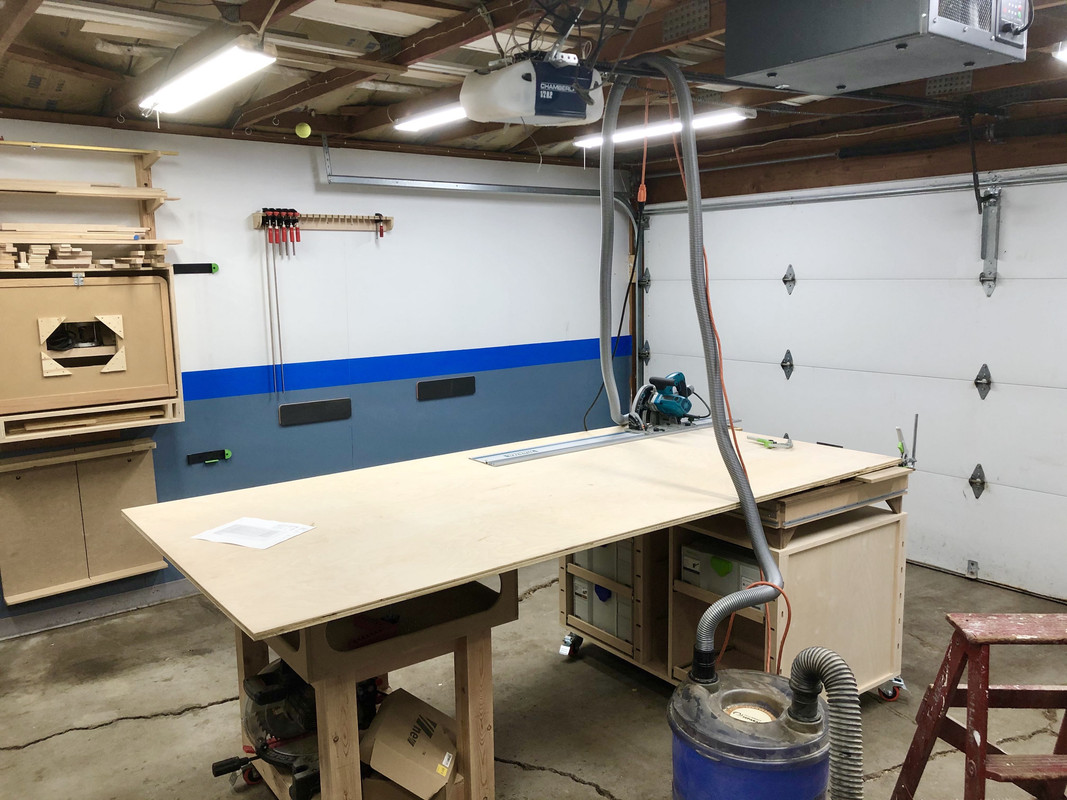

Are you sick of hearing about the track saw station yet? :lol::lol::lol:

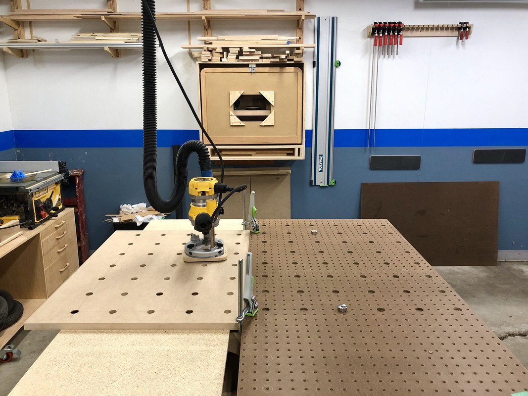

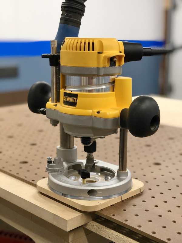

I took the MDF top off to machine the 20mm hole grid. I did this on my old bench. Old bench helping build the new bench. Nice.
Using the same Etsy Woodrave pegboard jig. It doesn't result in a perfectly orthogonal grid, but I don't rely on the grid for angles or square. I just use for clamping, so close enough is good enough for me. I've found in my climate, with the severe humidity and temperature changes, that the MDF expands and contracts and is not reliable enough. Plus the pegboard I used as an indexing template is less than perfect.
After doing the first half I slide the pegboard down and index with some Parf dogs and do the second half.

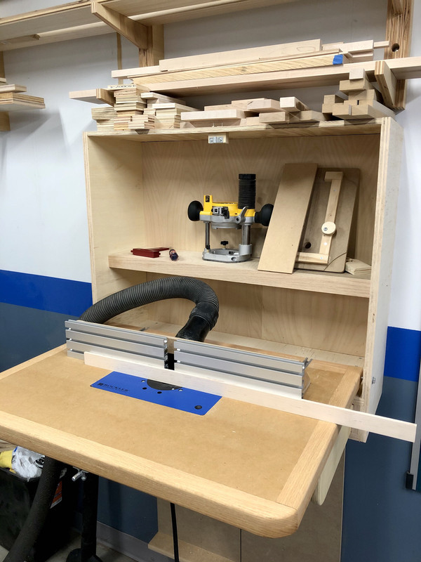

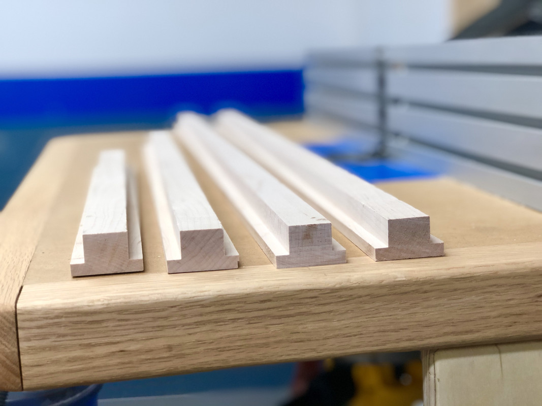

Also, my Misumi Engineering fence extrusion came in, and I needed to route some small T-Track grooves in the worktop for it. I used the extrusion itself as a straight edge guide:
These small sections of Misumi T-Track will allow the fence to be secured with some L-brackets and allow for adjustability in terms of squaring the fence to the guide rail.
All finished -- 70 dog holes total:

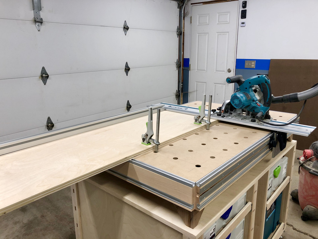

And here are some photos of the fence attached:
I have to say the Misumi parts are awesome quality and reasonably priced.
I squared it to the guide rail and did some test cuts on particle board and the results were stellar. About as square a piece as I've had, absolutely no gaps with the Woodpeckers square when held against the shop lights.

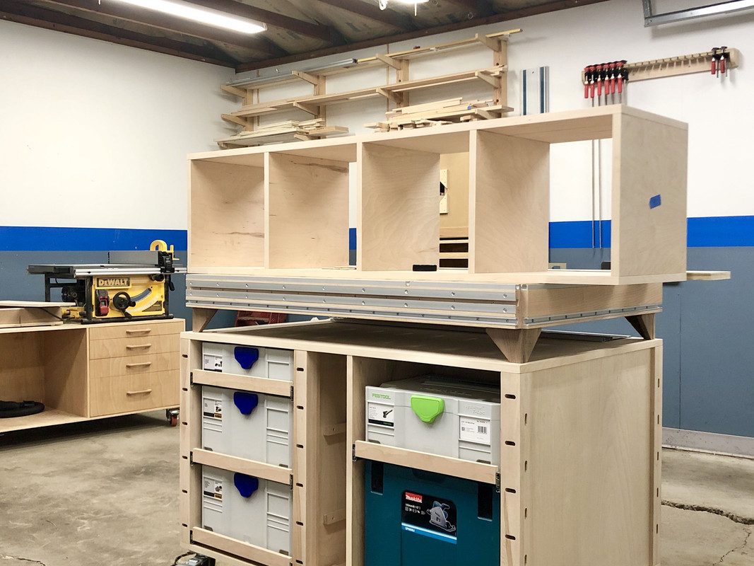

I've started a new project! We've been working on turning one of the main floor bedrooms into a "playroom" for my daughter and all her ****, er, I mean toys and books and stuff. My wife wanted to get the standard IKEA bookcase units (KALLAX). I said I wanted to step it up and make some plywood ones. She said well you better get to it, then!

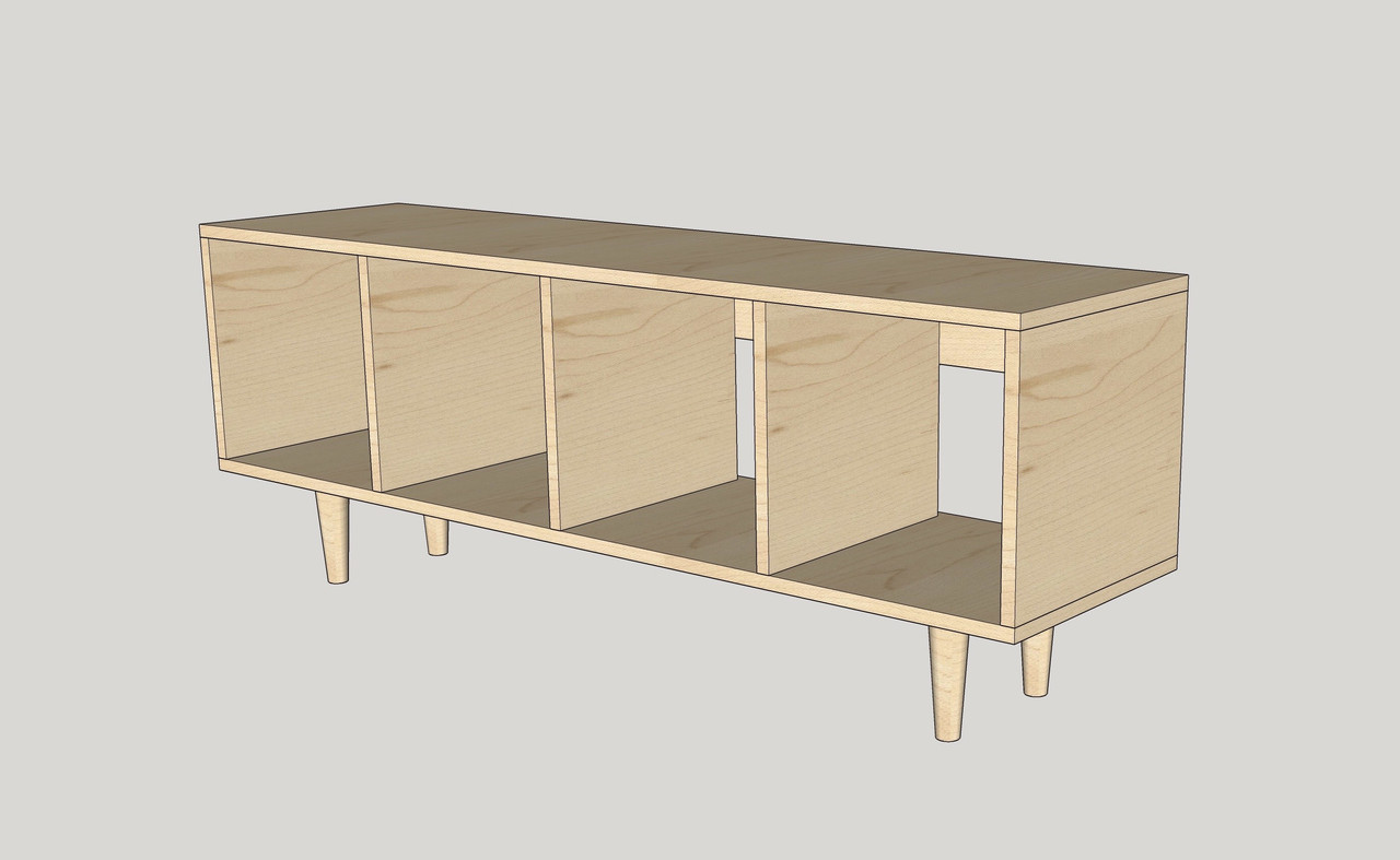

So within milliseconds I whipped up a design in Sketchup:
Going for kind of a Montessori / Danish modern approach. It's actually more or less a copy of these from Sprout Kids, which cost a small fortune and an arm and a leg.

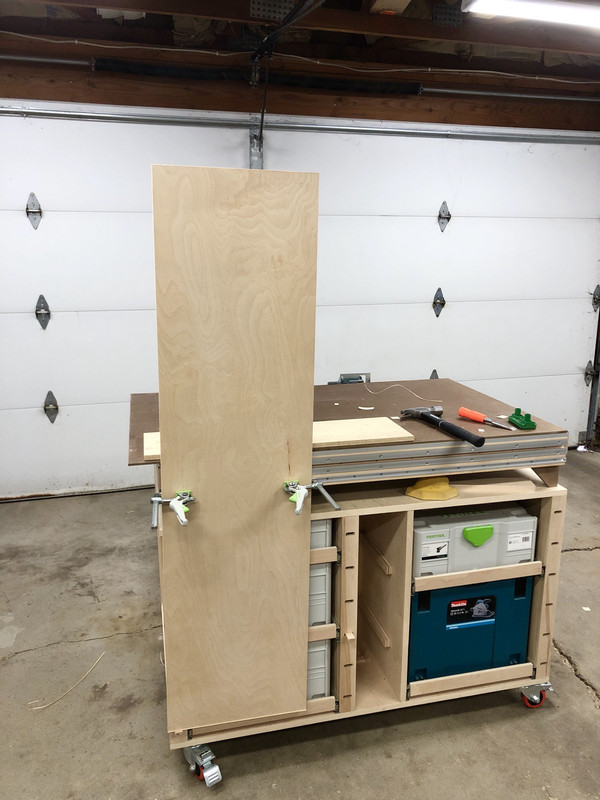

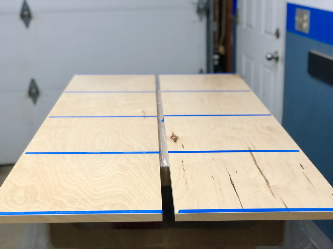

So I went through the painful process of procuring a 4'x8' sheet of plywood from Home Depot in the age of Covid. Had to rent one of their trucks as our cars can't transport. It was not fun.
Got 'er unloaded across both benches:
In the future I'd like to make some support extensions that attach to the new bench, but for now this will do.

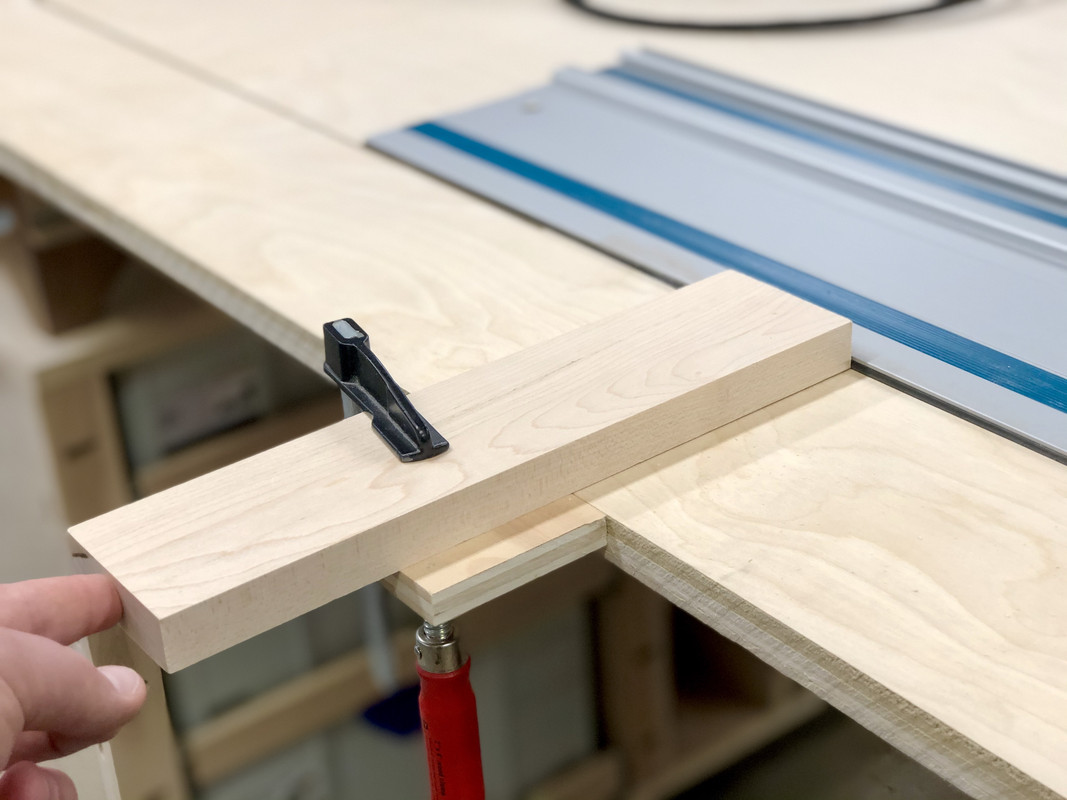

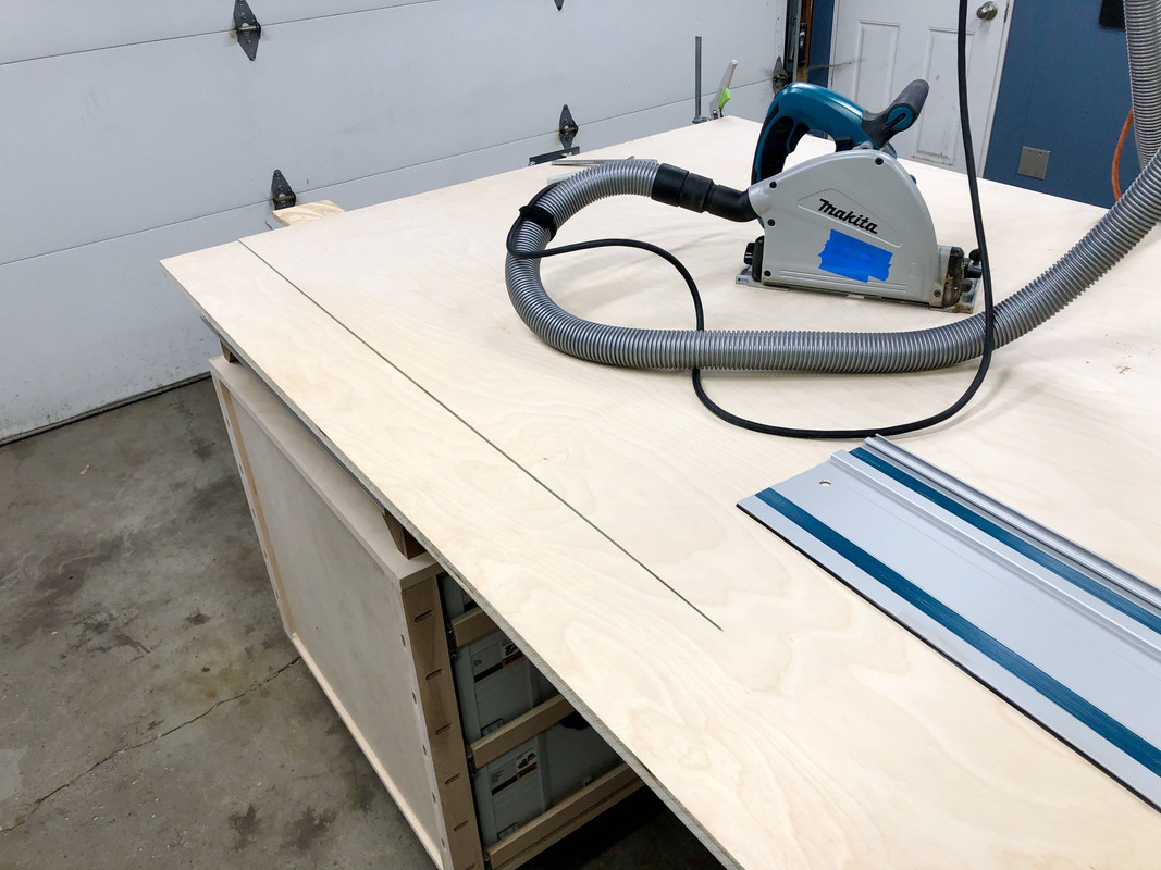

First task was to make some big rips. And I don't mean farts. To fit 4 "cubbies", I needed the bench to be 56 3/4" long, and my longest tracksaw track is 55". And to maximize cut efficiency I really needed to rip the whole 96" length a few times.
To solve this I made a stupidly simple plywood spacer jig by measuring the offset on a piece of plywood, and clamping another stop block of plywood at that measurement. Then I used that jig to register the track at both ends.
This allowed me to make half a pass, move the track down, and cut the other half, all the while keeping it very straight.

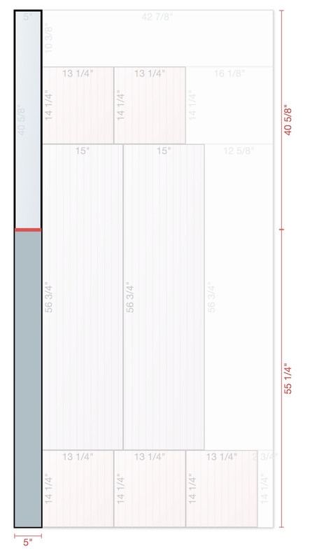

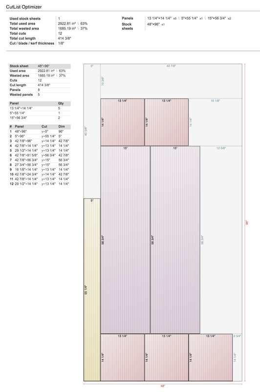

Another fun thing I tried was Cutlist Optimizer. It's a free web program where you can enter your final dimensions of pieces needed and it will figure out the best way to cut it out of a bigger sheet. You can have it prioritize least amount of material waste, least amount of cuts needed, and consider grain direction.
It even shows you visually where to cut as you hover over each cutlist item:
This really helped me keep track of things.
As the pieces got smaller I could move to the main bench only:
And finally to doing the crosscuts and squaring up the ends with the tracksaw station fence:

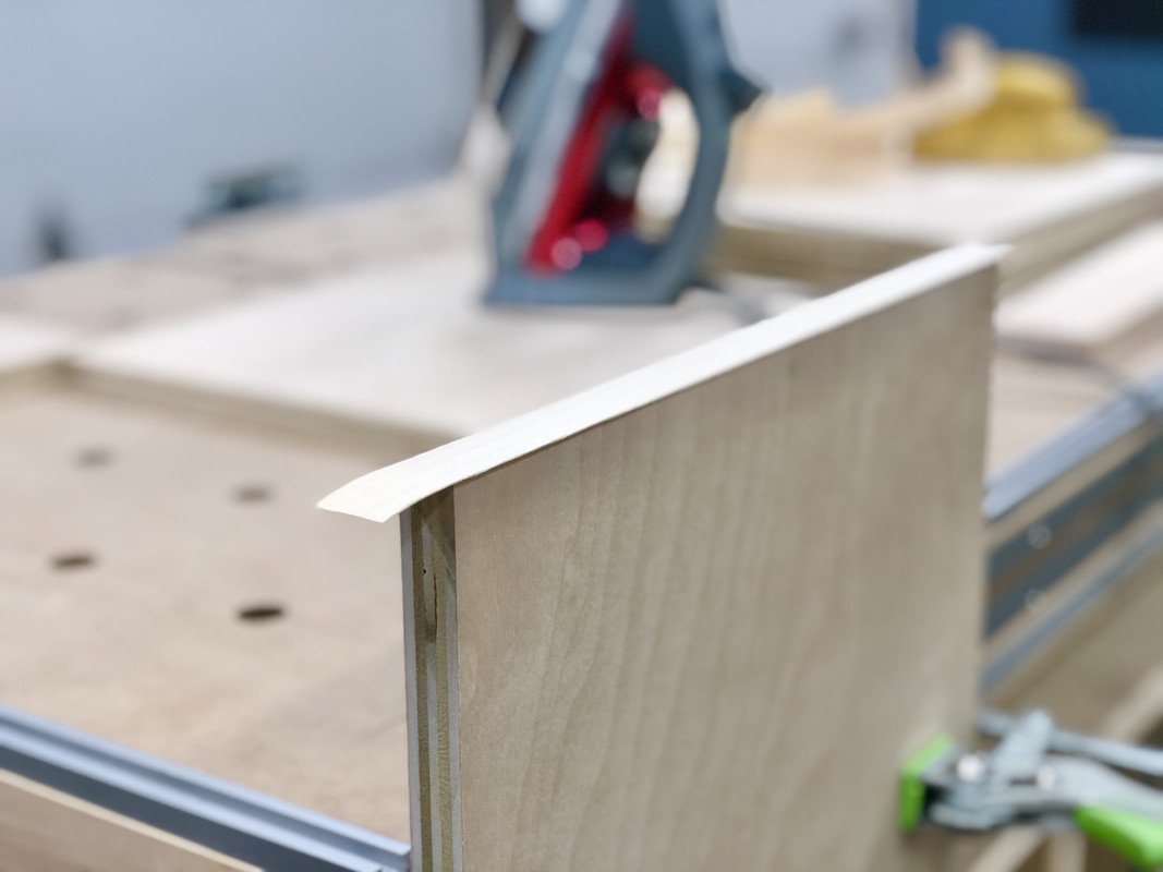

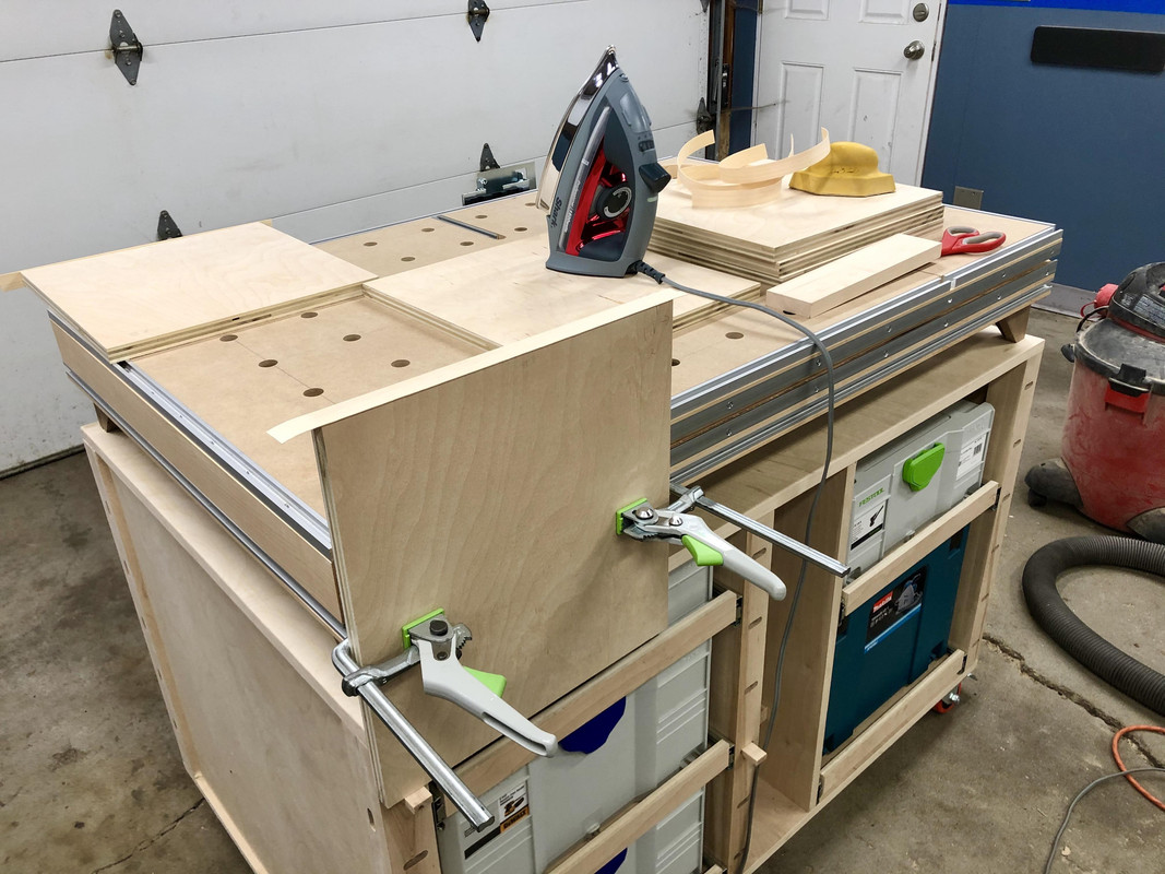

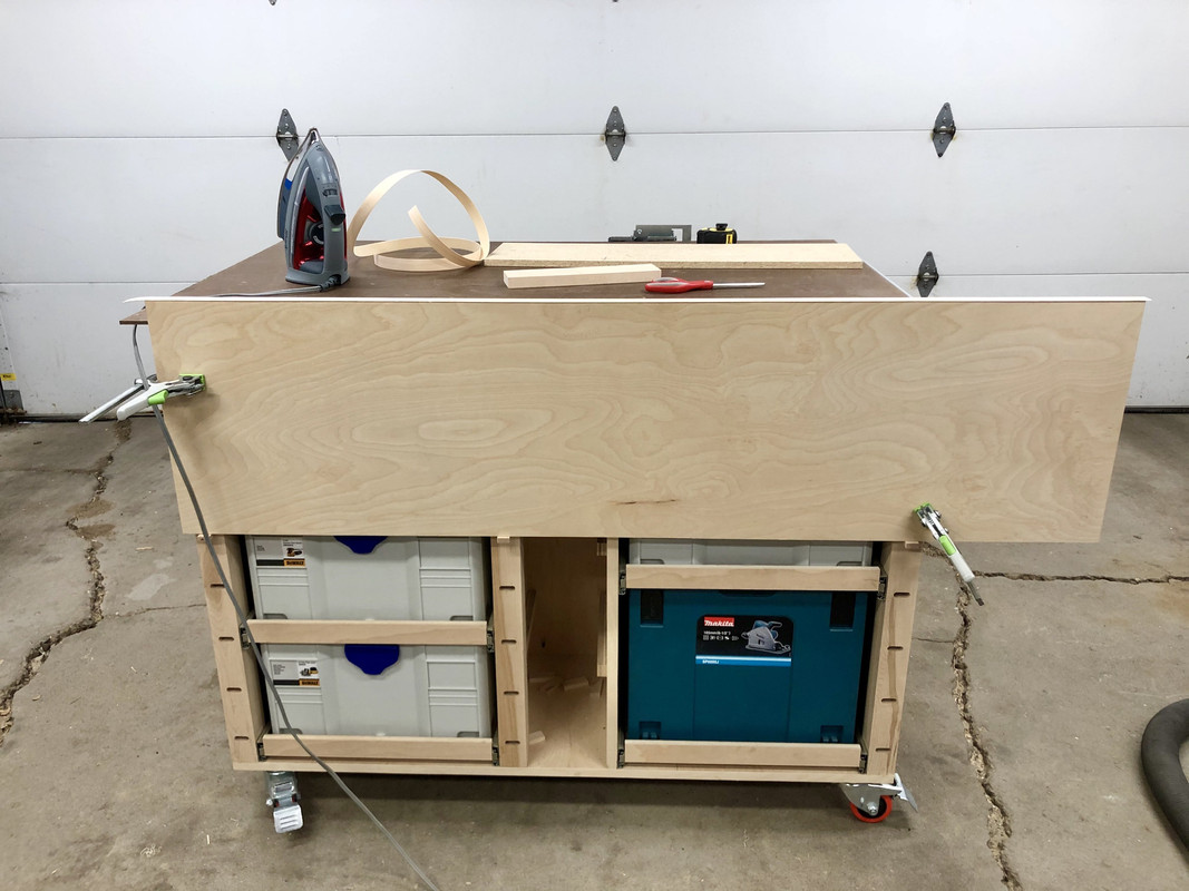

With all the pieces dimensioned I moved into edge banding mode:
I was very pleased with how this worked out both for applying the edge banding and trimming it. I was able to clamp every piece.

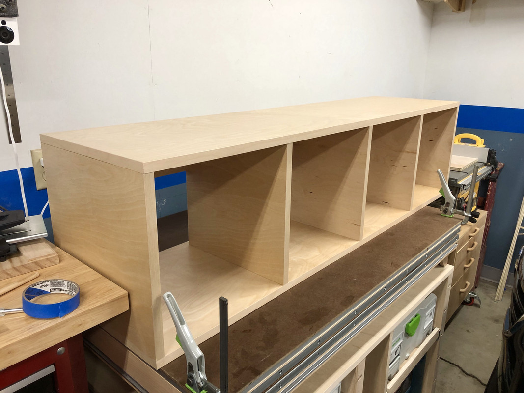

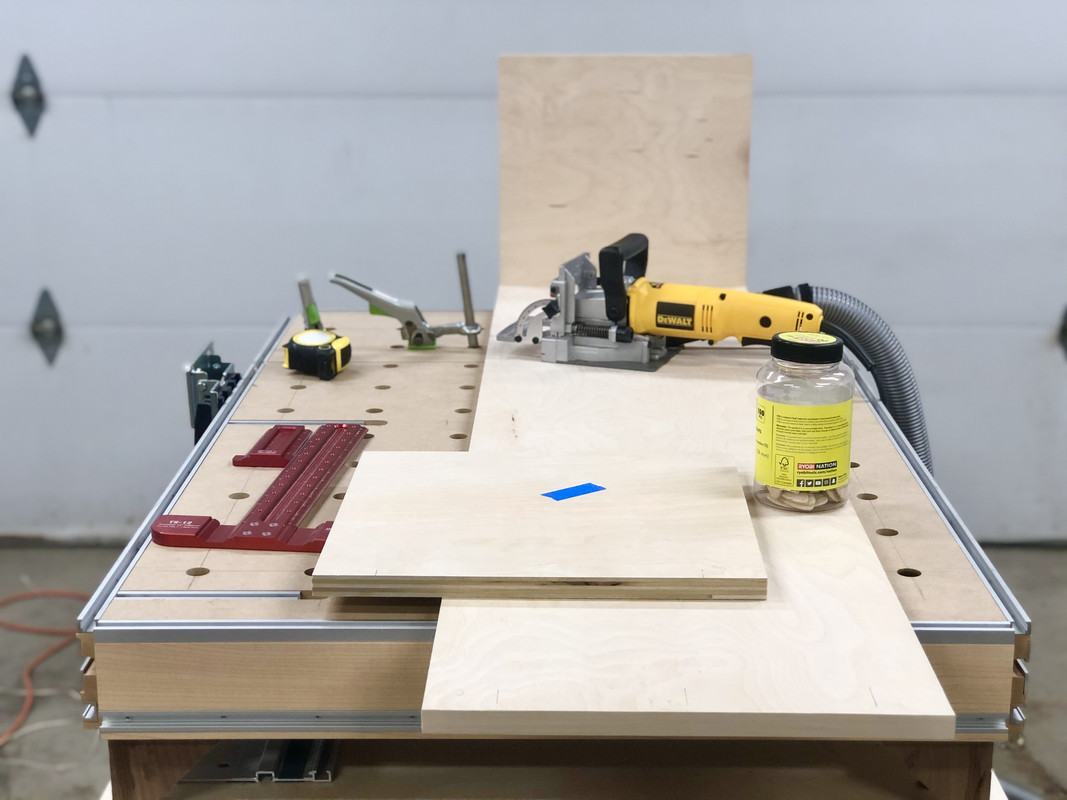

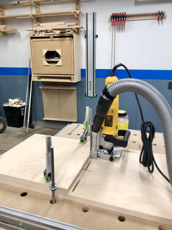

With all the pieces edge banded I moved into joinery mode, with the biscuit joiner.
Cutting the biscuits is so quick and painless, but the layout is a bit of a chore. It's easy to get confused (for me, anyways) on how to orient the biscuit joiner.
For this project I plan to only use biscuits and glue. Well actually there is a back stretcher that might get some pocket holes on the back side, but the main carcass will be biscuits and glue. No one will be sitting on it... I think it will be plenty strong but we shall see.
I left off with a dry fit and everything aligned nicely:

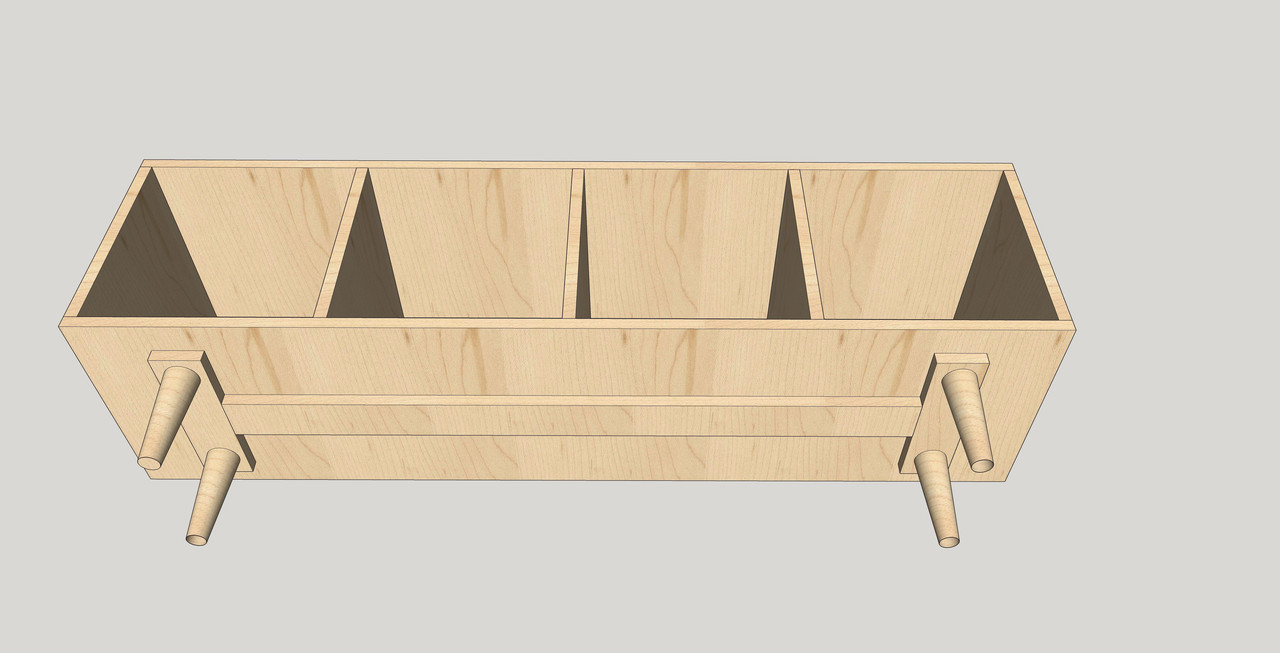

I plan to get some spindle legs on Amazon, and in my Sketchup I played with this stretcher/support element but I'm not sure if it's even needed.
Anyone have opinions on that? Seems to me like it would be pretty sturdy without, but I don't want it to sag.

Looks great so far! I doubt you will need the stretcher underneath especially with the back stretcher but if you have the scraps available to do it why not otherwise it will just be left sitting around in the way anyway lol!

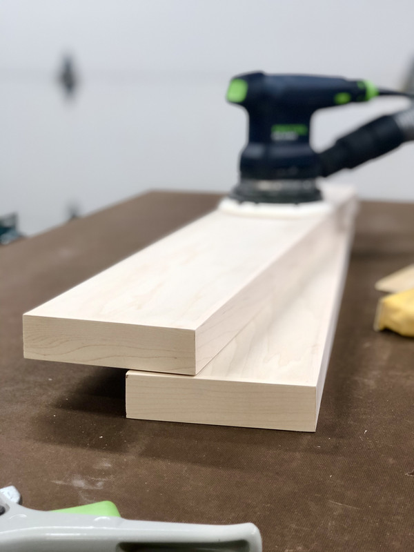

Next up was lots of sanding:
I've found this Festool ETS 125 really works the smoothest when the workpiece is solidly clamped.

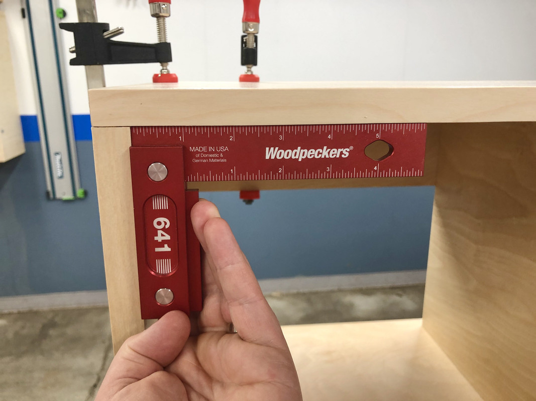

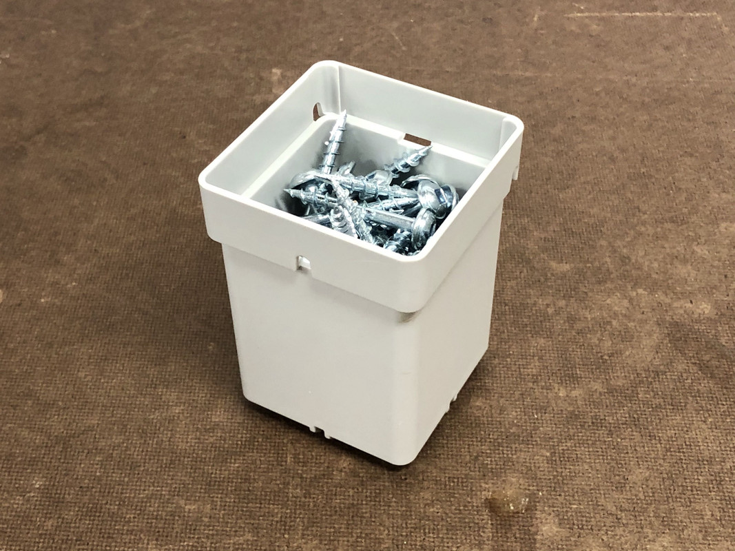

I did not take pics of the glue up because it was stressful AF. I will say pocket-screwing the stretcher in the back as the glue up went down was extremely helpful in squaring things up. It came out pretty decent!
It's a little gappy in areas because I had nowhere near enough clamps, but nothing someone would notice.

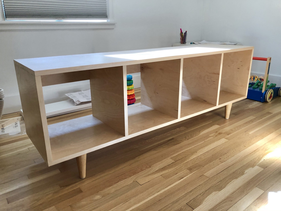

Here it sits glued up, waiting for the legs to arrive from Etsy:

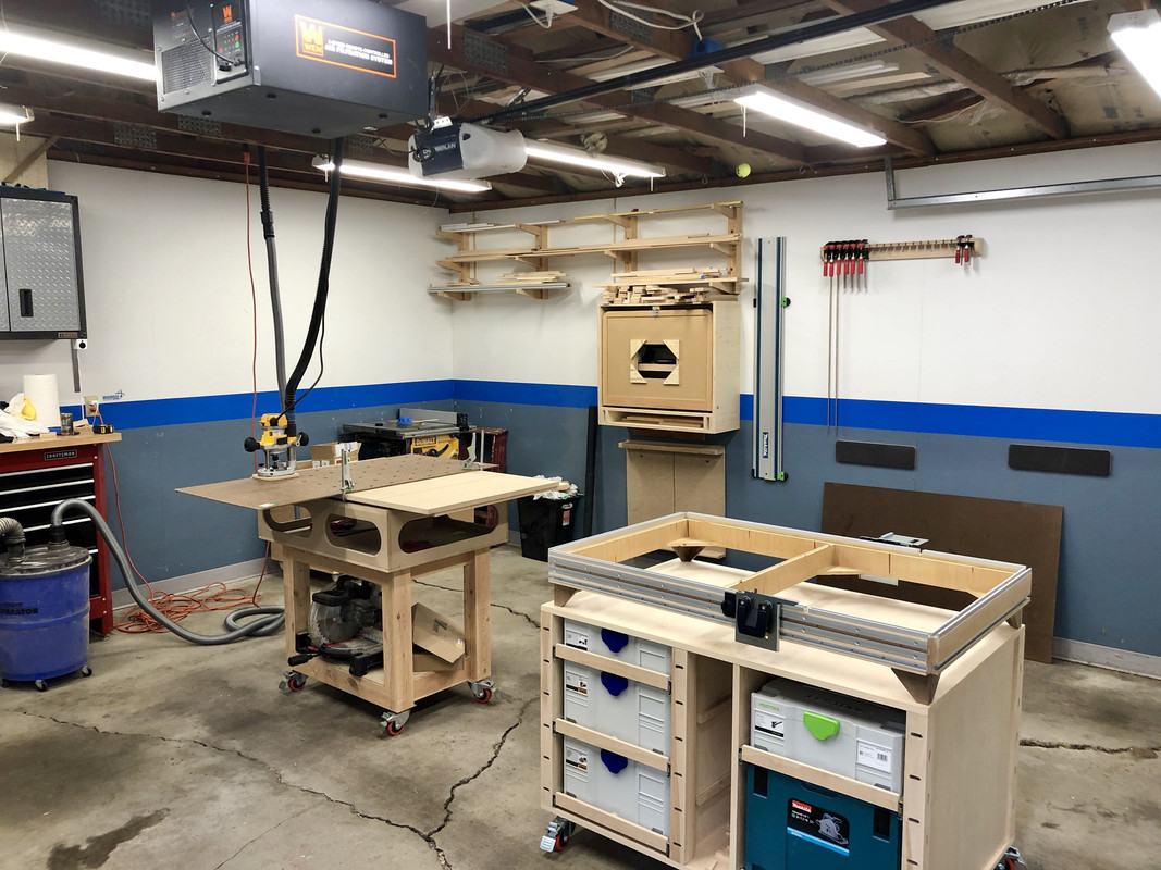

And because I thought it looked cool, here's an overall pic of the garage with the cars put away and all cleaned up for the evening:

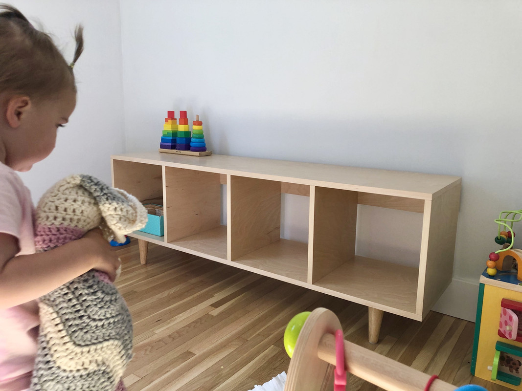

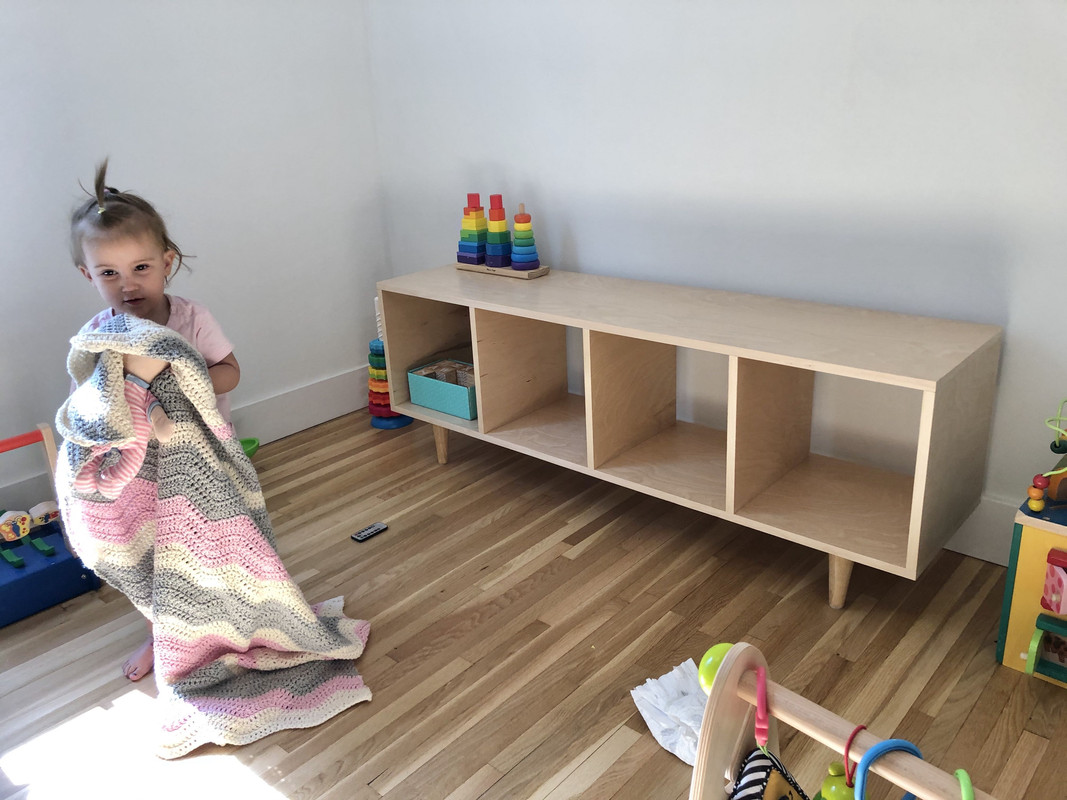

Playroom toy cubby - part 3

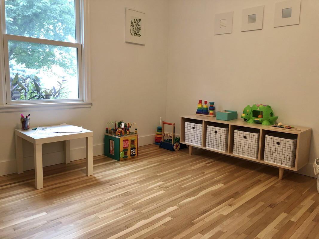

The grand reveal. I got the legs and attached them with pound in t-nuts and super glue.
My daughter approves. I had showed it to her in the garage so she knew it was coming. She's getting used to that "dada" makes things for the house, and seems to be quite proud, which is a great feeling.
The height lets her access anything on top of it, too.

Thank you! Yes, it's crazy, she is 21 months now. As I'm sure you know it's such a fun age. I was thinking the same thing, if the unit is still standing I could repurpose it somewhere else in the house someday. And I know what you mean about quality. Even expensive store-bought furniture can be somewhat flimsy especially if it isn't solid wood. I've had good experiences with the IKEA Kallax units, which I think are reasonably priced, but I wanted to make something for her and practice my sheet goods skills.
It was intended for storage bins, yes. The "cubbies" are 13 1/4" square, and accommodate a 13" storage cube system. I had some picked out at Target but my wife unknowingly picked up some smaller 11" ones. But we're keeping them because 90% of the time my daughter likes to pull them all out on the floor anyways, so a perfect fit is a bit of a silly quest. :lol:
It looks clean because I picked it up to take the pic, but I can assure you it normally looks like a bomb went off. A nuclear toy bomb. :lol:

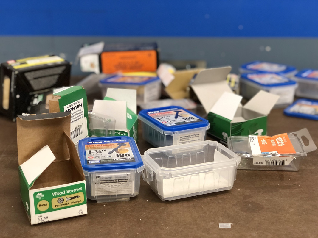

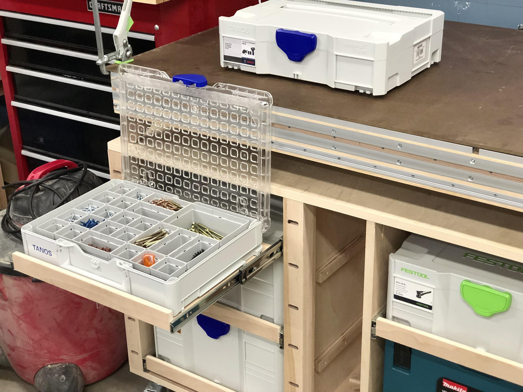

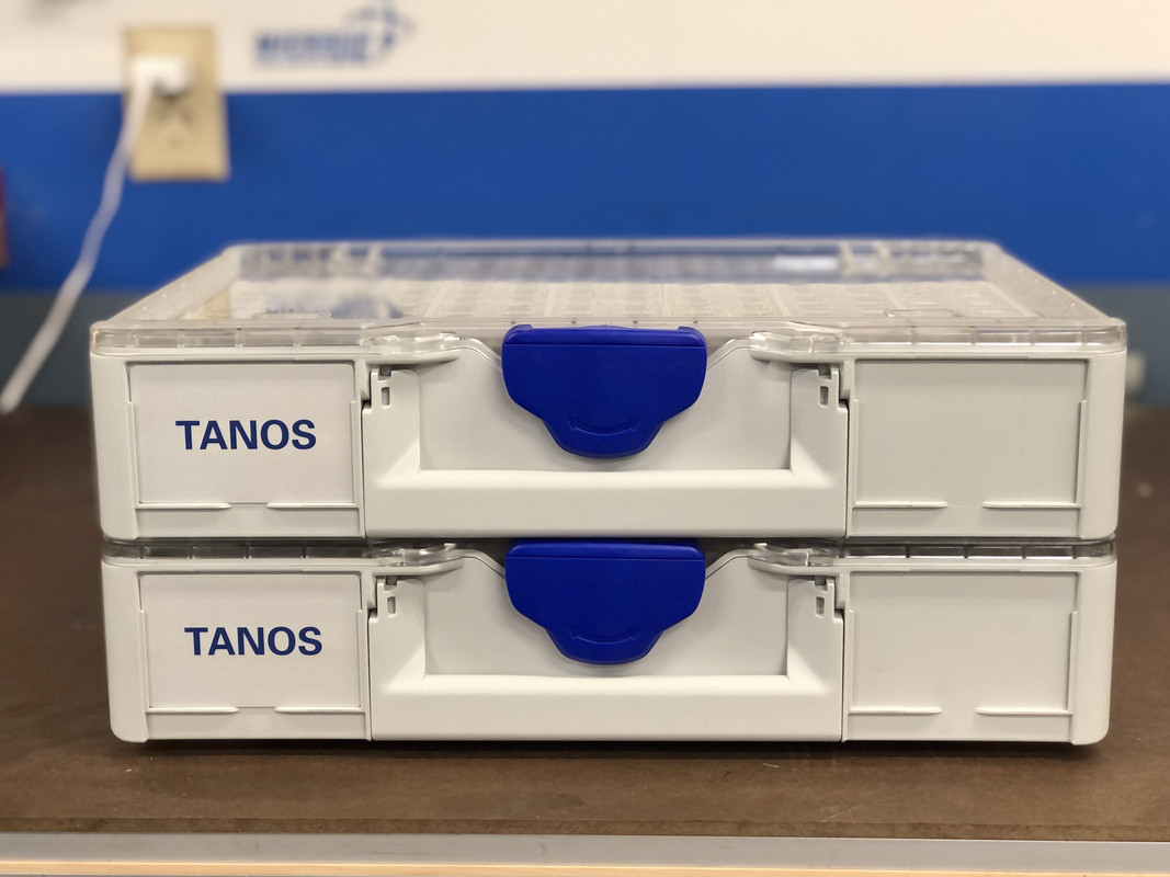

So... this is one of three places I usually keep my fasteners:
It's a mess. I've been meaning to either get some small parts boxes, or make a plywood grid within the drawer. I couldn't find any parts box arrays that would fit this Craftsman unit. And with the plywood grid, I wouldn't be able to take a box of screws over to my assembly area.

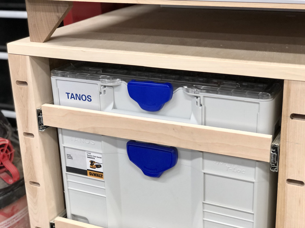

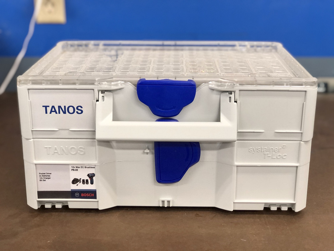

By now you probably know I'm a fan of the Tanos Systainers. The place I've ordered from before sent me an email saying the new Systainer3 was available, including the new "Organizer" boxes. These are very similar in function to the Bosch/Sortimo L-BOXX parts boxes. To my surprise they were cheaper than the old Sys1 parts box. I think you can guess what happened.
Used a 15% off code, got free shipping, and ordered two. :)
They are shorter than a Sys1 and have a clear lid, front handle, and smaller T-Loc latch. I started emptying boxes and packing them out right away.
Can get rid of all these now:

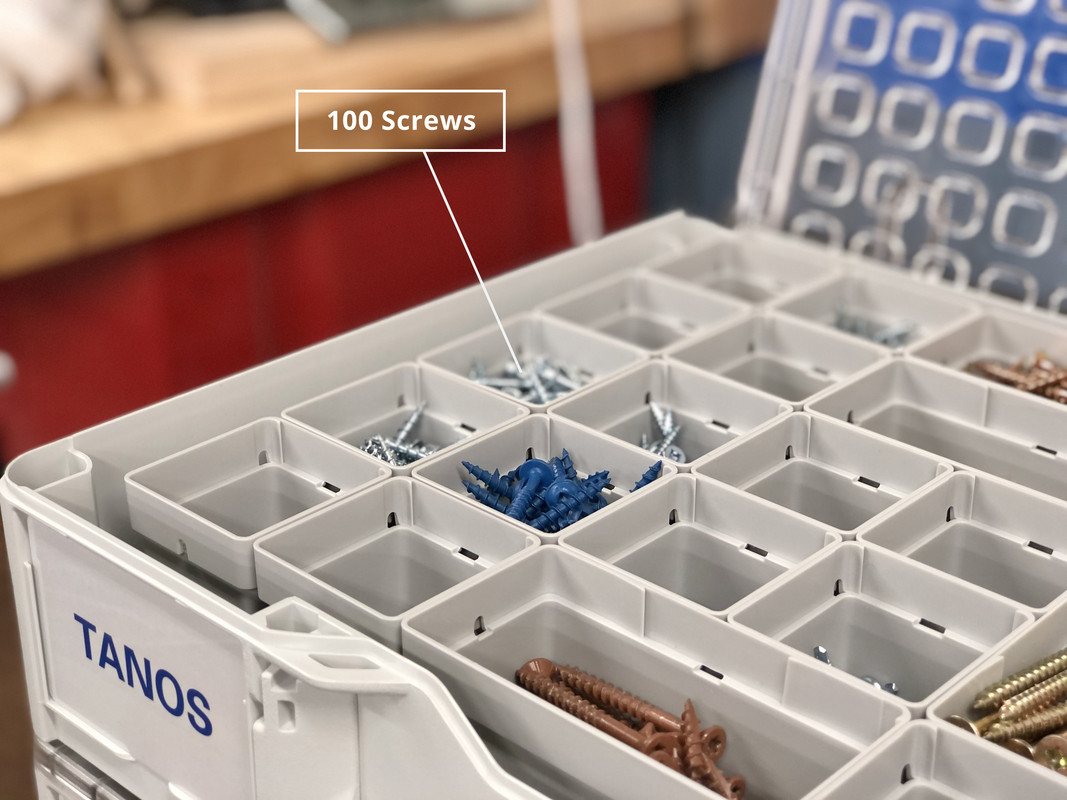

The interior boxes have a pattern on the bottom that indexes with the pattern in the bottom of the unit, and the lid has a pattern which locks them in place as well.
Again, this is similar to Sortimo, and lets you carry the box in any orientation without any of the mini-boxes mixing contents or moving around. Pretty neat.
Suprisingly, they hold a LOT of stuff! I got every fastener I had on hand almost entirely into one box!
At first they look small, but the interior boxes are fairly deep. The smallest size can hold at least 100x 3/4" #6 wood screws. Not bad. There are literally hundreds of fasteners in this one box.
I like the separate boxes inside so I can just take the one thing I need to the workbench or in the house or whatever.
Fully compatible with the T-Locs so I can throw a fastener box onto my 12v drill Systainer and take it to the house.
Also fits in my workbench... almost makes me which I had some space for these in here.
After the discount they were about $66 each. So not cheap by any means, but I think they are a well thought out product, and honestly a better value than the standard Systainers. I've seen some people who have a whole hardware store's worth of small parts at home (which is cool :D), but I think I could manage with just the two of these units. Maybe three down the road.

Cool, glad you like it and thanks for following along! They are available elsewhere (Europe) but I did not know they were out in the U.S. either until a few weeks ago. Maybe they aren’t even, but I got them from the Systainer Store:
https://systainer.store/?gclid=EAIaIQobChMIz8fq4rHO6gIVj4bACh2eAAplEAAYASAAEgKMYvD_BwE
It’s run by a guy “Sys Tim” based in Michigan who has a good relationship with Tanos and orders from Germany. And there’s a 15% off code for new customers which helps take some sting out of the price.
Also if you like the current gen T-Locs, woodcraft has some good pricing on Amazon right now [emoji16].

I guess it did sort of turn into a review, didn't it? I was probably just trying to justify to myself why I bought some expensive plastic boxes :lol:
How do you like digging/getting some of the smaller fasteners out of the smaller containers? What I like about the larger boxes they come in is it is easy to get a few fingers in there to dig out 3-10 fasteners at a time. I have big hands, so I am always concerned about small boxes (that is how I met my wife!).
Oh my. :eyecrazy:
Haven't had much opportunity to use it yet but yes, I can see this being slightly annoying. The small boxes are pretty small. I'd likely just pour a few screws out on the workbench. The boxes themselves remove easily.
Also, you can get a few different box configurations. The ones I got have a mix of sizes, but you could get one without any of the smallest size box, for example.

Ha! You might be right!
I almost missed the boat on the drawer depth. The lids barely clear.
The Systainer stacking is a little silly within the garage, but bringing stuff to the house it's really nice. Because my garage is detached, I've often found myself trying to carry way too many individual tools and fumble through the screen door, often dropping things. My ultimate goal is to have a few neatly organized boxes I can easily bring inside for different things. Another benefit is when I'm doing housework I can pack 'em up nice and neat at the end of the day where my kid can't get them and my wife doesn't view it as a prolonged mess of tools spread all over the counter or floor. Nice and tidy.

Eh, you're not too far off :lol:
I think one downside with the empty Systainers is they come with no internal organization. To really make use of the larger ones you need some custom plywood inserts, dividers, kaizen foam, etc to stay organized. Otherwise it is like throwing a bunch of stuff in a bucket. If you buy a tool (like a Festool, but some others as well) that comes with them, they are usually kitted out with a plastic molded insert that holds the tool and accessories nicely. Without that it does take some extra effort and thought.
And you're certainly not wrong about the expensive part. On every Systainer I've purchased I've waited for the lowest price, or sale, or coupon code, free shipping etc. Anything to bring the price down a bit. If you can find one on sale or good second hand condition, I think they are *slightly* more reasonable. Not sure how big your hunting gear is but they also have a range of smaller sizes that are cheaper.
