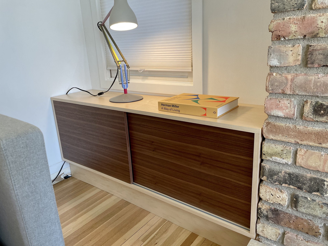

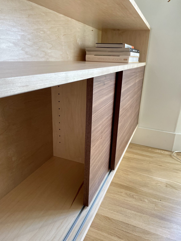

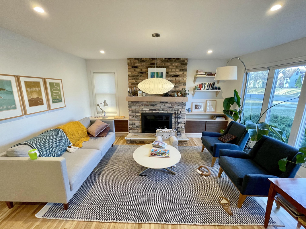

Living Room Built Ins - part 15 - All Done!
Well, not 100% (is a project really ever done??), but I'm calling it for photo / journal purposes.

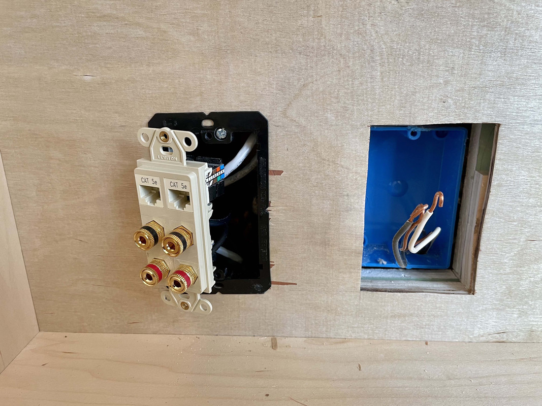

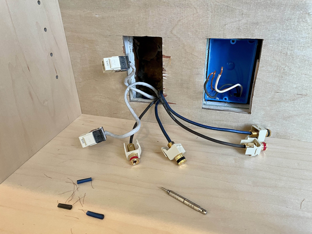

I finished some wiring stuff.
The Cat5e and speaker terminals are for a mini-amp and Sonos Connect that go to the living room in-wall speakers. Now they will be out of sight and my daughter won't be able to press all the receiver buttons!

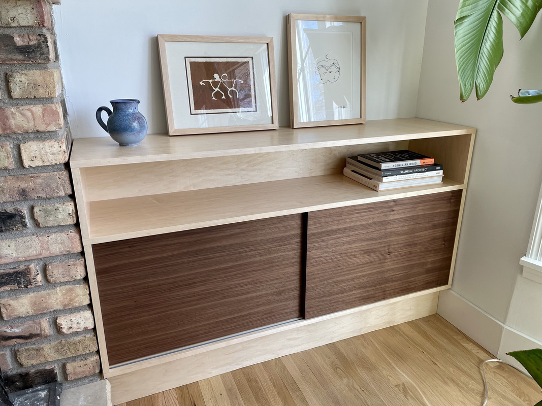

Here's some final installed pics:

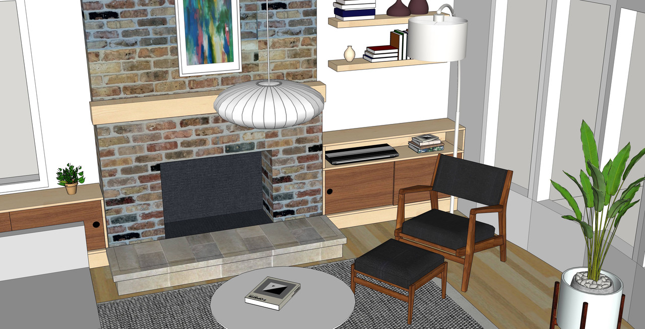

Not a surprise, but they bear striking resemblance to the original Sketchups:
Some random thoughts and things I learned on this project:
  • built ins are hard
  • installation challenges (leveling, scribing, fitting parts) took a LOT of time
  • I hugely underestimated the amount of time these would take overall
  • I LOVE the walnut
  • the door tracks and UHMW tabs work very well, and I'm super happy with how that came out
Thanks to everyone who gave advice and suggestions along the way, as well as just commenting and checking in. It really does help keep me motivated!
:beer:

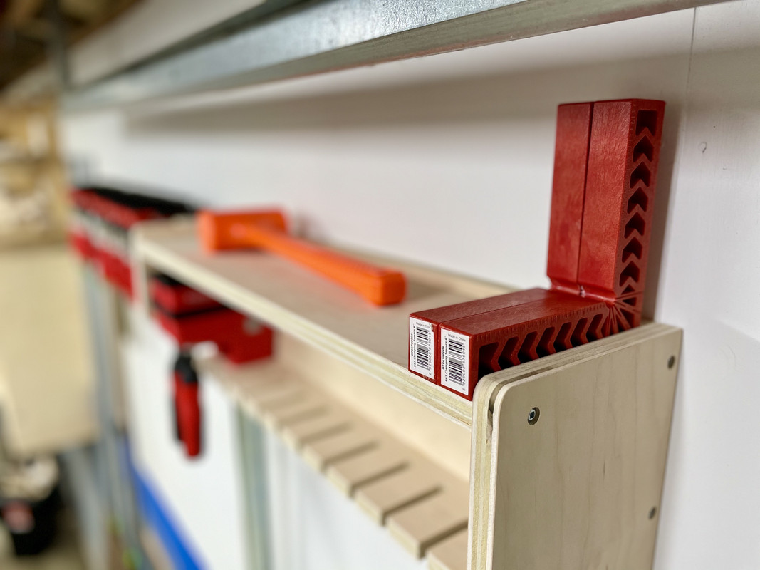

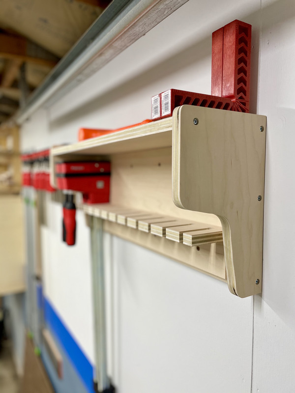

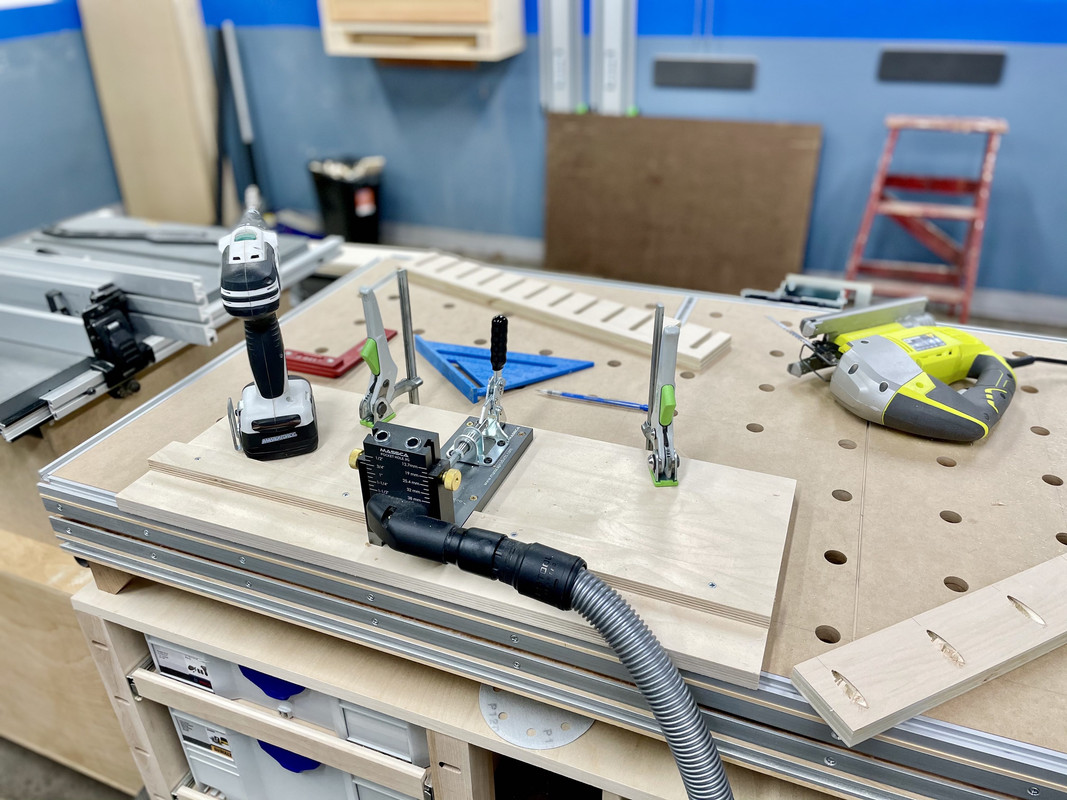

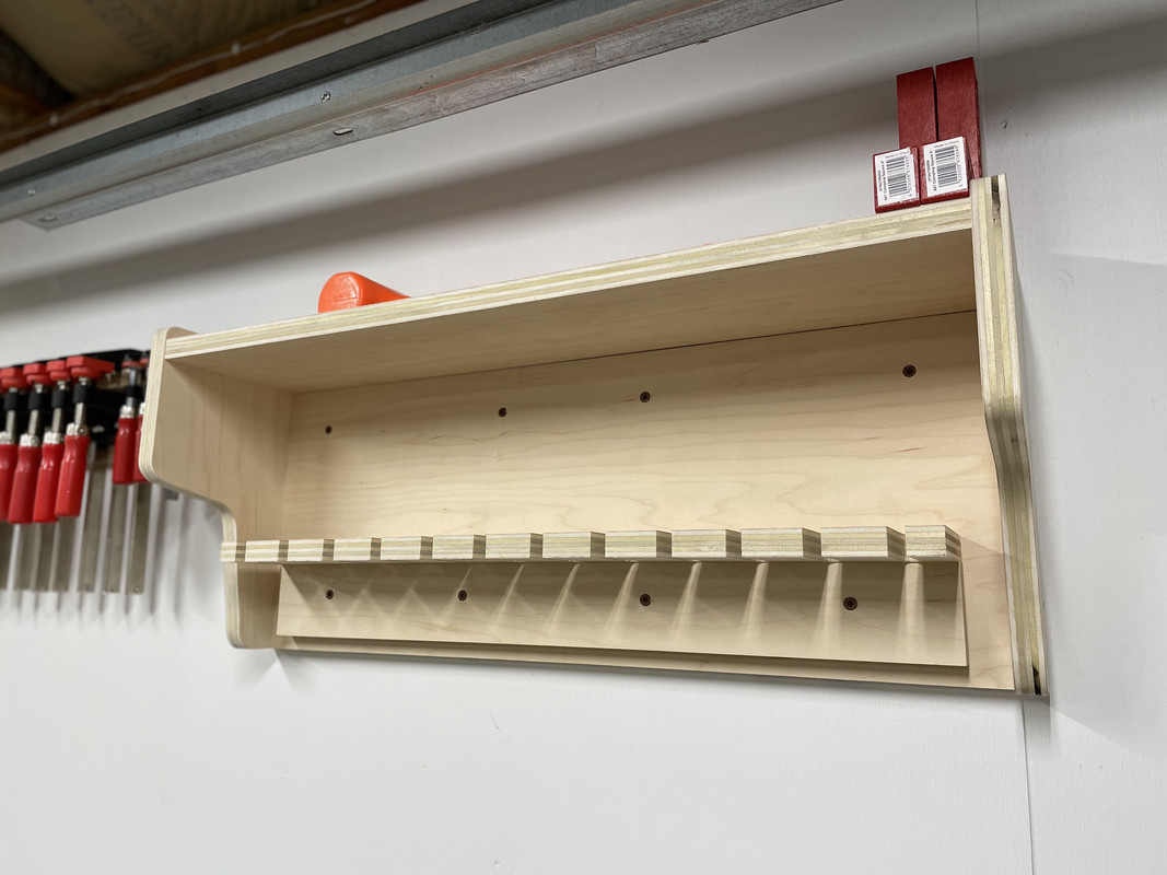

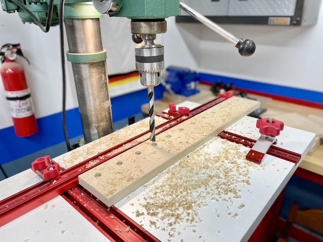

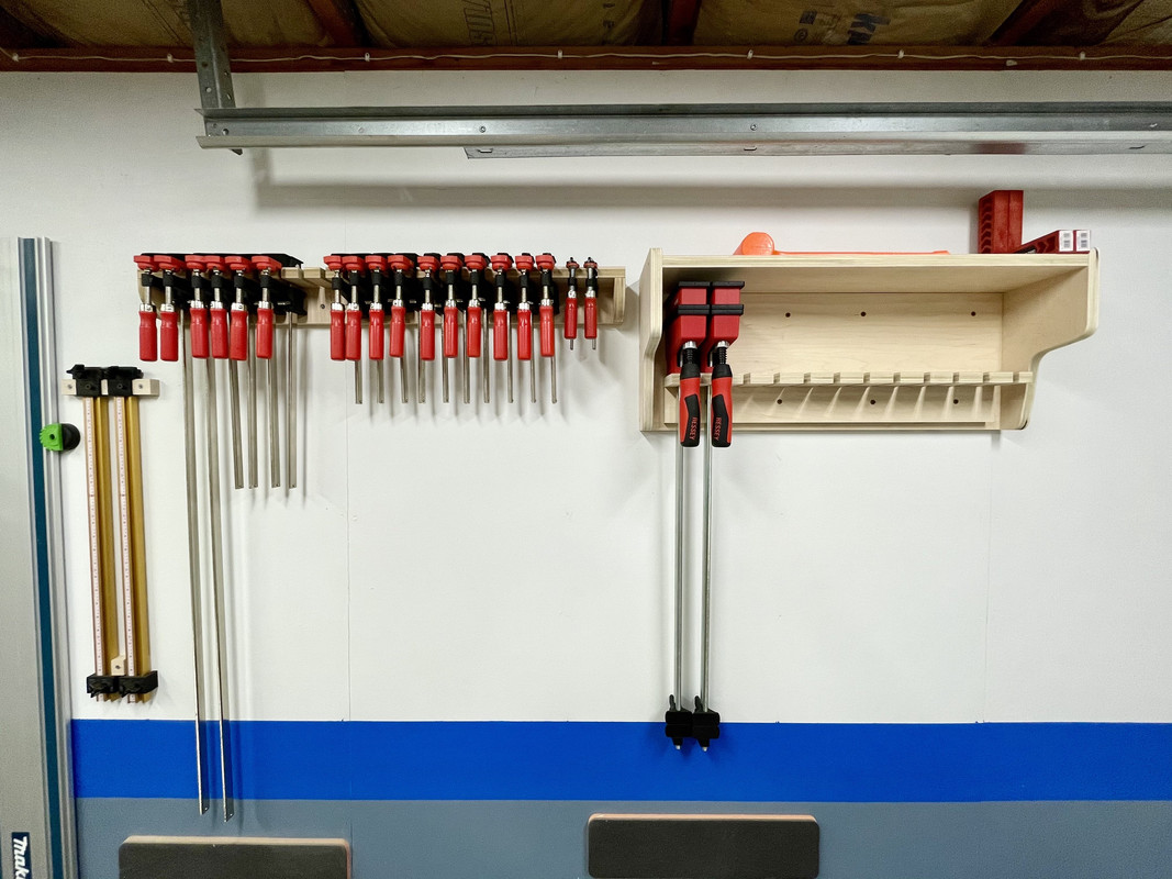

Parallel Clamp Rack
This evening I decided to bang out a quick shop project.
I was at Home Depot last weekend and had a moment of weakness and left with two 24" parallel clamps. They've been on "the list" for awhile, and after making many cabinet carcasses and drawers, especially with pocket holes, I've often found the longer F-clamps lacking. Feeling a little guilty but the deed is done.
So yeah... needed a place to put them. I came very close to getting this steel parallel clamp rack from Rockler for $20. I have a desire to make my own stuff... but am short on time and sometimes I feel like there are fairly good, inexpensive commercial solutions where it doesn't make sense to DIY. But then again, I get a lot of satisfaction from these "shop projects". So to hell with the easy road!

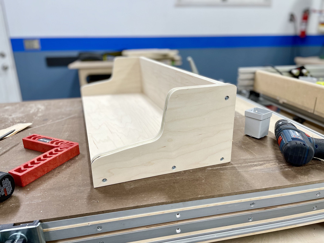

I did save some time by adapting this design from the Wood Whisperer. It was quite helpful because he had dimensions ready to go I could work off of instead of figuring it out as I went along.
Check out Marc's link if you're interested in the details, but I did snap a few pics as I went along:

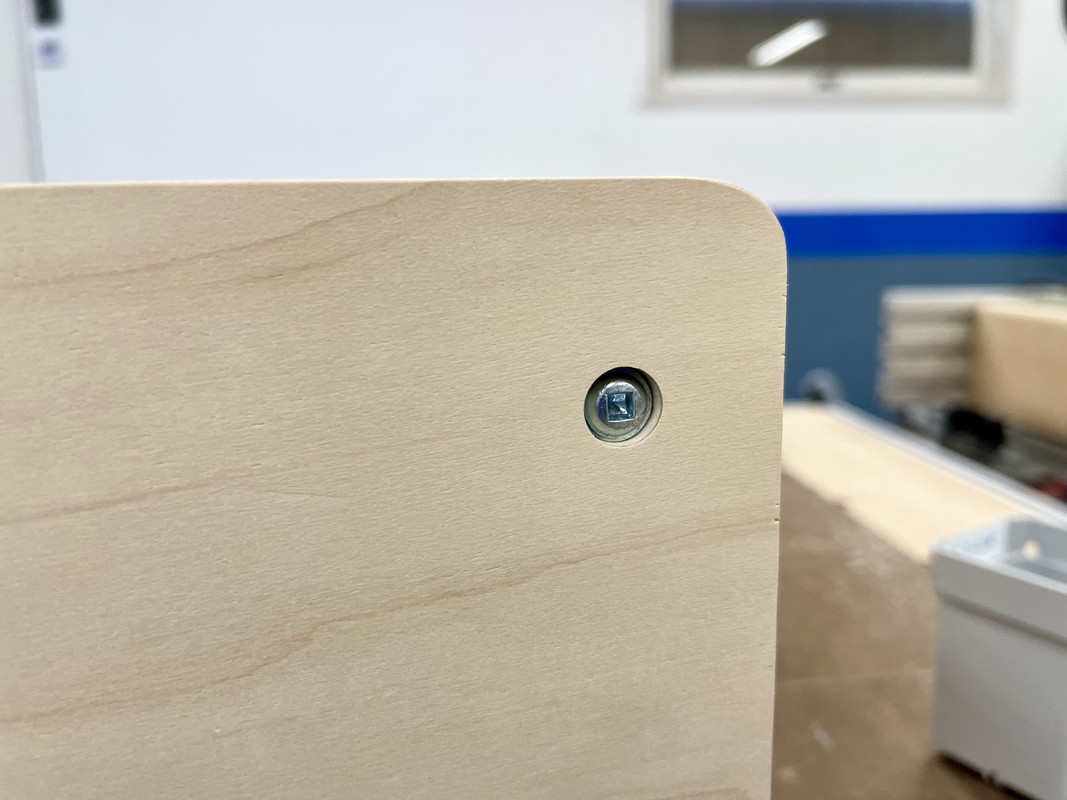

A detail I've found I like as an alternative to countersinking is using the pan head Kreg screws in a 3/8" Forstner recess:
Slots were drill press + jigsaw combo.
Time will tell the strength but I did use pocket screws and **** joint for the part that actually bears the weight of the clamps. And glue.

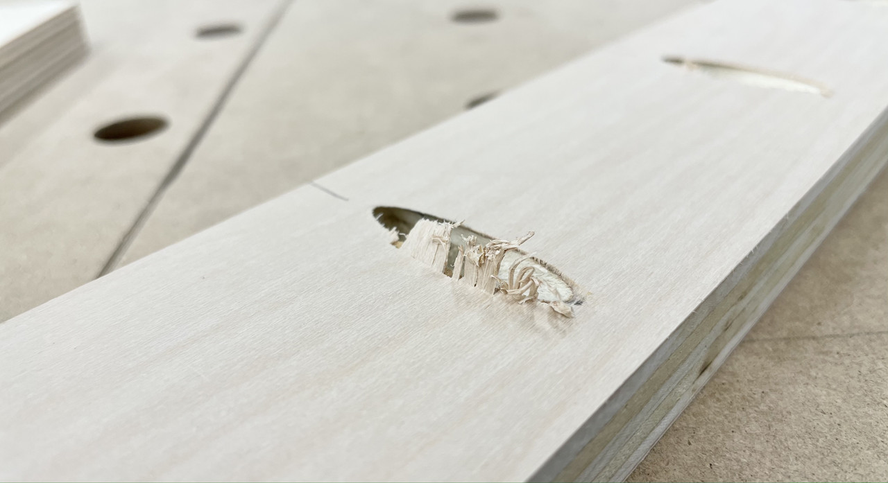

The Massca jig is super efficient but one thing that still bugs me is the "fringe" around the holes:
They break off easily, and no biggie for concealed, but if they ever needed to be plugged it wouldn't be the cleanest.
Mounted on the wall:
Top has a nice little shelf I'm planning to store some commonly used assembly goodies like 90° positioning squares, glue, dead-blow mallet, etc.
I only made 12 slots, but lets be honest 12 clamps is enough to break the bank. I'm hoping I can maybe find some used ones along the way to fill it out in time. First I need to see if I end up using them like I think I will.
:beer:

Nick the built ins came out fantastic. I love the Walnut too. It seems everything DIY takes longer than we think.
The living room looks very put together and planned. Looking forward to your next project.

The built ins look amazing. Walnut my be my favorite wood to wood with and as a bonus it smells great while working with it.
Your clamp rack looks almost too good for a garage! I always make extra slots or storage on things like that. Then my OCD kicks in and I have to fill them up!! Great Work!

Thank you Bret, that means a lot coming from you. :thumbup:
I think one big way I will use the parallel clamps is holding parts together while driving pocket screws, particularly with drawers and cabinet casework.. I know Kreg also makes specific clamps for this, which are also expensive, but they only do that one thing.
I'm also supposed to do a huge cabinet job for my parents soon, and am anticipating trying them out on that.
Thanks man! I agree on extra storage... it takes time to make stuff and I would be kicking myself if I ran out of space. Sadly with the parallel clamps it's probably going to sit empty, taunting me.
Nick, the finish product looks terrific! A job well done, very worth all of the effort.
I think one of these cool reproduction speakers on top of the built in will fit right in with your decor
https://www.amazon.com/dp/B07FHDCJ55/?tag=atomicindus08-20
Thank you!! I *think* it was worth the effort, too. Of course I'm just coming off finishing it so I think I will appreciate them even more after the post-project-exhaustion has worn off.
I agree that speaker/radio would fit nicely, although I have some existing in-wall speakers installed that I just received a new mini-amp for.

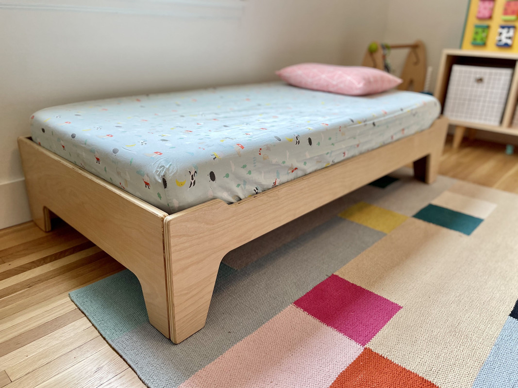

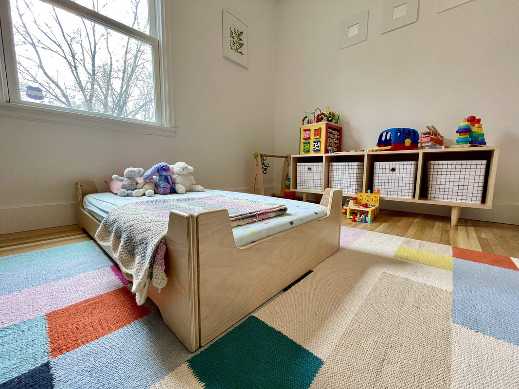

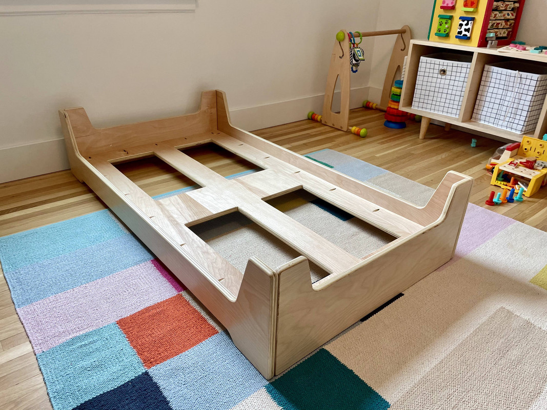

Kid Bed - wrapping it up
Some of you may not remember but I started building a bed, or built most of it rather, for my daughter last summer. And then bailed because we decided we wanted to keep her in the crib as long as possible. If you're interesting in the beginning, check out posts 829, 849, 853, and 880.
Well... baby #2 is due July, so she'll be moving rooms, and I want to get her used to the bed first, instead of two big changes at once. So time to finish up.

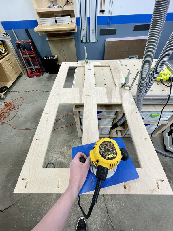

I had everything cut to size, but decided to cut out some holes in the mattress platform to reduce weight. I tried to remove as much material without completely compromising strength.
Track saw + jig saw for this. Easy peasy. And even though it will be hidden I gave it a round over because why not.

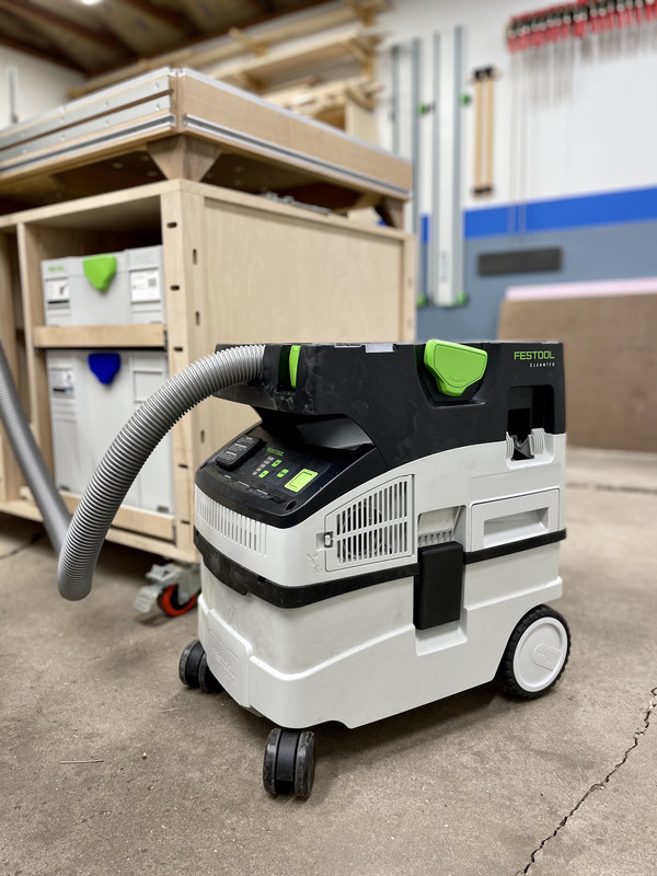

Btw in case anyone is interested in this vacuum, I did pick up the Systainer hose garage for the CT15. It's meant for the MINI/MIDI but it fits. Only oddity is the place for the manual filter clean is empty. Part 204717.

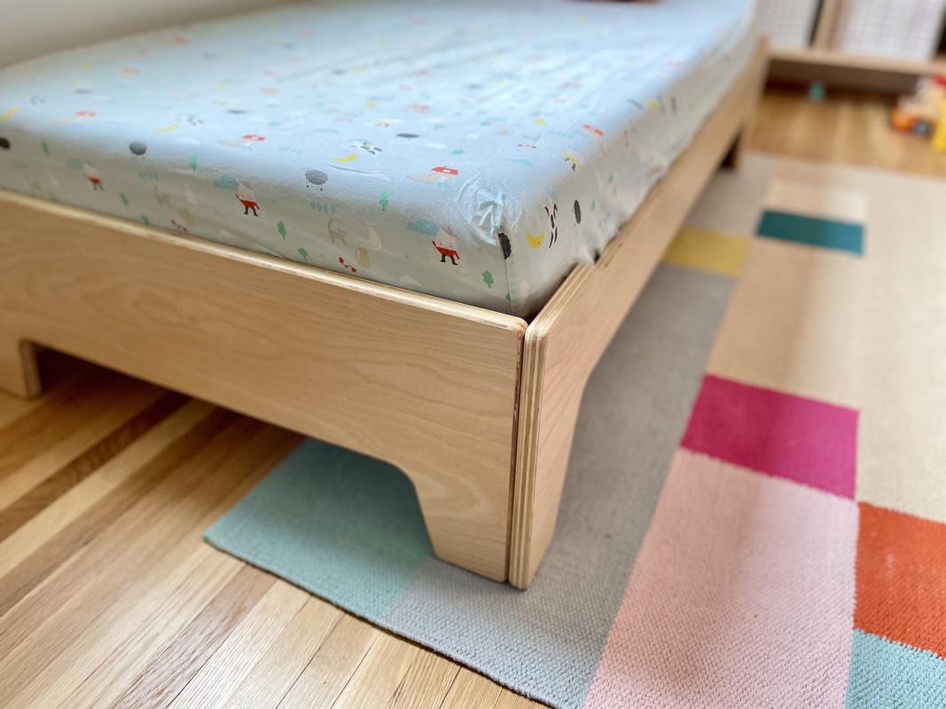

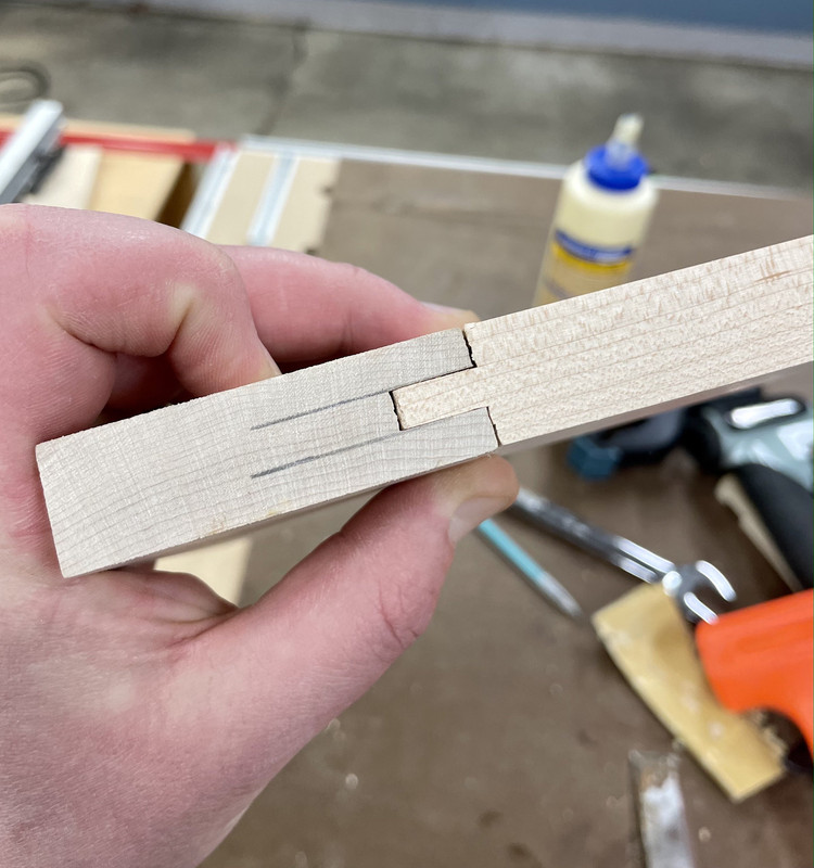

Then I assembled it. Without glue. I'm going to see how it works out, and wasn't sure if I'd be wanting to take it apart.
The four sides are dry joined with dowels, and the whole mattress platform is pocket screwed all the way around. It seems pretty solid.
The bed is reversible by flipping it over. This is "low mode":
And this is "high mode":
Honestly the mattress sticks above the rails either way, so it's not like you can't roll out of it. We might just skip to the taller mode. We'll see how it goes...
My one regret on this project is not using nicer baltic birch plywood. I still don't have a supplier and am using Home Depot stuff. Upside is the bed only cost $50 + my time, but it would have been even more professional or felt like it could have been purchased at a store, if it were baltic birch I feel.
We're not transitioning quite yet, but I left it up so she could see, and my daughter was THRILLED. That alone made it worth it.
:thumbup:

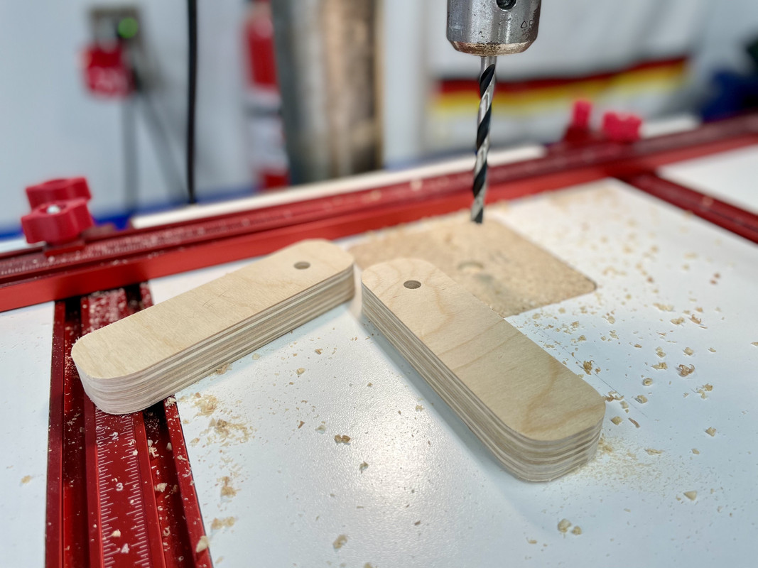

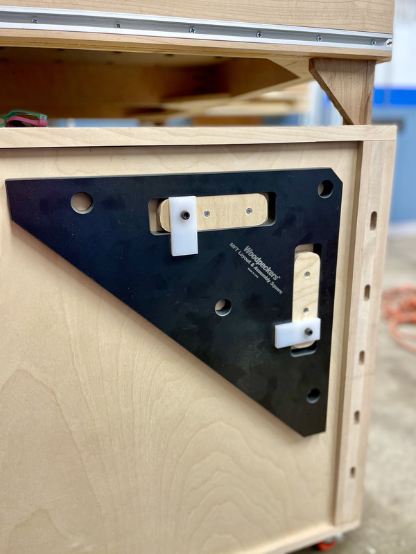

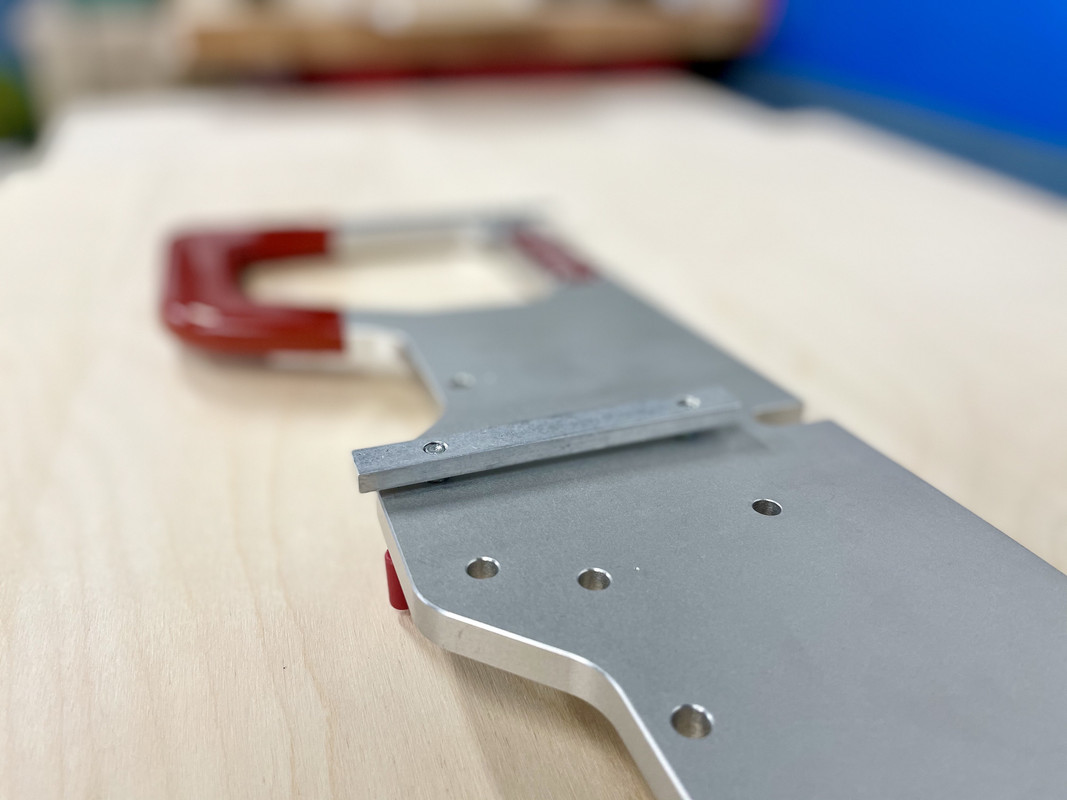

MFT Square Storage
This is a quick one. I had a few hours today and wanted to do something fast. The MFT square I got for my fence and rail setup I've been storing on my stationary workbench, or the table saw cart, or wherever. It's kind of large. Having to move it to get to stuff. No place to call home.

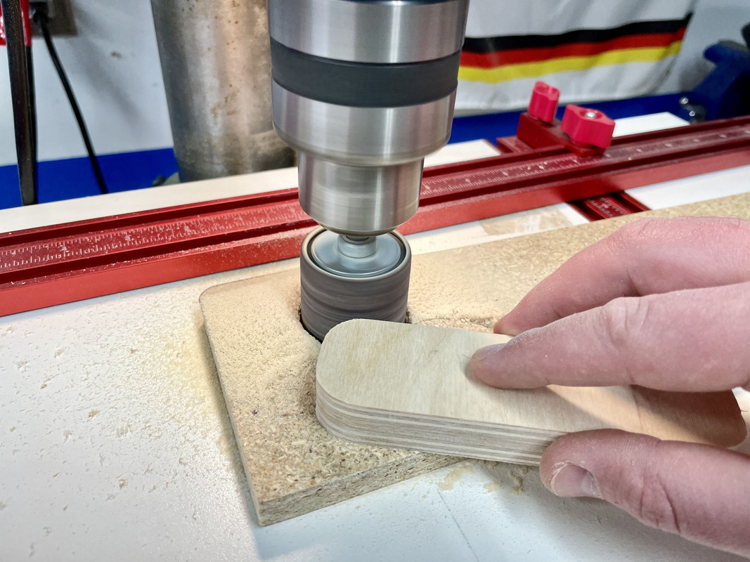

So I fashioned some plywood cleats and made 'em purdy with some rounded corners:
An oscillating spindle sander, or disc sander, is on the list, but I think those I'd probably be looking at Craigslist for used. The right deal hasn't come up.
Speaking of Craigslist, I used the drill press heavily on this little project. I never could have imagined how often I use it.
And then I used some leftover UHMW plastic for some retaining tabs. Skipping to the result:
Now it's with the MFT, at the ready, on a vertical surface not taking up space.
It's the little things... :lol:

Stunning room. It automatically says "Conversations" to me as I see myself with family/friends conversing and enjoying the time.

Awesome work! The walnut looks perfect.
Vision to concept to finished product - very well thought out and thanks for bringing us along for the ride. The Sketchup planning went a long way. I’m sure the wife is relieved it’s done!!
The clamp rack looks great. Too empty though!! The pan screws make a small but noticeable difference and works since those screws are more visible on that location.

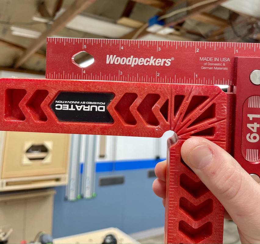

Who makes those red 90* guides?
I’m a sucker for small layout tools.

The DP is one of those tools that I knew I'd use. But now that I have one, I find myself almost looking for ways to use it...

Thanks!! The purpose of the room to me is pretty much as you've described. Many of the smaller houses on my block (like mine) are set up similar where the "living room" is the first thing you enter through the front door. Also many have big flat screen TVs you can see through the windows in the evenings. I decided early on this would be a "sitting" room, with no TV. It's not huge but a nice place to receive guests or family, or just sit with a book or magazine. I'm hoping to get a modern lounge chair in there someday, but taking my time with that.

Thanks J! My wife is pretty understanding of projects, especially when they benefit us both. But I'm sure she is glad she no longer has to listen to me complaining about how much work I have left to do...
The red 90° squares are just some cheap-O's I got on Amazon I think. The brand is "Duratec" although I am sure there are similar out there.
They are not *perfectly* square, but just fine for assembling cabinets. I often get obsessed with accuracy and squareness, but I've never felt the need to upgrade these and they work fine with the F-clamps.

MFT Square Storage
I like that drum sander in the drill press trick. I will probably do the same once I get a drill press. For now its carefully holding a small piece in one hand and my orbital sander upside down in the other.
Yeah, I've done the orbital sander thing too haha. :D It works much better on the drill press, the only thing is I try to apply very little pressure so as not to put undue force on the quill. But totally gets me by in a pinch until I can get a proper sander.
There are even some drill presses out there that have an oscillating feature meant to use with sanding spindles.

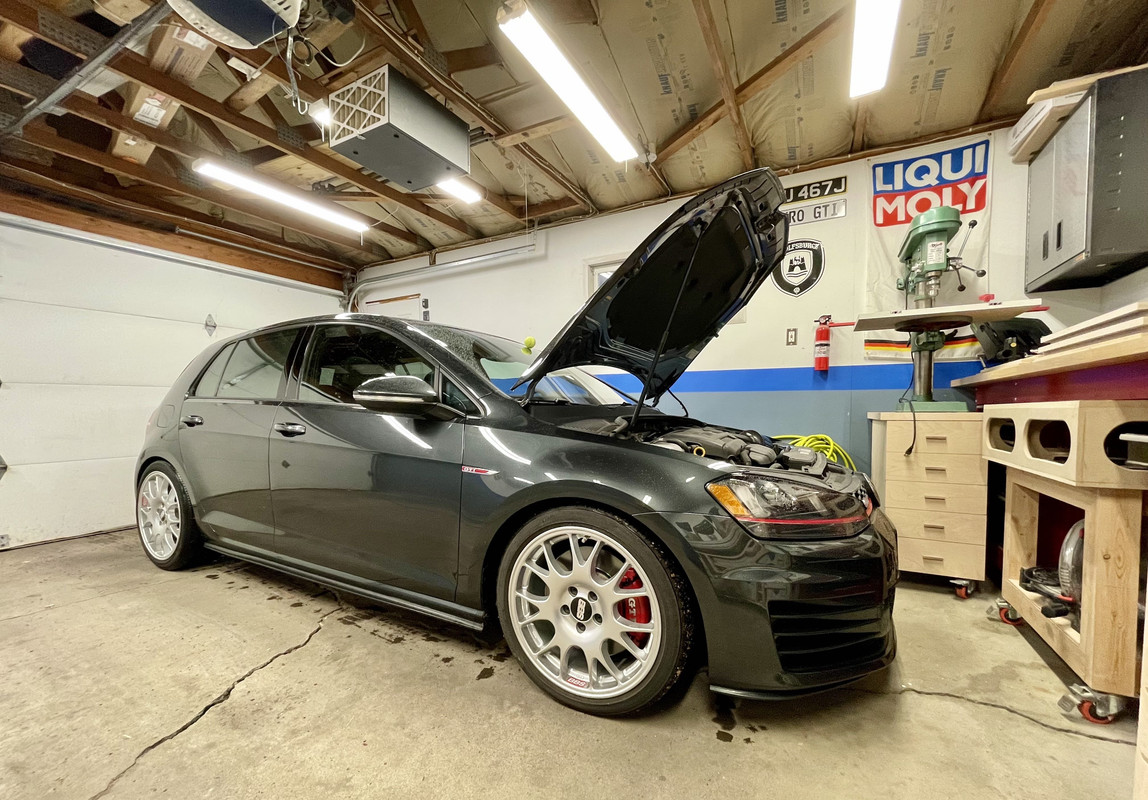

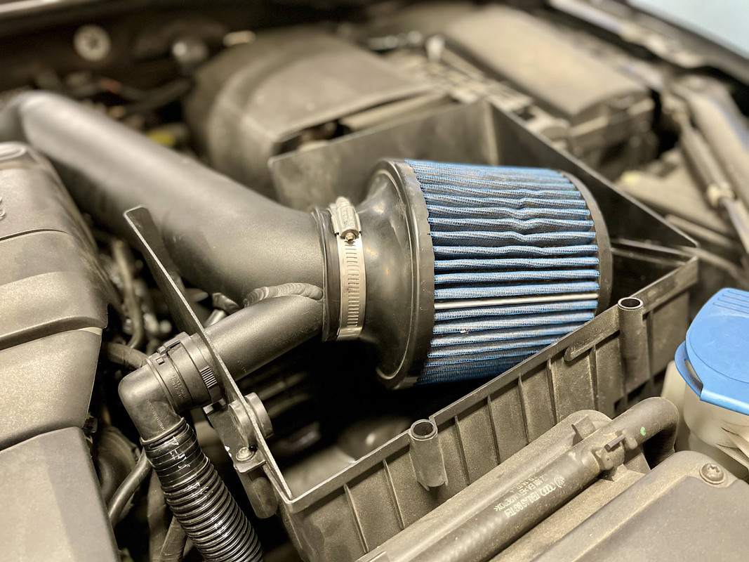

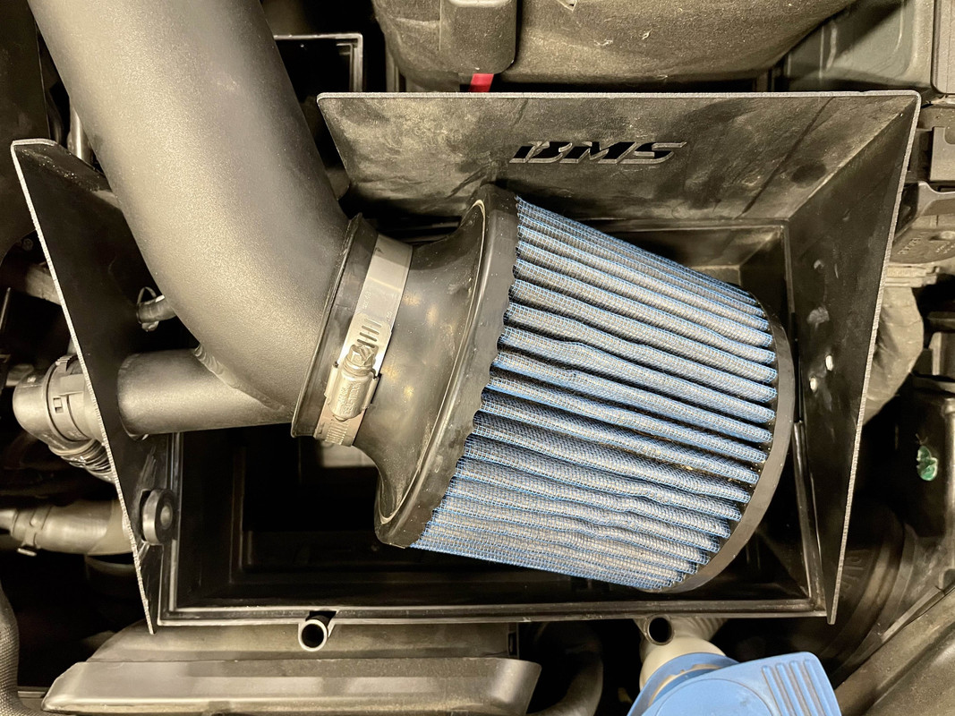

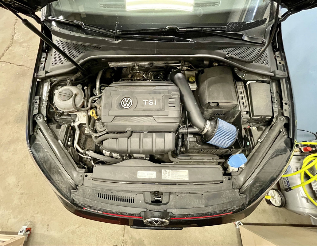

Revisiting the namesake of the thread after quite some time, the VW got a little love over the weekend.
Back to summer wheels and got a wash in.
And installed a Burger Motorspots cold air intake / filter on a stick. **** dyno says I've gained 400 WHP.
Jk it was kind of a trial to see if I like it. I've had a few Turbo Beetle cabriolets as car rentals before and I was jealous that you could actually hear the turbo and DV. The GTI is so well-damped in the cabin you get basically nothing.
I found one of these used for $60. This particular one is $229 new but has been out of stock for about a year so idk if they are ever coming back. For reference, intakes on this platform are usually in the $350 - $450 range, which in my opinion is ridiculous. I figured, for $60... I can try it and flip it if it stinks.

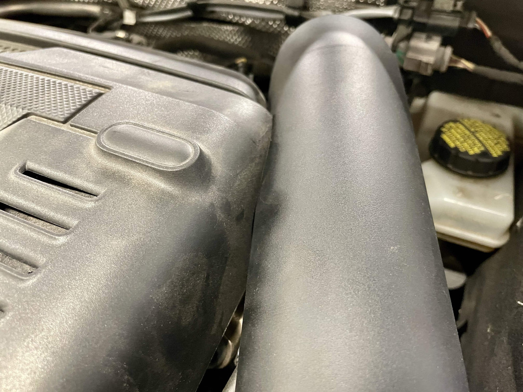

As usual as it goes for me installing car parts, it was frustrating. Fitment was not good, it was a major struggle to get everything aligned.
The intake tubing is basically rubbing against the motor:
And the cone filter itself is pressing against the back wall of the support box:
Not a fan of this but hopefully it will be ok.
The reason I got it cheap was the filter was crushed a bit and the previous owner had drilled some holes in the support box for water and meth lines.
Since it's under the hood none of this is really a problem to me.
Here's the disappointing part... no way near as much turbo noise as I expected!! In first gear I hear nothing from the DV. 2nd and 3rd there is some decent noise from the DV release when you let off the gas, but it's only very audible with the windows down. Windows up still pretty dang quiet. AND I really have to run it out and drive like a race car driver to get enough boost. I'm not tuned or anything so maybe these are more effective running some additional boost, but a little disappointed. Aside from the "DV effect" there is really no additional intake noise. The rental Beetle I drove you could hear the turbo spooling much better. I'm gonna leave it on for now, when summer finally gets here it might be kinda fun with the windows and sunroof open, but initial impressions are I'm certainly glad I picked up a cheap-O and nothing expensive.

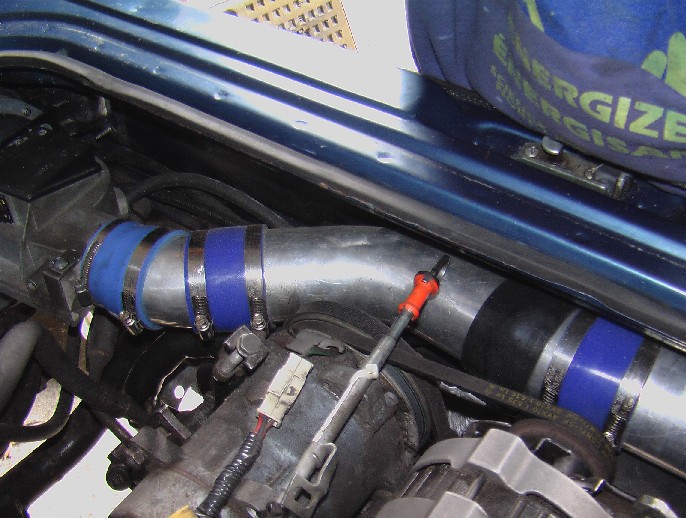

Nick, I build my last custom intake from some mandrel bent 3" aluminium tubing, and silicon coupling gaskets. You just buy generic bends and straight bits and join them with the couplers. just an idea if you want to sort the contact. This was for my Audi engine into 1990 Westfalia conversion...

Nick that is strange. Can you even hear it sucking air when you goose the throttle? Most open elements you can at least here the air sucking in louder than stock. Most stock air boxes are setup to be quiet for the majority of the public that don't want to hear or feel their engine working.
I have a K&N on the Camaro in a whisper lid and you can hear every bit of air running in when I am on it. Same on the Caprice. It has your old standard round open element air cleaner with a 6" tall air cleaner. Neither one of them have hood insulation though.

Ha, that's cool Dennis. I've driven it a few times now and it seems ok I think, but I will keep that in mind if it becomes an issue.

I only hear it in 2nd, 3rd gear or above, at medium RPMs. 1st is pretty much non-existent (and it's a long 1st gear!). Basically confirms my long-held suspicion that 1st gear is neutered by boost-limiting, probably because high torque and FWD blah blah blah. But 2nd doesn't really dig into good boost until your 30-40 mph+, so it's challenging to get the turbo noises on residential streets without driving like a bit of a clown.
My car does have under hood insulation, so that is surely killing it some. I removed the weatherstrip where the firewall / windshield intersect this morning, and that did help a bit. But overall, still a bit underwhelming.
It's hard for me to tell if it's just quiet in the cabin, or quiet overall. There's a chance it's just quiet in the car and I'm still ******* off the neighborhood :lol:
It's a blessing and a curse, VW engineered the car to be very well damped inside. It's quiet, comfortable, dare I even say a hint of Audi-esque luxury. But, that also makes it less sporty and kind of tame. I mean it's supposed to be an enthusiast's car... not that fun if you can't hear the motor, exhaust, or turbo. I've done a few things (like stiffer motor mounts) that help bring it out, but completely stock, the car is on the tame side for what I think should have a *little* more attitude.
I can only imagine what your cars sound like, Bret, I'm sure they are totally awesome!!!

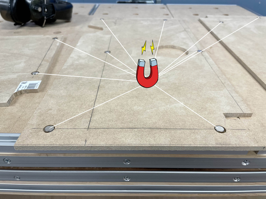

Teeny tiny shop project the other day. Awhile ago I made some dust covers for my table saw. They have worked well, and do trap a lot of dust inside.
Although they fit well, sometimes one would fall over. I decided to add some magnets to hold them secure by recessing with the drill press and some super glue.

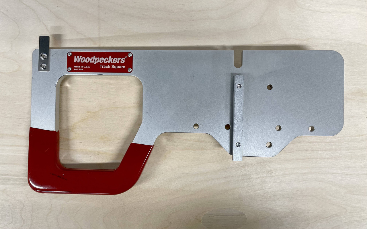

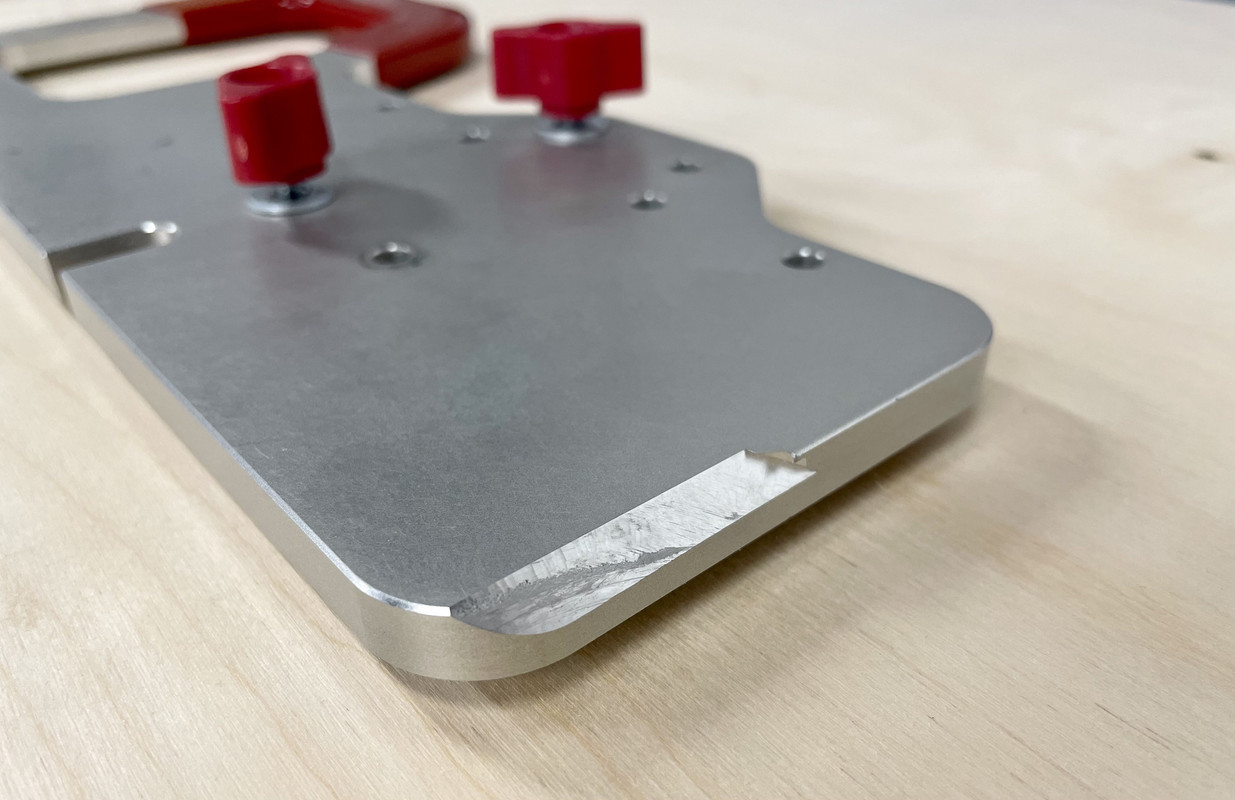

Craiglist Find - Rail Square
Just sharing because I'm excited! I made an impulse purchase on this used Woodpecker One Time Tool "Track Square":
I rarely find good deals, but I do often keep an eye on the used markets around me, Facebook, Craigslist, Nextdoor, etc.
This bad boy has some signs of use, but it was less than a third of what TSO's cheapest rail square costs. Getting one square corner on a full sheet of plywood is an important part of breaking down sheet goods with a track saw, and I've never had a great method. Sometimes you can do all the rip cuts, and then all the cross cuts on the MFT, but sometimes not. Depends how the cut list is laid out to use the sheet most efficiently.
Anyways one reason it was a deal is the previous owner accidentally cut into the bottom on a miter cut:
This isn't a huge deal to me since it's on the bottom.
One bummer I didn't realize (like I said this was a bit of an impulse purchase), is the rail square has no reference for square. What I mean by that is the little bar that the rail slides onto has some play in it:
According to Woodpecker's own instructions, you need an "accurate reference square" to "calibrate" it to the rail. Most rail squares (including Woodpecker's latest one) have an additional fixed bar that is perfect 90° and a spring clip that hugs the rail to it.
Fortunately I think I can use my phenolic MFT setup square as a large reference.
In retrospect it's not perfect, but super cheap compared to new ones and I still think it will be useful. And I should get to try it soon -- my dad has been bugging me to start his enormous pantry project, since I am finished with the built ins.

Updates to the dust covers look great. Nice idea with the magnets.

I’d put the stock airbox back in and put that money towards a stage 1 APR tune. The intake isn’t doing anything for performance anyway. Wakes the car up and I feel their tunes have always been a nice mix of performance and reliability versus other tuners that focus on higher dyno numbers. But there are many options as I’m sure you know.

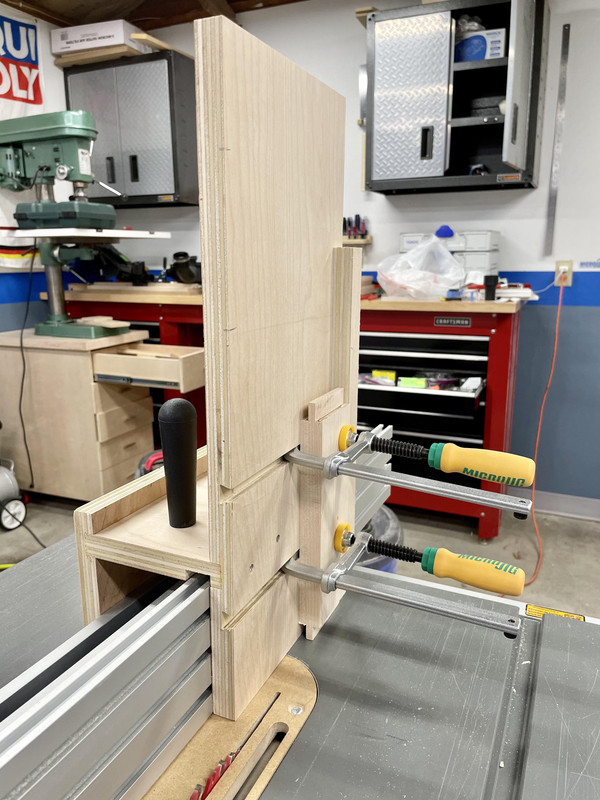

Spent way too much time on this simple tenoning jig the other night:
I've been thinking about how to make my dad's cabinet project easier. You'll hear more about it soon I think but one challenge for me is doing rail and stile doors since I've never done them before. The tenoning jig was supposed to help with that, since I don't own cope + stick router bits, a coping sled, or have a miter channel in my homemade router table.
I figured table saw might be easier, and I broke down and got the basic Microjig matchfit dovetail bit and clamp pack from Rockler to make this jig. I figured I can use the clamps in the MFT and will likely use this system for a number of future jigs so I don't have to pay for expensive T-Track. I already have a couple of cool ideas in mind.
Anyways, back to the tenoning jig, man I got frustrated. I tried to assemble it with dados, which was a huge waste of time. It took me a long time to get the exact fitment set up on the router table, I really need a better system or jig for that. It's one reason I rarely use dados, but I think I will be for a mid-divider in my dad's project, so I have to get something reliable figured out.
2nd problem is my table saw. I've noticed the taller aluminum extrusion I have on the fence is not perfectly 90° to the table, which means the stock fence isn't either, although probably not as noticeable with the shorter height. I also had trouble getting the jig glued up squarely. So the side that supports the tenon is actually not perfectly square.

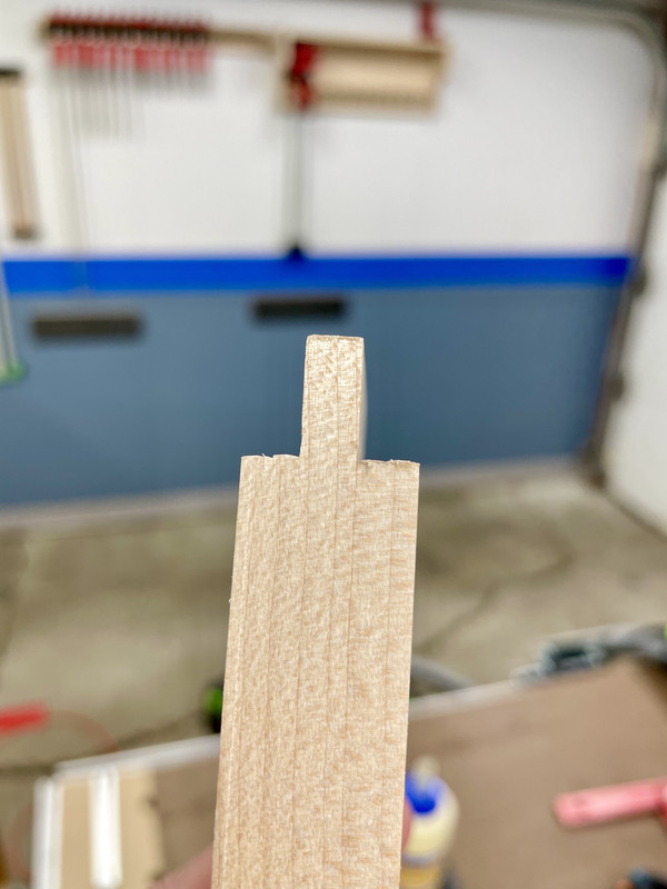

Not wanting to rebuild it I tried a test joint with some scrap maple:
It worked... ok...
I don't have FTG tooth blade yet, so my combo blade didn't leave a totally flat surface on the tenon shoulders. Hoping this is partly the reason for not a perfect fit:
But additionally I am worried about the fence perpendicularity, and my zero clearance insert is not perfectly leveled with the table surface. And if I want to get really nitpicky, the whole table on this job site saw is not perfectly flat.
All of those table saw defects (plus miter channels are not equal width throughout!) have been making me wish I could upgrade to a full size saw that's more accurate.
I'll need to practice some more with the tenons, and if I can't get good joints, come up with something else.

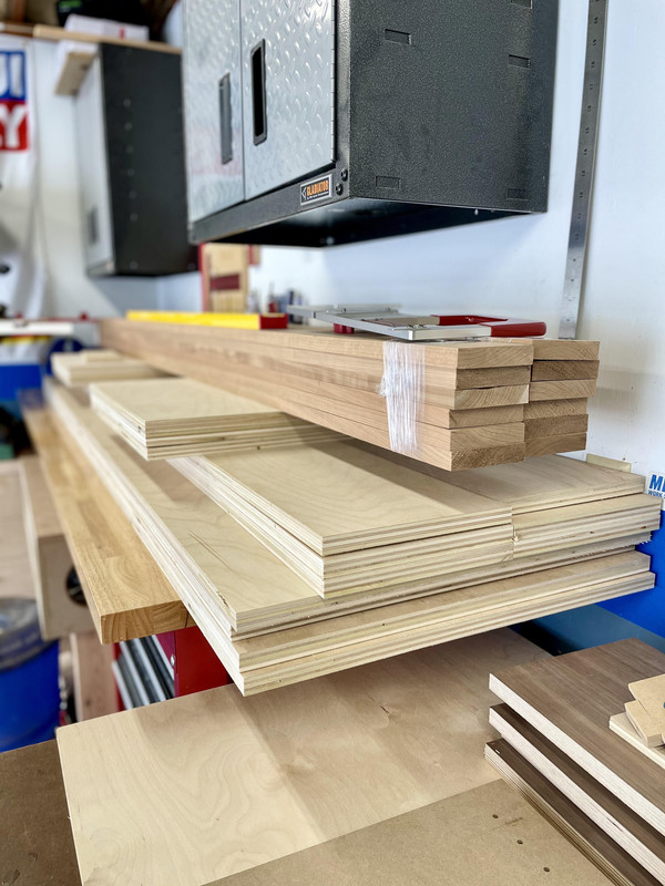

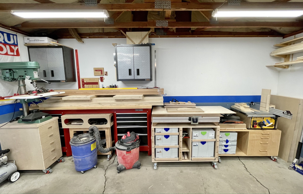

In other news the shop is a bit of a mess and I have a lot of leftover materials from the built ins that I want to save, but don't have a spot for. I really need to clean house before I start the next one.

Before I had a shop full of machines to make tenons, I used a miter gauge on the table saw to make them.
Set the length to the shoulder with the rip fence and nibble away, then flip. It will take some tweaking but eventually you will get a good fit.
I'm 99% positive that is thr method we were shown in high school shop class.

Nick you don't need a flat bottom blade for to make those tight. Just cut the tenon a little short and then cut the shoulder to size horizontally with the miter gauge. You will have to do two setups.
Thanks Jar, this will be my backup method if the tenoning jig doesn't work well enough.
Bret
Smart, Bret. I've been meaning to add one to the blade collection eventually for miter splines etc, but I'll give that a test and a think over. Thanks!

Pantry Project - part 1
Ope!
(That's my dad in the pic)
Plans he drew in Autocad:
I present to you, lots of broken down plywood (6 sheets!):
Getting a little crowded:
I guess this means I've started the next project. :lol:
