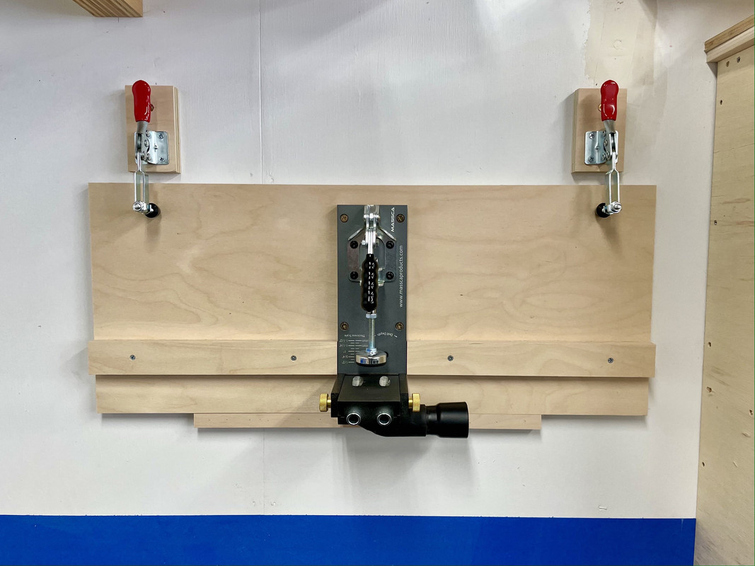

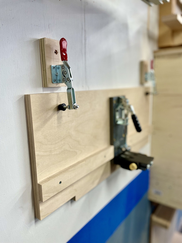

To keep this mildly garage-related, in an effort to clear space off the benches (I need all I can get for my dad's project!) I made a little docking-station-wall-holder for my pocket hole jig. The quick-clamp idea I stole from Trapps!
It's not necessarily permanent, but at least it's on the wall for now!

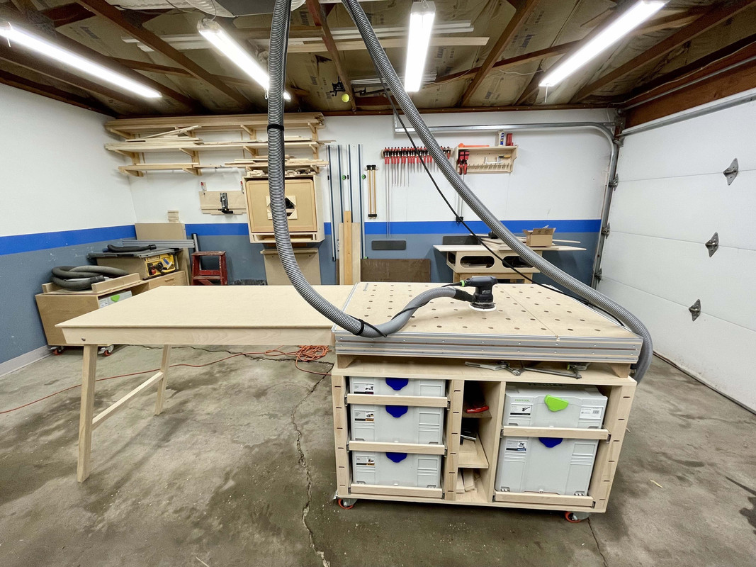

Another thing I've been mulling over for awhile is re-painting the garage walls white. Aka getting rid of the blue stripe. I'm not 100% on it but as the space has evolved in purpose from car-centric to woodworking-focused, I thought some of the plywood shop furniture and red tool bench would look nice against a simpler white backdrop.

Nick, side note, but if you want any more of those toggle clamps let me know. I have a ton of them that were purchased for a work project but never used. Carr Lane CL-350-HTC just cover shipping and I'll send you a bunch.
https://www.amazon.com/dp/B00EKJIOL4/?tag=atomicindus08-20
Also... thanks for the kind words about my Jeep “skills” haha, just faking it till I make it!
If Nick passes, I'd be interested in some.
Thanks Roboto, although I actually have some extras still from a pack I bought. I don't have an immediate use so I think I'll pass but I appreciate the offer!
:beer:
This has been bugging me for some time. I didn't want to say anything as it is your garage and the way you want it. But I have looked at the stripe at thought I wonder if Nick still sees this as a garage aimed at cars as it has truly evolved into a wonderful workshop making sawdust and all other things.
Glad to know it is kicking around in your head. I am suffering from analysis paralysis as BD calls it. I can't decide whether to paint the 2 sections of pegboard I have left that are not painted the Blue I choose for the garage or the off white I painted the tool wall that is leftover from painting the shed. I like the color contrast of the Blue but my aging eyes really like the brightness of the off white. I dunno...
Bret
N
nicholam77
Dec 18, 2016
2,693
Minneapolis, MN
Bret
Ha, I guess you read my mind! I've actually been thinking about it since taking the miter station down... just haven't prioritized the PITA of moving and cleaning everything over other projects. I don't have anything against "racing stripes", but yeah, over the past few years doing a deep internet dive of workshops on forums, Pinterest, YouTube, and of course Garage Journal... a lot of woodworking shops are painted white. And it makes sense. If I knew it was bugging you, too, I woulda got on it sooner!
:lol_hitti
With the shop lights, the high contrast of the white and dark gray pose an issue for photos, too. It's better with my current phone, but my last phone really struggled. I always edit every single one of my photos to bring up the blacks / shadows so it looks more consistent like real life. A solid white backdrop would make exposures better.
I'm not sure on your pegboard, but if you're like me you'll end up thinking about it for another year or two!
:lol:

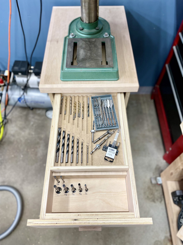

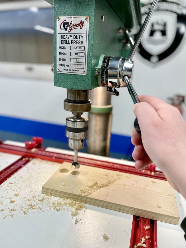

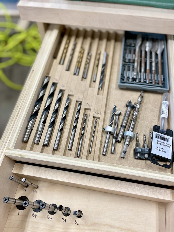

Drill Press Storage
Another quick shop project. So I built the drill press cart last summer, and put stuff in it. But it was basically just thrown in the drawers as a jumbled mess. Today I tried to tackle the drawer with my drill bits.
The drawers have some depth, so for the Forstner bits I just drilled holes for the heads in a piece of plywood and stood them upright:
I only have the 7, but I left space for some larger ones and future metric versions. I also put two side runners in the back area of the drawer, and a little divider behind the Forstner bit section.
On this divider I capped the plywood with a strip of maple I had that was just over the thickness of the plywood. No reason really, but I did give the hand plane another go to flush it up:
Worked well, pretty sweet!

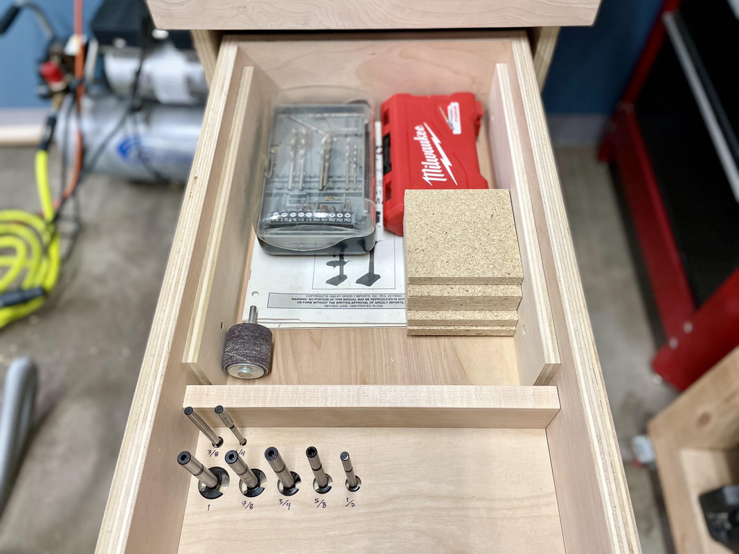

Next I made a sliding drawer compartment thingy for brad and twist bits + some miscellaneous stuff:
And wrote the sizes on the wood with a fine point sharpie:
This way I can take the tray out and still store stuff underneath it.
If I know I'll be acquiring more of something someday (like drill bits), I always struggle building or planning storage for it. I get anxiety that I'll run out of room or won't predict it right. But anything is better than piled on top of each other in a mess. It feels so good to do little organizational things like this, I think I just need to take some leaps and realize that if it doesn't work out down the line I can always rebuild it.
Plus it's these projects that are the perfect use for plywood and MDF scraps. :D
:beer:

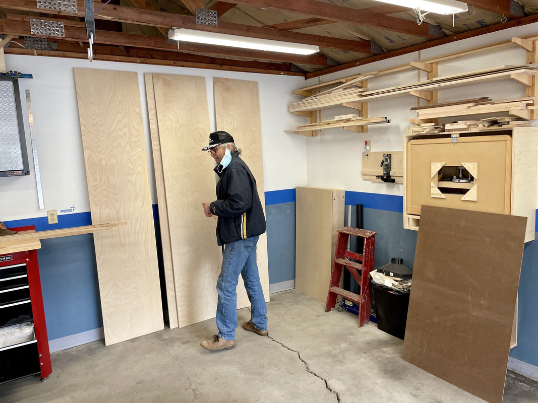

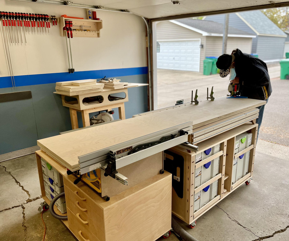

Pantry Project - part 2
Got through a few more steps.
Making sense of all the pieces:

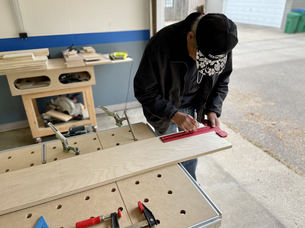

Dad taking the Woodpecker goods for a spin:
Cutting out toe kicks with a jig saw:

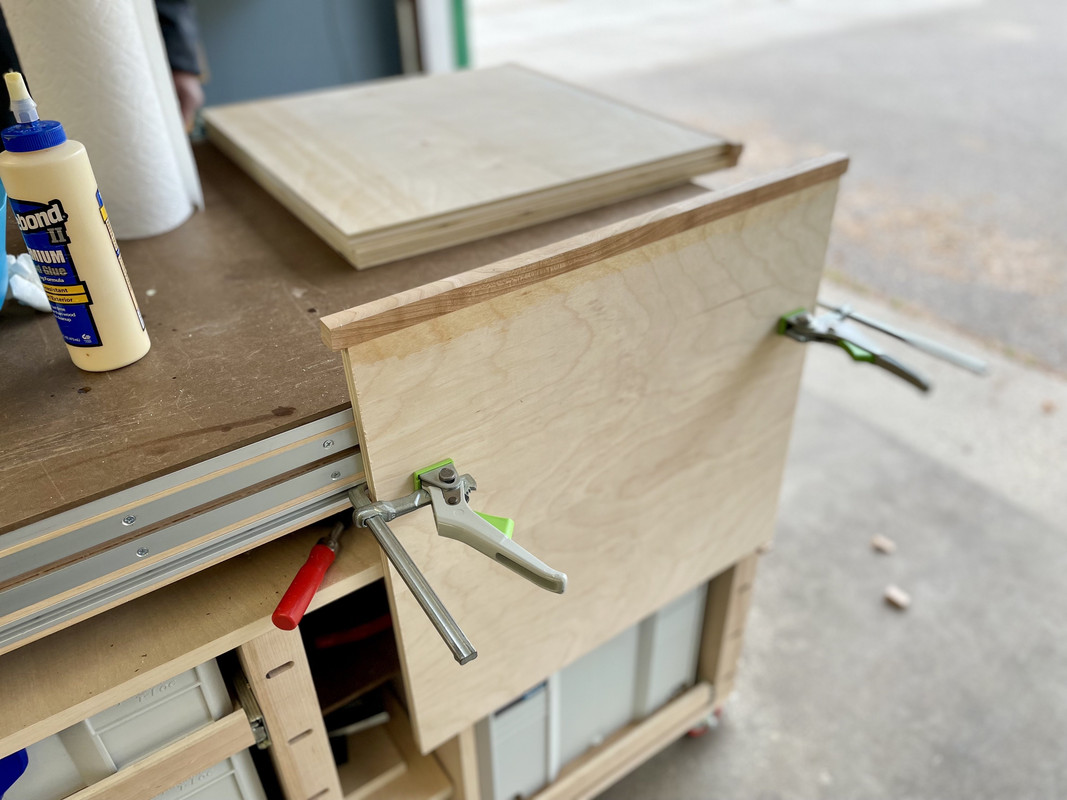

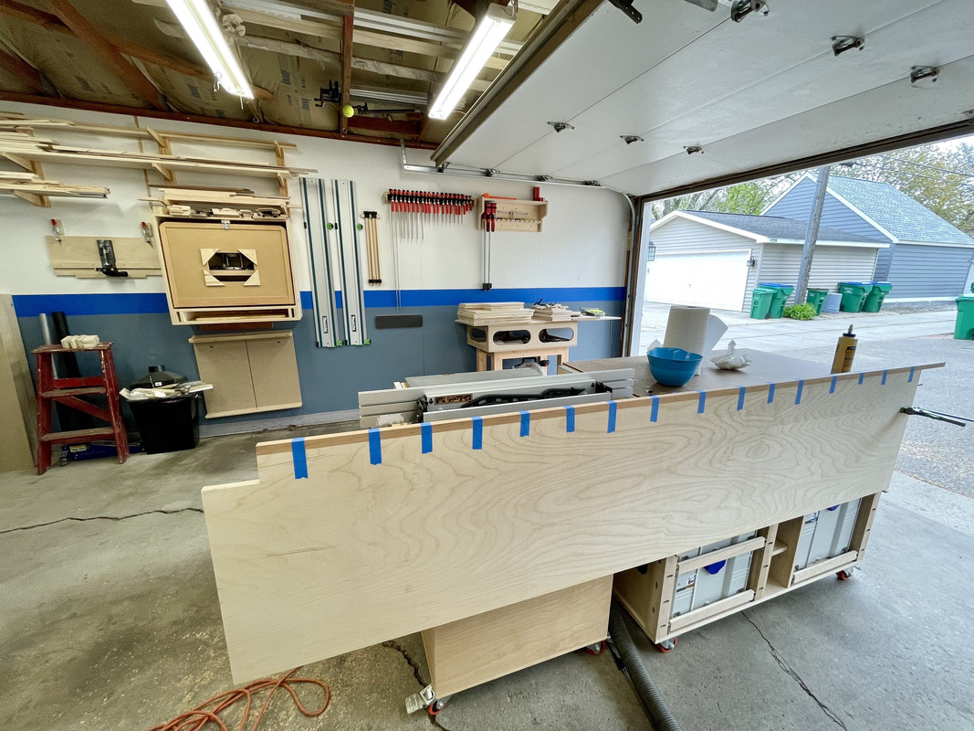

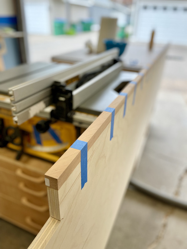

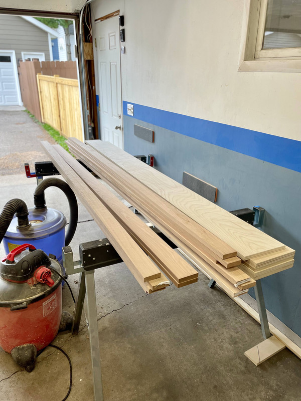

A bunch of cherry boards we ripped for 3/4" thick hardwood edge banding on all the faces. The offcuts will be used for the rail and stile doors.

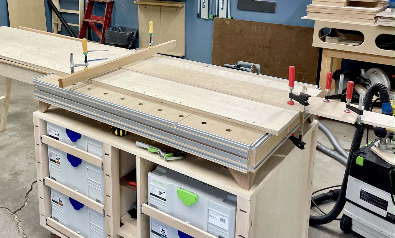

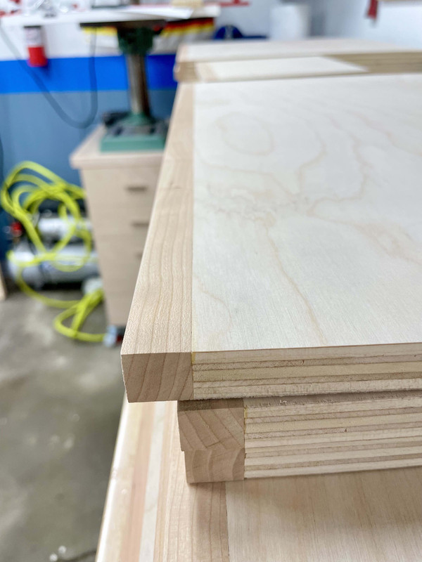

Edge banding:
That's right, the MFT can even clamp these almost 8' pieces! :rocker:
I tried to use some blue tape on the first one to space out the pin nails, but that got real old real quick, so for the rest I just used more pins.
They'll be covered by the doors anyways, so :dunno:
And the horizontal pieces:

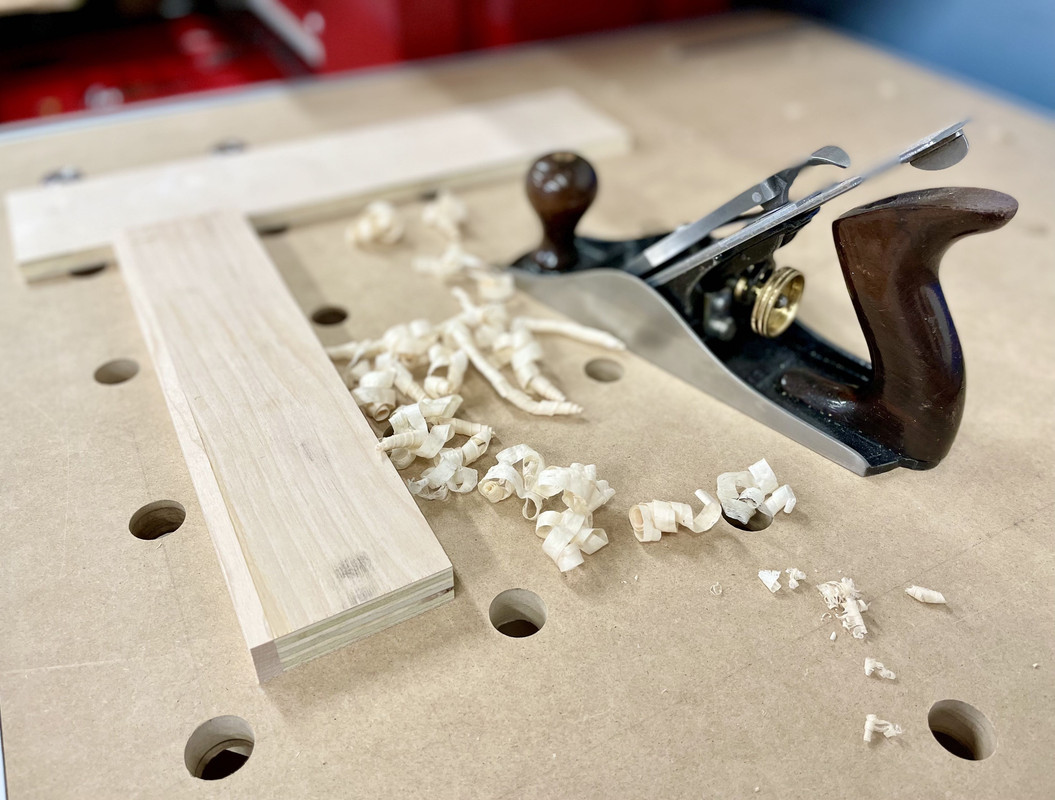

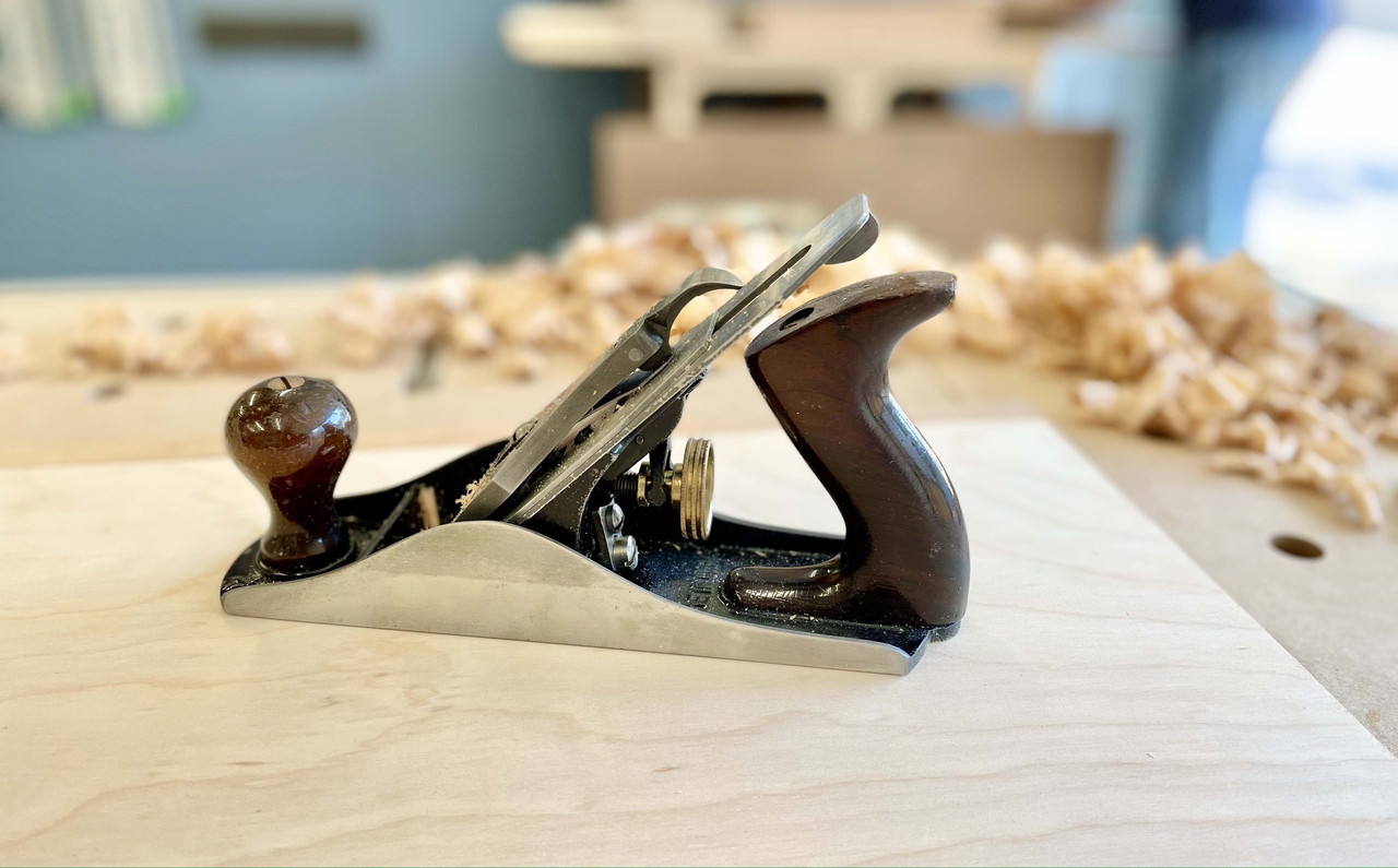

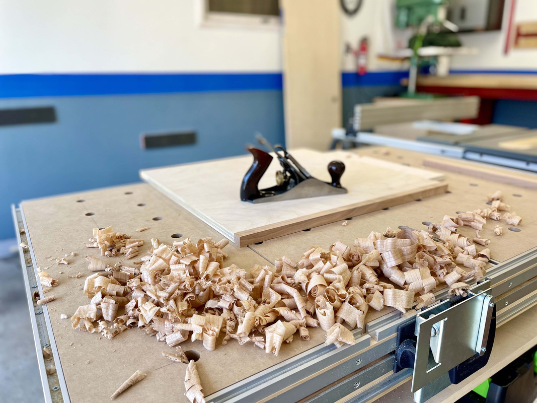

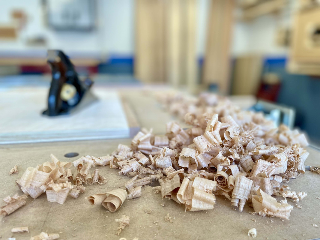

Pantry Project - part 3 - flushing the edge banding
In an effort to make sanding go quicker.
There are many, many more shavings not pictured. Like a ton more. Did the 8' carcass sides as well. Got some sweeeeet 4' shavings on those. It was a good couple hours of work. First time really using the No. 4 and it was exceedingly fun. My weak @$$ shoulder is gonna be sore tomorrow.
I probably could have found a more efficient way to do it (router??), but I thought it would be fun to use my grandpa's tool on my dad's project.
:D
loganb
Dec 29, 2011
5,710
Omaha, NE
:D
Super cool...the extra time spent doing it with a tool with that connection is well worth it....and even if it wasn't your grandpa's...hand planes are fun!
N
nicholam77
Dec 18, 2016
2,693
Minneapolis, MN
Good to see the plane in action. :thumbup:
Yeah, thanks for the advice on getting it tuned up! Tools are meant to be used! But holy **** did my forearms hurt last night. Kept me up at night actually, had to pop some Tylenol! Idk if it's my bench height or just unused muscles but I really felt it.
Yeah, very satisfying indeed :rocker:

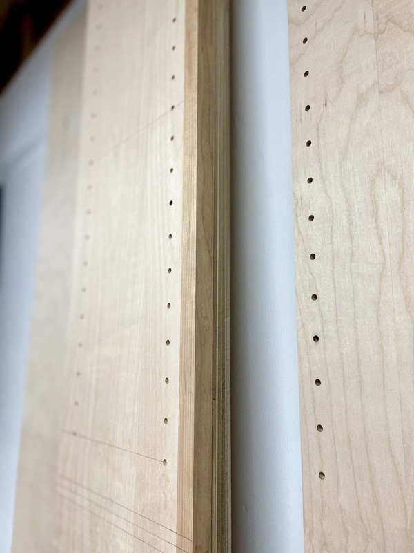

Pantry Project - part 4 - shelf pins for the win

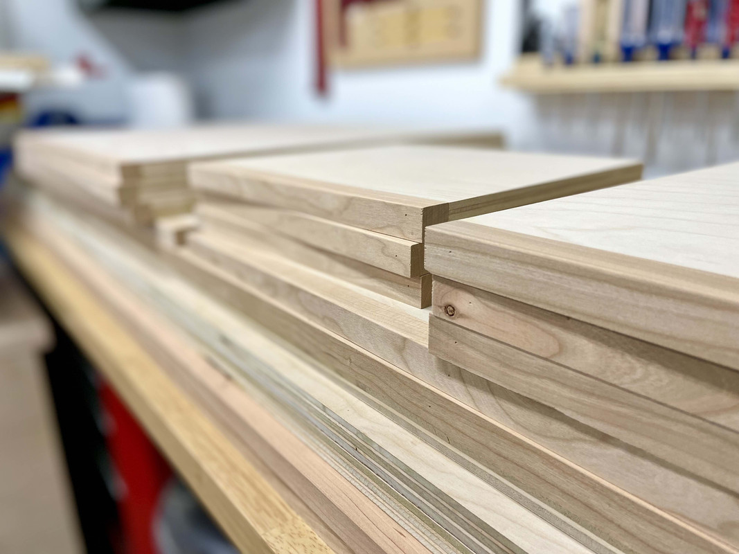

Got some more time in this afternoon. First I trued up some of the parts. The track saw rip cuts (with two 55" rails connected) had not come out at accurate as I'd like, again. Some had a sag in the middle. I'm bummed I didn't just save up and go for the 118" rail.
I didn't want anything to come out sloppy in the end, so I ended up running everything through the table saw and shaving an 1/8" off to get a nice parallel edge to the fronts. A huge plus of the track saw is NOT having to do this with large pieces on a tiny table saw, so I need to figure out something to correct it on these long parts in the future.

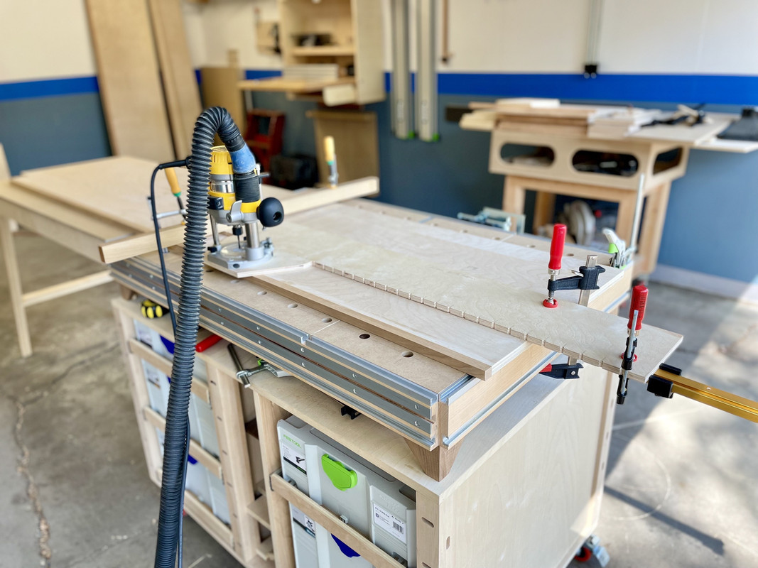

After that, started on the shelf pins:

Because I'm looking ahead to built in cabinets in the studio/office build, I just picked up 32mm rail index tool that also fits my rail router adapter:
As you know, that Bosch rail adapter runs on Makita tracks and will mate to a DeWalt router. What I don't know is if the 32mm indexing tool will play nicely with the Makita 32mm rail.

Continuing on with shelf pins:
I don't have detailed pics as I was focused on moving the work forward instead of documenting, but I am a bit disappointed and didn't get the results I wanted.
One row of these cabinets is very narrow / shallow. Like 9" deep. So the jig can't be clamped on the back with the MFT dog holes. And the cabinets are so long I can't clamp the jig on the end that falls in the middle. So it required some creative and fiddly clamping, including the usage of a caul:
Aside from the ease-of-use frustrations, there were some accuracy issues. I had used one of my 3D printed Incra TT+ parallel guides as an "end stop", clamped to the jig, for drilling the holes in the first orientation. When it came time to flip the jig over and drill the opposite row of holes, I had to flip the end stop to the other side of the jig, but when I drilled the next row they came out about 2mm off from the opposite row.
:headscrat
I assumed it was some sort of error with the end stop, so on the next one I drew parallel lines over with a T-square, and re-positioned the jig by eye and re-set the end stop.
Better... but still off a bit, maybe .5mm or 1mm. This doesn't sound like much, but it is not good for shelve pins. They should be almost exact.
I've produced essentially perfect results with the jig before, so I was scratching my head on what was happening and how to fix it.
What I think may have happened is when installing the router onto the baseplate, the bit may not have been perfectly in center with the indexing pin. Even 0.5mm off and it would propagate to 1mm overall because the baseplate faces a different orientation for the front row of holes vs. the back row of holes.
To set the baseplate I've just been plunging the bit through the existing 5mm hole and then tightening the screws, but the hole may have widened a hair with use.
The Festool LR32 base has a much wider opening and uses a "centering mandrel" to center the bit. I'm realizing the importance of this.
Another frustration was my jig, the long board piece, has warped and would not lie flat, which made lining it up a chore.
Overall the holes got machined very nicely:
And any inaccuracies won't affect the doors. But some of the shelves might require some tape to shim them level if they end up rocking a bit. We shall see...
I think ultimately I'll end up building more cabinets for myself, and I'd like to crack this nut without shelling out for something like the LR32 which costs a small fortune. Either a more thoughtful redesign of this plywood jig with better materials and dimensions, or a rail-based solution with 3D printed parts like Bakafish has executed, or perhaps a hybrid solution with some pre-existing products like Trapps was suggesting. Too late for this project, but food for thought!

Just a quick test of the new forum posting.
I've been completely slammed at work and was super sick over the weekend. So... not much to report. Yesterday while I was working I did set my dad up to do some sanding on his own:

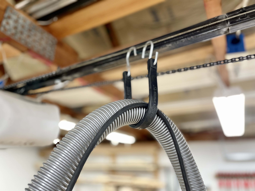

Until I build a boom arm I'm using this rubber strap and the garage door wire to suspend the vac hose:
He managed to sand everything to 120 grit and do the final flushing on the cherry edge banding.
It's all looking pretty good. Need to continue the shelf pins when we can, but I have so much going on, not sure when I'll be able to next.
On a positive note, yay for new forum software!

Although I’m a fan of the Festool 32mm setup why not just use the Woodpeckers jig with drill bit? For under $150 with both 5mm and 1/4” drill it’s fast, accurate, and easy.

This was my solution for drilling shelf pin holes before I acquired a line boring machine. I had the kreg jig before this, and was never happy with the tearout. I ended up picking up a Bosch colt with plunge base just for pin holes. The slight variation is hole spacing is irrelevant as long as you start from exactly the same point on all roles of holes.20170318_182929.jpg
Hmmm I sorta forgot about that one. I really enjoy the speed of using the router, and the quality of cut, dust collection, and guaranteed perpendicularity of the bit. I've used a self-centering bit style with a Rockler jig, and my plywood router jig is significantly faster, with zero dust. But... if I can't make something else work I think the Woodpecker kit is a good option. Still a bit more than I want to spend for shelf pins -- part of me thinks I could just get the LR32 base for that much $$$ and make a custom Makita rail for it.
Nice idea @jar944
I agree, a brad point bit in a router seems to leave really pristine holes.

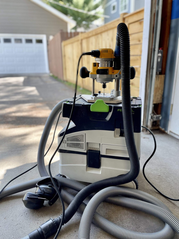

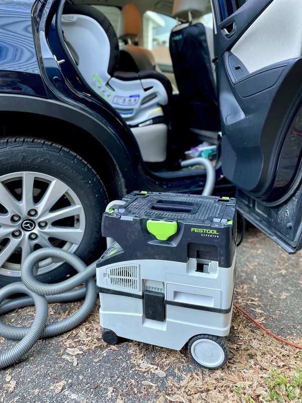

When you need full HEPA to vacuum out the car seat. Can't be inhaling Goldfish crumbs. 😁
Sorry, that's all the content I can muster this week. :ROFLMAO: Been working a bajillion hours so no time for GJ projects.
In all seriousness, I discovered the CT15 makes a sweet car vac.
Have a great Memorial Day weekend everyone!
