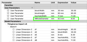

Short update on the MFT Flip Stop.
I tweaked the model for the stop block so the M6 holes are slightly oversized and that worked well. When I made the model I attempted to add some User Parameters to try out the concept of parametric modeling. This was AWESOME when it came to changing the dimension and having the model update.
For those reading along that aren't CAD wizards much like I am not, basically you can set a text string parameter as a value or formula. In this case, I saved the parameter "M6holeDiameter", and used that to set the dimension every time I wanted an M6 hole. The value started at 6mm of course. When that turned out to be too tight, I could just update the parameter value to 6.5mm, and then all the M6 holes in my model adjusted accordingly. I see the huge value in this, especially for 3D printing where adjustments probably have to be made quite a bit. In Sketchup this would be a nightmare.

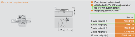

In other news, I suggested to my dad we make some prototype doors for his pantry. I haven't done any work on that project until now because of the baby, but I don't want to neglect it all winter or it will go unfinished for half a year. Unfortunately my only real time to work on it is after 8pm and it's getting cold, fast.
I didn't take any pics, but we sliced up some MDF to the expected door size for one of the cabinets as a test. I used the the table saw for the rips and the MFT w/fence scale and flip stop for the crosscuts and it came out perfect, with two identical, square parts.
I'm new to cabinet doors but it's a bit of a math headache. My dad has drawings, but of course there are slight variances in plywood thickness and the actual cabinet that got built vs. the schematics.
The boxes are 3/4" ply (actually 15/16"), and he wants a 1/16" reveal on the edges and a 1/8" gap where the pair of doors come together.
Here are some Blum charts that helped us figure it out:
That second one shows the "boring distance" for the hinge cup, which is the distance in millimeters from the edge of the door, based on the hinge plate part # and the overlay you want. We had originally planned for a 6mm boring distance to give a 17mm overlay. 17mm is equivalent to 11/16", which would leave a 1/16" reveal on 3/4" material. But because the plywood is actually a 1/16" undersized, we ending up going with the 5mm boring distance, as that gives a 16mm or 5/8" overlay, leaving the correct 1/16" reveal. Confused? I was too.
To size the doors, we took the total cabinet outside width, divided by two (2x doors), and subtracted 1/8" to account for the 1/16" reveal on each side. 1/16" + 1/16" adds up to 1/8" in the middle.
The hinge cups were drilled on the drill press with a 35mm Forstner bit. To find the distance in from the edge to drill, we added the 5mm boring distance to the radius of the 35mm bit, which totals 22.5 mm.
I did some test pieces and set the drill press fence, making an extra for a setup template when we go back to do the real doors.
Again, no pics, but my dad fitted the doors and said the overlay worked out correctly, but he mistakenly was off by an inch for the cabinet width so they wouldn't close and he couldn't test the gap between the doors. Will have to rip them down. Good to be making mistakes now instead of on the cherry. :oops:
EDIT: Here's a pic

For runner bars on my past sleds I've used oak. They've held up well, but do expand and contract a bit based on the season. The miter channels in my DeWalt table saw are $#%!, and not consistent width, so I really want to minimize sloppiness.
Enter the 3D printer.
I found these Microjig Zero-Play Miter Bar clones on Thingiverse:
Each one has a top and a bottom, and they're only about 8.5" long, so I printed 4 pairs:
They require some specific nuts and screws that are detailed in the Thingiverse link, and which I ordered from McMaster. About $20 including shipping.
First, some low profile hex nuts needed to be press-fit into the bottom pieces:
This went ok. The fit was tight, and I had to print with supports and they weren't the cleanest recesses. I ended up using a channel lock pliers and some blocks of plywood to protect the parts and press them in.
Then assemble in top and bottom pairs like this:
If you're not familiar with the Microjig product, the top and bottom slide against each other in a parallelogram action that lets the overall width match your miter slot exactly, and then you screw them tightly together.
This proved easier said than done.
