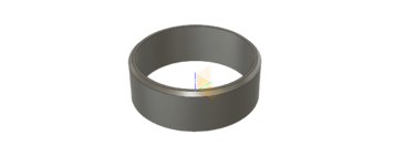

Switching gears from the GTI, I did a small 3d print last night, some drill bit depth stops I found on Printables.
Using my trusty print-in-the-front-right-corner method. :ROFLMAO:
I get a little bit of stringing, little fuzzies, on more intricate models. They clean off pretty easily so not too worried about it but I probably need some temperature or retraction tuning.
It's a pretty cool model set consisting of collets and sleeves. Made for metric but with the right combos they work for imperial, too.
A quick test:
I am impressed with the design. They hug the bit in a concentric fashion so the actual stop surface stays 90° to the bit. Seem to hold in place pretty well. Fairly easy to setup, no allen key or finding the blue tape.

Since Peter Millard is on the metric system, he design the mortise guides for an 18mm guide bushing, which is near impossible to find in the U.S. for the Porter Cable style baseplate on my DeWalt plunge router.
So I made a simple 'sleeve' to go over a 5/8" O.D. bushing in Fusion 360.
Had to clear some sharks out of the way to print it. I've been on a bit of a shark spree, made one for my girl, my boy, their cousin, and of course one for myself.
Of course this did not fit the first time, so I had to make 4 revisions before the I.D. was a snug fit.
