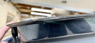

I guess I have no way to measure flatness, but I thought the part of the rotor that the pads contact actually looked in pretty decent shape.

A small update — circling back to the infotainment screen upgrade on my GTI, I ordered, received, and installed a replacement screen. It was wholesale from the Chinese market (still authentic VW), and it looks great. I was concerned spending a couple hundred bucks on this wouldn't be worth it, but it really changed the feel of the interior for me.
After negotiating back and forth with the eBay seller of the broken screen I received the first time, they gave me a full refund. We had talked about shipping it back, but he kind of dropped the ball (I think it was going to be too expensive to cover), so I still have it sitting around.

I also finally attempted to fix the paint chip / rust on my hatch seam.
In the process I discovered it's down to bare metal in the middle as well, and also on the right side:
Not as bad or rusty in those areas, but what I've determined is the seam of the hatch is rubbing on the bumper. I can see scratches in the bumper clear coat in those areas.
I painted the problem areas with this stuff @bj383ss recommended:
And then went to apply some official VW Carbon Steel Gray + Clear Top Coat touch up pens, but the ones I had were dried up so I need to order some more.
This will give me temporary peace of mind, but I'm not sure how to solve the larger problem of the hatch rubbing on the bumper. And that area collects water and gets so dirty, especially in winter. It's kind of a defect but I'm out of warranty so I don't even know what I'd do (taking to the dealer sounds like a nightmare). But now I'm really worried in a few years my hatch is going to be rusting out.
More updates to come.
